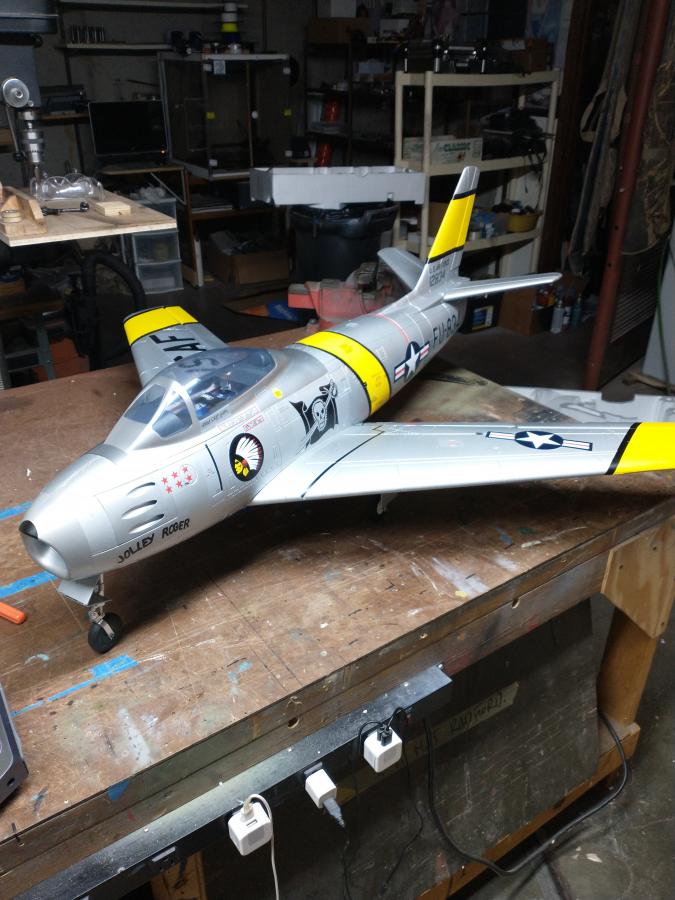

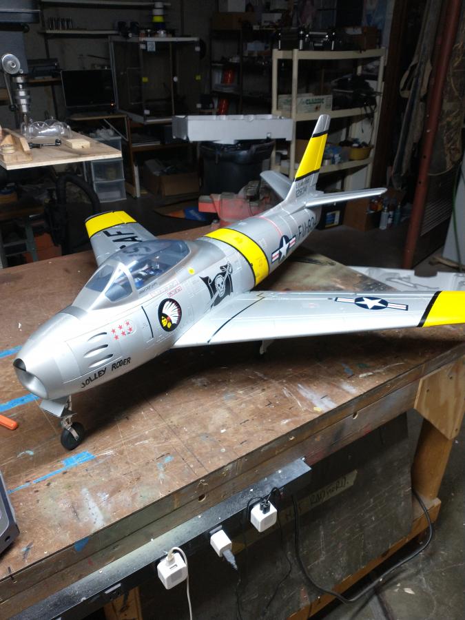

ID:	311619 I flew 4 flights on my new F-86 today and what a nice flying jet. I ordered the PnP version with the 12 blade outrunner motor. First thing I did was swap in a 9 blade 1920kv inrunner system for better performance...and it proved to be fantastic.
    Reading through this thread I was somewhat concerned about flying from a bumpy, grass strip. Turned out to be a non-problem. I did change the nose gear slightly....put in a larger wheel and a 3mm spacer to raise the nose and increase AoA for takeoff. The F-86 literally jumped off the ground in only a short distance and climbed out with authority. I was flying with a RT 4400 mah battery and performance was really good. Most of the flight was at 50% throttle or less and only going to full power for steep vertical climbs. From a high speed pass, pulling to vertical the plane continued to climb until I decided that it was probably going to go out of sight if I kept on. By the 4th flight I had increased the timer to 4:30 and was still landing with 40% left in the battery pack.
    This one is a worthy addition to the fleet.
