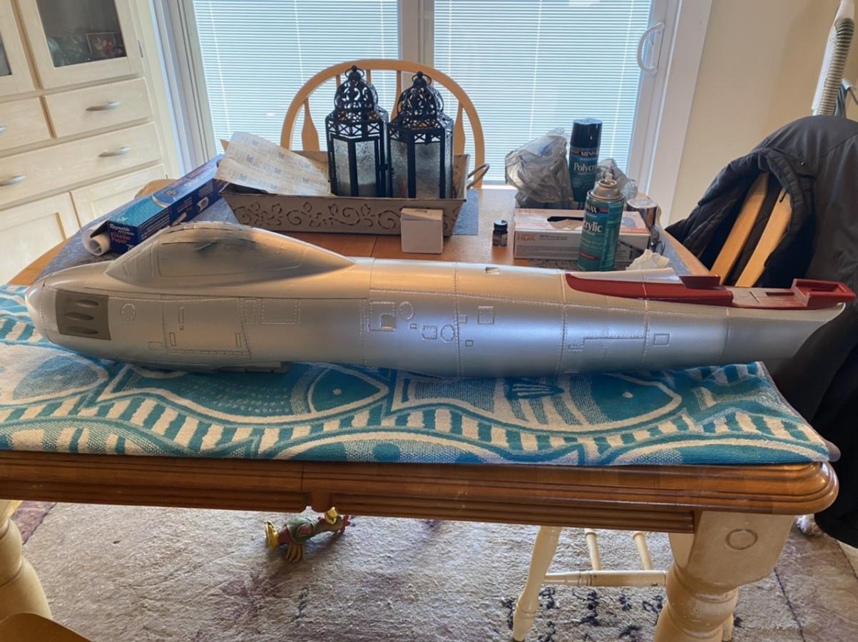

    All the painting is complete on my F-86. The graphics from Callie should arrive today. I am hoping the red, white and blue fuselage stripes are included. If not I am going to order pinstripe tape to put the stripes on. I am done fighting masking this plane.

    I have the red,white and blue sprayed on the plane. I have to say the chrome paint does not tolerate being touched by hand or masked. You can handle it with latex gloves and it will not affect the surface. I will have to wait for the colored paints to cure so I can mask off and re-spray the chrome paint.

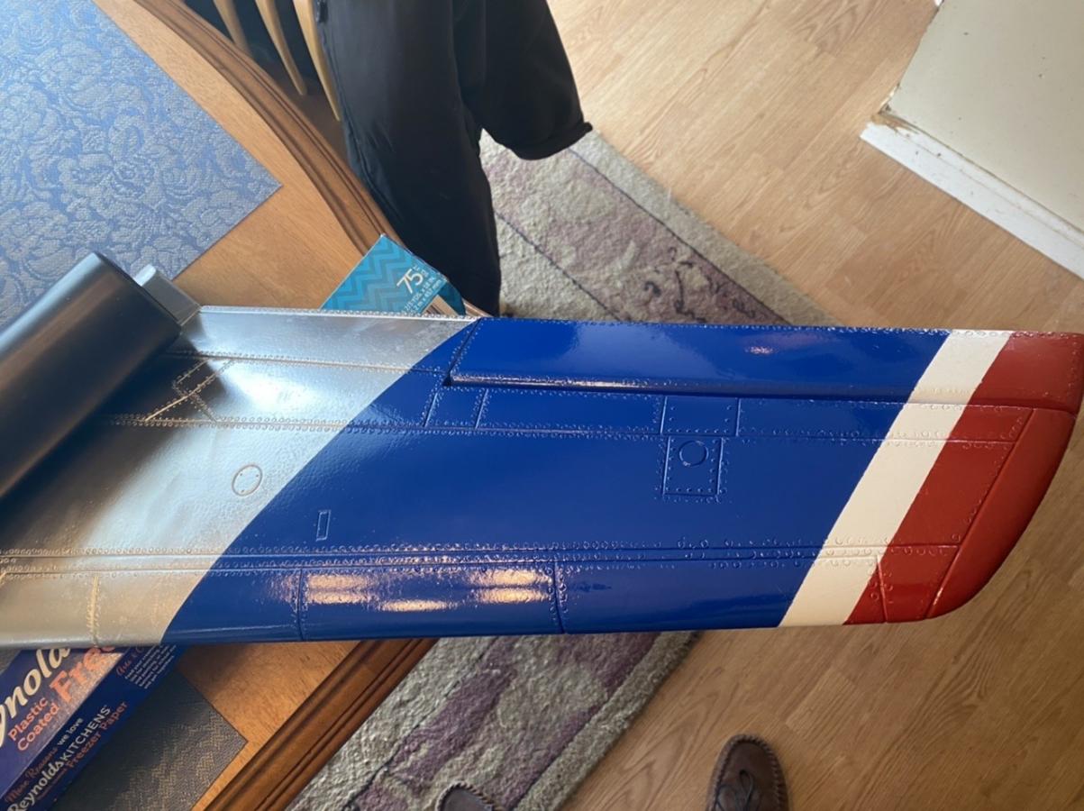

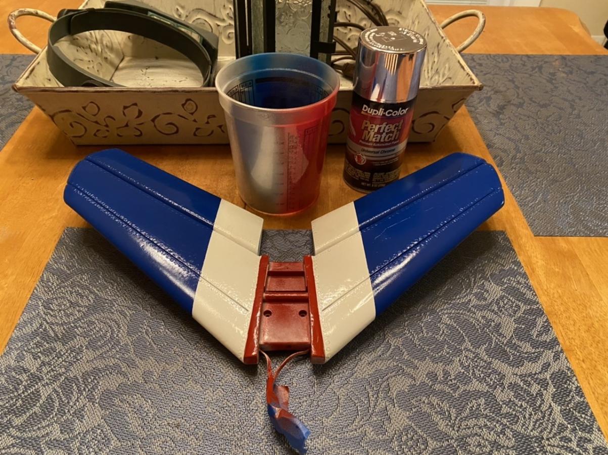

    I started masking and spraying the red and blue. The white paint was good and dry on the tail surfaces. I had only a couple minor problems on the tail with paint lifting. On the top of the fuse where the tail mounts the white paint lifted after spraying the red. I will have to mask off the red and spray the white again.
    I did a test with all 4 colors sprayed on a paint cup. I sprayed 2 coats of Polycrylic over the paints with no issues. I will clear the plane with Polycrylic after the graphics are applied.
    Here is a pic of the stab/elevators.

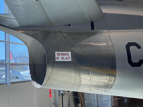

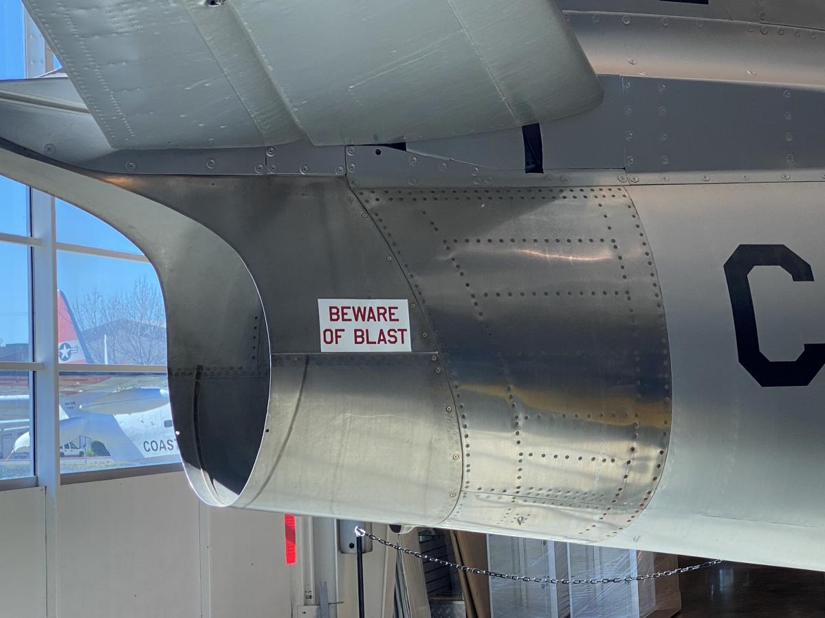

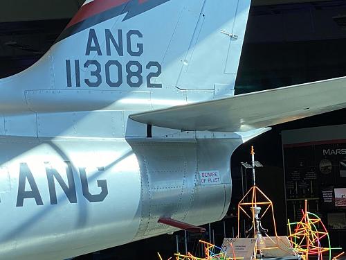

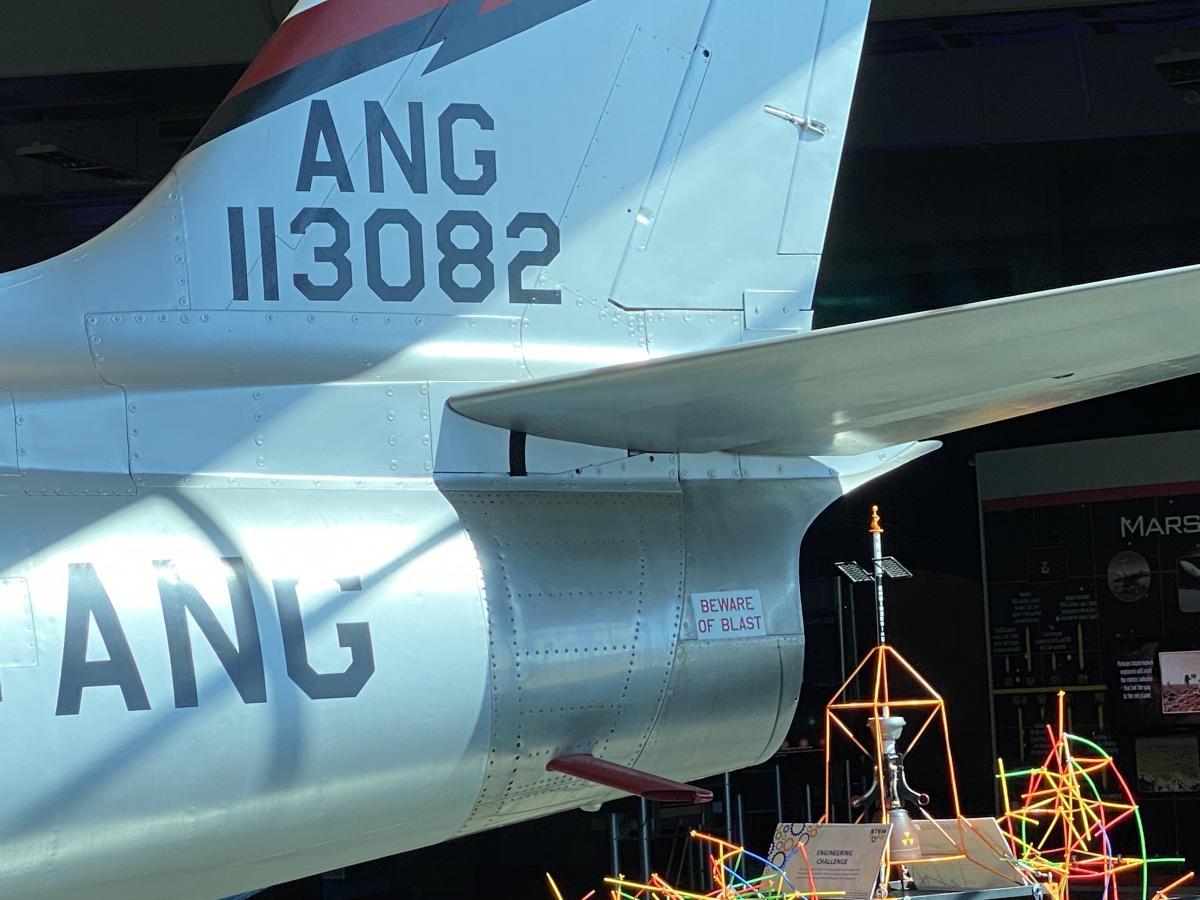

  • C17loadmaster
    Plane looks good! I took these pics the other day in case you are searching for references... I have about 100 of this Sabre, a 10 minute video of a walkaround (and under) an F-14, also some F-104, and A-10 pics. Being as those are the my only planes the museum had that I also had in my Freewing Fleet.
    It was about a quarter mile from my dentists office so i made a solo field trip...
