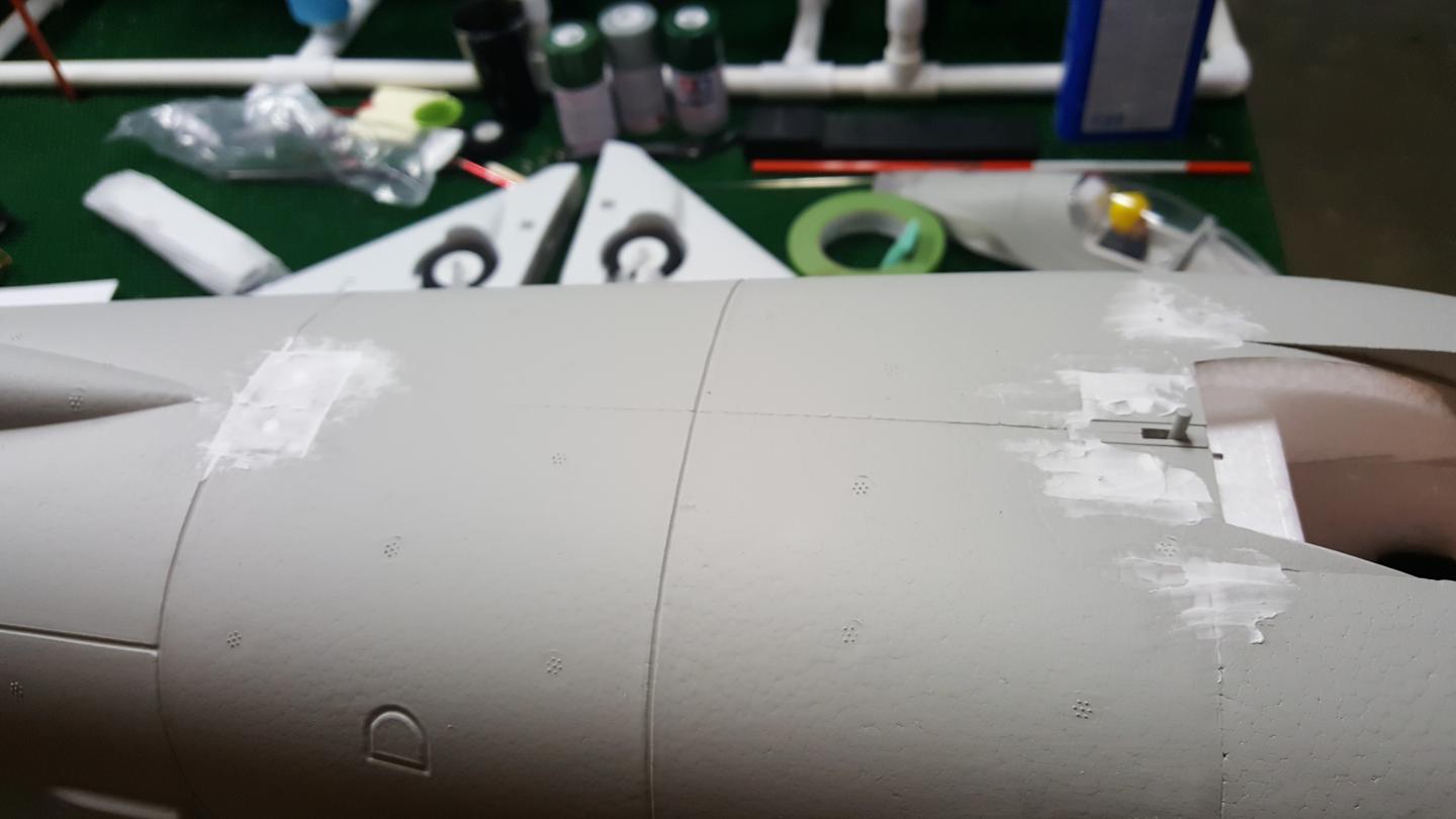

    I am in the process of converting a Freewing 80mm ARF+ to a Blue Angels #6 from the 1980 team that I watched fly in my home town of Corvallis, OR. I thought I would post up a thread on the project. So far I have the plane, graphics from Callie (which needed some re-sizing), the JetFan 80 fan unit with HET 2085kV motor, HET Zeus 125A ESC, Model Masters Acrylic paints and various other components. My plan is to add main and nose gear doors and Strobon V2 landing and Nav lights which are currently back ordered. So far I have installed the fan and ESC, removed various raised portions on the fuselage, done some filling work with Beacon Foam Filler, modified the refueling probe, removed the gun mounts for filling, painted a new pilot and I am currently finishing up lining the cockpit with card stock (poster-board). Here are some photos of the progress so far.

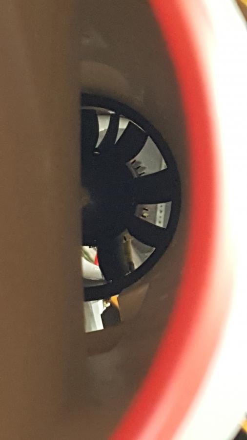

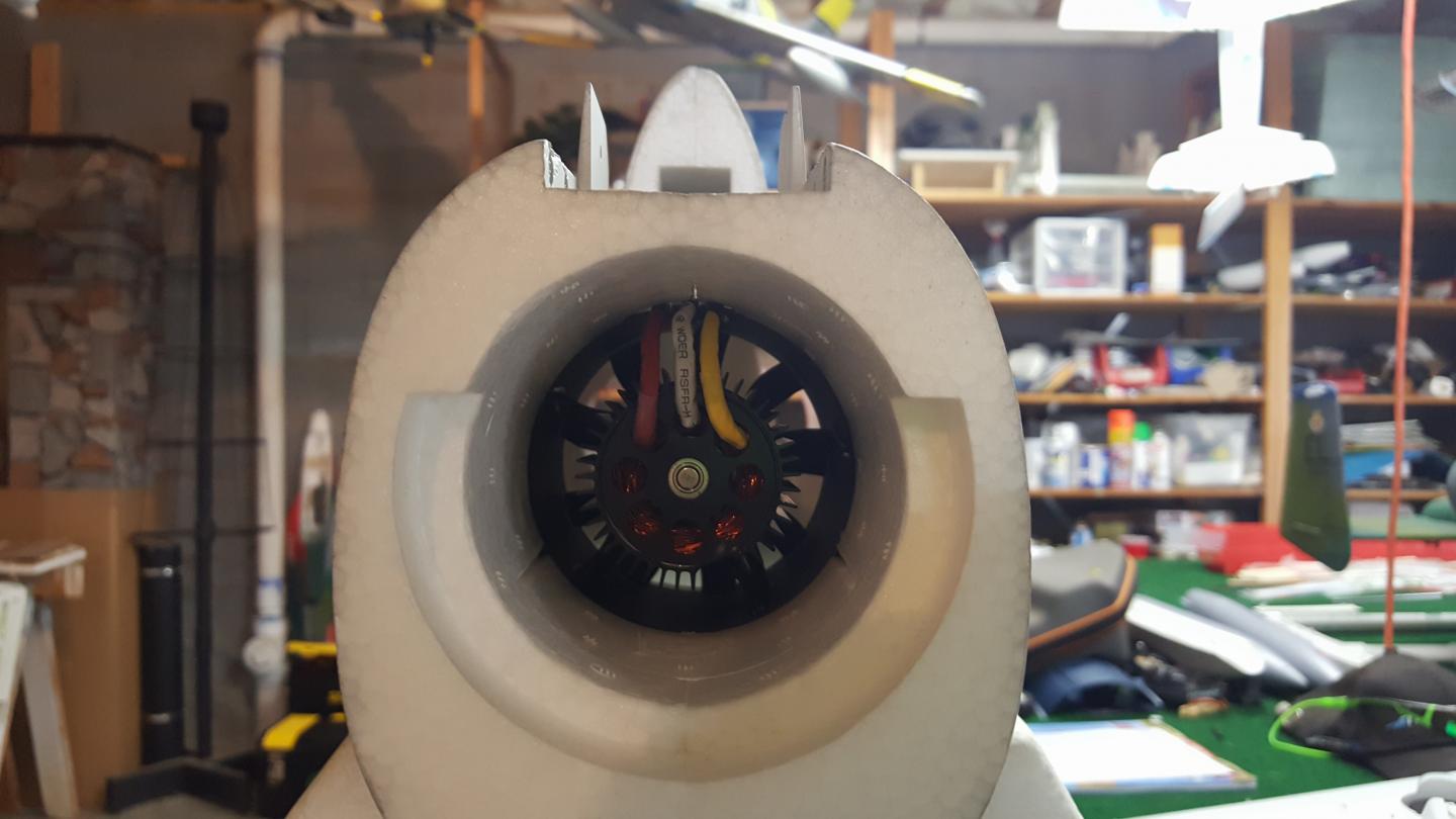

    The fan fit great. I will try to get a shot of the ESC mounting as well.

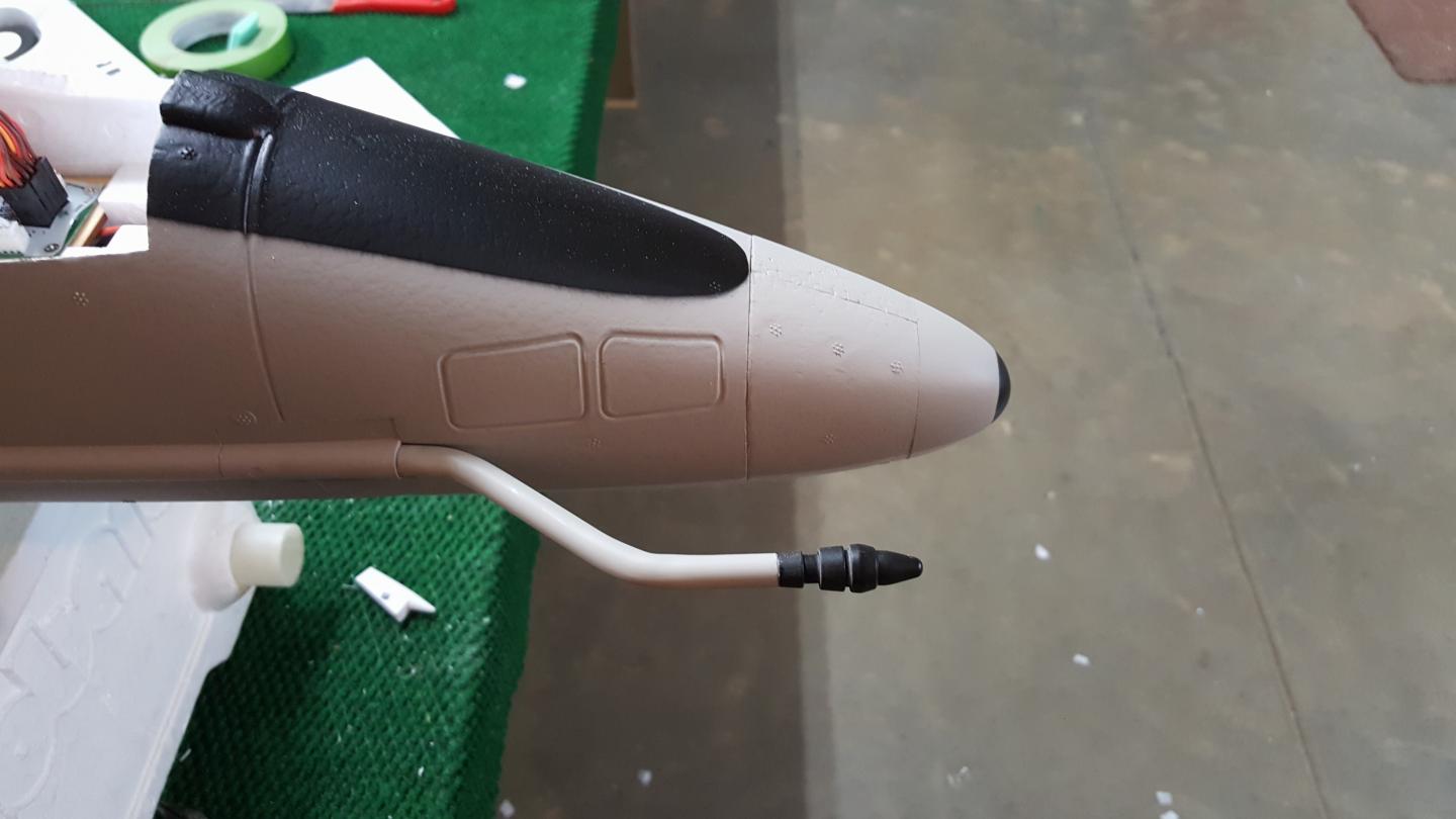

    I need to shorten the probe a bit more.

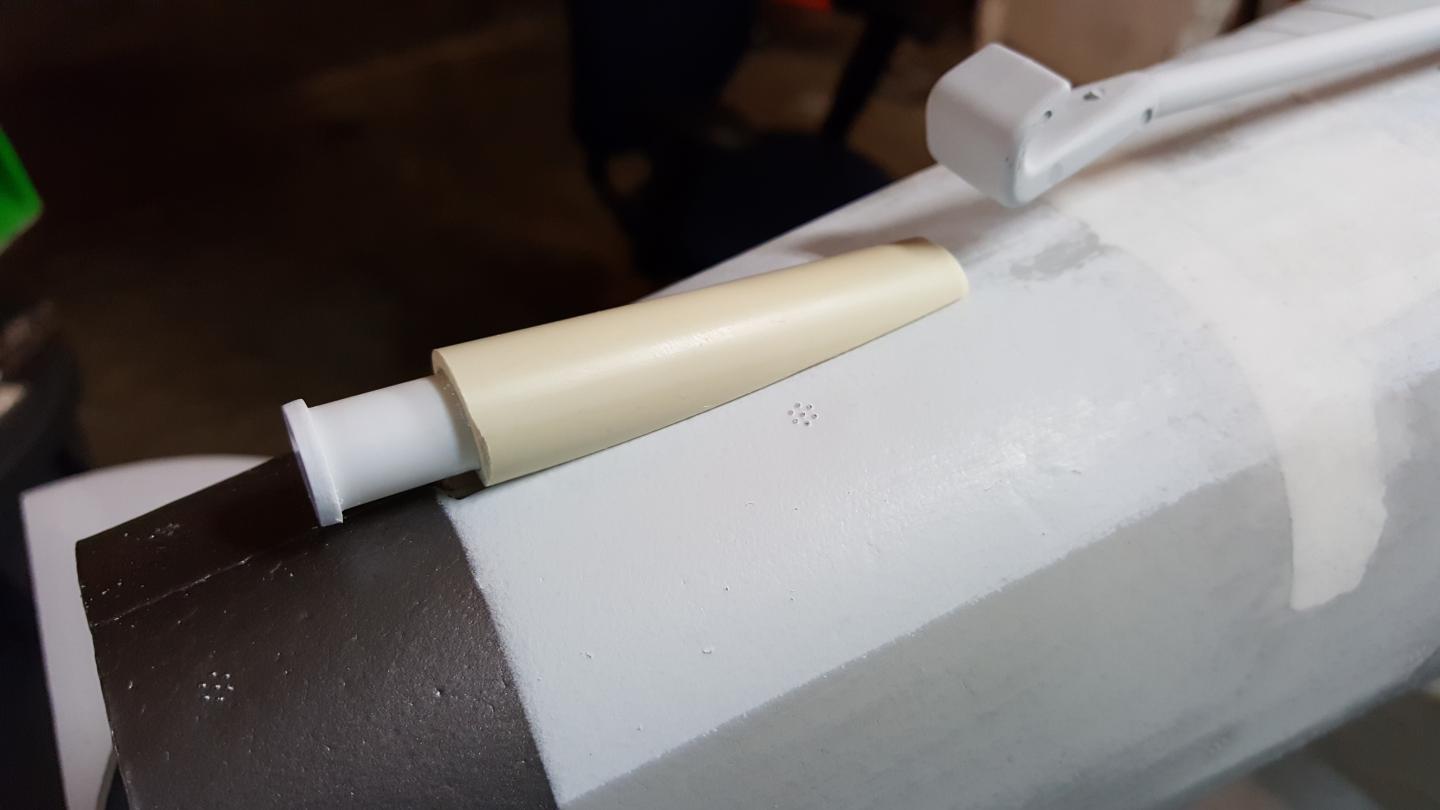

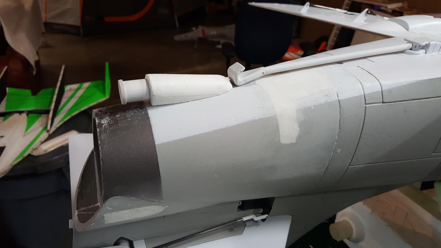

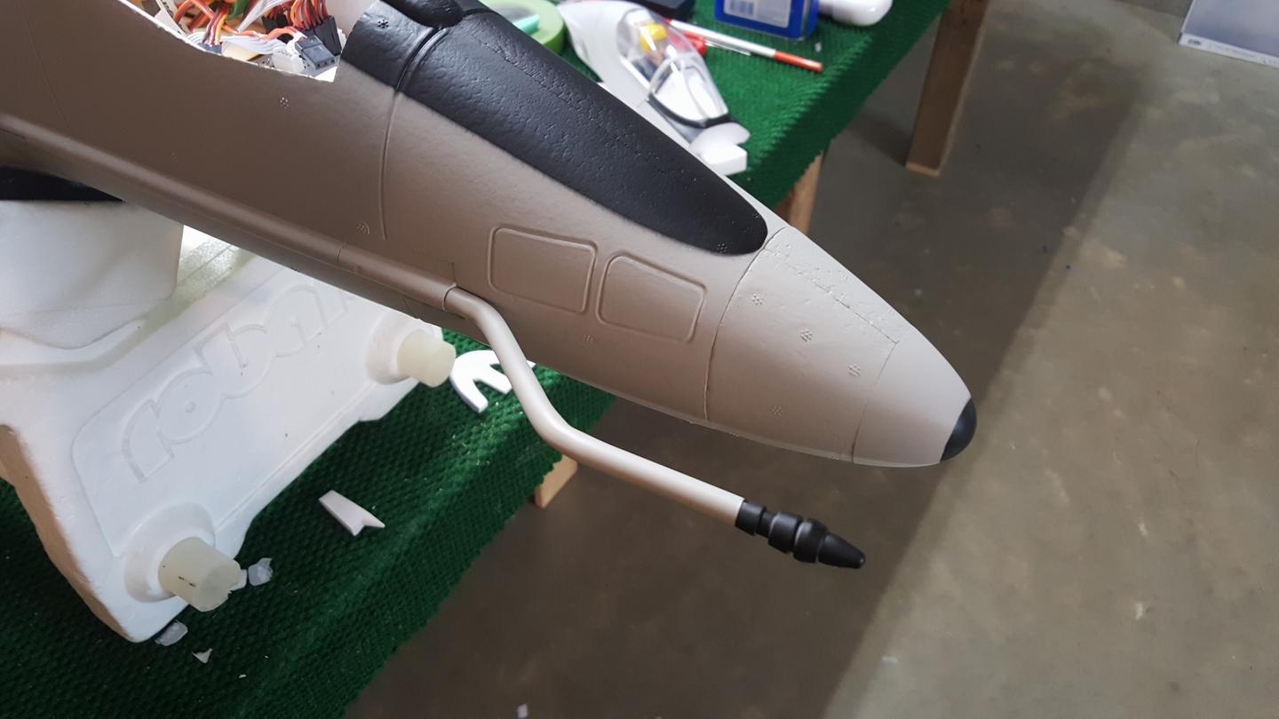

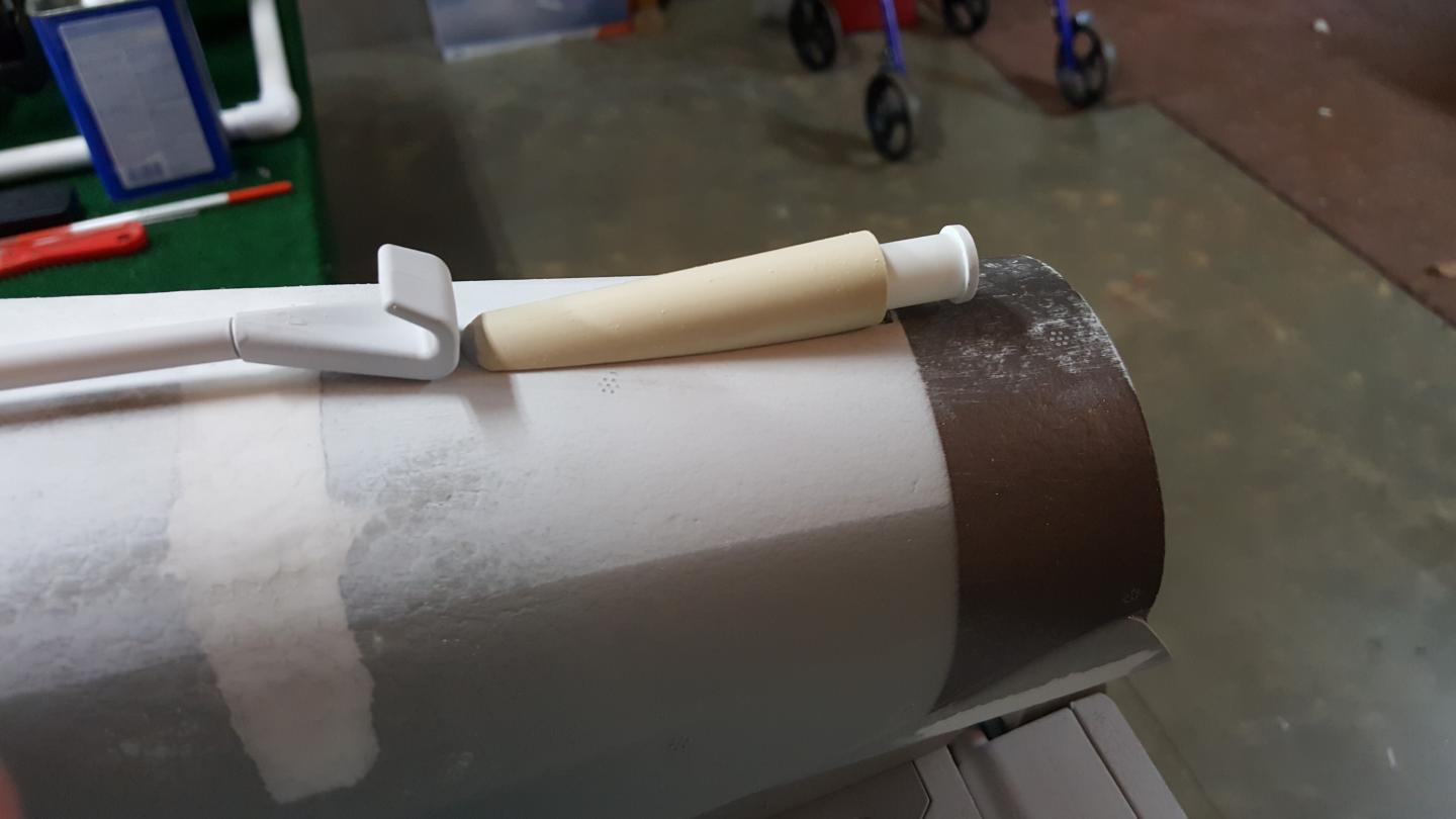

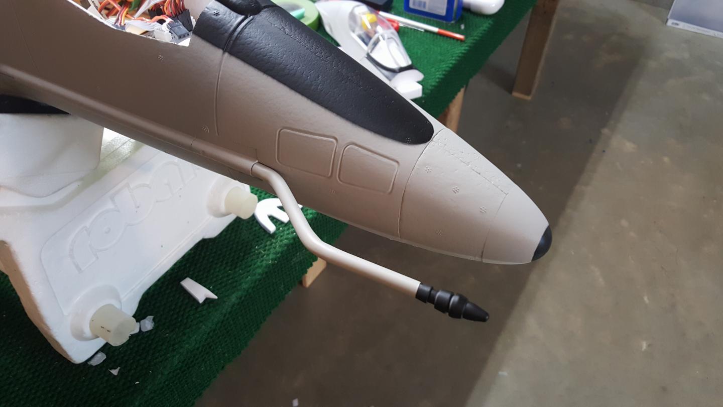

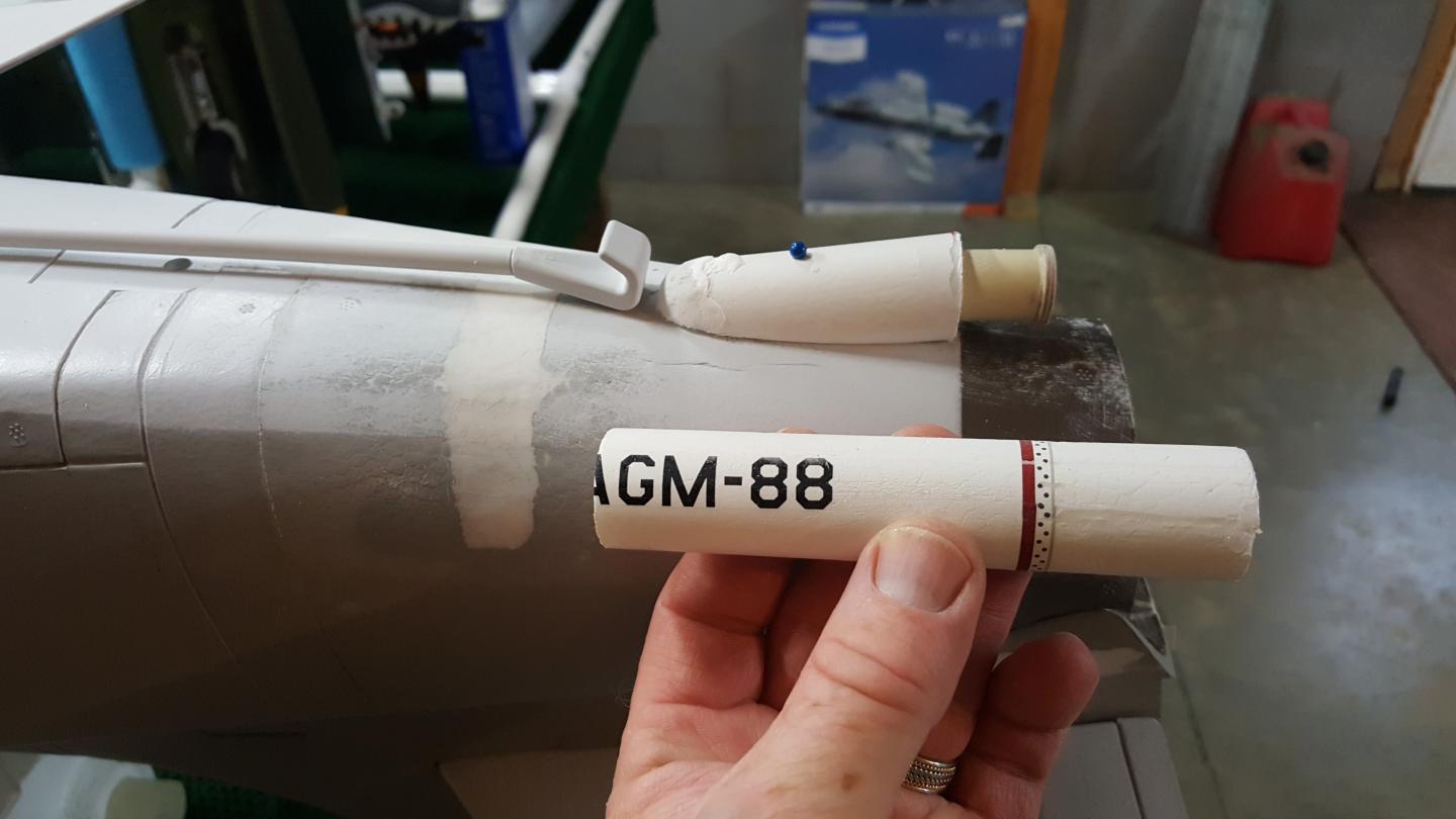

          A few more small updates as I did not get much time on it last night but did manage to shorten the refueling probe.
          Before...
          after.

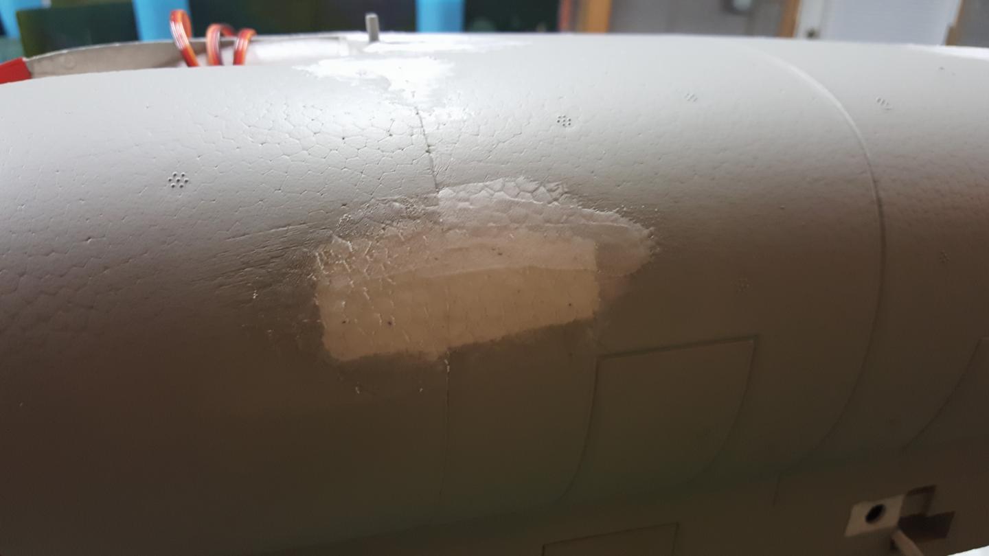

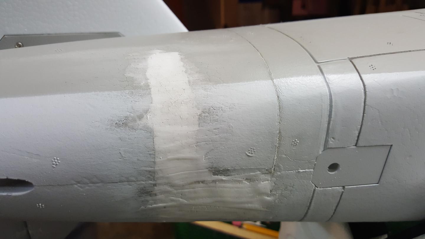

          And start filling in where the guns were.

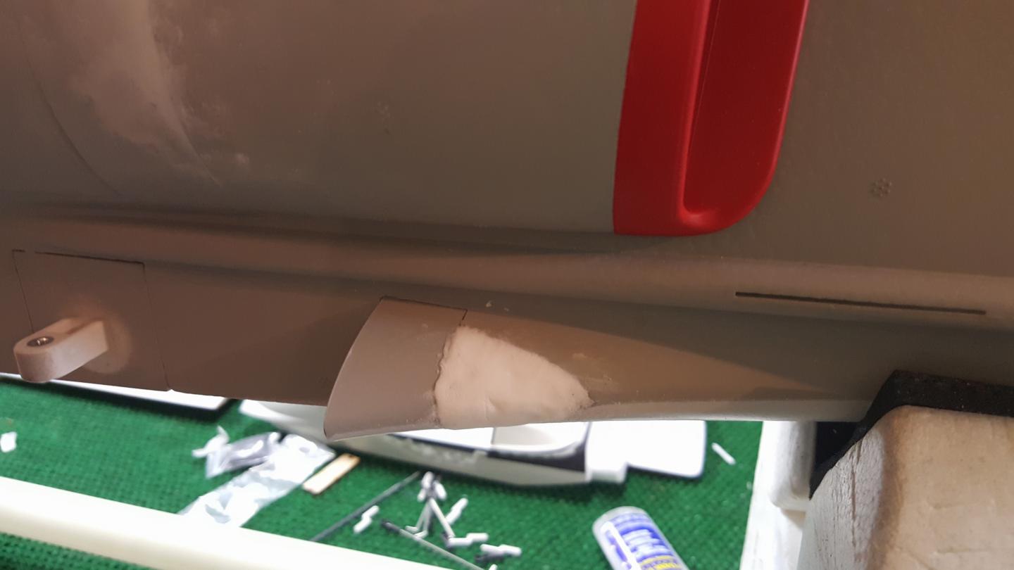

              I just Foam Tac'd a chunk of scrap foam there and then covered it over with Beacon Foam Filler.

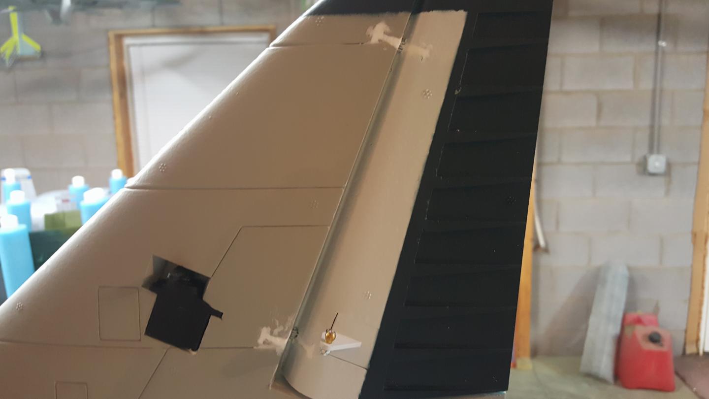

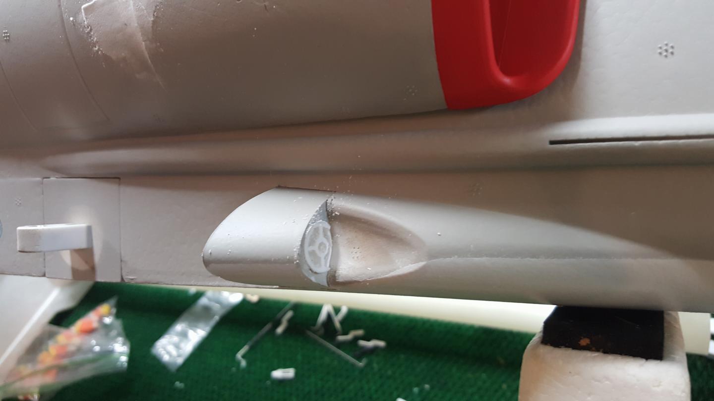

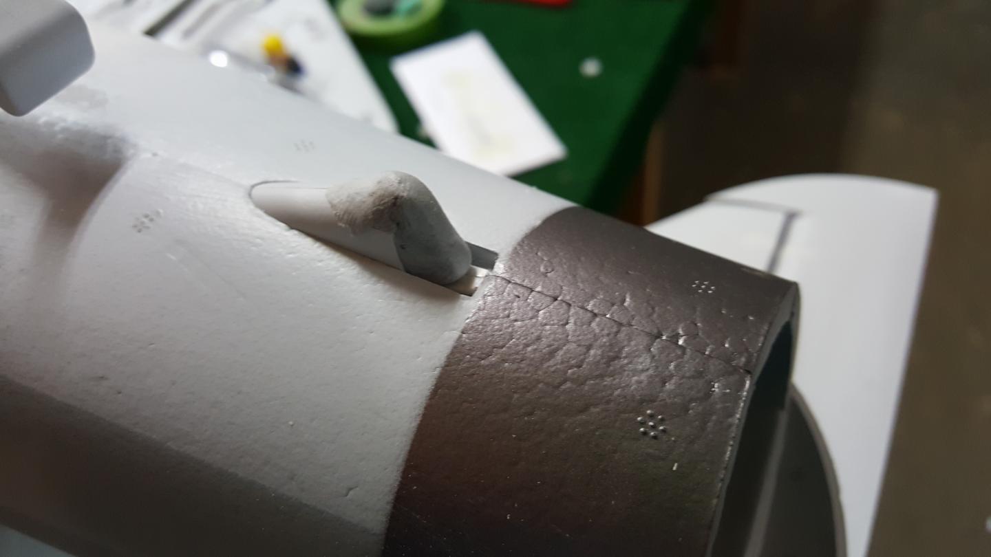

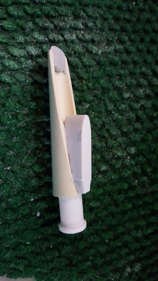

                Made a little more progress this evening. I added the detail of the piece below the tail pipe. Made it from 1/2" CPVC and styrene. Also spent some more time working on the cockpit. It is ready to paint.

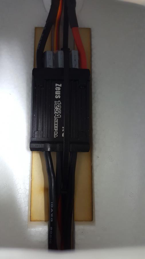

                  Here is the ESC mounting.

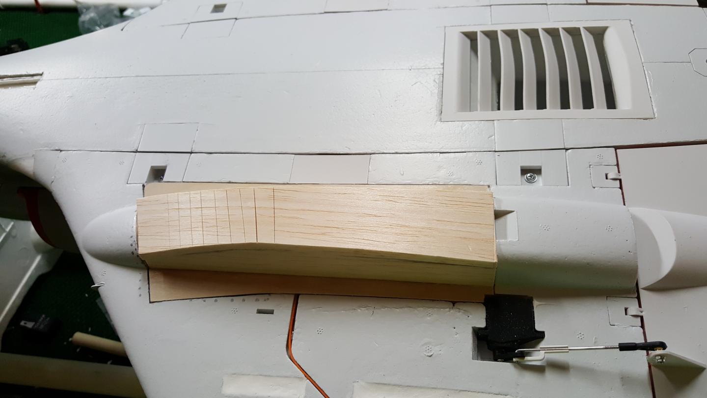

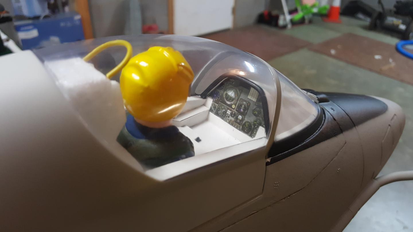

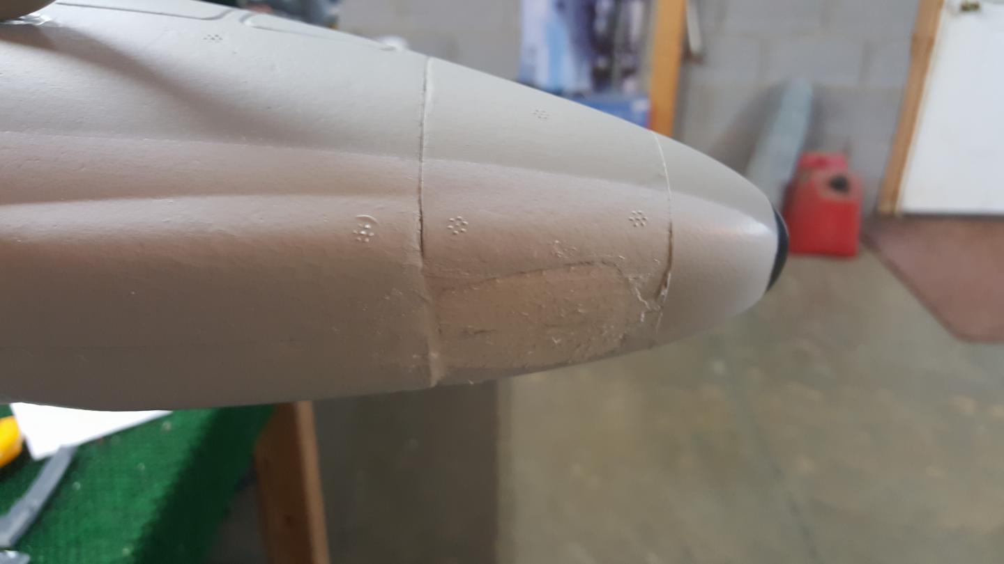

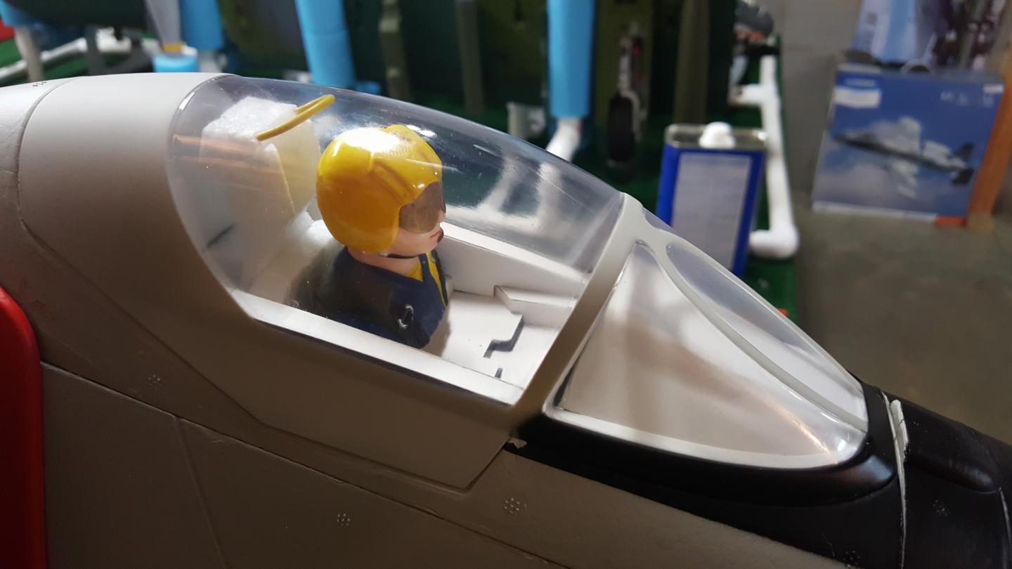

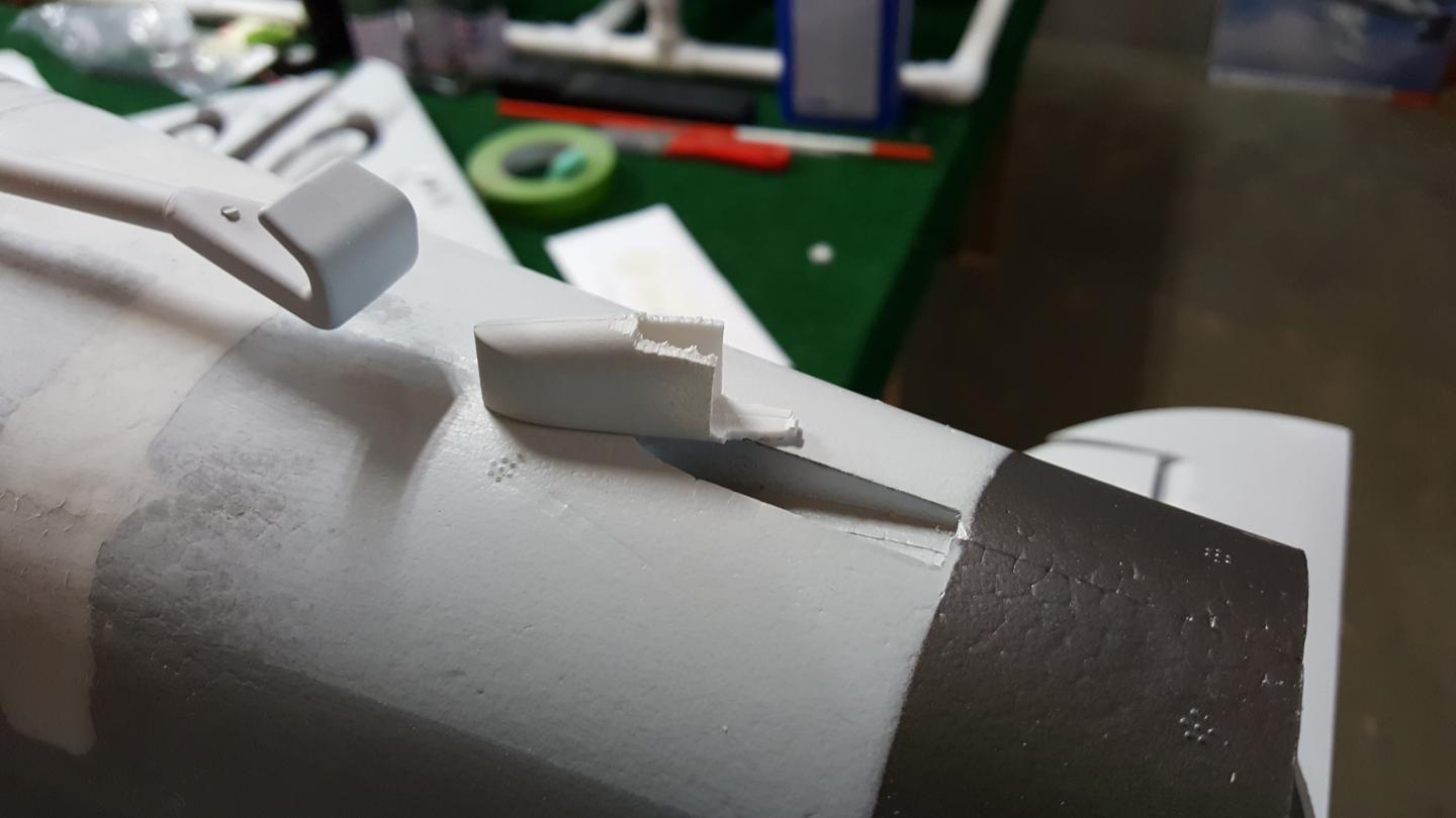

                      After looking at the part I made for the bottom of the tail cone awhile, I decided I didn't like it. Just looked too small (I do that often). So, I decided to re-do it. Instead I used a section of foam from an AGM-88 HARM missile off the Freewing 90mm F-16. I still used a small piece of 1/2" CPVC and some 1/8" ply for the disc on the back. Now it looks closer to the right size and shape.
                      Click image for larger version  Name:	20171008_113158_001.jpg Views:	1 Size:	79.0 KB ID:	99700
                      Click image for larger version  Name:	20171008_122954.jpg Views:	1 Size:	78.7 KB ID:	99701
                      After looking at the refueling probe I will be re-doing it as well.

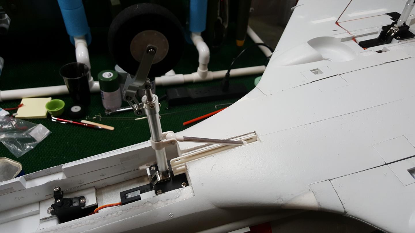

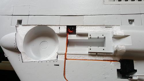

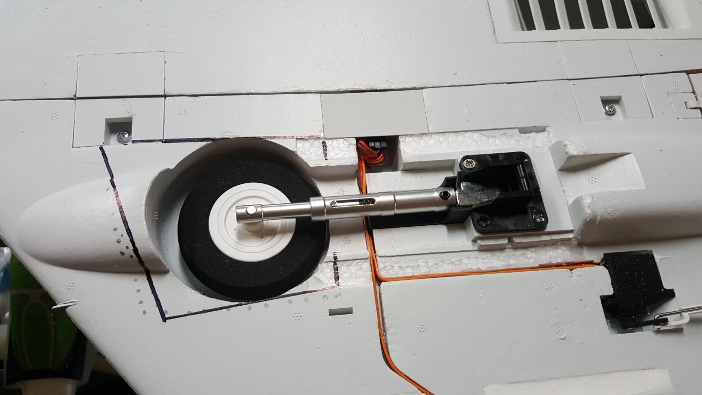

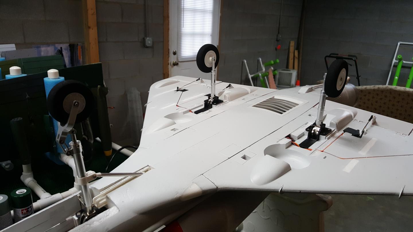

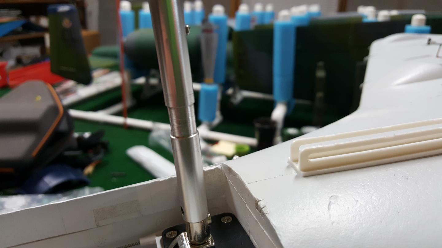

                      I then replaced the main struts with a set of Stinger 90 Oleos. It requires drilling the strut to 5mm to fit the strut pin, shortening the strut pin a little and grinding new flats in it. I also used Stinger 90 main wheel axles and some nylon stand-offs I got from my local hardware store.
                      Click image for larger version  Name:	20171008_112904.jpg Views:	1 Size:	95.9 KB ID:	99702
                      Notice also I filled in the weapons pylon locations. No ordnance for this bird.

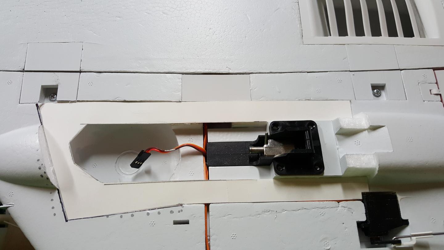

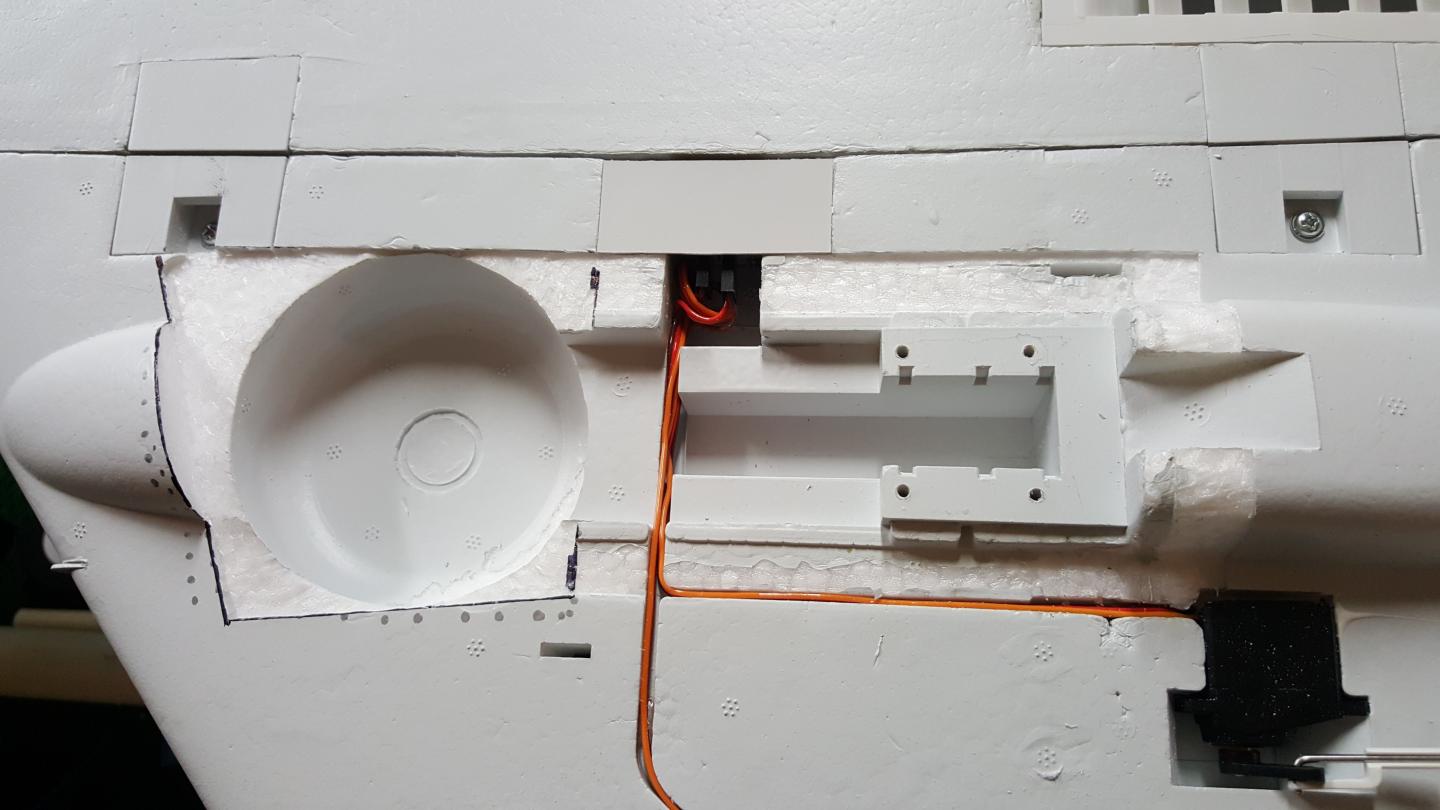

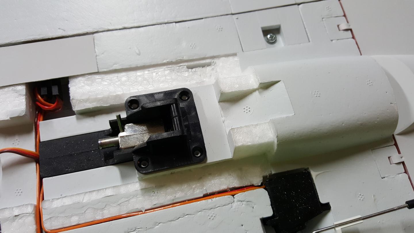

                      For the nose strut support, I used the one for the F-14. I actually ordered two of them and I am glad I did. The clamp on the strut needs to rotate freely but was too small so I took the strut completely apart and chucked it in a hand drill. I then lightly clamped the drill in a vise and took the edge of a flat file to create a grove in the strut that would allow the clamp to fit properly. I had to glue two sections of the rail together to make it long enough and then cut the ends off the support arm and drilled them to fit a piece of CF rod. Once I determined how long it needed to be I then cut two pieces of aluminum tubing (one fit inside the other) and then CA'd it all together.
                      Click image for larger version  Name:	20171007_195138.jpg Views:	1 Size:	82.4 KB ID:	99703
                      Click image for larger version  Name:	20171008_112915.jpg Views:	1 Size:	95.2 KB ID:	99704
                      I still need to make the small cover or door for the support and of course the nose gear door.
                      I did a quick outline of the proposed main wheel door and I think it will work ok. It is further back than on the full size plane. Maybe the main struts are shorter to keep them from being so spindly or the mains are moved back a bit to improve weight distribution. I dunno...

                          if I remember correctly, the A-4 main gear has an internal cable that shortens the overall length of the strut as it retracts. That may be why you are having to mount those gear doors farther forward than you'd like. Pretty sure the nose gear does this also. It was the same on the Prowler's main gear.
                            Thank you sir. Yeah, the placement is what it is so I will just have to work with it. I trimmed the foam to prepare for building up the doors.

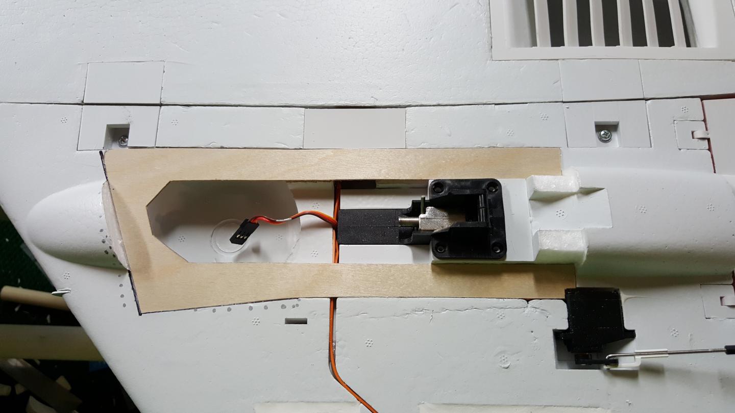

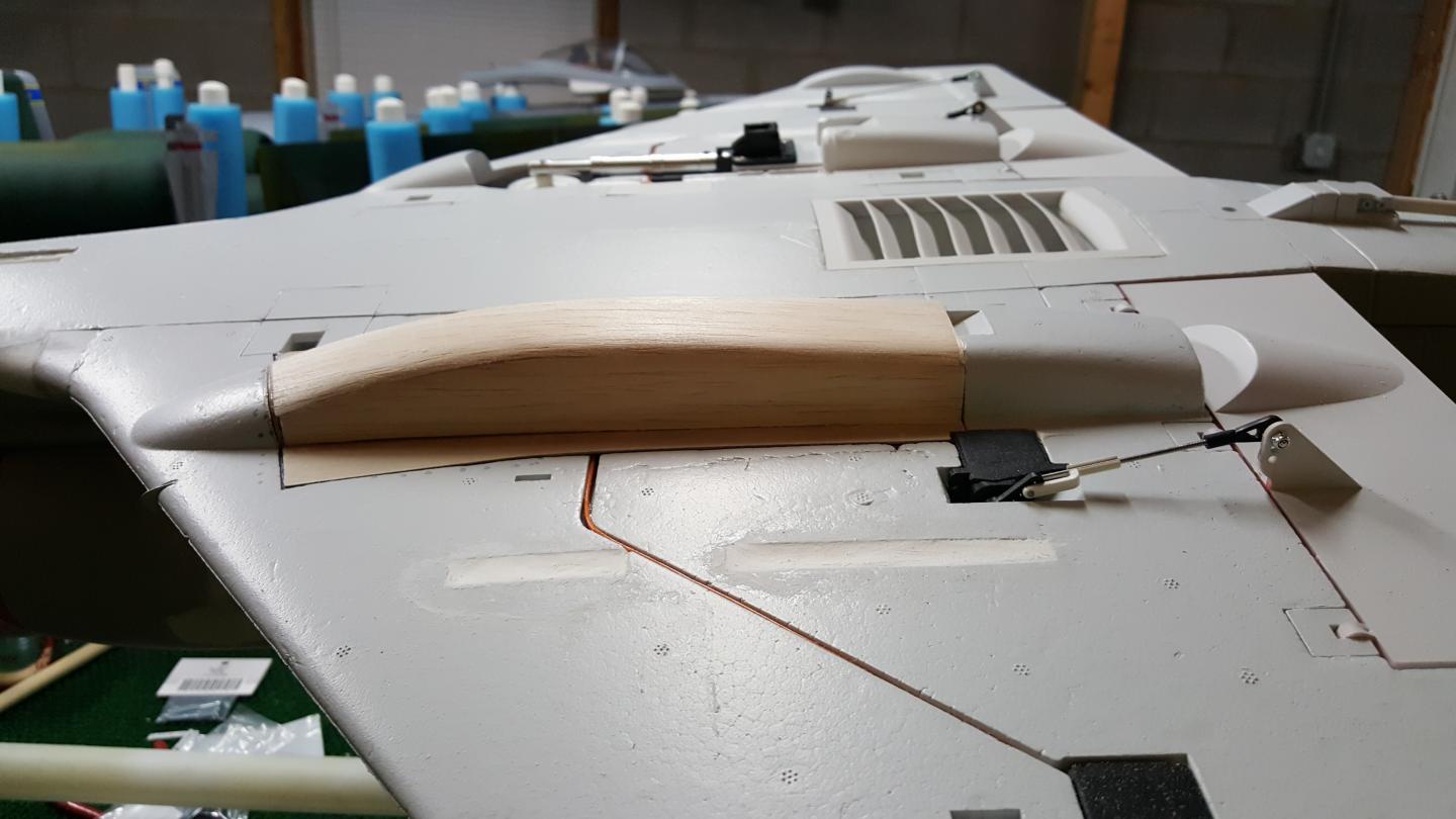

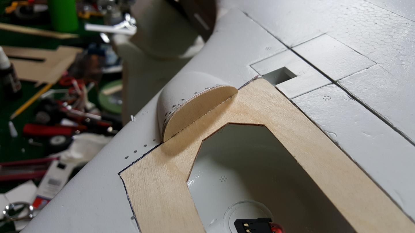

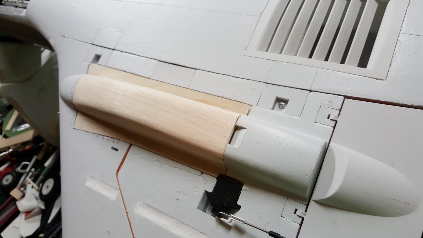

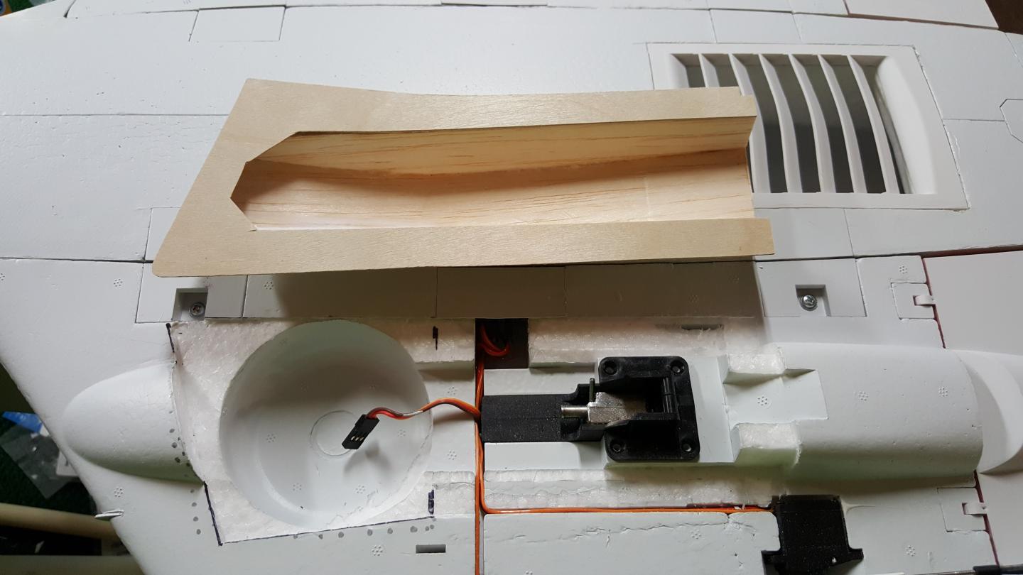

                              I started making the first main gear cover which will become the gear doors. Had to remove a little more foam back around the retract mechanism first. I started by making a poster board template and once the shape was how I wanted it I made the piece from 1/32" ply. I then made a small bulkhead to go behind the door fairing on the wing.Then I built up the sides and bottom with 3/16" balsa. Once I get it to it's final shape I will cover it with some fiberglass cloth and finishing resin. Then I will cut it apart and install the hinges. That is the plan anyway.
                              Click image for larger version  Name:	20171009_181654.jpg Views:	1 Size:	101.4 KB ID:	99952
                              Click image for larger version  Name:	20171009_184725.jpg Views:	1 Size:	92.5 KB ID:	99953

                                      Inside of the cover.
