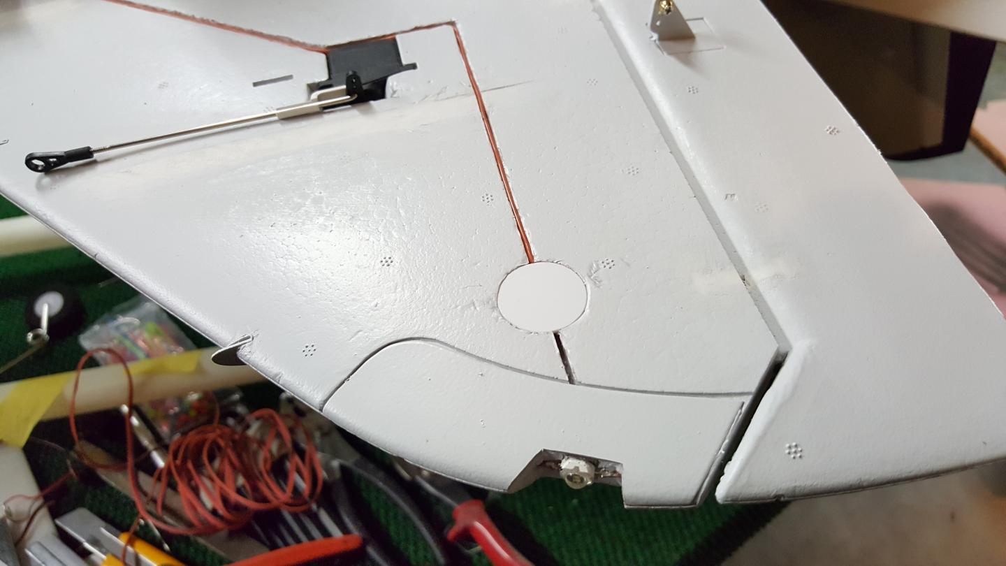

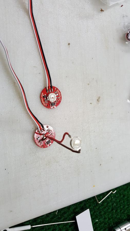

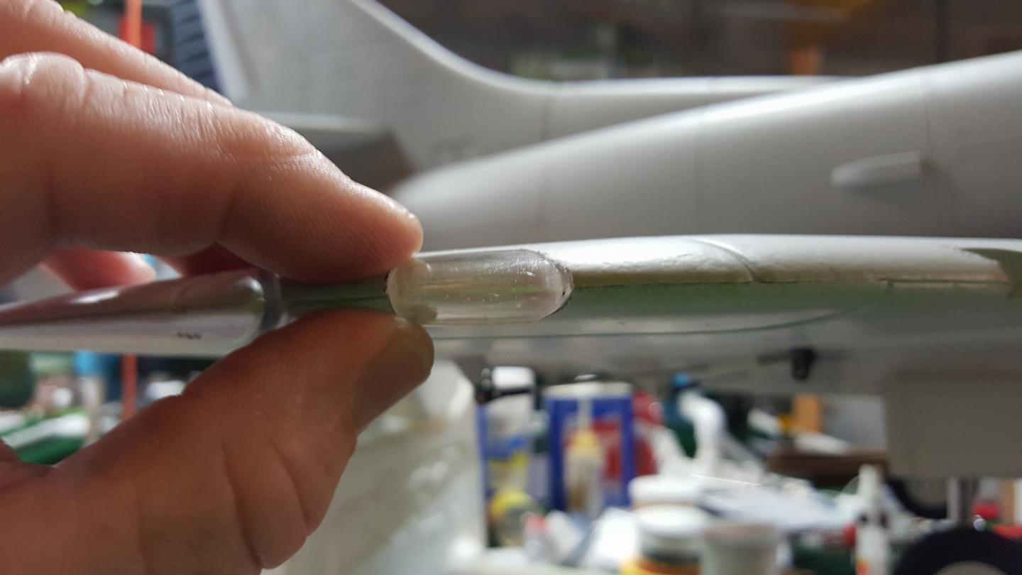

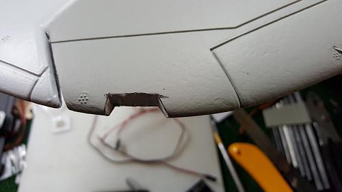

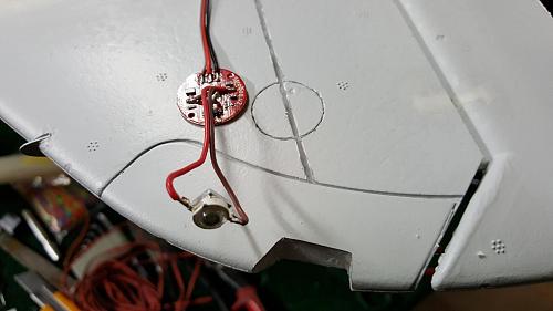

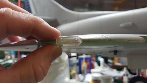

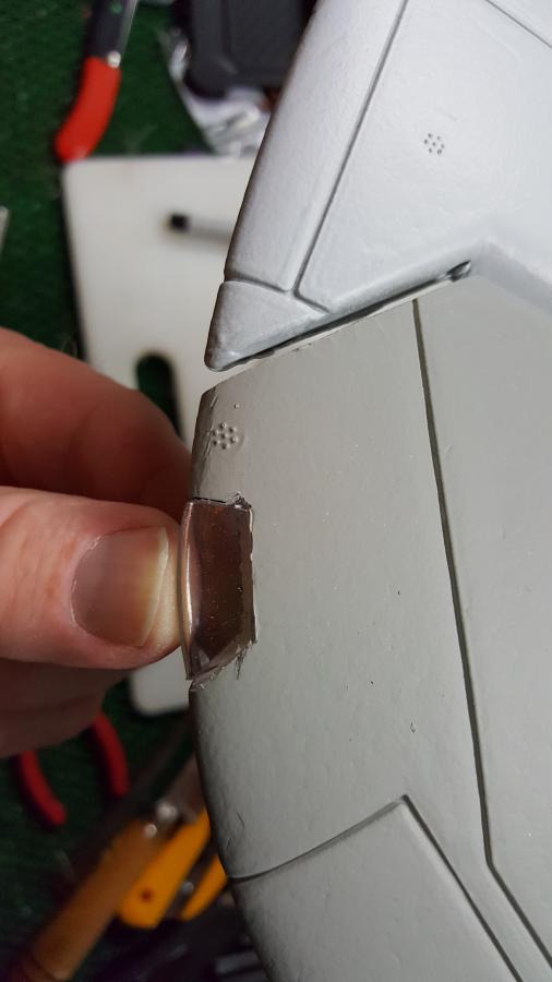

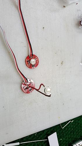

      • Time for my nightly update. I went through the Strobon v2 lights I got from Readymade RC and programmed them. I also un-soldered the LED's from three of them and added short wire extensions to allow mounting the LED's in the thin wing tips of the A-4. I got a set of the T-45 light covers and modified the wingtip covers to fit a recess in the A-4 wings for the LED's. The video explains the programming of the LED's. The wire runs are straight forward. I managed to get the wing tip lights installed. Here is the video
        and here are some pictures

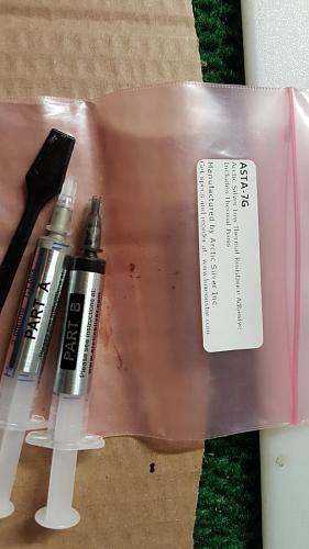

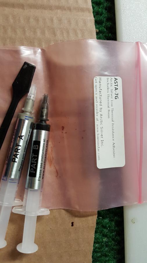

        Because the LED's appeared to be heatsinked to the boards, I glued a small square of aluminum sheet stock to the back of each LED I mounted remotely with this thermal epoxy.

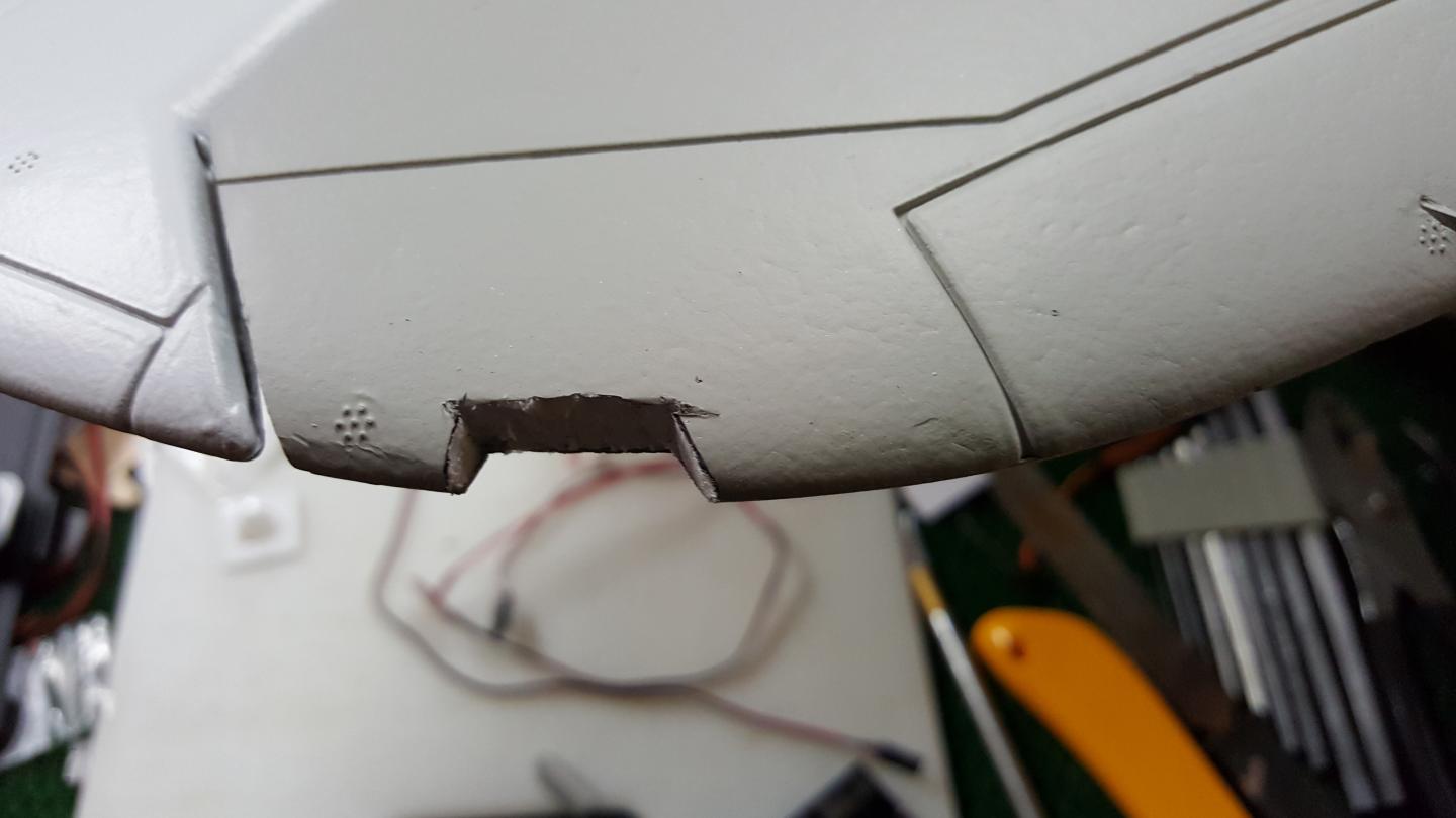

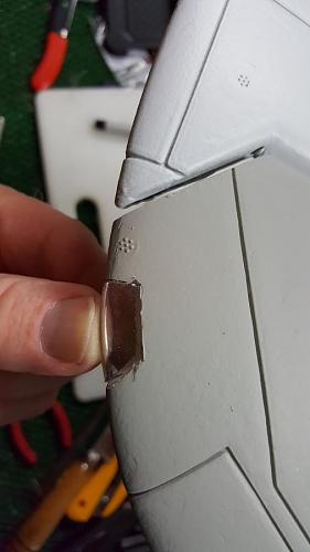

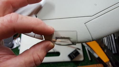

        Fitting the wing tip covers...

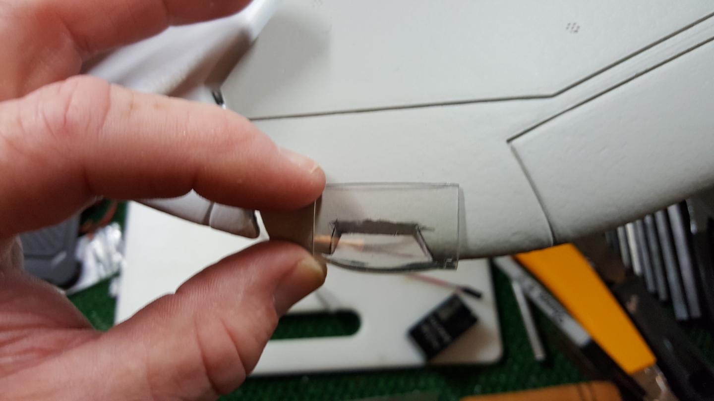

        I had to heat the lenses a little to soften them up so I could squeeze them to the right dimension to fit.

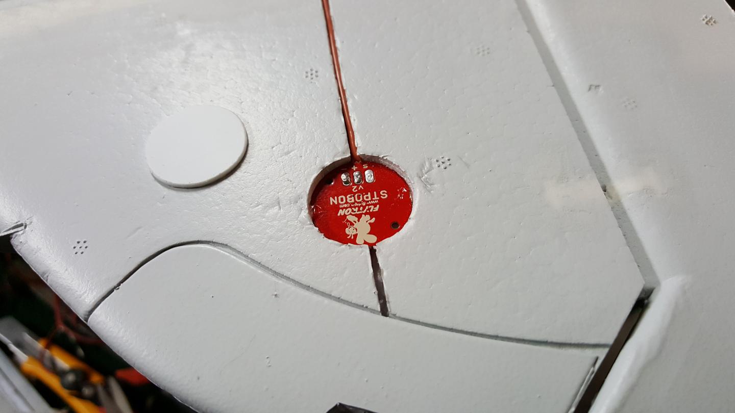

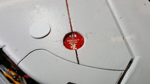

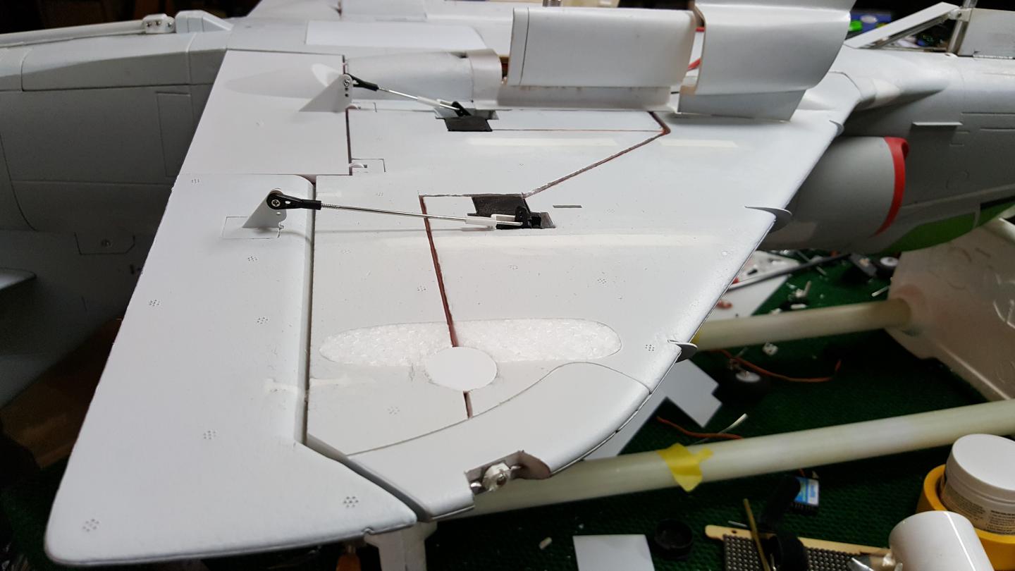

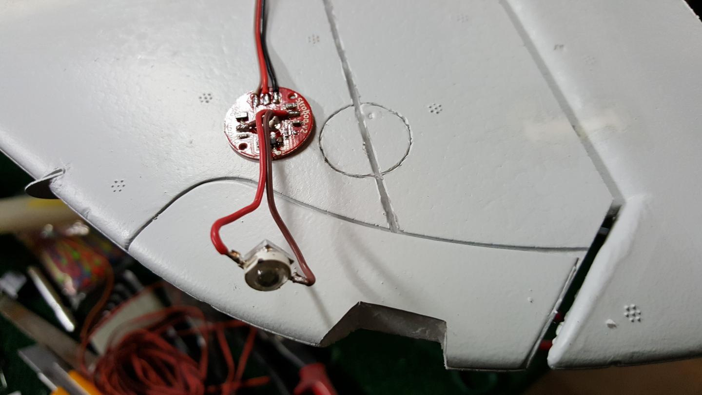

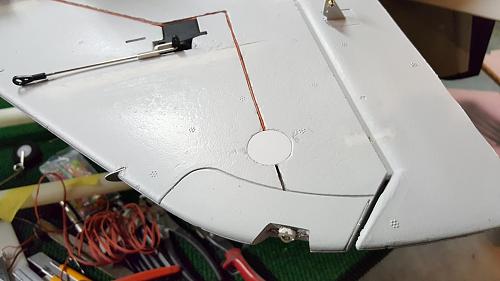

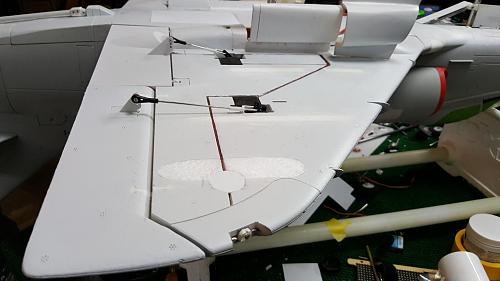

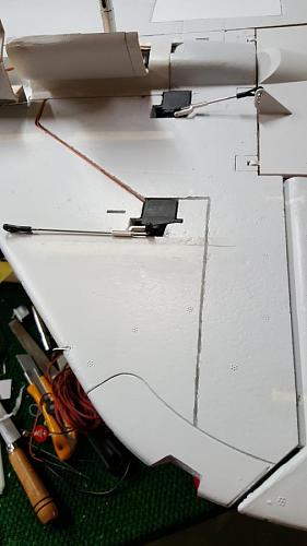

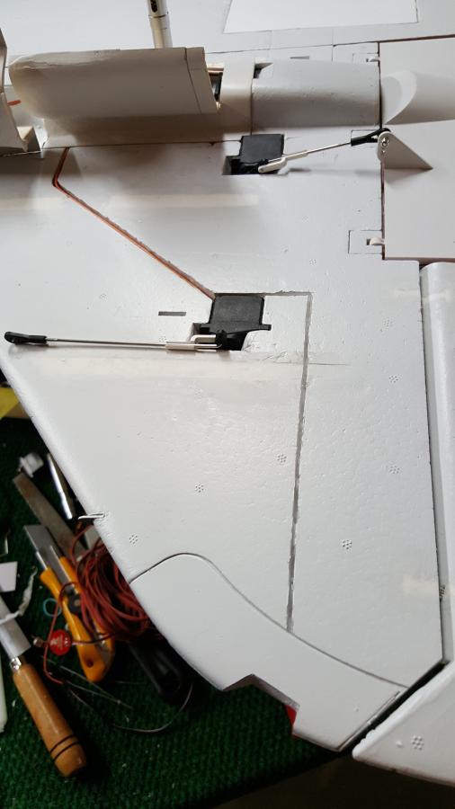

        The rest of the pictures are making the wire channels, fitting the LED's and embedding the circuit boards.

        I will be painting the lens covered red and green before installing them.

        • Not sure if it's because I'm new to the hobby and haven't seen stuff like this before, but I want to be like Steve when I grow up.
          do you just use blades to channel the wire? Also, how did ypu manage to bore a perfect circle to the depth of the disc (not sure of the term)? Really great job. I'd love to do this to planes without daytime LEDs. Looking forward to seeing the rest.
          • LOL I just used an Xacto knife to cut around the disc and then cut from an angle to remove as much of the foam as possible. The rest I pulled out with the tip of a pair of needle nose pliers. Under the circuit boards its pretty rough. I then used a few spots of Foam Tac from above to hold the circuit boards in place and then capped it off with a disc of Styrene that I glued in with Foam Tac. I am trying to keep the board clean in the event I have to change it out for any reason in the future.

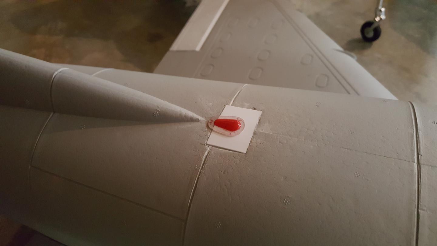

                                    • Here is a video of the finished lights
                                      and a picture of the top beacon. The lenses for the beacons are off of the FL P-38.
