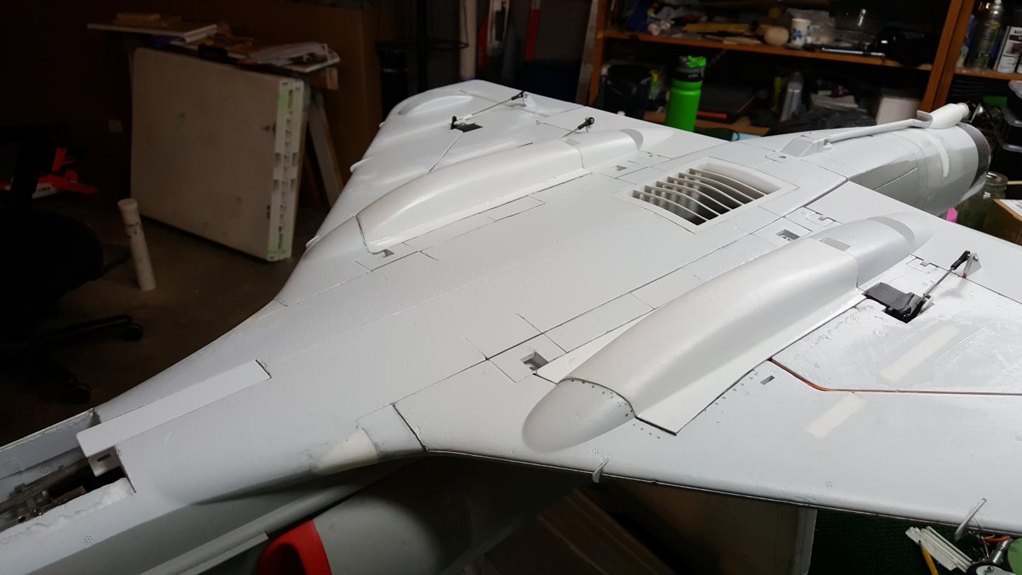

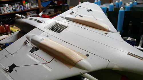

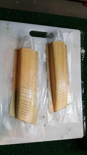

      And the second....I think it's time for bed. Thanks everyone.

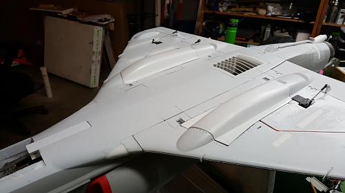

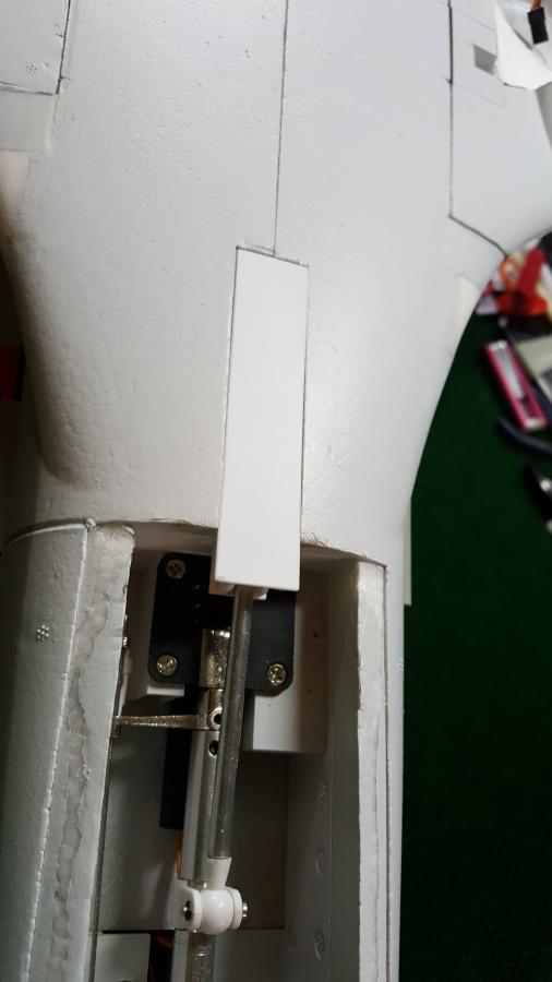

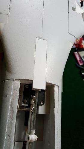

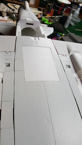

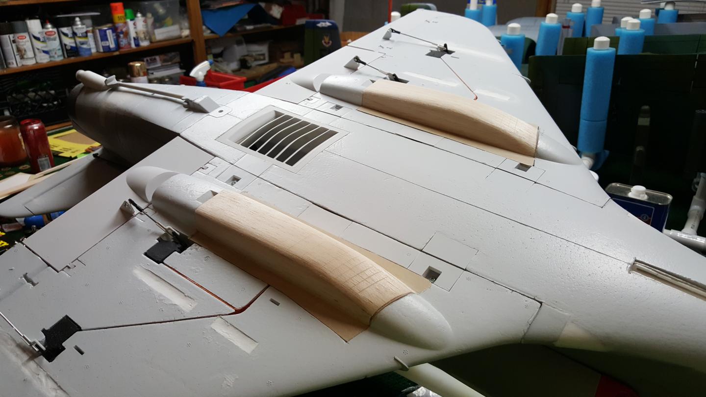

          The wheel covers are now fiberglassed.

            Aw geez Steve, now you’ve done it, now you’ll have to glass the whole airframe to match those beautiful wheel covers!! LOL
            I am seriously really enjoying this tutorial, you are a skilled modeler/craftsman!
            • #26
              Ha! Fat chance on glassing the whole thing. I am only mildly crazy... :Silly:

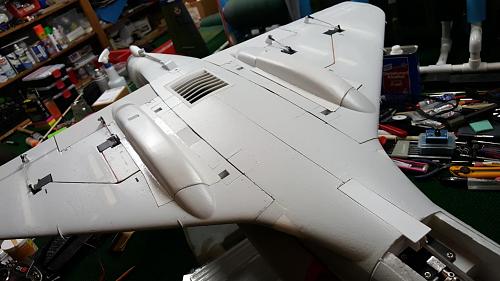

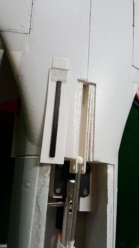

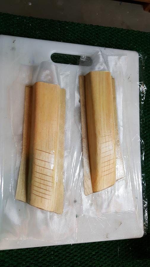

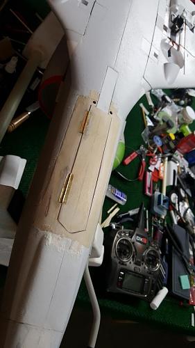

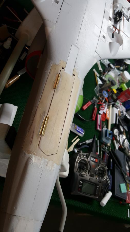

                  I got the first coat of primer on the wheel covers and started eye balling a nose gear door.

                  • #29
                    A quick video showing the action of the nose gear strut support and door. The actual nose gear door is up next.
                    • #30

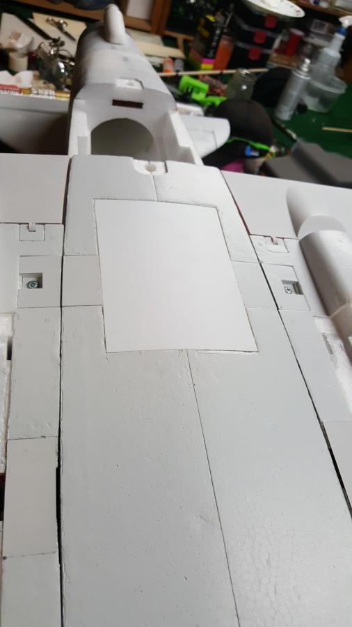

                      Looking at that clean bottom have you given any thought of going w/o the cheater hole for the totally scale look? Looks awesome Steve!
                      • #31
                        Yes I have thought about it and I am on the fence concerning it. Some have even gone as far as making a foam block to fill the opening to "improve" airflow into the fan but I question the benefit of that. I flew my other one at eWeek with the cheater taped over because I didn't want to suck up any freshly cut grass which was a real problem on many of our EDF's. It flew fine like that.
                        • #32
                          You say it flew fine, but did you notice any difference in how it flew? Is it slower to accelerate for example? Is the cheater is even necessary in your opinion? Debri injestion can ruin your day.
                          I can’t wait to see how you activate the gear doors. Are you going to use the spring method like the nose door on the FW Super Scorpion ?
                          • #33
                            To be honest I can't tell a difference covered vs. uncovered. There was a calculation done on FSA for the intakes and it was determined that the cheater is not really necessary. If for no other reason than to keep from sucking something up that would be enough to cover it. I think if flying off of grass it is a no-brainer to cover it. I will be attempting to use piano wire to both hold the doors open and help close them. My goal is to not add any servos to operate the doors. Right now I am just under 7 lbs. AUW but most of that is due to a heavier fan and ESC. The main gear covers are super lite. My Green Knights A-4 weighs 6.7 lbs. AUW with Bull Pups and the stock fan and I will be changing the ordnance on it have two MER's with 6 Mk. 82's each and two LAU-10/A rocket pods so the ultimate weight between the two will not be that different.

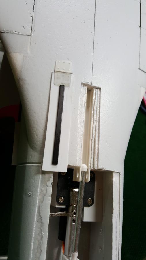

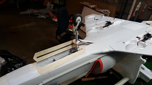

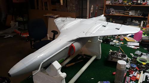

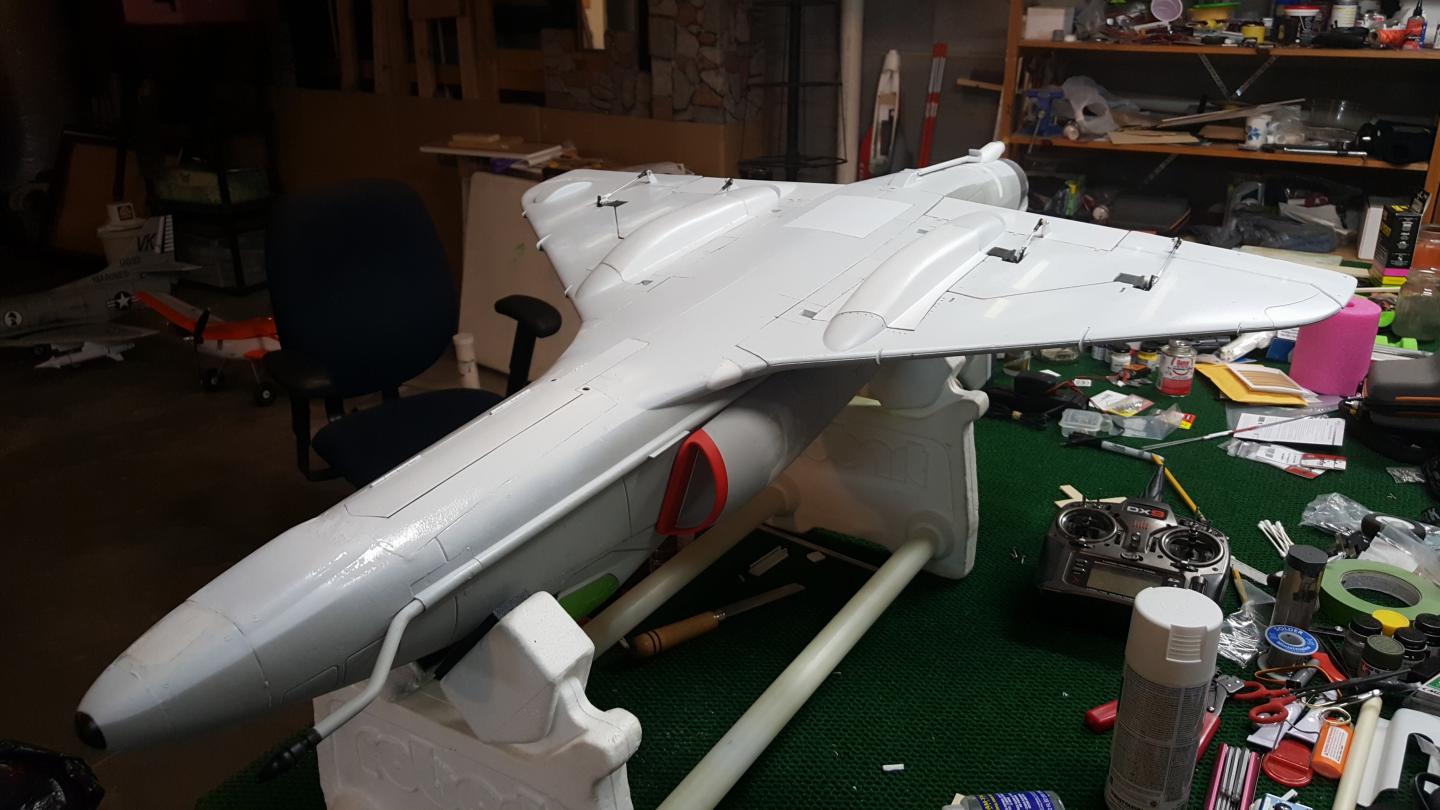

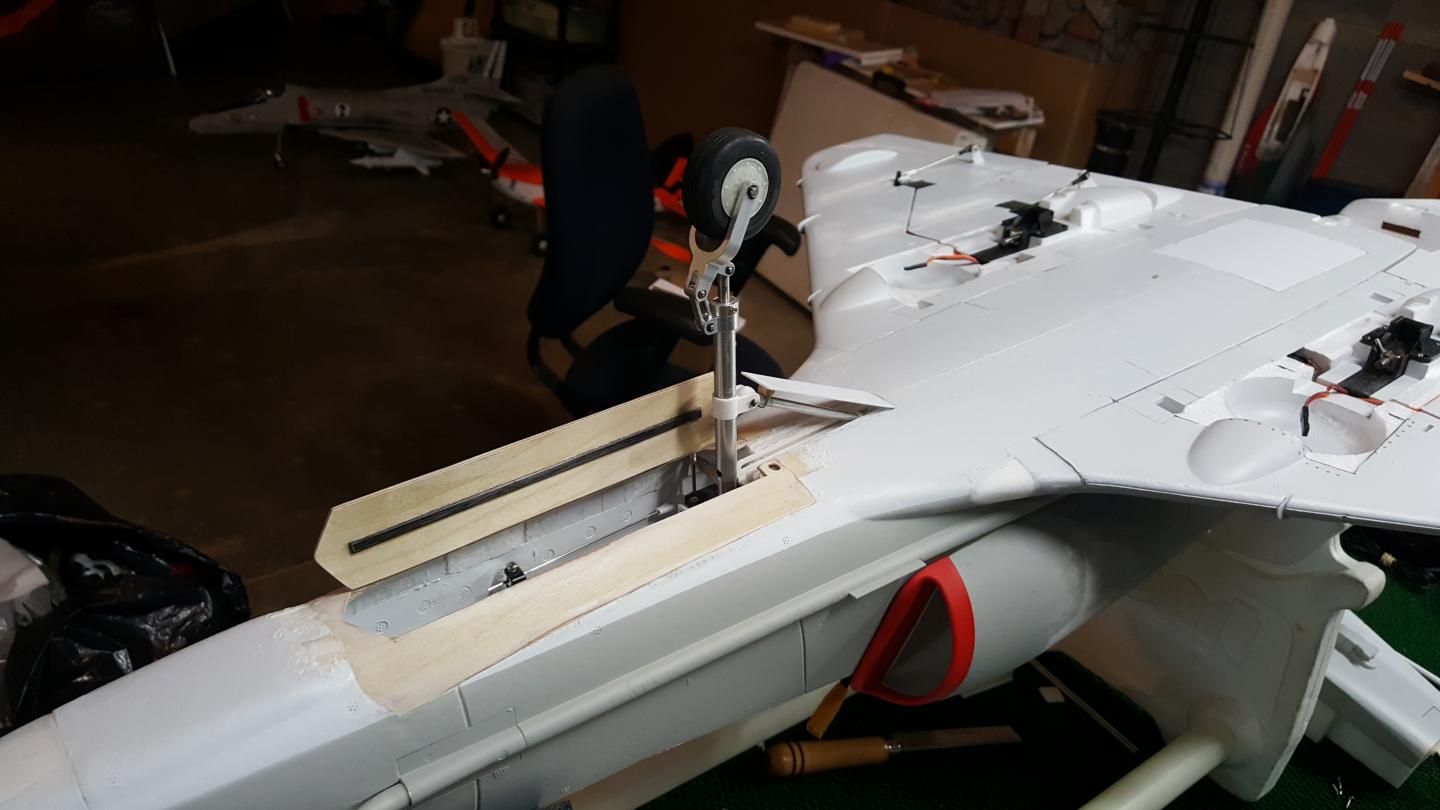

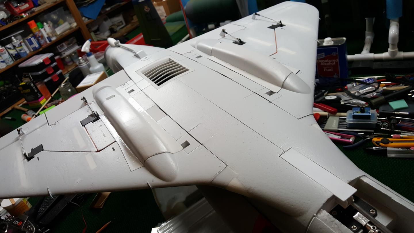

                                    I think smoke is out as cool as it might be. Here is tonight's update. I worked on the nose gear door. I used the plastic piece that came off it as a template for a replacement piece made from 1/32" plywood. I doubled it where the door is and added some CF strips to help keep it straight. I still have to install the closing mechanism but the basics are in place.
                                    Click image for larger version  Name:	20171012_005155.jpg Views:	1 Size:	89.7 KB ID:	100200
                                    Click image for larger version  Name:	20171012_005330.jpg Views:	1 Size:	51.9 KB ID:	100201
                                    I also went ahead and covered the cheater.
                                    Click image for larger version  Name:	20171012_005401.jpg Views:	1 Size:	38.2 KB ID:	100202
                                    I've always liked a clean bottom...

                                    • #38
                                      So how did you plane down the inset for the mains doors to get them flush with the wing surface? Looks amazing! My Skyhawk is still in the box, but this winter I’ll try to copy what you’ve done and maybe use the A-10 power system. I may also try to add slats, something you don’t need on your BA version since theirs were disabled, so they wouldn’t deploy at inopportune close formation moments!
                                      • #39
                                        I would use an Xacto knife as flat as I could get it or a blade by itself maybe even held with a pair of needle nose pliers. I also use the long blades from a utility knife. The kind where you can snap off sections of the blade to keep it sharp. The wider blade helps make the cut more consistent. Just whatever works.
