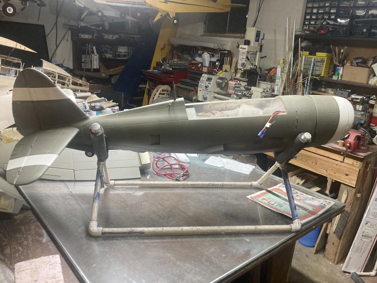

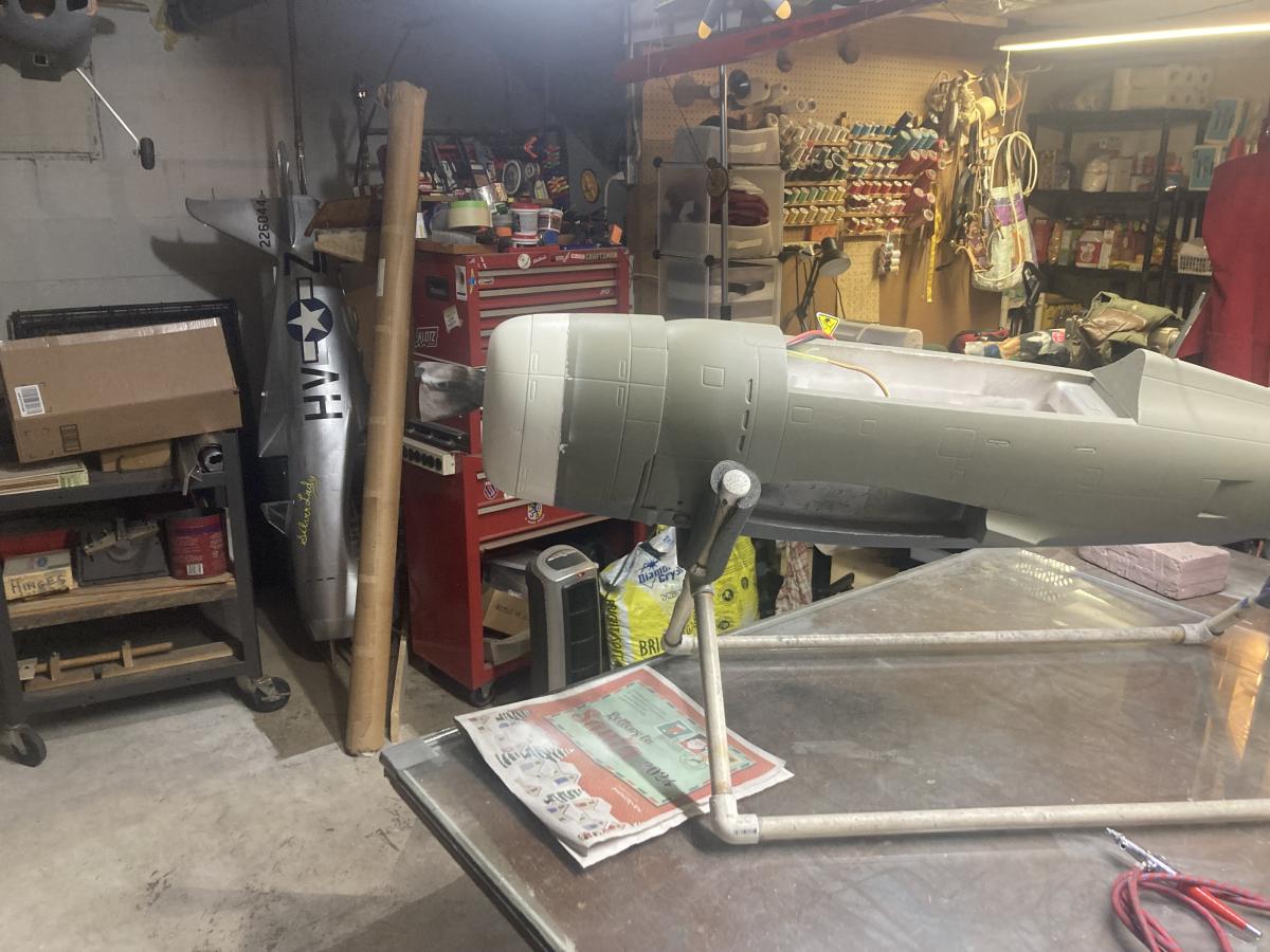

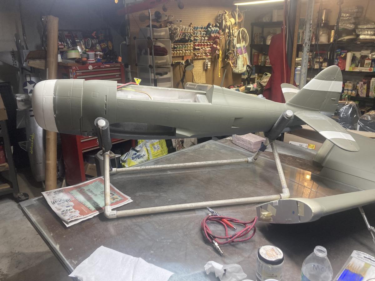

    Hi Rex: I think it is probably a judgement call on your part how you find it looks to you, the builder. That's the only one who really counts. I'm happy with the way my models came out the way I did them with a constant one inch stripe on the front of the foam fuselage, and painting All of the plastic cowl piece on the forward end. There's no getting around the angled plastic cowl piece due to the necessity that they work in the right or down thrust to make a model airplane fly properly. With that required design part for model flying, you can't possibly have a uniform scaled down 24 inch cowl stripe as the real airplanes had. We just have to do the best we can with what we have to work with.
    I haven't printed up the improved Elbee Corsair prop hub. I'm not all that familiar with it and have just have used the OEM hub for the past 5+ years that I have had this airplane. I'm not averse to looking into the idea of using it, it just hasn't been on my "radar" up to this point.

    Hi Rex: I just looked at one of my airplanes, I Wanted Wings. I made a cowl stripe of a constant one (1) inch around the front of the fuselage, going backwards from where the plastic nose cowl mounts onto the airplane. I painted all the plastic nose cowl red (or white, per the particular airplane). One issue I guess, for me is that the plastic nose cowl piece angles quite a bit to allow the prop and motor to have the proper right thrust for these model airplanes to fly properly. Obviously, the real planes did not have this. That might account for the perception that from some angles the cowl stripe with that plastic cowl piece attached looks too wide? Not sure. From your photos, it seems about right to me and looking at my planes that I have painted up similarly.
    For these planes, I have found using a constant one (1) inch cowl stripe starting just aft of where the the plastic cowl piece fits on the fuse and then painting the entire plastic nose cowl piece red or white, seems to me to be a good compromise for the angled plastic cowl piece for right thrust considerations. It might be just a bit wonky due to this, but either I have gotten used to it, or it looks fine like that, to me.
    The tail stripes look good to me from what I can see in the pictures.

    Today I sprayed the white stripes and it came out great. I have some touch- up/over spray to fix.
    I used the measurements and scaled to 1 1/2" but the cowl stripe looks too wide, 3" for scale size. What do you guys think
