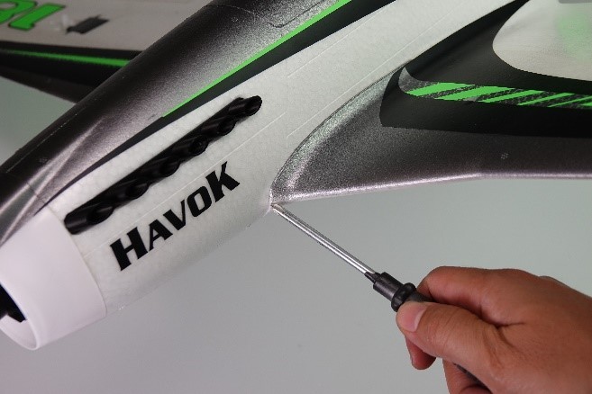

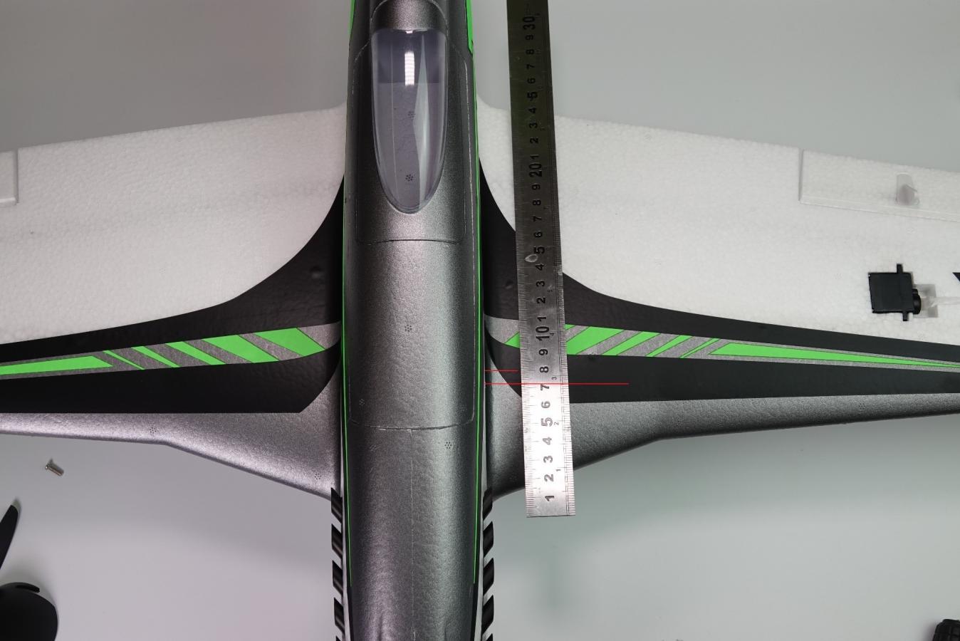

      Can someone please tell me what the CG is on the Havok please! Lol. I have mine sitting here ready to go and have no idea what the CG on this thing is. I have all different types of batteries and all and my model didn’t come with a manual unfortunately. I called and the tech told me that the entire first run of these planes did not go out with manuals. I can’t even download one from the website either. I don’t see a link on there or anything like that. Someone please help me. I would truly appreciate it big time. Or if maybe someone can email me one my email address is kydfrost@aol.com. Thx!
      Hey man, manual is coming to the website tomorrow. Sorry for the delay:
      "Position your battery in the battery tray and balance the model inverted so that the model balances between 73mm to 78mm aft of the leading edge of the main wing root, defined as the forwardmost part where the main wing piece attaches to the side of the fuselage."

      This position is identified in the image below, at the tip of the screwdriver. Measure 73mm to 78mm aft of this point.

        Awesome! Thank you so much James. I really appreciate that.
