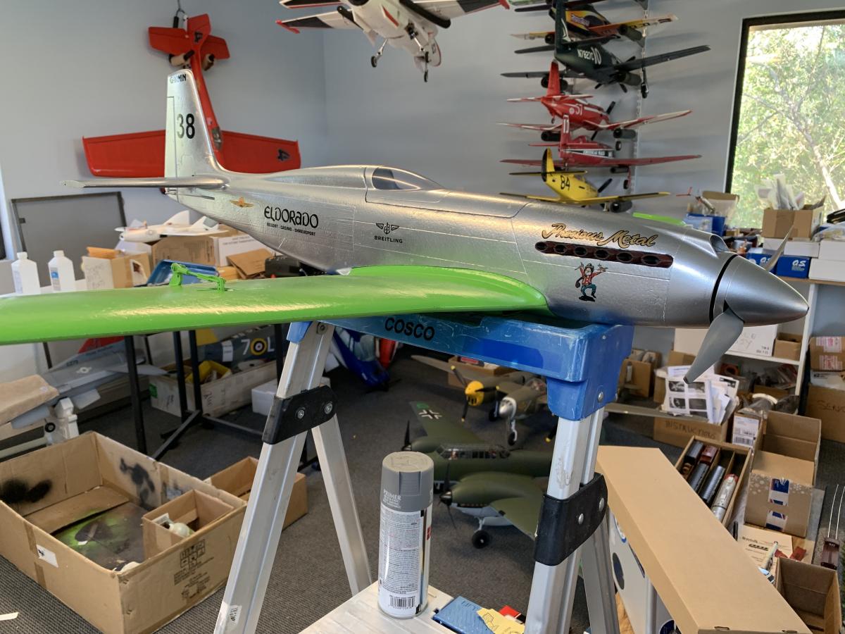

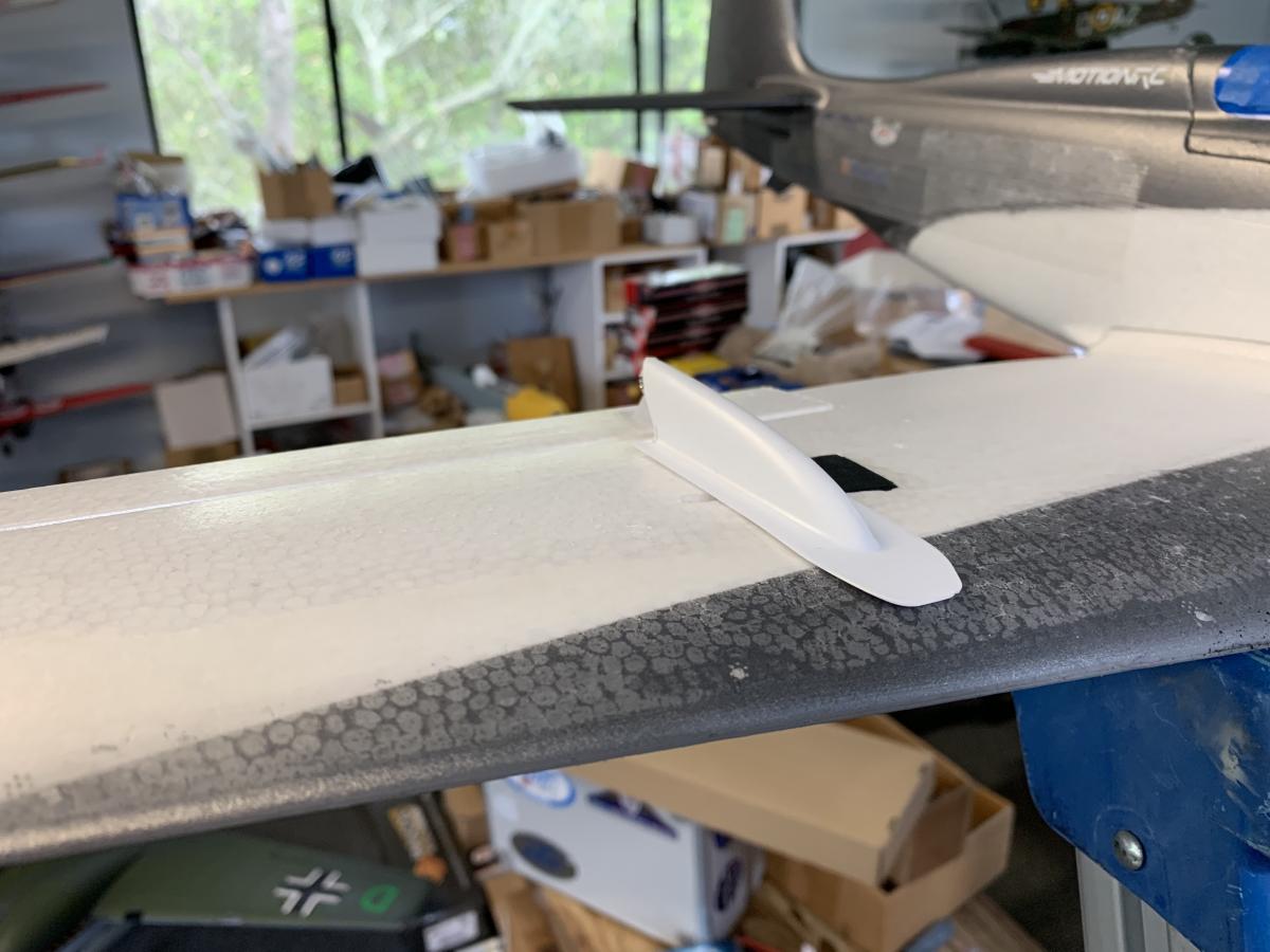

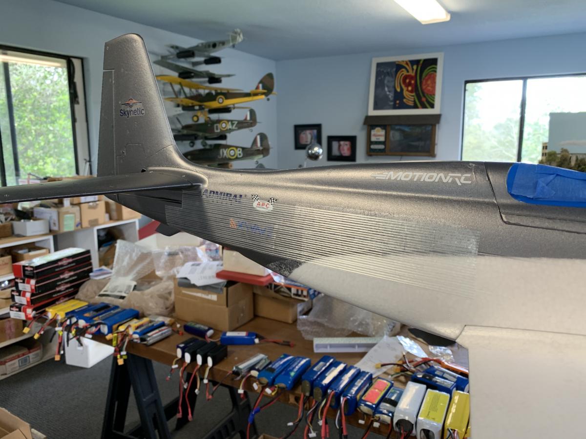

              After a long delay the repaint starts. I used strapping tape to stiffen up the fuse. My favorite quick and dirty fix for sloppy foam. I have squared the fuse to the wing as best as I could. I don’t think I’m going to use the aileron linkage fairings.

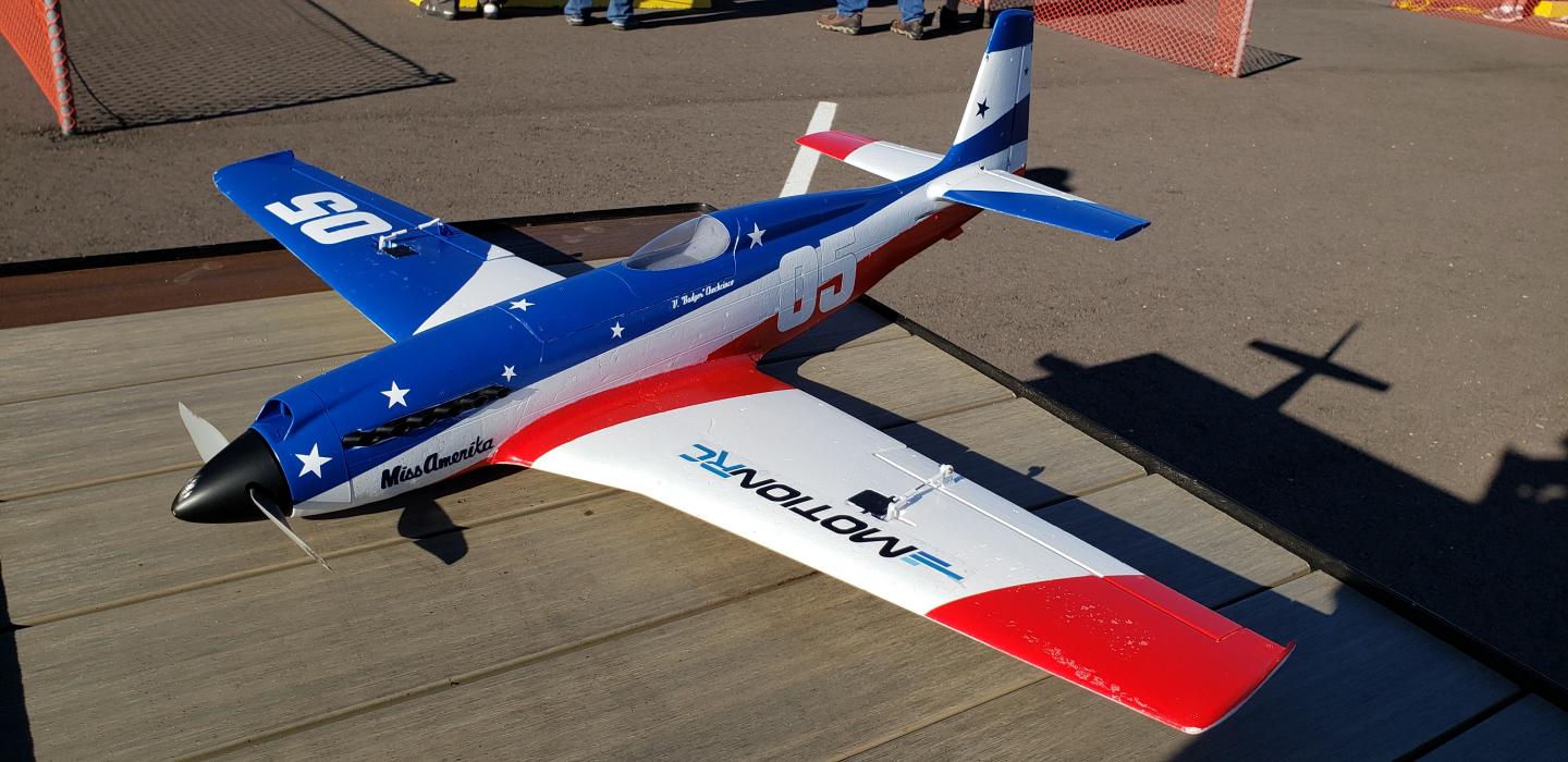

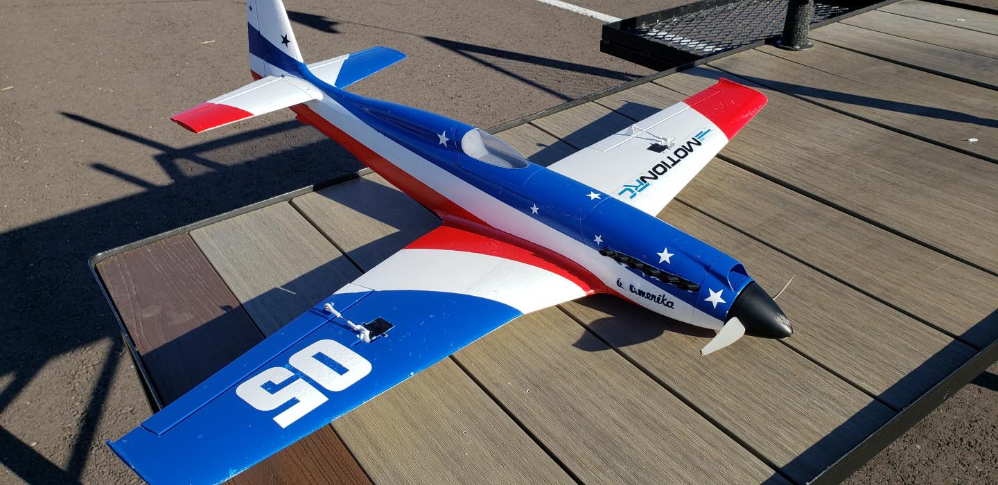

                Speaking of repaints, can't believe I haven't posted pics of my finished "Miss AmeriKa" scheme!
                Real simple to do with Rustoleum 2X paint.
                The white does tend to peel a little easier than usual so I chose to mask those areas with post-it notes where I could (instead of masking tape).
                Decals by none other than Callie Graphics!
                Cheers!
                Vic

                  #148
                  Great job AMK! Real eye-catcher there!

                    Has to be when it's moving that fast!
                    The Havok has quickly become one of my favorite birds. It's so locked in and pleasantly predictable, even at full blast!

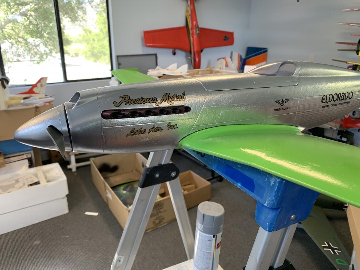

                                #155
                                I have waited a week for the silver to dry before putting
                                Callie’s stickers on.

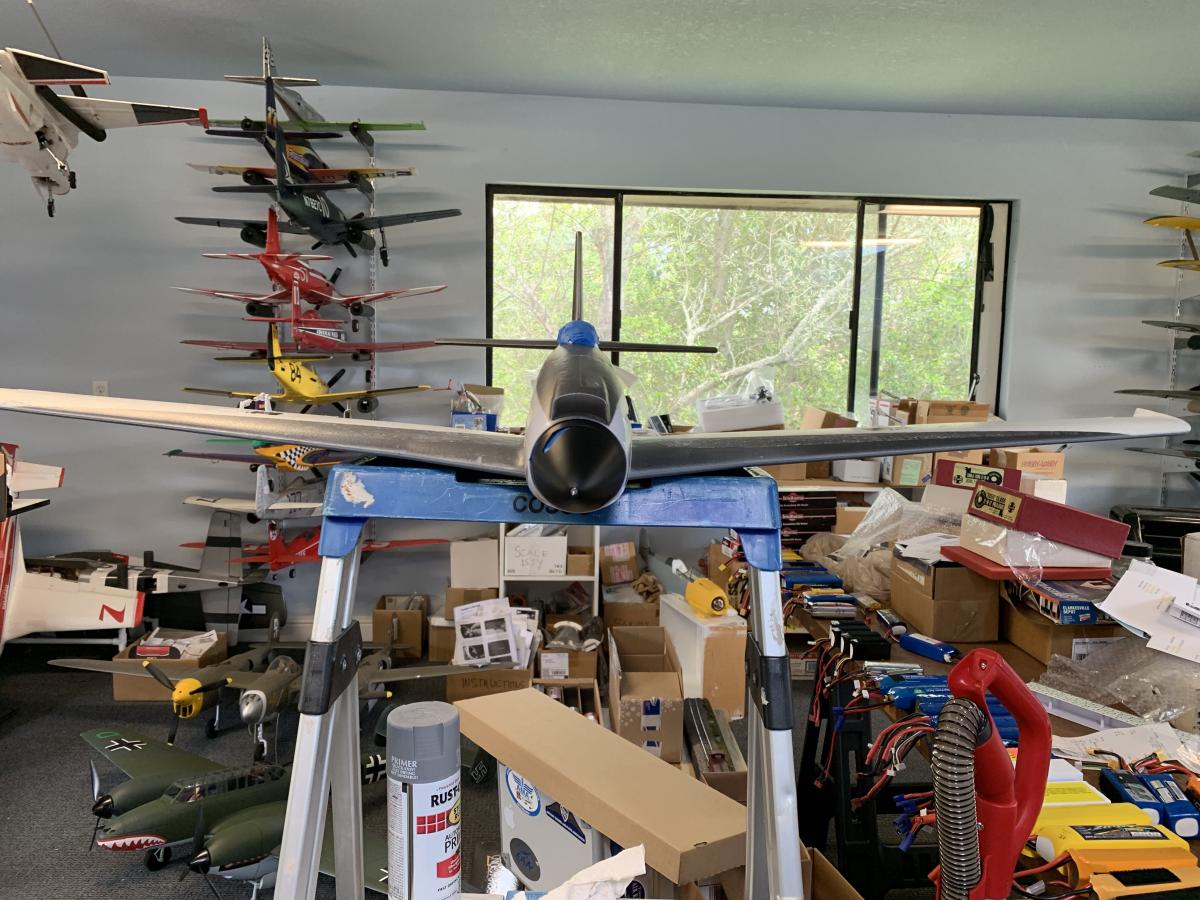

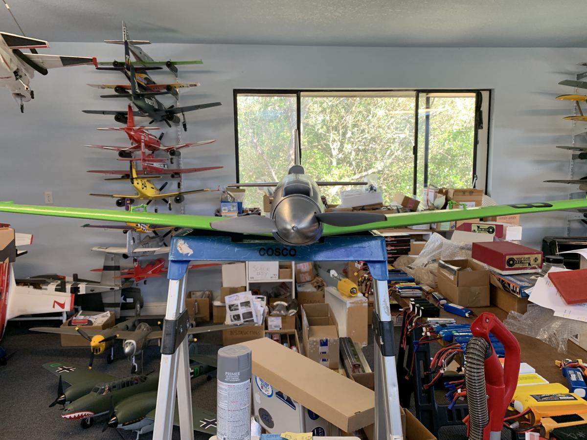

                                  #156
                                  I didn’t get the fuse perfectly aligned with the wing but I was able to get it to sit straighter. Here’s two pics for comparison. Should have taken off the prop for the pic. May help out with the left roll at high airspeed.
