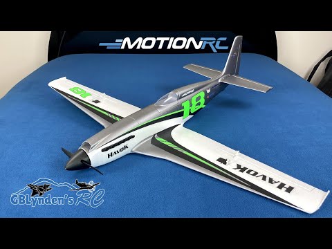

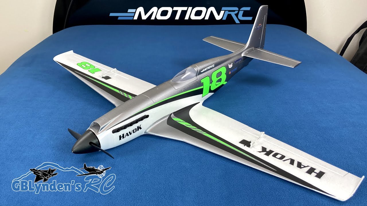

                      • This is my Skynetic Havok Racer 1000mm PNP Unboxing & Review.

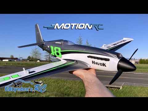

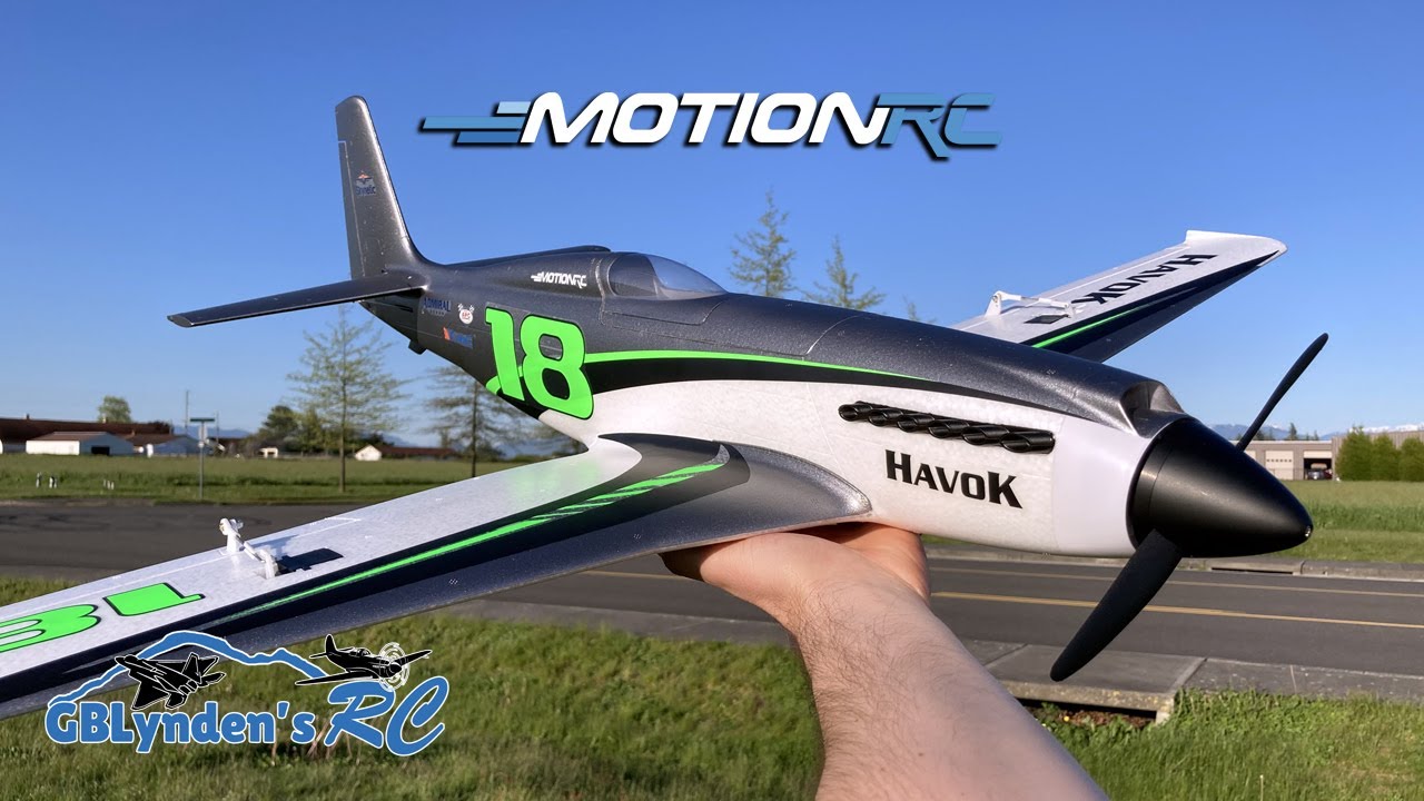

                        • Check out my maiden flight review! More pictures to come as well
                          • Nice work! This thing is super fun!
                            • Thank you and it really is super fun!
                              • Nice job GBLynden ! Man, that looks like the kind of runway and open space I am looking for to fly my HSD F-16. You're not a stone's throw away but I could be talked into a nice weekend drive here in the next month or two, hint, hint.
