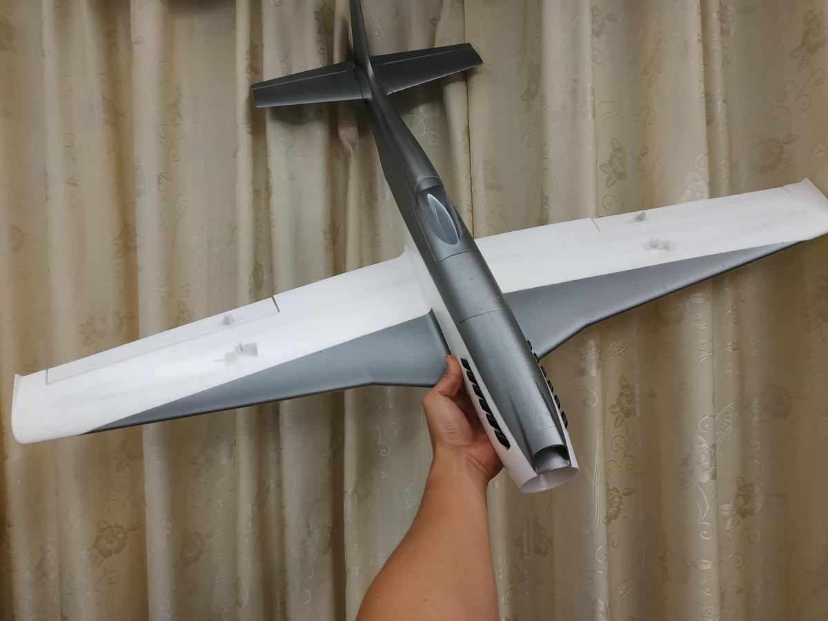

        Thanks, Flygirl ! I'm glad you think so. Based on early figures, it seems many others do, as well, so we're doubly excited for what we've got on the horizon as we expand the Skynetic lineup. We're not content to just be the scale warbird or scale jet company, and we recognize that our global customer family expects us to be more than that while keeping the same level of quality, spare parts, and service support.

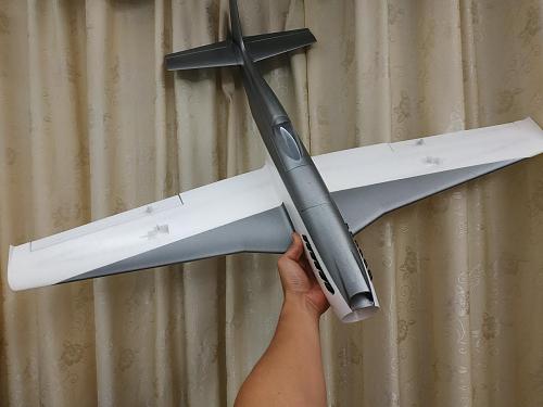

        In the meantime, back to my custom Havok repaint... I'm starting with the bare graphite and white... any ideas?

          Paint the white areas on the wing that hot neon green!

              Edge the silver and white with black or red striping tape. Awesome Alpha! And thanks for the reply. :)

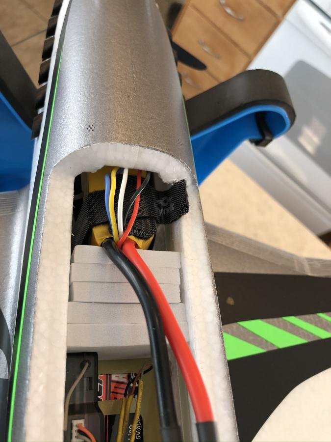

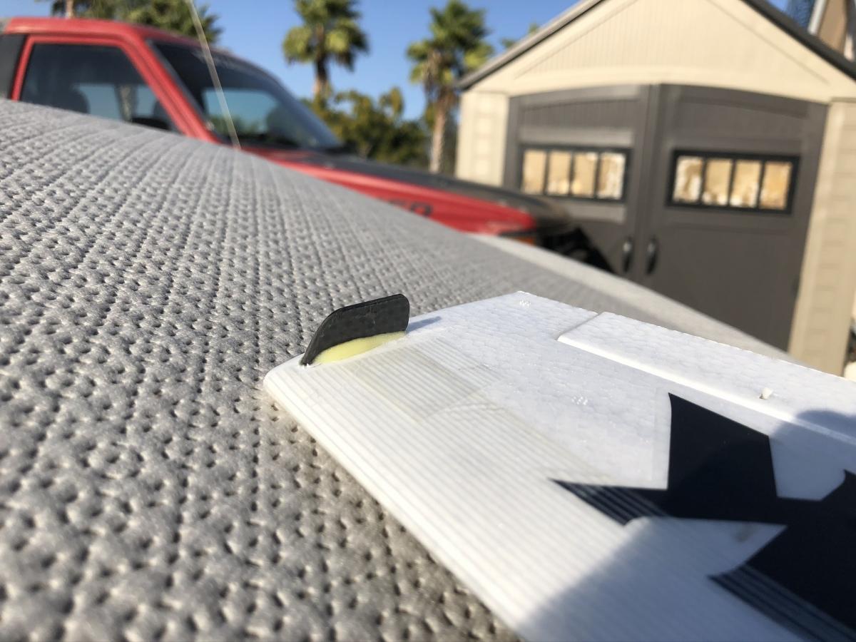

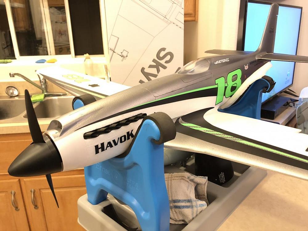

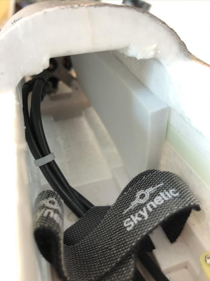

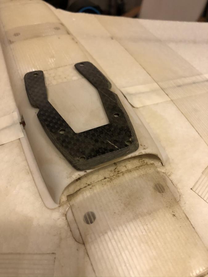

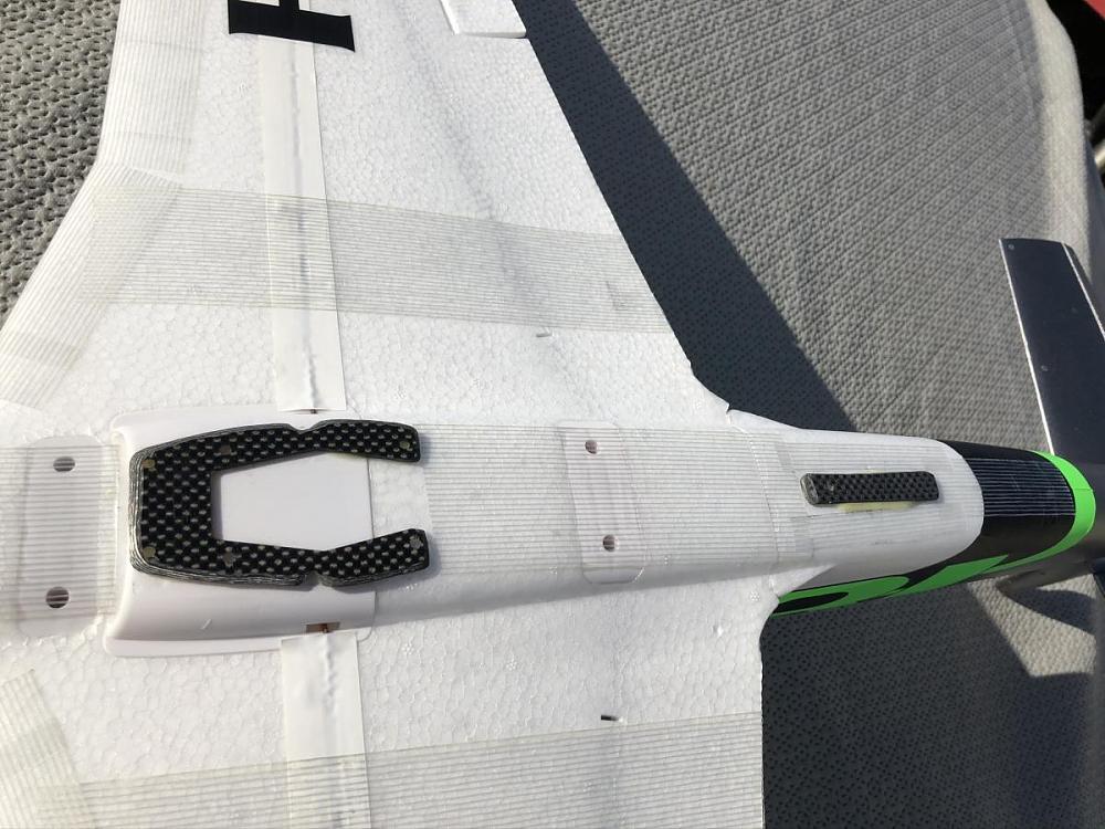

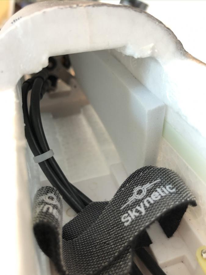

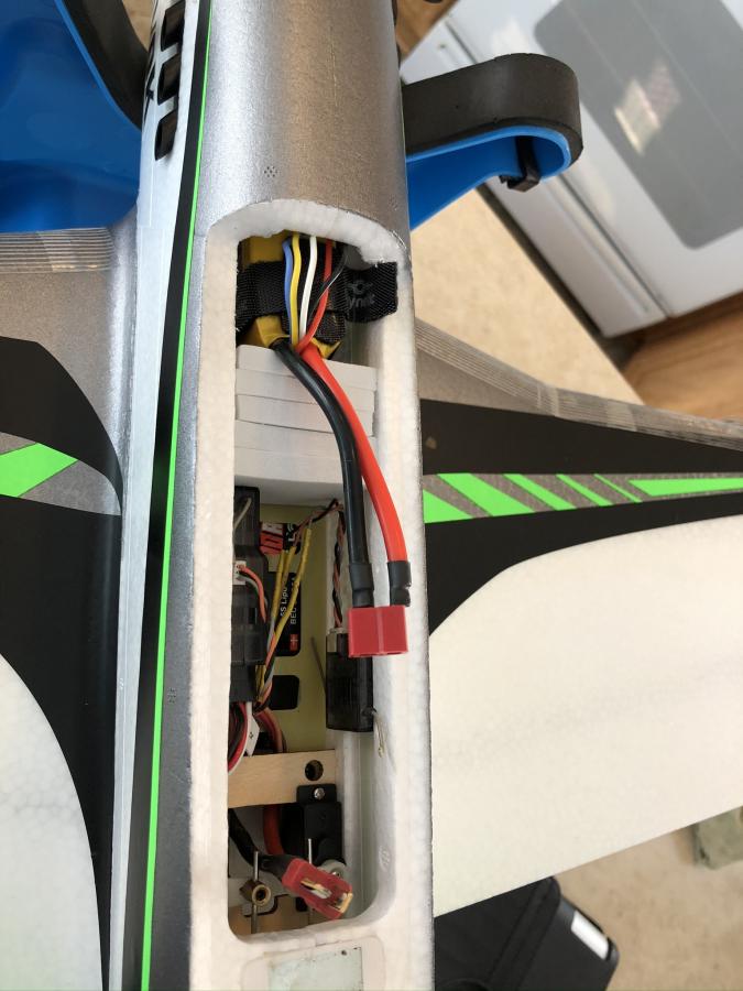

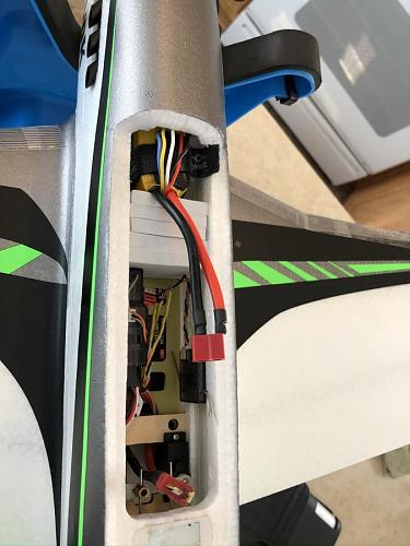

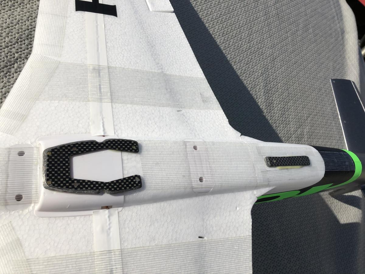

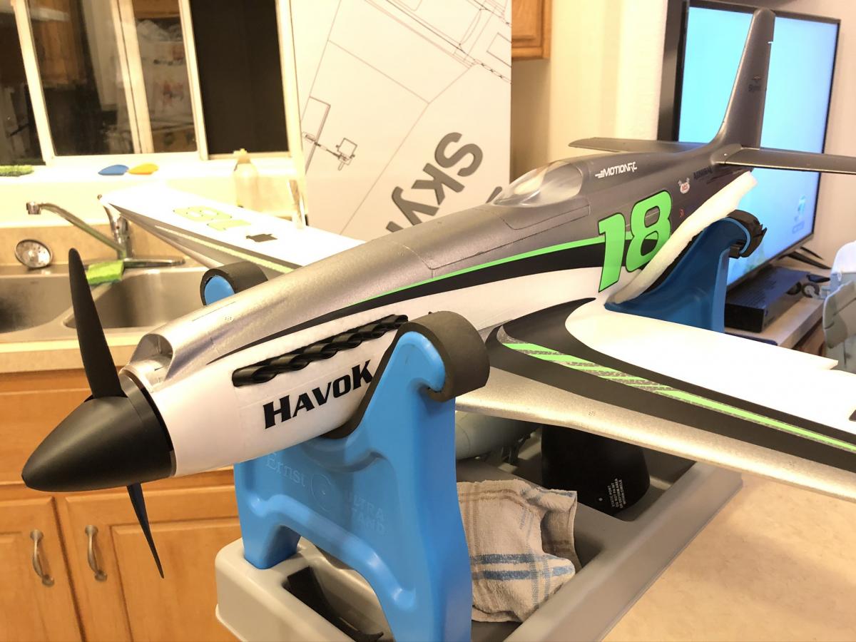

                To sum it up quickly: It flies just as good as it looks! The price is right, it's easy to setup, it's FAST, and it handles very well. You don't need to be an advanced flyer to handle this rocket but do hold on! :zap: :stuck_out_tongue_wi
                I'm flying off a dirt strip with some rocks so I epoxied on some carbon fiber skid plates on the belly, added wing tip skids, and used strapping-tape to help protect the belly better for landing. I flew it using an old AR7000 receiver, no gyro, and a Zippy 2700mah 4S pack. I used 35% expo on all surfaces and set hi/low rates per the book. I used James' CG setting of 75mm. With the 317g Zippy 2700mah I was able to meet CG easily with it shoved all the way forward. I used some spare dense foam against one side of the fuse and a foam block behind it help secure it. I put a Deans on the ESC and statically ran it up with the AMP meter which showed 56-58amps. It felt a tad heavy so I used 3/4 throttle for the hand launch and it leaped right out of my hand with ease. I only touched full throttle a few times and WOW it's fast on the top-end and it sounds awesome! Crisp and snappy handling on low rates. For landing I was able to bring it in low and flat bleeding off some energy for a nice controlled crash at a reasonable speed. I came in very conservatively at 3min 30sec and my pack showed 4.01V per cell.
                Below is a video link to my maiden flight experience. Can't wait to explore the flight envelope more and get some GPS speed numbers on it as well!
