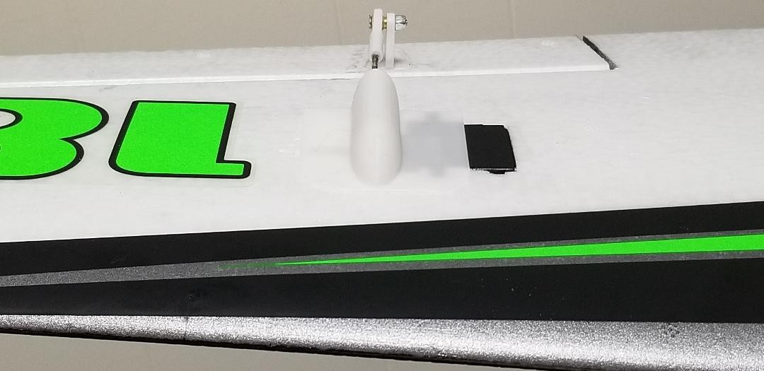

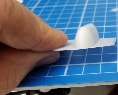

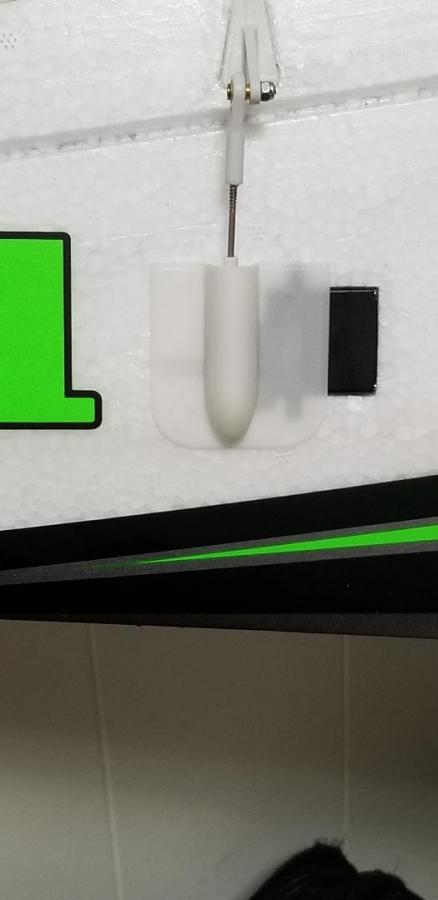

      • Weather wasn't good for flying today , So I designed some servo control arm covers. Turned out pretty good... I will have to check all the clearances Monday to see if they really came out with enough room.
        Printed in Esun PLA+, 100% infill, .2 layer height.

          They look awesome TaSaJaRa! Can you extend the sides so they fully cover the black on the servo?
          • Originally posted by James View Post
            Thanks....

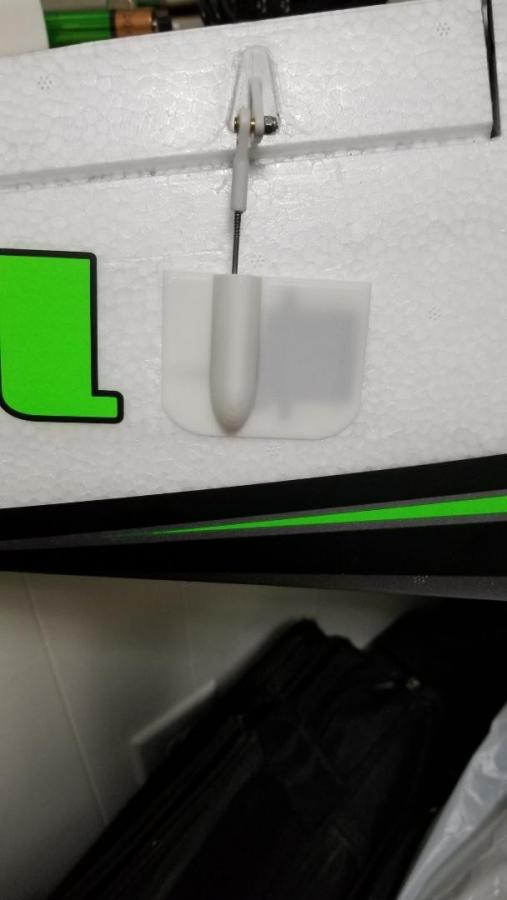

            Sure I can adjust it a bit...Printing the 3rd design now. Made the crown slightly thicker and added 11mm to width...With a thicker center you will need a support
            Will see how it turns out this time.

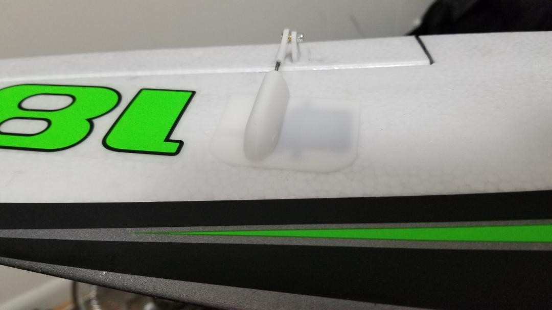

            • Well got them printed, turned out pretty good. I will put them on Thingiverse if anyone would like to try them out.
              I think I will use this Scotch Double Sided tape, it seems strong enough and it is very thin.(PIC Below)
              You cave get the covers HERE: https://www.thingiverse.com/thing:4084704

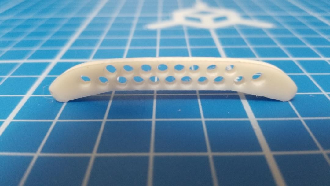

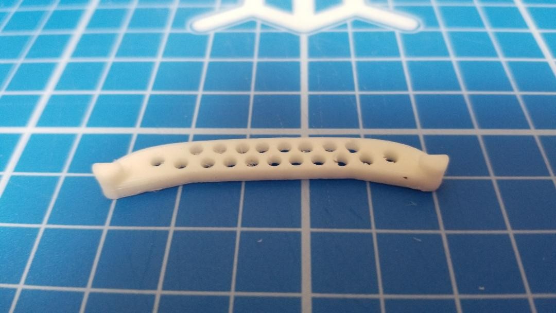

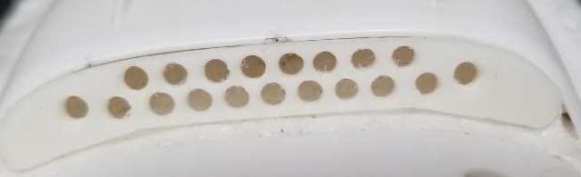

                        • Well had a no fly weekend again AAARRRGGHHH !!! So did a little more playing on TinkerCad.
                          I have been bothered by all the dead grass my Havok scoops up with the Lower Air Duct on ever landing. Darn thing acts like a shovel where I fly.
                          Always having to shake or rake it back out.
                          I designed a Duct Shield/Screen. It should still let plenty of air through, but not the grass.
                          Still need to clean up the holes a little more... The design will use one spot off CA to hold in place on the center bottom of the duct.
                          Have not got a chance to fly with it yet, but looks promising...
