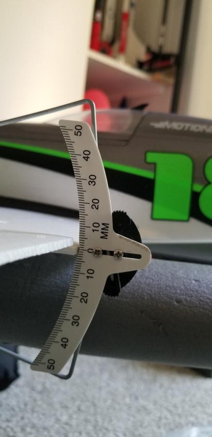

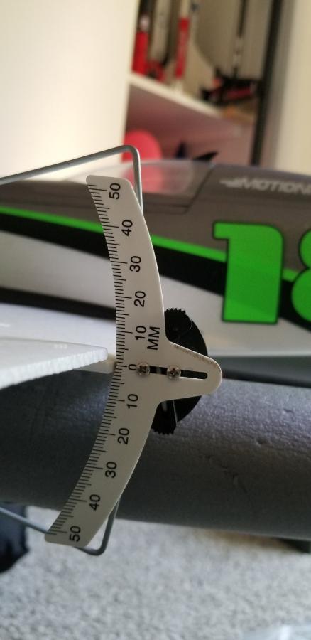

        air break landing mix,both ale-4mm up, I will add even more for the next flight, lifts the nose and slows her down for landing. Highly recommended
        Click image for larger version  Name:	20200602_175938_resized.jpg Views:	0 Size:	35.5 KB ID:	258363

          That looks like a really beautiful plane
