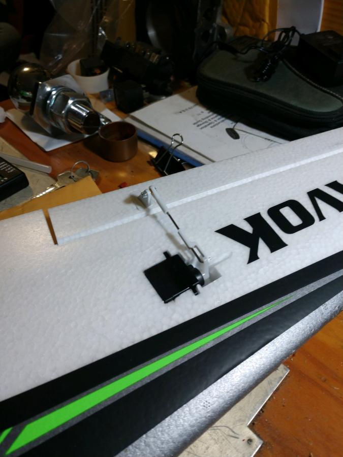

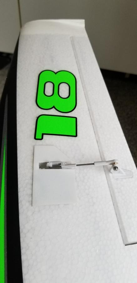

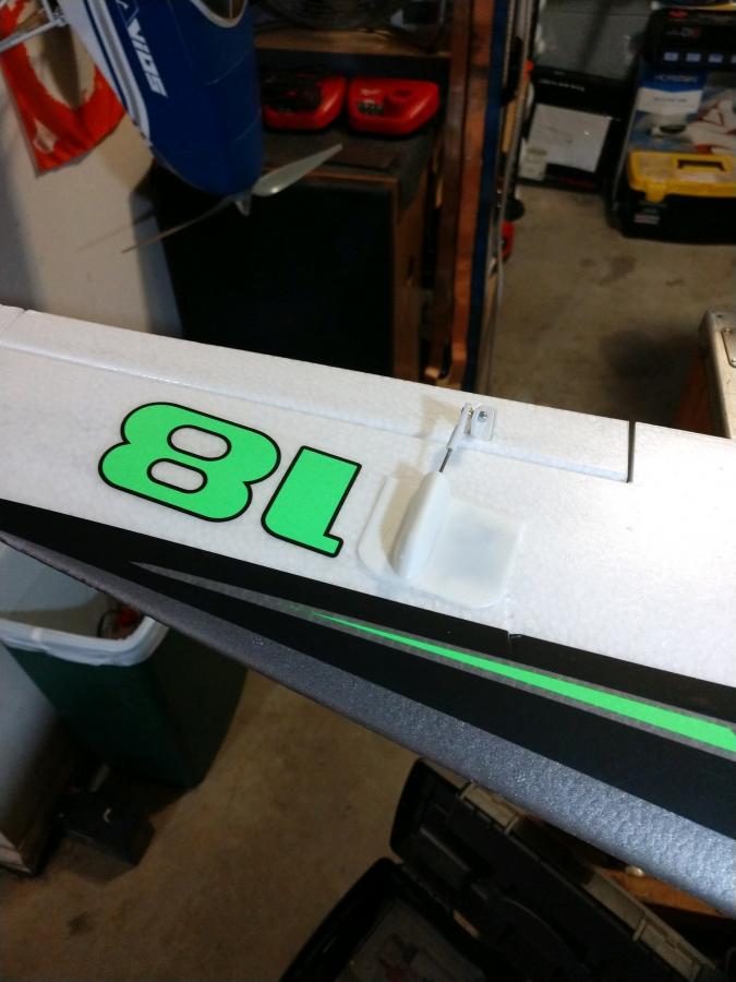

          UPDATE: To my Servo Covers design...
          I made V3 of servo cover. I didn't like how thin the transition is between
          the mount plate and arched tunnel. (May Crack if you don't get great bonding at this point)
          So I added beveled filler at this point making it a much stronger joint.
          Havok_servo_Cover_V3_Right.stl
          Havok_servo_Cover_V3_Left.stl

                YES... 100% the base plate and sides are so thin they need to be solid.

                              my daughter printing the servo covers at school for me, thanks for posting them

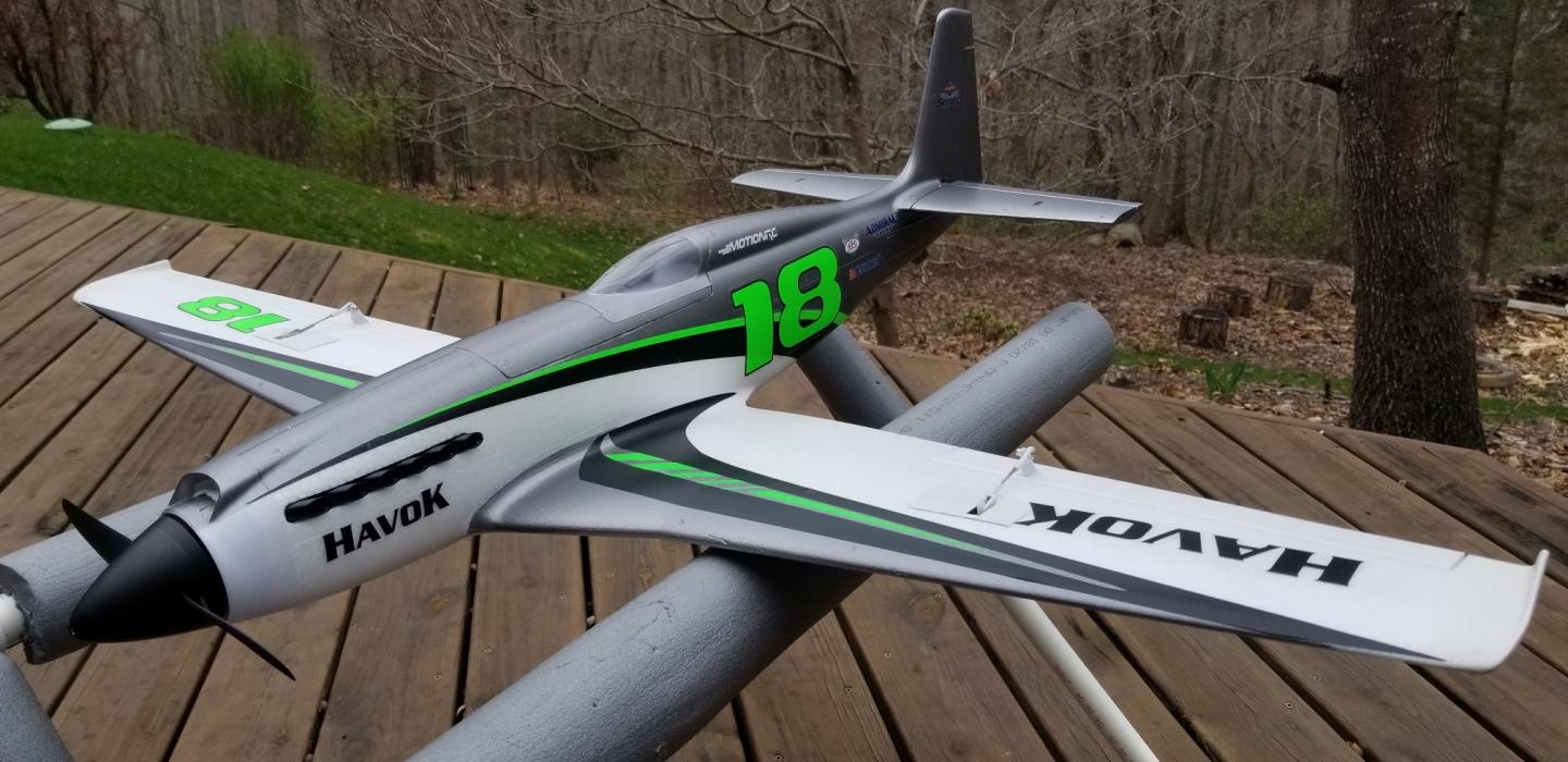

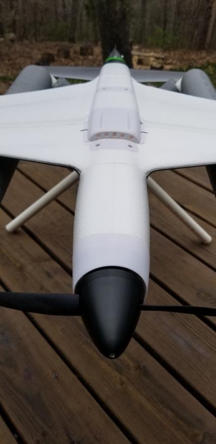

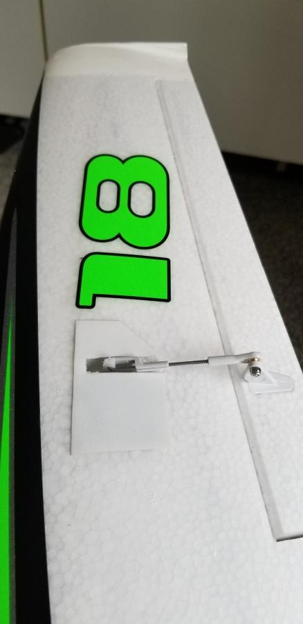

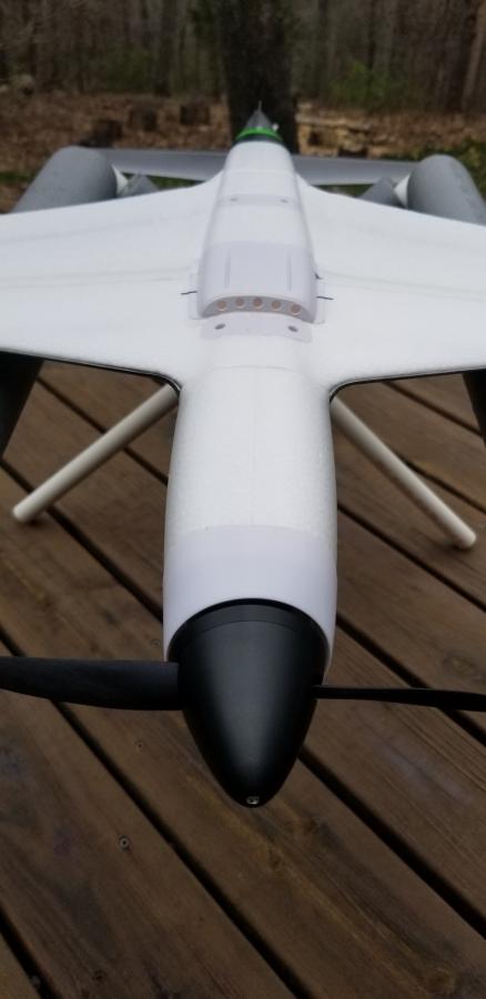

                                      She is ready. A little chubby on the # so went with the 2700 tp, fits well, I have a few larger packs that fit and balance ok, will go light for the first flight. Glassed the wing tips, made servo covers and and a lower intake cover to limit the grass intake. I gave her 3 coats of the varithane exterior urethane , this helps keep the unpainted foam clean and really blends the decals in, gives everything a uniformed sheen. Have a up trim launch mode set, likely will add a little rt ale. Click image for larger version

                                        Maiden complete today !
                                        The launch was well, ugly, crazy torque roll, did video and it was nearly inverted 2 sec after it left my hand
                                        Anyway cleaned my shorts and found no additional surprises, took quite a bit of down trim, inverted took a push down to hold level . She tracks really well and the speed is pretty good even with the stock prop. I made a landing mix /air-break both ale's up 2mm, really worked well to pick the nose up and slow her down a bit. 5 min and still came down with 3.9v/cell.
                                        so for next flight
                                        -moved cg back 3mm to 78
                                        -added 2mm up to my air-break mix
                                        -added 3mm rt ale trim to launch mix
                                        Just needs the tuning, she looks like a winner to me so far.
