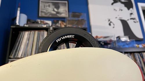

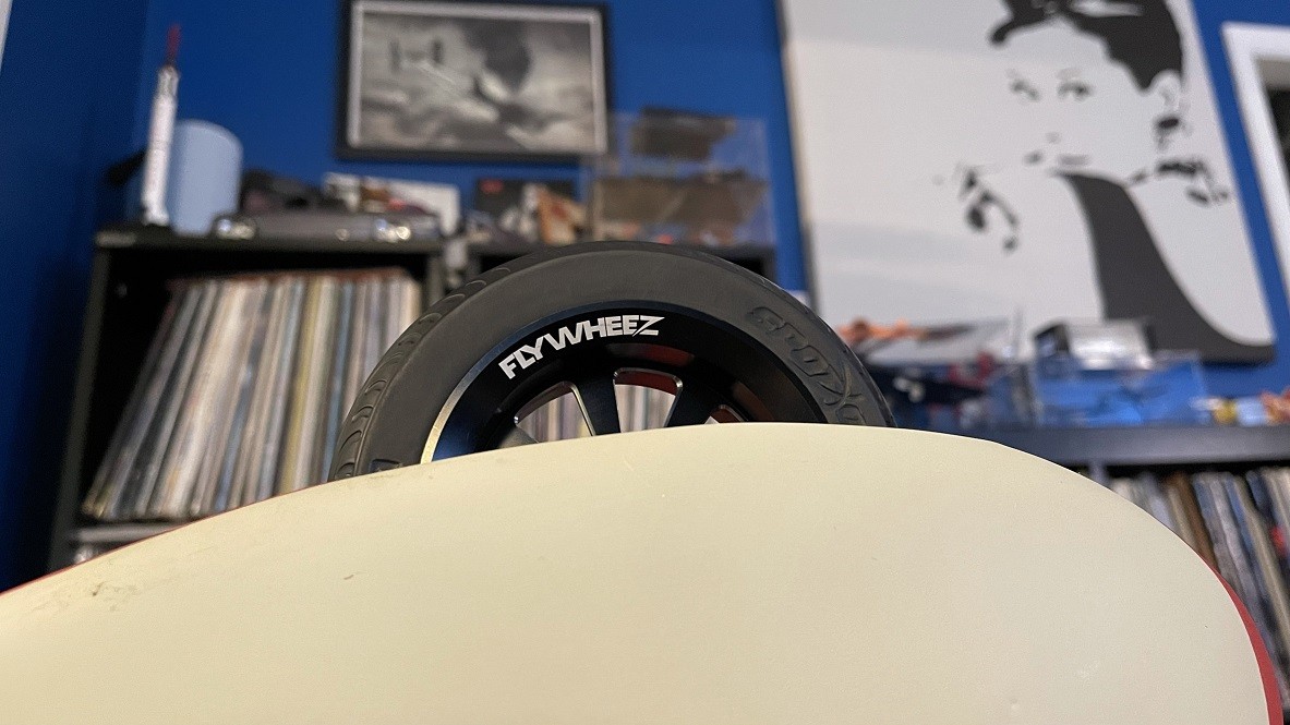

        I found these Fly Wheelz that I think will work perfect for the 44. Thinner, slightly more bounce (not much) and comes with a spare set of rubber.

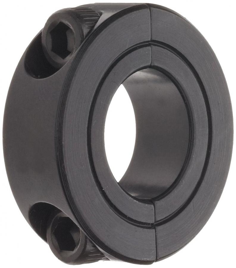

        I've also switched to some clamp-on collars for in-between the LG and the wheel. (instead of a nut or locknut)

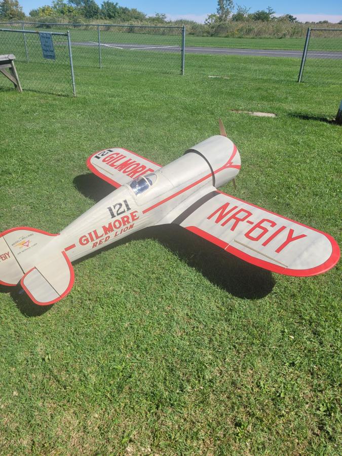

          Just a little teaser:

            Those wheels look REAL nice. Hope they perform as well as they look, please keep us posted.
            I’d like to get a couple of those split collars. Would you kindly share a link to your source and any additional details? The supplied screw used as the wheel axel is 6mm if memory serves correct. What size collar did you select?

              A real teaser indeed. Beautiful model being handled well.

                Thank you! The thing about those wheels is that they're pretty gawky...however with most of them inside the pants...it's not that big of an issue. I went with black so they would be less noticeable.
                About the collars...I had some 1/4 inch ID on hand...which is slightly larger than 6mm but they still clamp on real tight. (tight enough for me to be comfortable) If for some reason they slip, they have metric ones as well.
                I get these from McMaster-Carr: https://www.mcmaster.com/catalog/6436K12
                Looks like collars like these are available other places as well. (Home Depot, Amazon, etc etc)

                  #448
                  Interesting clamp collar. Thanks for the link.
                    I’ve placed an order for 2 each in 1/4” and 3/16”.

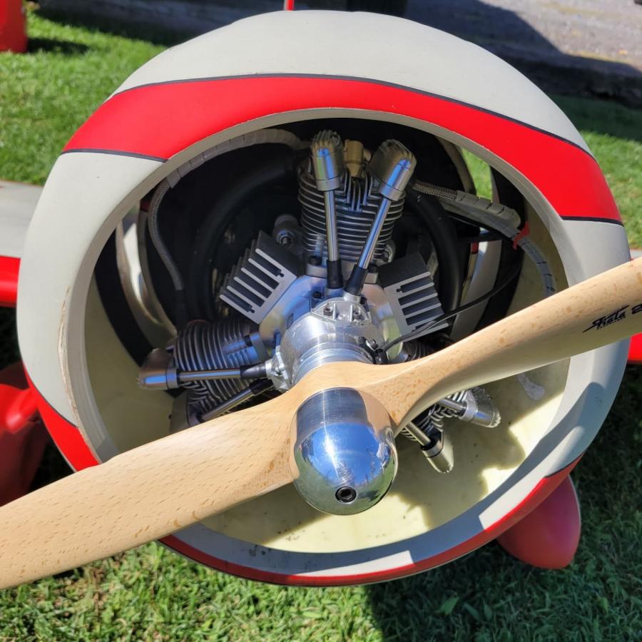

                        She flies!! Finally got everything together, ran out of excuses, got control of my shaky knees, fired up the Saito engine and off she went.

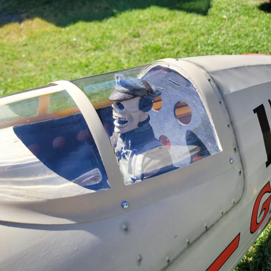

                                    Just absolutely fantastic RCBobP !!!! I love the Gilmore with the saito radial!!! It's defiantly the pride and joy of my hangar!! I'm really liking your Pilot!!! I need to get rid of the stock pilot and get something cool in there like you did.
