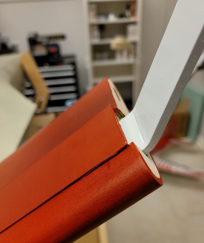

Alright, back at it! Wings are all done, epoxied, servos installed, push rods installed, etc. Next up was installing the landing gear. Regarding the thin plate that goes on the back side of the fairing- I understand it doesn't need to be glued in place, because it will be held in place by the shoulder at the top and the wheel pants at the bottom. Still, I'm having a heck of a time getting one of them to fit. Anyone else have to trim their's? Looks like I'll need to trim out some of the fairing itself at the top and bottom to get it to fit height-wise. Might still need to trim back some of the piece itself to fit side to side. No big deal, but was wondering if others had the issue.
Next question- the parts list show the push rod for the rudder to be 109 mm, and the push rod for the elevators to be 103 mm. But if the servos are mounted under the canopy, they need to be the long push rods that came in the box. Is the manual mistaken or am I?
Thanks!
RCBobP The manual stated pushrod length unit of measurement is wrong. They should be centimeters(cm), not millimeters(mm).
My thin strut covers were a tight fit, but were okay. I did tack them in place with a thin bead of Foam-Tac for the length of the cover. The reasoning was to prevent them from becoming loose or fluttering. Using a thin bead will allow for easy removal in the future if need be.
Thanks for the note about push rods. I was getting paranoid that I had misplaced them, and then was just getting confused because the elevator and rudder servos were mounted under the canopy, so how could they be that short. That's a major boo-boo that you'd think the manual would have been updated for.
