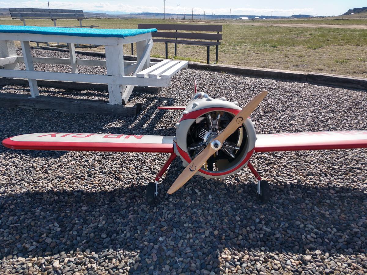

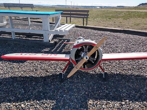

      DaleD I am not running any baffles in my cowl. It's is wide open with the Saito FG-90 sitting there. I've checked temps repeatedly on multiple flights immediately after landing and head temps are anywhere between 165-185 at peak. I have had no issues with temps or anything just running the cowl and no baffles.

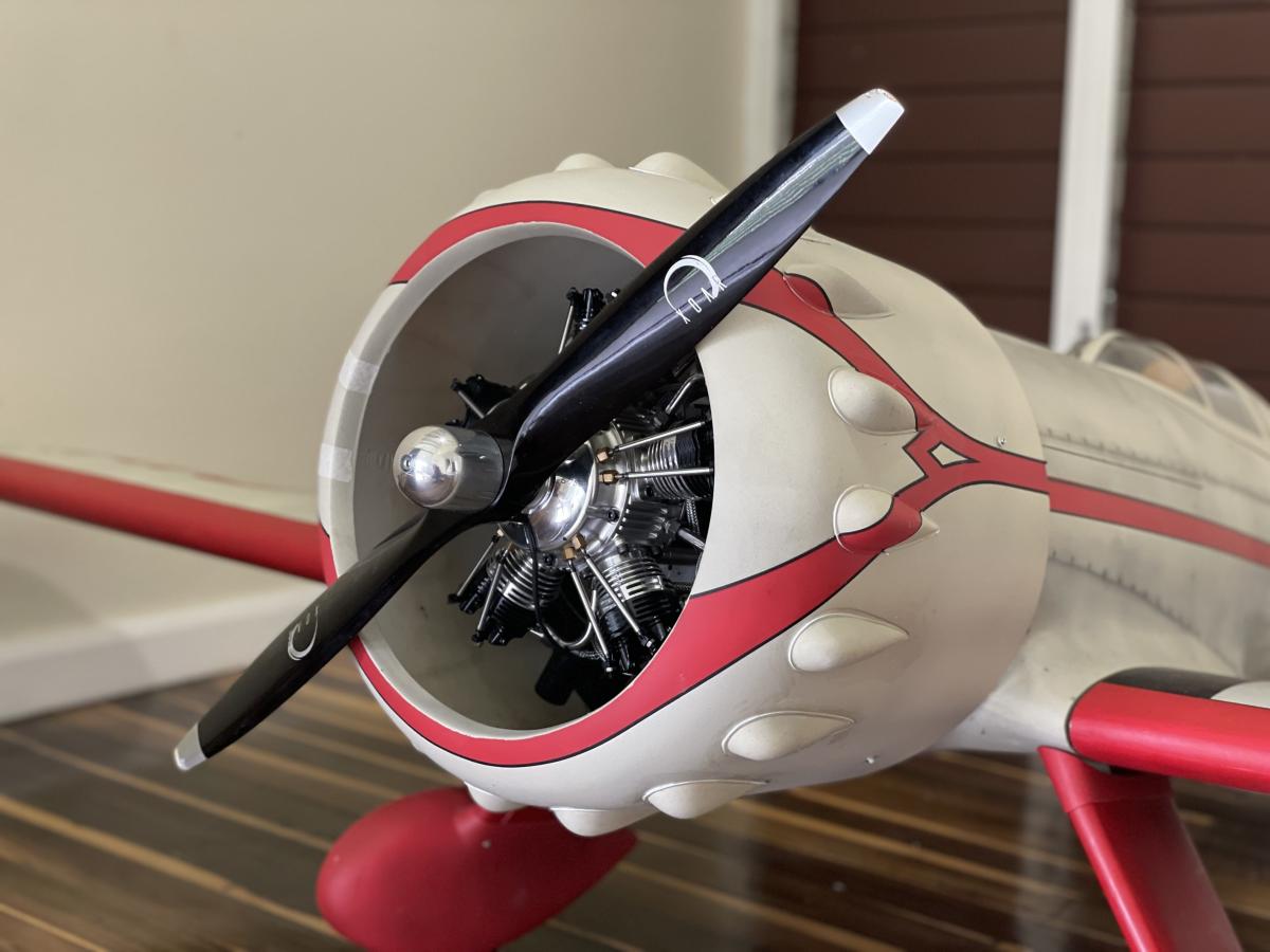

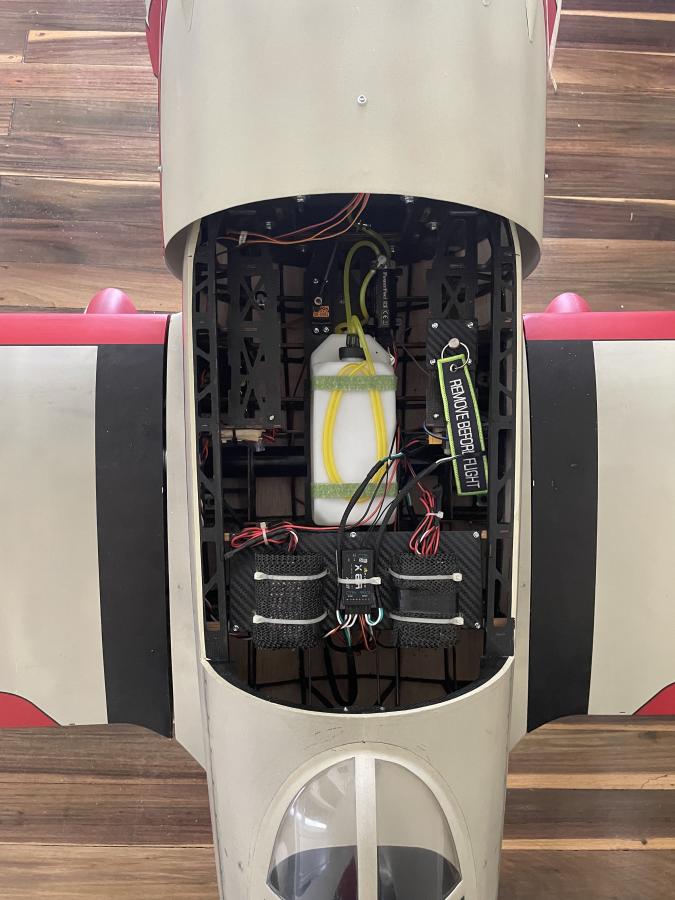

        RCBobP and 406PIlot, based on both your responses, I believe I will be about ready to maiden VERY soon.
        Today I finished installing the blisters on the cowl and finalised battery placement for an ever so slight nose heavy attitude.
        The addition of the blisters gives the Gilmore a more aggressive look. I am very happy I took time to trim, sand and install them. I can clearly see why this model attracts so much attention.
        More updates to come.
        DaleD

          DaleD That 5 cylinder looks so good in there!!! Nice clean install of batteries etc. Good work. Can't wait to hear your report on the maiden. We are all rooting for a successful flight!!

            That 5-cylinder engine looks bad arse! If I had known about it, I probably would have used that one, not that there's anything wrong with the Saito!
            Looking forward to your flight report, and take some video so we can hear that engine purr!

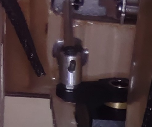

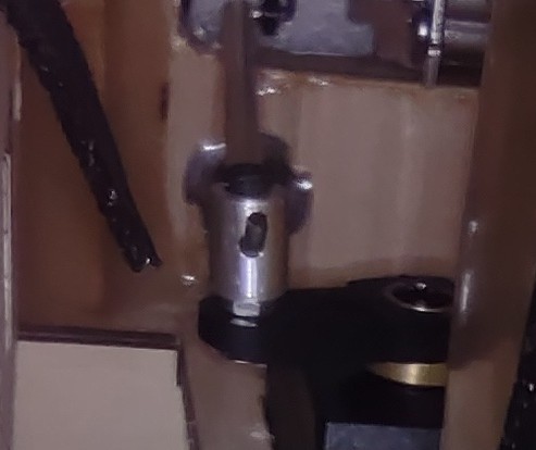

                  I don't trust the EZ Connector on the throttle servo arm. I tightened the set screw, but my paranoia makes me think that one day it will loosen and I won't be able to move the throttle while she's in the air. Now that I have the throws and trims where I want it, how big of a sin would it be to place a drop of medium CA on the push rod on either side of the connector? Or does anyone have a better idea? Or is my paranoia unfounded? (As the saying goes, just because you're paranoid doesn't mean they're not really out to get you.)

                            Put a 90bend in the wire just behind the connector. This should keep it from coming completely out should the screw get loose. Also no harm in a little ca or some blue loctite
                            here is a picture of mine doing exactly as I mentioned. The picture is bad but you get the idea (I hope).
                            Just make sure you don't need to adjust the rod before you trim and bend.
