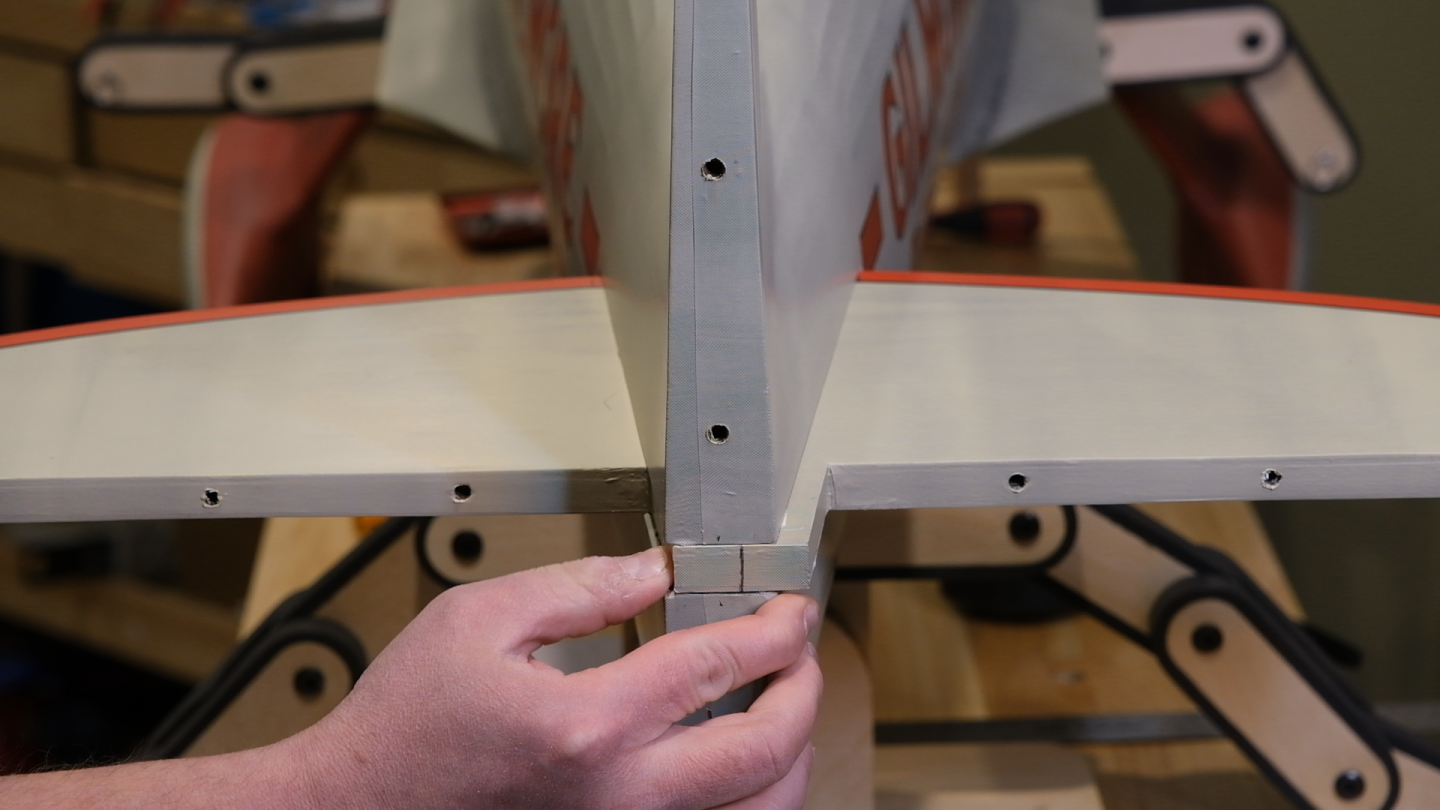

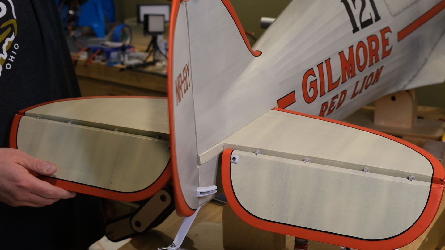

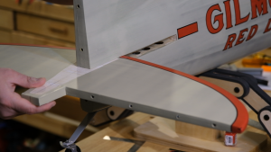

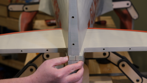

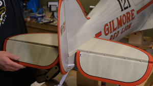

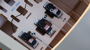

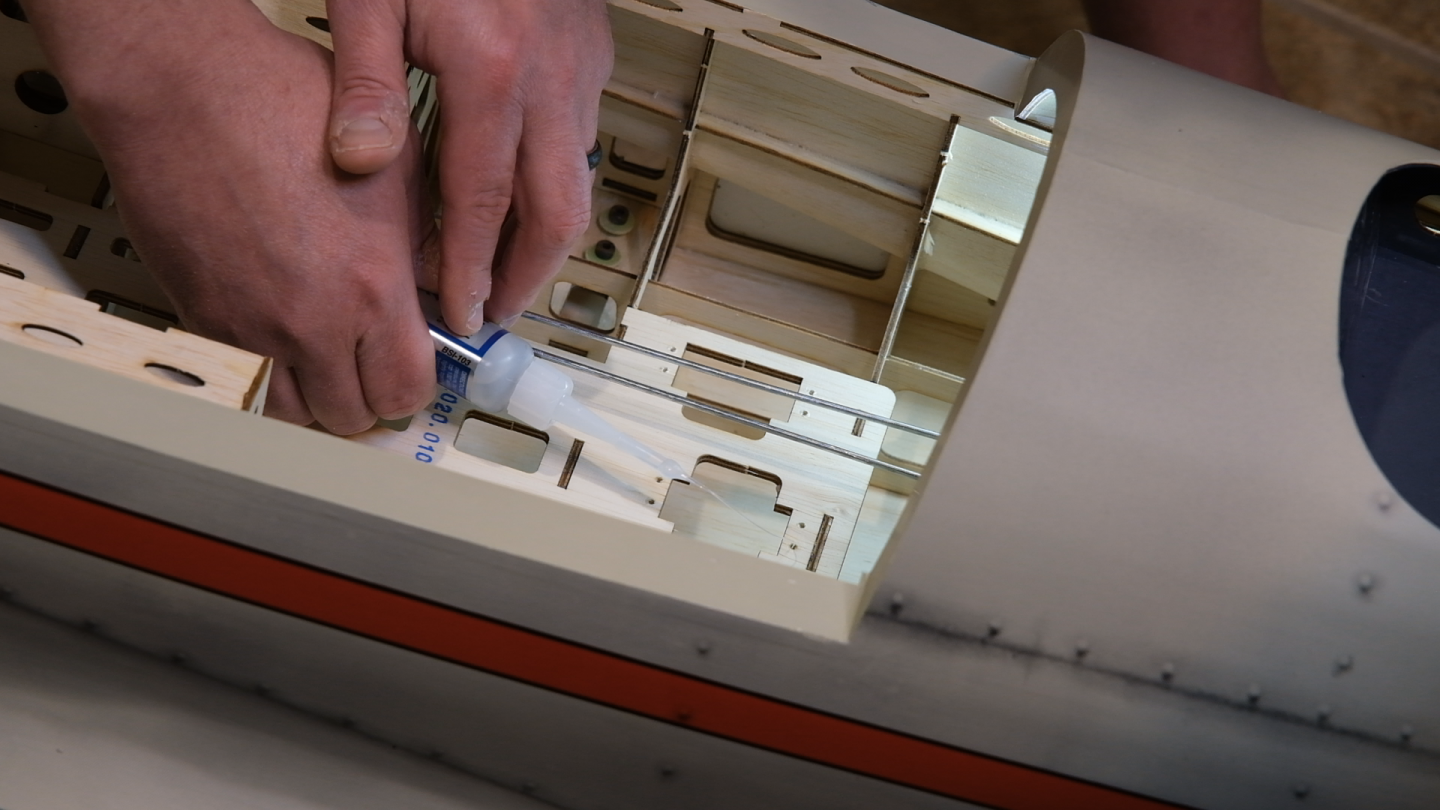

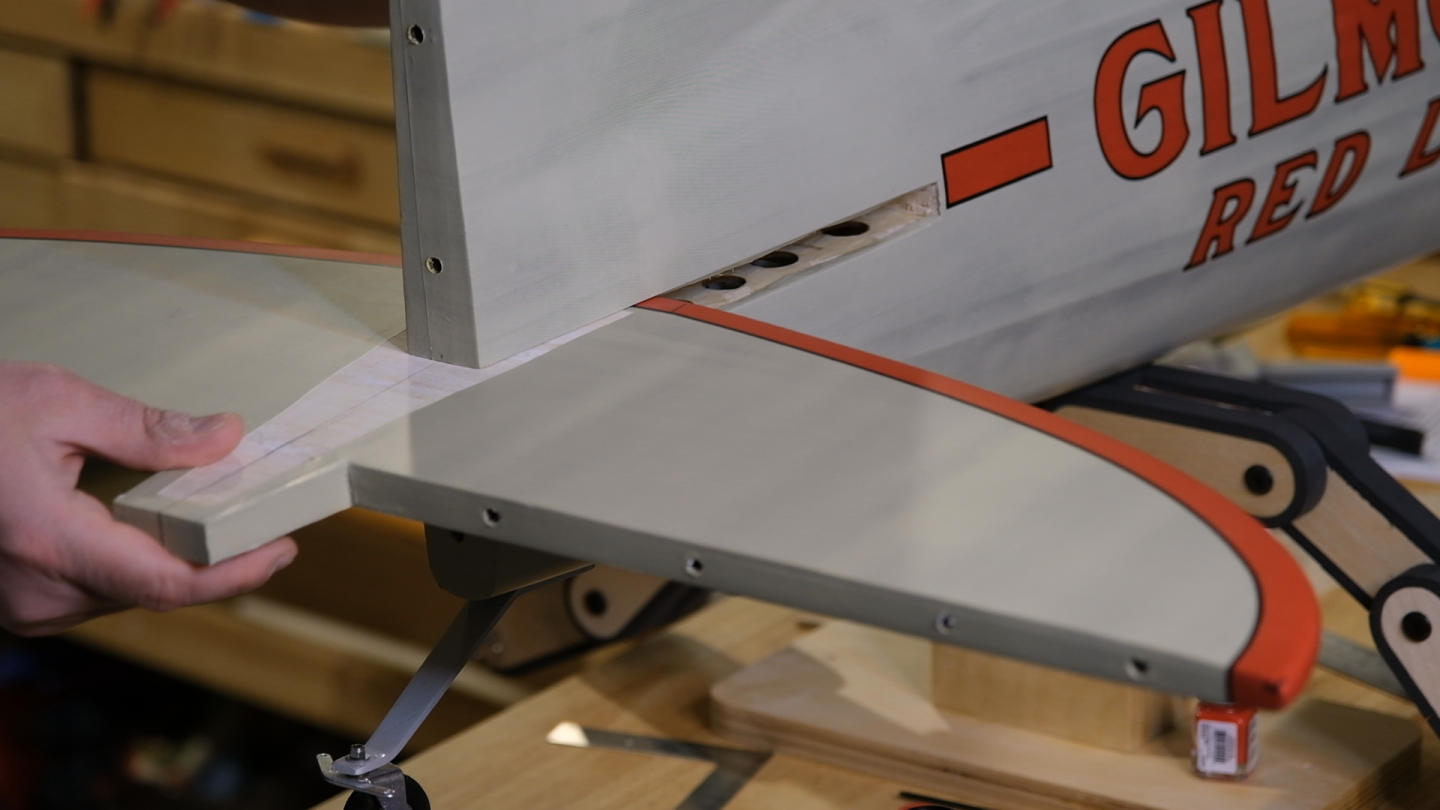

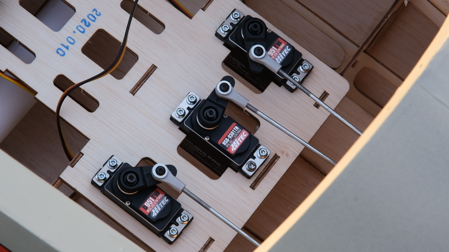

      Let's attach the rudder and elevator with Robart pin hinges in the same fashion as we did with the ailerons. We'll also install the respective servos and pushrods to connect everything up.
