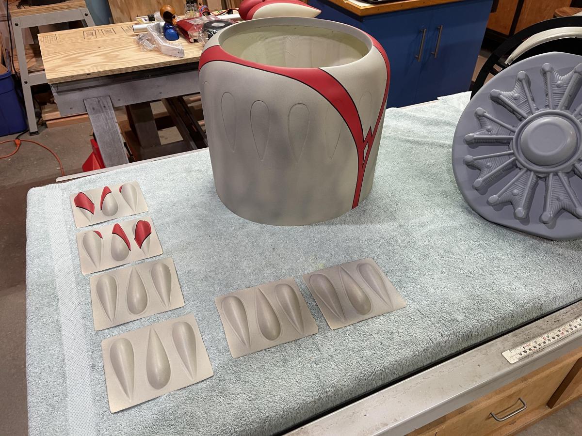

                    Just received My Gilmore today and everything was in great shape during the unboxing review.
                    One question though... Did anyone else have to bond on the all of the cowl bump-outs or did the cowl come with them installed?

                        mechwizz Welcome to Hobby Squawk! Mine was from the first batch and came with the cowl blisters attached.
                        Looking forward to following your and djmoose builds.

                          Twowingtj Could you post a couple of close up pictures of the blisters on your cowl. I have been plying around with the trim but do not want to go to far. Your picture will help me figure out exactly how the factory did it. Thanks in advance!!!

                            I can imagine that the blisters will be a NIGHTMARE to get looking good.

                              djmoose I must admit that I am not real happy about them not being applied. Instruction manual says noting about mounting them either. The plastic is very thick on these and the depression in the cowl not deep at all. the cut edges of the blisters will be white and stick out like a sore thumb. I am going to have to try and match the paint and airbrush the look back around.
                              Well, I guess some modeling will be required... LOL

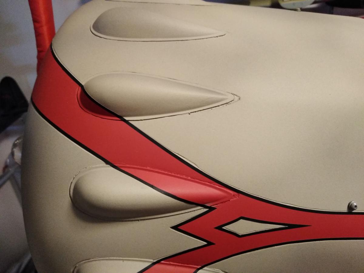

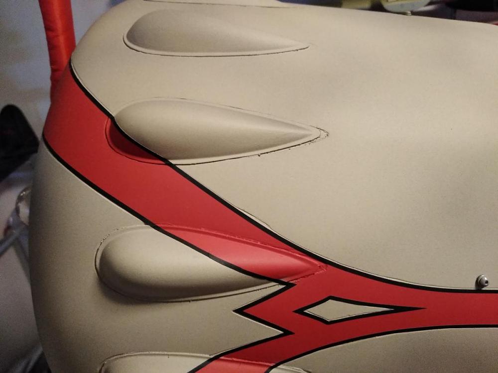

                                      mechwizz Here's a pic of my cowl. Hope it helps. A pair of canopy sissors would work best to cut the blisters out. I have no idea why Black Horse doesn't install them. Unless it's to give the buyer the option of smoothing over the blister pockets and repainting the cowl. The Wedell-Williams Model 44, in Gilmore Red Lion livery did not have the cowl blisters.

                                          mechwizz I had to do some touch-ups on my Gilmore cowl. I mixed Testors Flat Tan, Flat White, and Flat Black to match the paint. It took a while experimenting to get it right. Mainly because the paint darkens as it dries.
