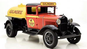

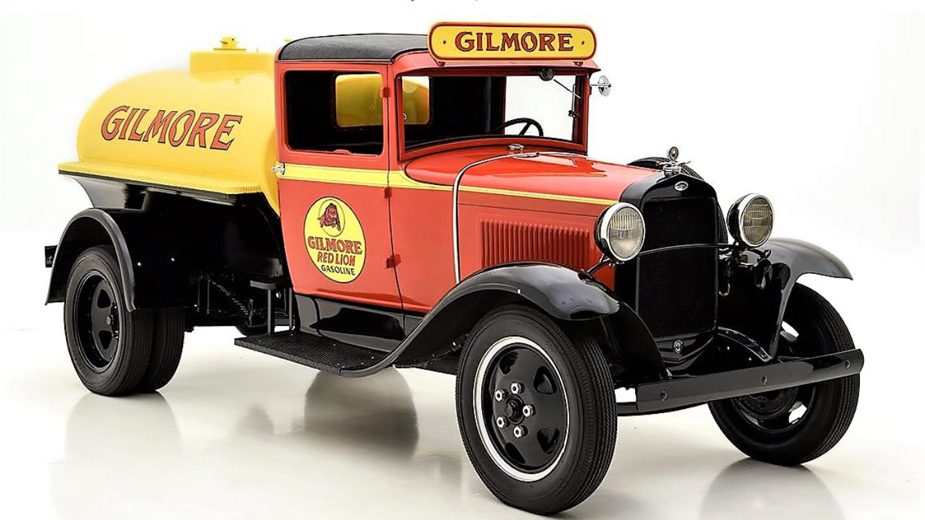

ID:	291280 Now who’s serious enough to build a working 1931 Ford model AA Gilmore fuel truck to go with their plane? 😁👍
                              • #75
                                Thimble Welcome to Hobby Squawk! That would be an excellent addition to any static display or picture with this classic aircraft.
