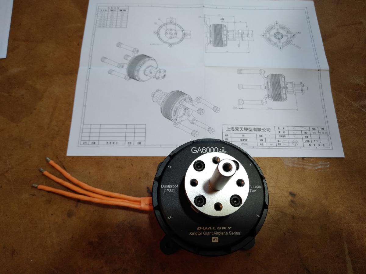

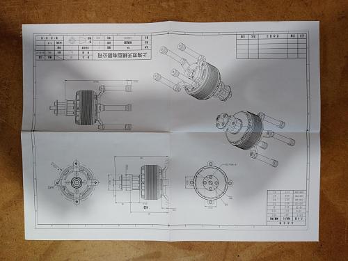

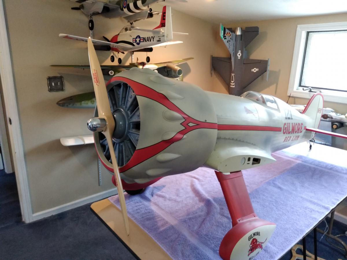

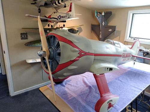

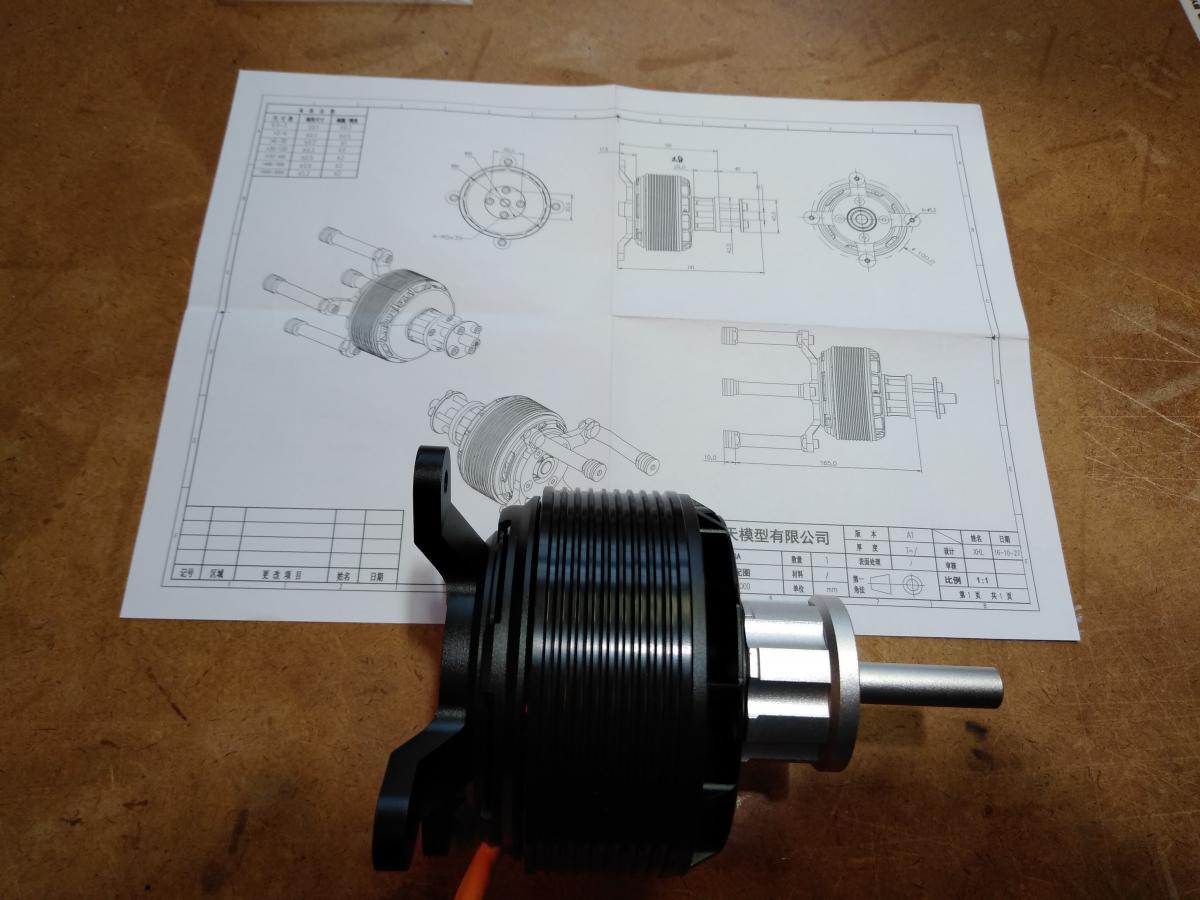

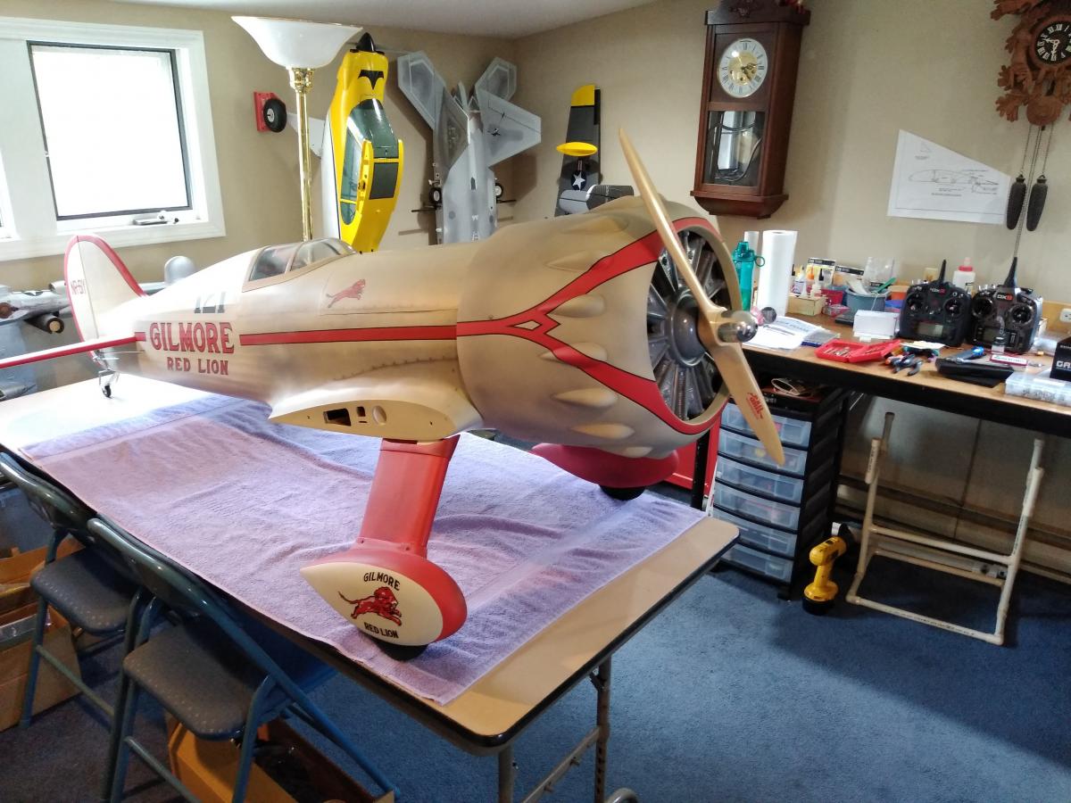

          Finally got the DualSky 60cc 160kv motor. I did a quick mock-up for fit with the motor, cowl, prop, and spinner. I'll post more pics and details later as I finish up the actual final install.
          That big 15" diameter cowl certainly adds to the Golden Age lines of this bird.
          The dummy P&W Wasp will get the detail treatment a little later on.
          Click image for larger version  Name:	Cowl Prop1.jpg Views:	0 Size:	117.5 KB ID:	248364Click image for larger version  Name:	Cowl Prop5.jpg Views:	0 Size:	133.7 KB ID:	248365Click image for larger version  Name:	Cowl Prop3.jpg Views:	0 Size:	145.1 KB ID:	248366Click image for larger version  Name:	Cowl Prop4.jpg Views:	0 Size:	99.5 KB ID:	248367Click image for larger version  Name:	Cowl Prop2.jpg Views:	0 Size:	112.2 KB ID:	248368
            OV10 commented
            Editing a comment
            That workplace looks to darn clean, wanna come over and organize my workshop LOL

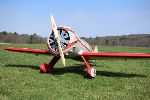

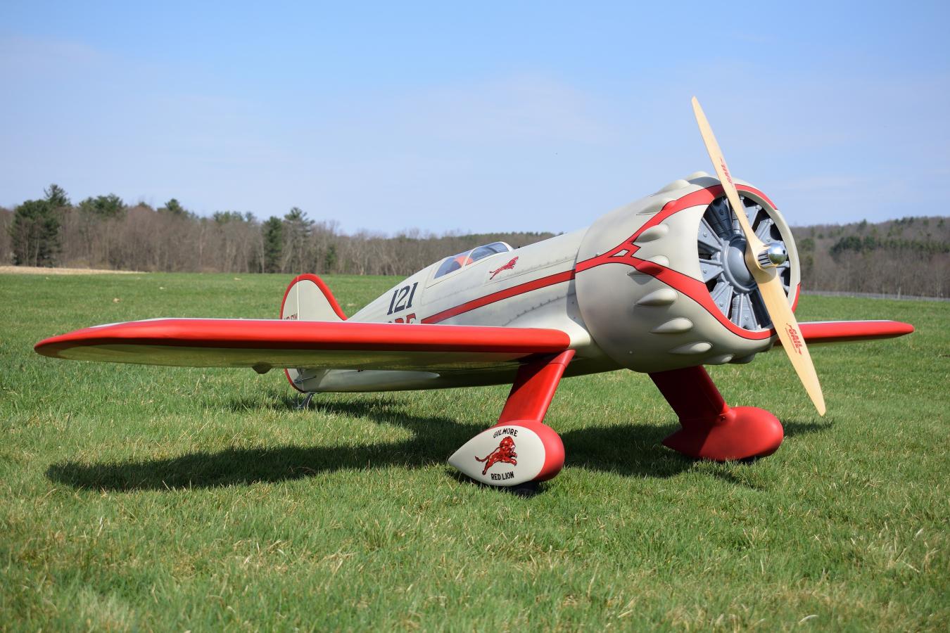

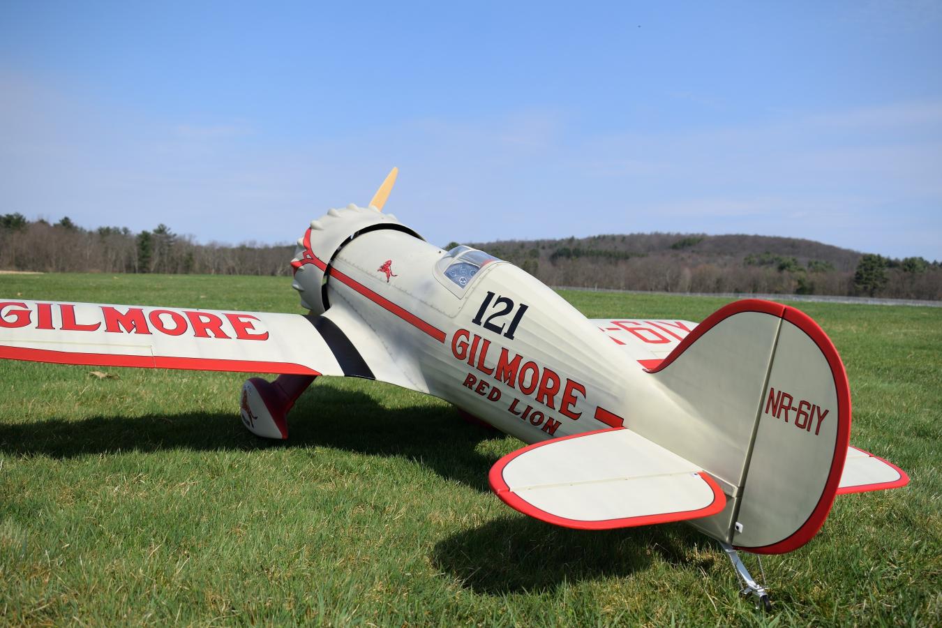

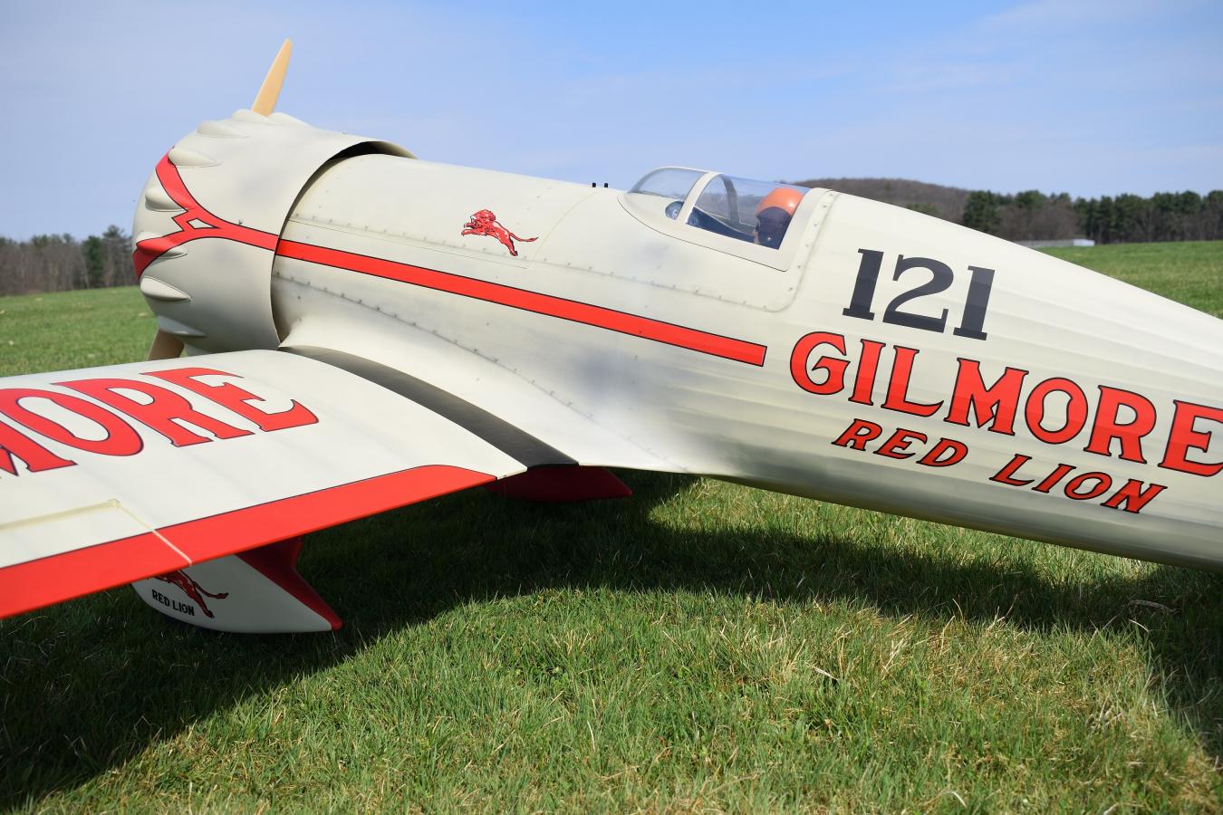

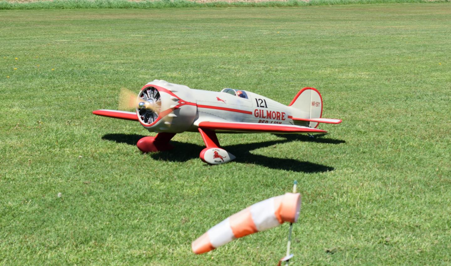

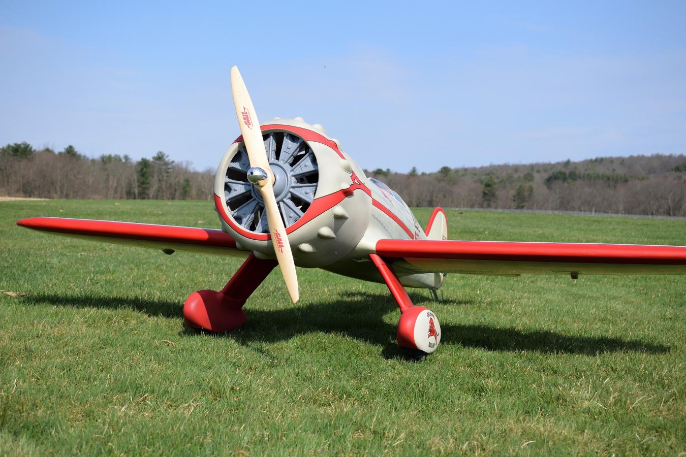

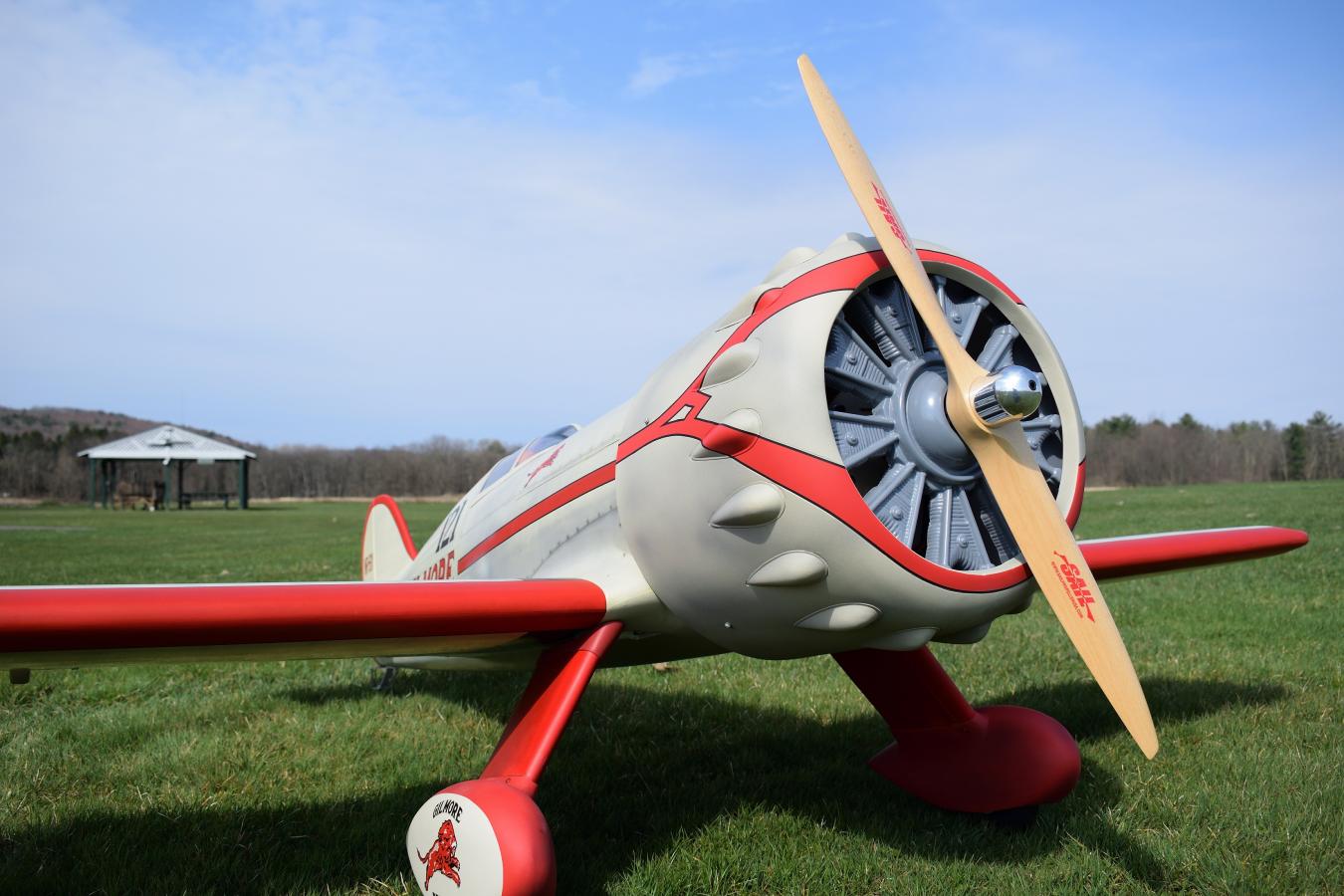

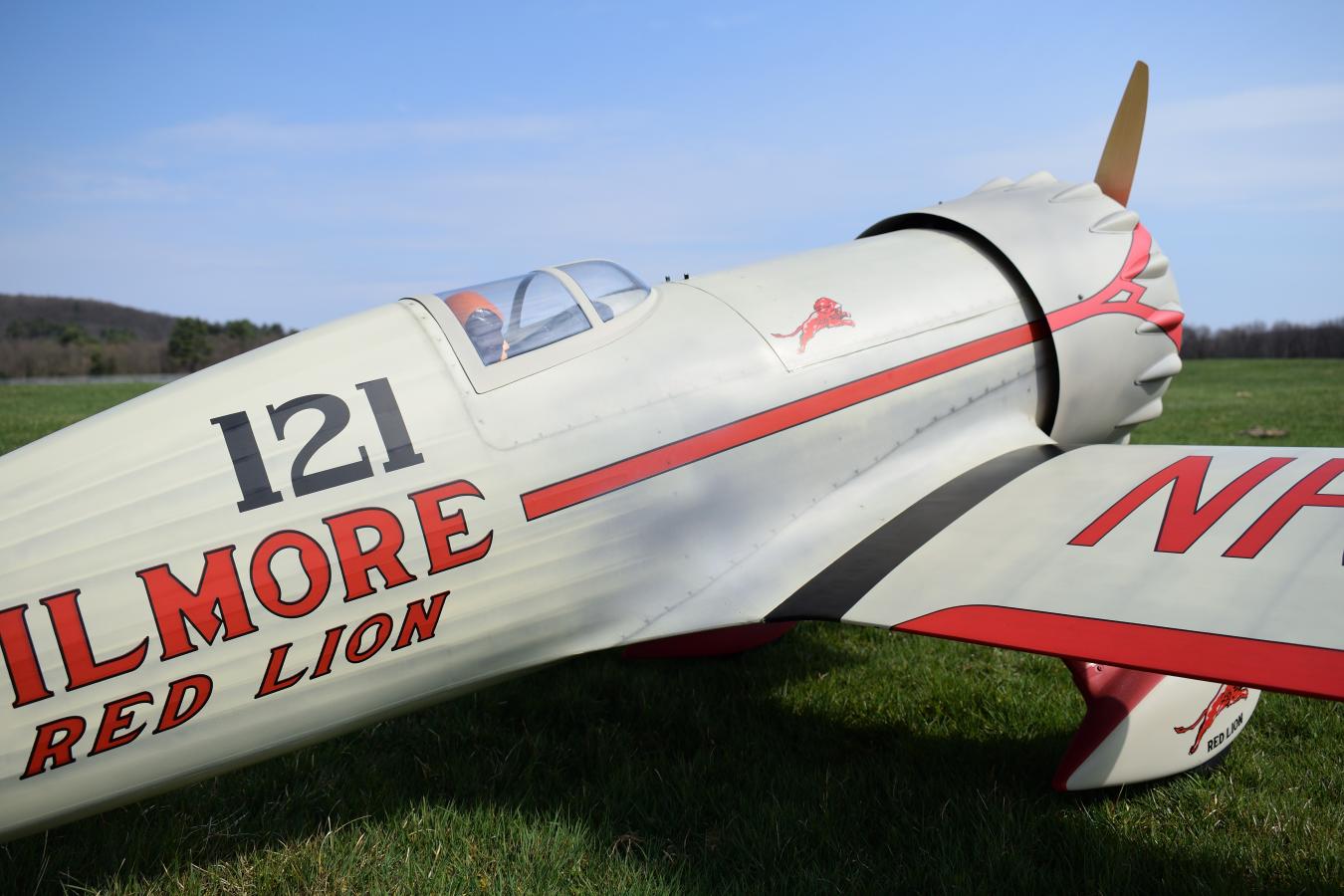

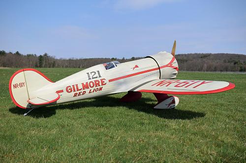

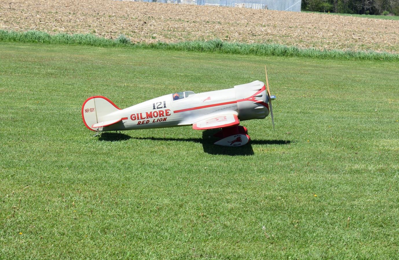

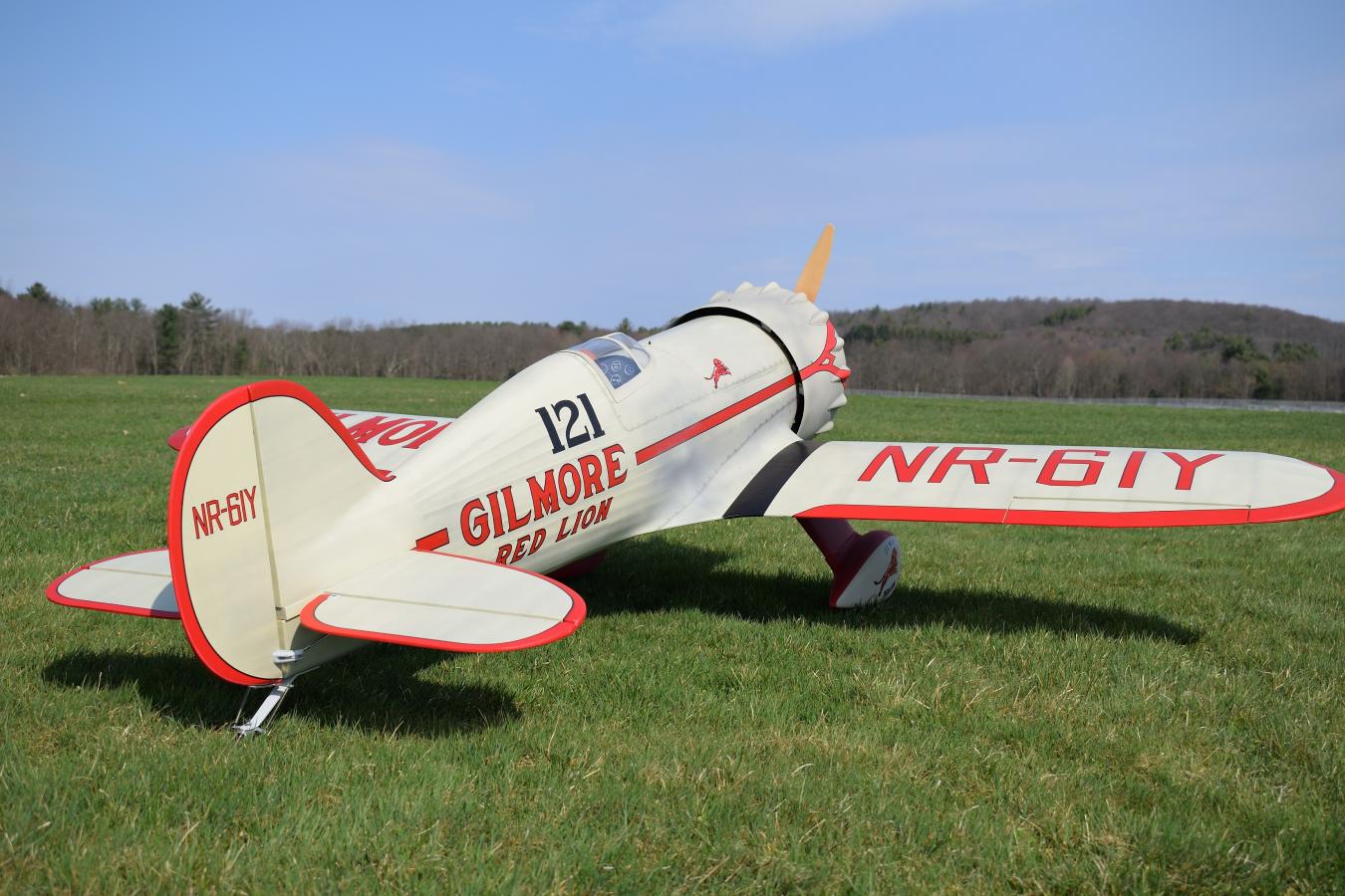

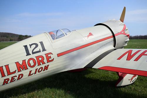

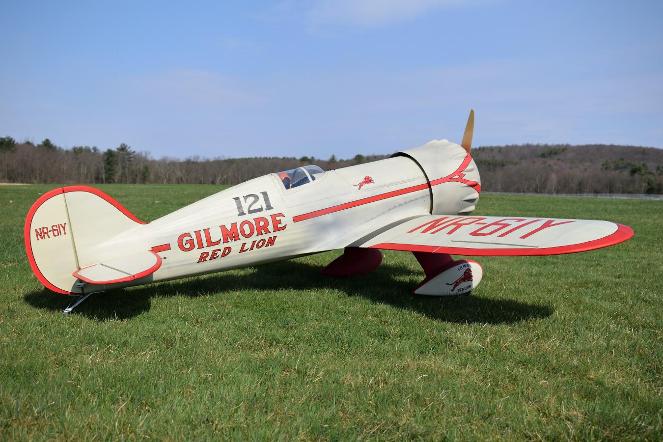

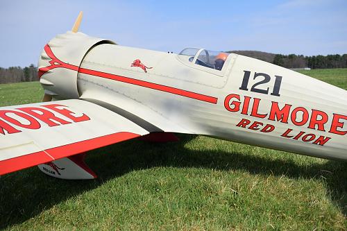

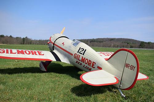

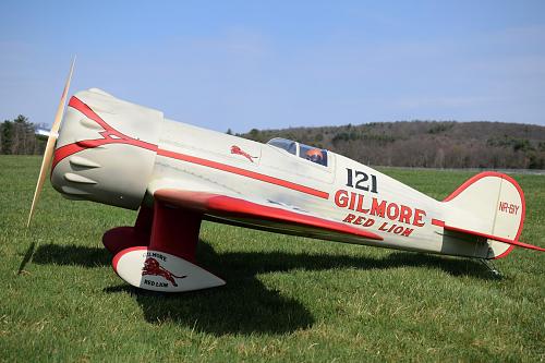

          Had a chance to get the Gilmore out in its natual habitat for some photos this morning.
          When indoors, the weathering appears a bit overdone. When outside, it looks much more realistic for a Golden Age air racer. It presents quite well. Click image for larger version
Name:	Outdoor Gilmore_033.jpg
          Now it's time to pull the cowl and get the drive electrics finished. I'm also going to use the opportunity to paint and detail the dummy motor.

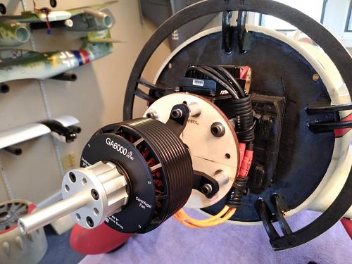

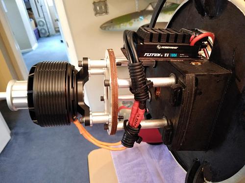

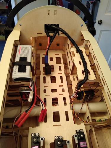

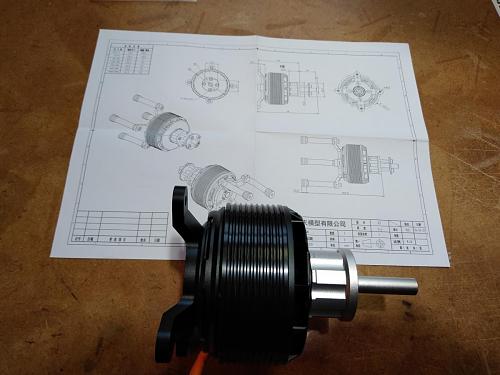

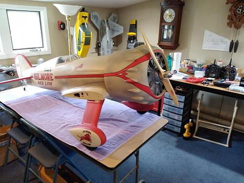

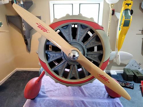

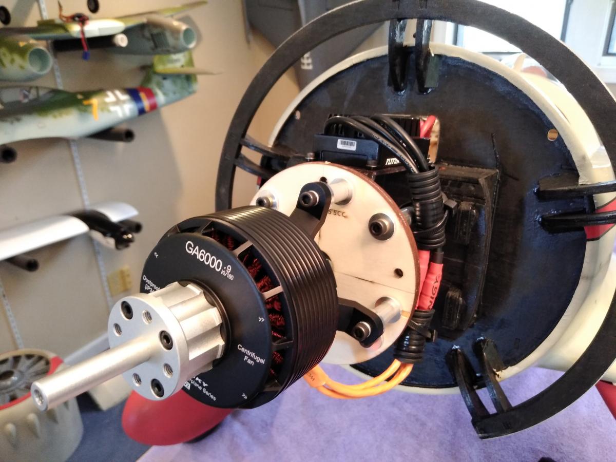

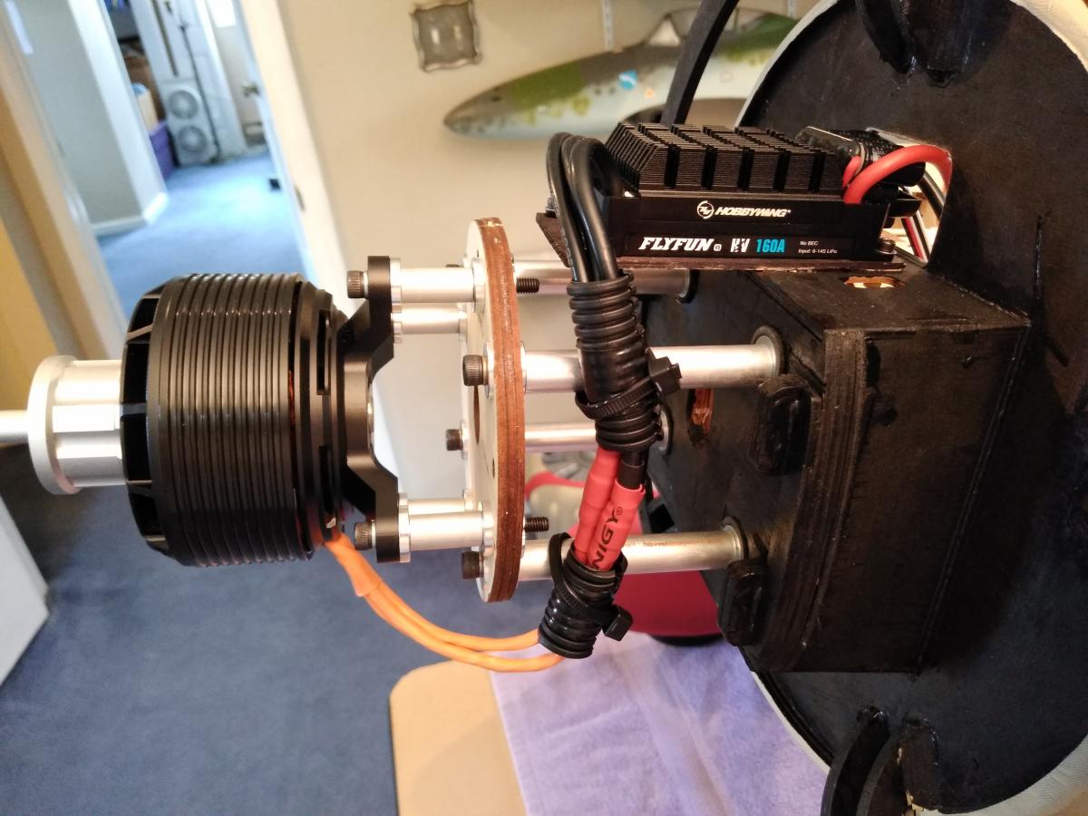

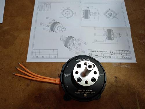

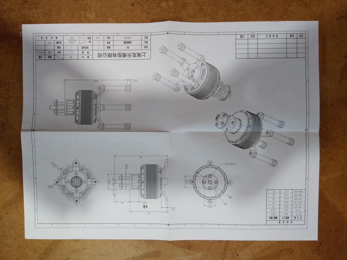

            The DualSky GA6000.9 160kv motor now installed. This is the first of the larger DualSky motors I’ve used. The initial impression of the motor was that it seems to be very well designed and well made. The motor comes with a set of bullet connectors, 65mm stand offs, and machined aluminum shims in two thicknesses (8ea. 2mm and 8 ea. 3mm).
            To mount the motor, I was able to use the stand offs and motor mount disc that came with the kit. I found that the small diameter of the stock stand offs, for both the mount disc and motor tended to press into the wood. I also needed some additional length on the whole assembly to put the prop mount hub where I wanted it to be. By using the aluminum shims that came with the motor I could achieve the 206mm distance from firewall to prop mount hub that I was looking for. In addition, the 16mm diameter of the shims, also provided a larger surface area in contact with the wood, which addressed the compression of the wood.
            The bolts that come with the kit for mounting the motor to the disc are 4mm in diameter. The bolts for the long stand offs are 5mm. My preference was to go with 5mm bolts on the whole assembly. This required drilling out the short motor to disc stand offs to fit the 5mm bolts.

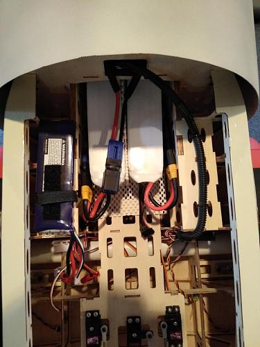

            A plywood platform was made for the ESC and epoxied it to the top of the motor box. The ESC is then bolted to the platform in front and through the platform and motor box at the rear for a secure set-up.
            The equipment bay on this model is not short on room. I think I've had appartments smaller.
            Click image for larger version  Name:	Motor1.jpg Views:	0 Size:	91.9 KB ID:	249581Click image for larger version  Name:	Motor2.jpg Views:	0 Size:	102.1 KB ID:	249582Click image for larger version  Name:	Motor6.jpg Views:	0 Size:	82.6 KB ID:	249583Click image for larger version  Name:	Motor5.jpg Views:	0 Size:	115.2 KB ID:	249584Click image for larger version  Name:	Motor3.jpg Views:	0 Size:	116.8 KB ID:	249585Click image for larger version  Name:	Motor4.jpg Views:	0 Size:	120.3 KB ID:	249586

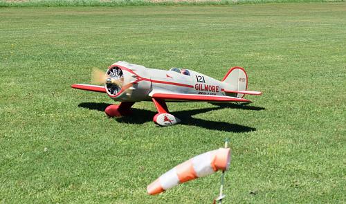

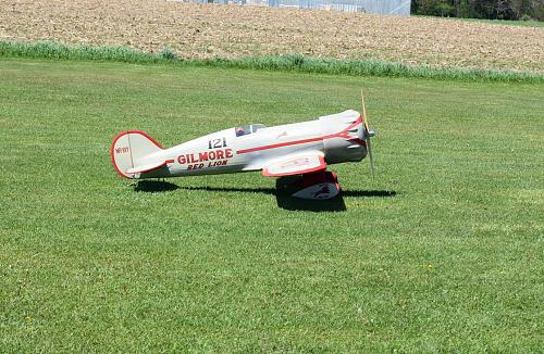

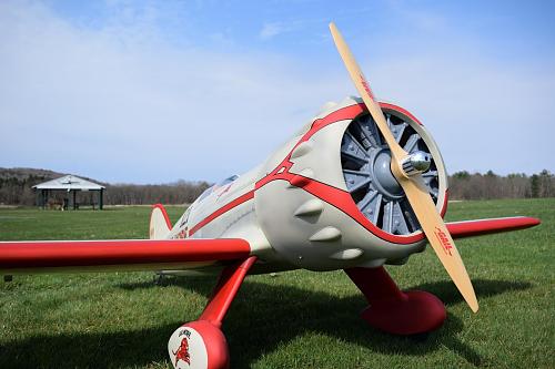

              Was having some trouble getting the pics of the Gilmore, taken outside, to load. After resizing, here are some additional images of the model of the Wedell-Williams Model 44 in its classic Red Lion scheme, from Black Horse.
Name:	Outdoor Gilmore_008a.jpg
ID:	249966Click image for larger version
Name:	Outdoor Gilmore_003a.jpg
ID:	249967Click image for larger version
Name:	Outdoor Gilmore_005a.jpg
ID:	249968Click image for larger version
Name:	Outdoor Gilmore_011a.jpg
ID:	249969Click image for larger version
Name:	Outdoor Gilmore_031a.jpg
ID:	249970Click image for larger version
Name:	Outdoor Gilmore_015a.jpg
ID:	249971Click image for larger version
Name:	Outdoor Gilmore_034a.jpg
Name:	Outdoor Gilmore_002a.jpg

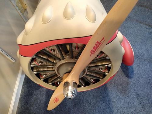

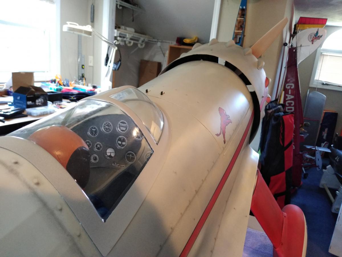

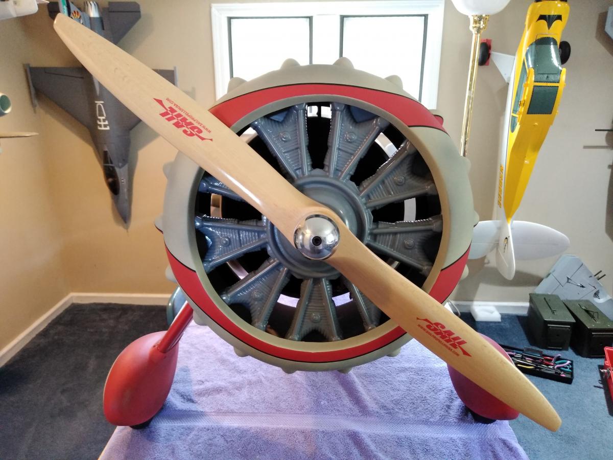

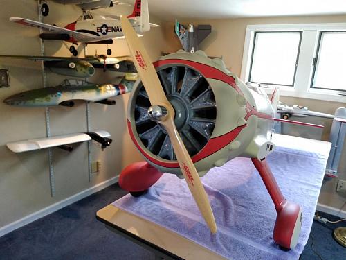

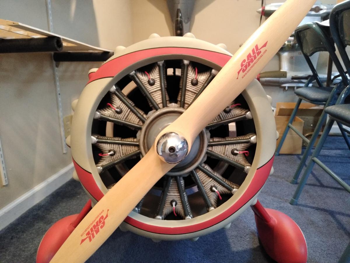

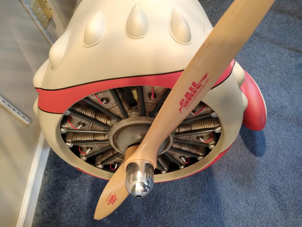

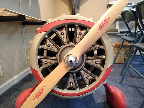

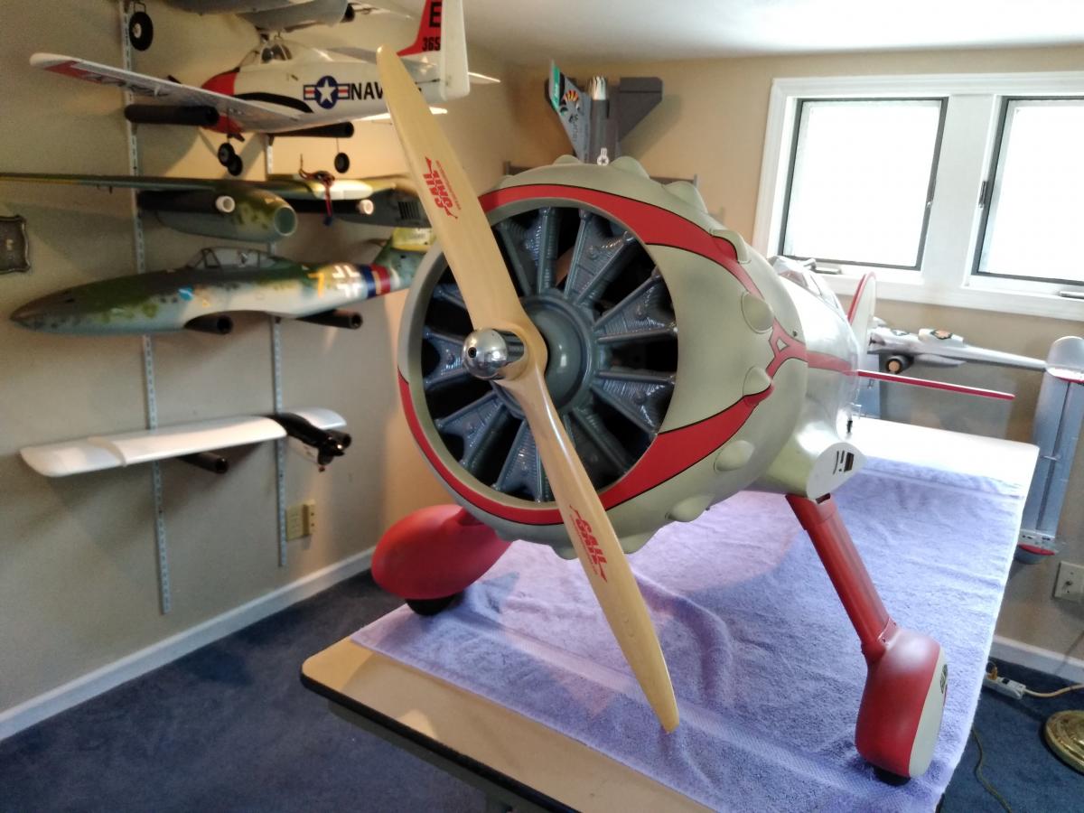

                    Dummy Motor: The dummy motor supplied, actually resembles a P&W Wasp Junior. Although it's slightly smaller than scale, it's a decent enough foundation to work with for detailing. Especially since it’s such a large visible feature on this model.
                    When you get the ARF the dummy motor has vacuformed webbing between the cylinders. It’s easy to open up between the cylinders with canopy scissors, then sand the edges. It is advised to only remove the webbing up to about the rocker boxes on the cylinders and leave the area in the "V" of the heads filled in to support the dummy motor. The center of the motor is filled in as well and is fairly thick. I opened mine up using a 2” hole saw.
                    There is a top and bottom to the motor. The cut outs go in the sides and are slightly biased toward the top. The cylinders form a “Y” at the top, with a single cylinder at the bottom.
                    After detailing, the dummy motor was installed in the cowl using silicon adhesive. I also made sure that there was a slight lip of silicon at the rear of the motor so it could not be pushed backward. I went with the silicon so the motor was secured most of the way around, yet the silicon could be cut if the motor needed to be removed.
                    The detailing was done with regular Testors model paints finished with a black wash to dirty it up a bit. The spark plugs are just sections of white plastic tubing, hot glued into a hole drilled at an angle. The wires are 18 ga. wire glued into the white tubing and into the motor over the heads.
                    Cowl Install: The locations to drill the cowl mount holes are preformed dimples in the cowl. All are marked except the top. I used the others as a guide for marking and drilling the top hole.
                    The cowl is tapered. It’s narrower at the rear than in the front. It is a bit tricky to get it to slide over the cowl mount ring. Especially after the dummy motor is installed.
                    It helps to sand the front edge of the cowl mount ring, to a slightly rounded front edge.
                    Click image for larger version  Name:	Lion motor1.jpg Views:	0 Size:	130.4 KB ID:	250944Click image for larger version  Name:	Lion motor3.jpg Views:	0 Size:	125.9 KB ID:	250945

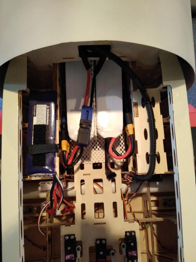

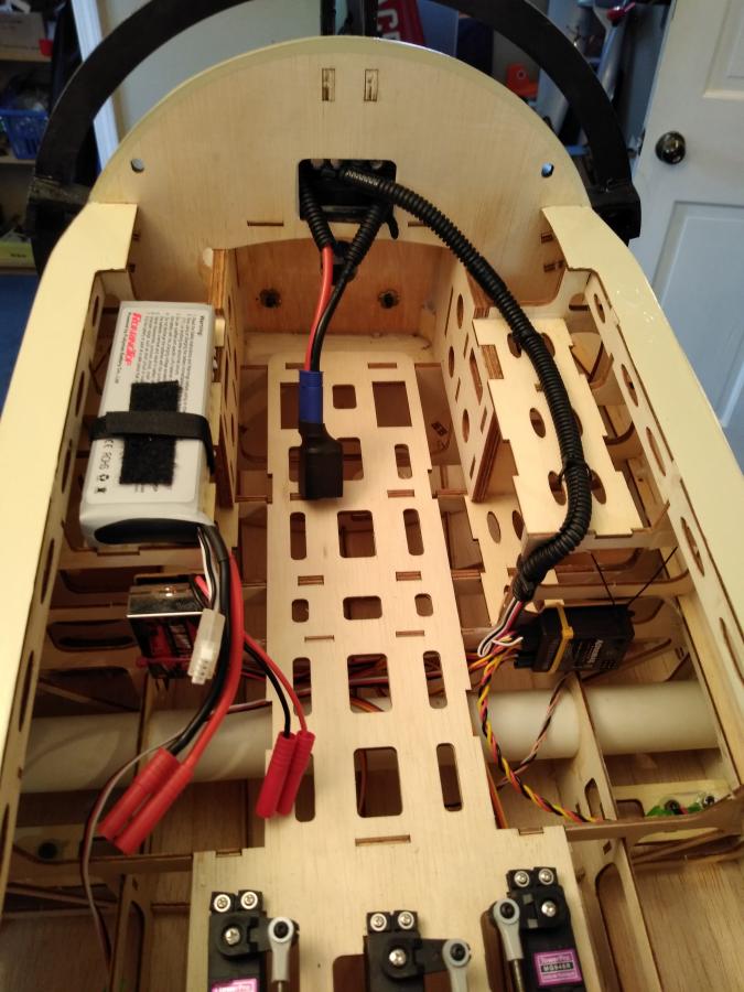

                      With the Gilmore Red Lion having a fairly short nose, it was likely that it was going to need a fair amount of weight in the nose to balance. As I’m not a fan of having dead weight in a model, it was decided to do an initial CG using lead to see how much weight might be needed.
                      Black Horse provides a CG tool with the plane. It’s a fairly simple tool consisting of two semi wing ribs with a cut out for the wing tube and a hole for the forward anti-rotation pin. On mine, the hole for the anti-rotation pin was drilled 10mm too far forward. After taking the measurement for the true location, a new hole was drilled. The tool also has nylon bolts that screw into tabs in the semi-ribs, at the recommended CG. They also provide cord and a section of tubing to serve as a handle. It's quite a handy gadget really.
                      The recommended CG is 118mm from the leading edge of the wing. With a 450mm wing cord, that places the CG at 26.2% which is a good starting point.
                      Once the CG tool was installed and the plane was level with the tail blocked up, lead ingots were added far forward in the battery compartment. The plane was lifted using the tool, and the weights adjusted until the plane hung level at the recommended CG.

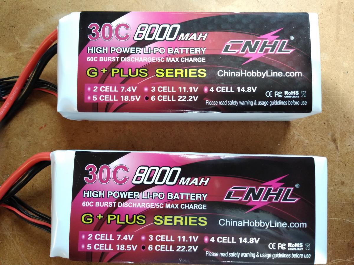

                      With the 3300mah 3S receiver battery installed, it took just over 4.5lbs of lead to balance.
                      With that weight in mind as a starting point, flight batteries were selected that would meet the requirement and give good flight times. I selected a pair of CHNL 6S 8000mah Lipos. The battery dimensions were perfect for the battery tray and each weighed 1113g or 2.45lbs.
                      Once the batteries arrived, the CG was re-accomplished. The plane balanced at the recommended CG, with the two batteries at barely back of the full forward position. Use of the batteries called for on the product page would have required quite a bit of dead weight to be added to the nose in order balance. The all up, ready to fly weight came in at 24.6lbs. The airframe weight, fully equiped, minus batteries, came in at the 20.7lbs listed on the product page.
                      Next up is the maiden, when the weather and area health situation allows.
                      Here’s a link to the batteries used. https://chinahobbyline.com/index.php?route=product/product&product_id=87

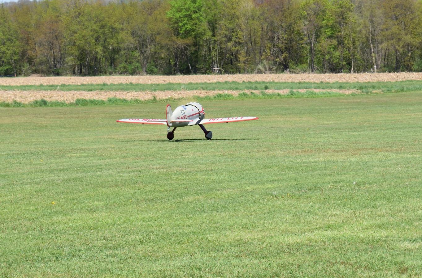

                                Maiden report:
                                Field assembly: The Gilmore is very easy to set-up. It’s simply a matter of sliding the wing tube in, slide each wing on, tighten the two wing clamp bolts on each side and connecting the aileron leads. Everything fits and aligns well.
                                Prep: The receiver and flight batteries were loaded. Then the range check was done from all angles around the plane. The control throws were set by the manual with low rates, mid was set to manual high rates and high about 10% higher. During the power run up, I noticed that the ESC was in medium soft start mode. Not ideal, but workable.
                                Ground handling: Time for the first taxi tests. There were 15mph crosswinds with some higher gusts. It tracked straight going into the wind, and of course wanted to weathervane while in the crosswind. Everything was looking pretty good.
                                Take-off: I set the rates to mid. With a little right rudder input, the throttle was rolled in. Just past half throttle, the big air racer broke ground into a nice scale climb out. The elevator felt quite sensitive and the plane behaved as it were a little on the tail heavy side. The ailerons and rudder felt fine.
                                Trimming: Once at a good altitude and about 2/3 throttle, she was brought into the wind for trimming. With two clicks of elevator, it was tracking true.

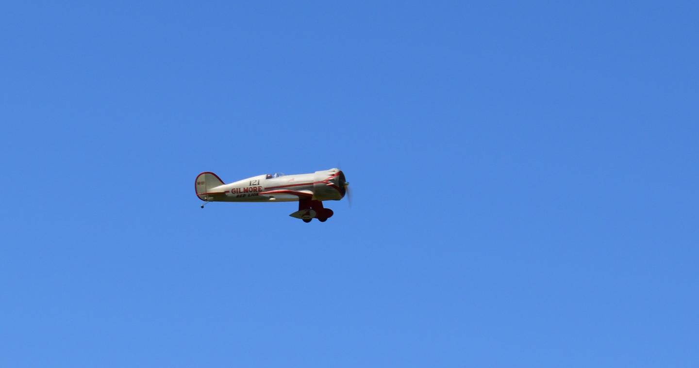

                                  #38

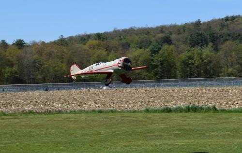

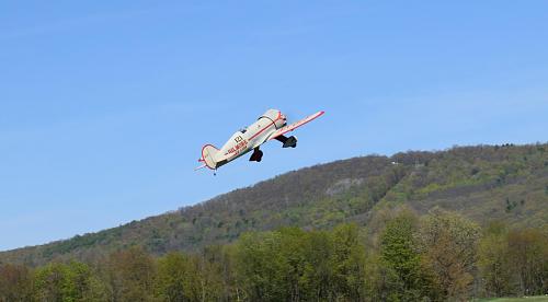

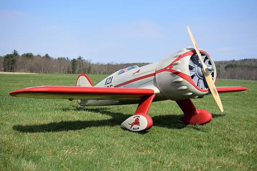

                                  Flight number 2,3 and 4 in yesterday while buddy Warbird Charlie was at the field to maiden the Flightline OV-10.
                                  After adding the 5oz of lead to the nose, it balanced right at the 118mm, called for in the manual, on the Vanessa CG rig.
                                  We were still dealing with a stiff and gusty crosswinds. At take off it handled much better. The ailerons felt even better than they had previously and the elevator felt less touchy. Cruise speed and full throttle passes were very rewarding. Even did a couple of large loops and an aileron roll.
                                  When slowing down for practice approaches, the tail would drop a bit and the elevator was still somewhat touchy, especially in a gusty crosswind. My feeling is that the plane is still slightly tail heavy. I'll add another 3-4oz and see how it feels from there.
                                  At right around 4.8kw at WOT, the Gilmore is powered perfectly for my taste. The DualSky motor, Hobbywing ESC and CNHL lipos don't seem stressed at all after a vigorous 5 minute workout.
                                  Once dialed in, it's going to be a real pleasure to fly and it gathers a lot of attention at the field.
                                  Thanks to fellow Squawker OV10 for getting some pics for me.
