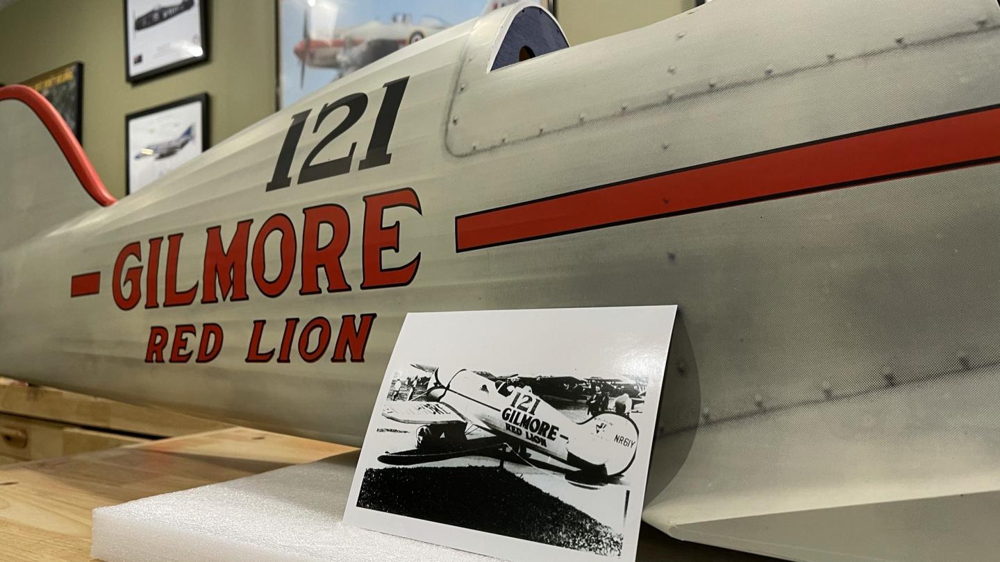

        Very excited about this.

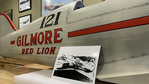

                                      #178

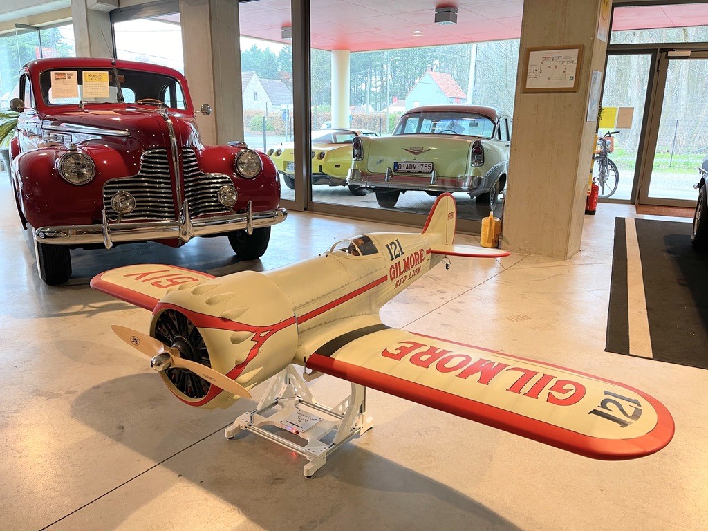

                                      Blisters attached . The red lines correspondent not with all the planes . So here is some cutting and shaving to do. but the end result is ok for me.
                                      • RC ML
                                        • Dec 2020
                                        • 22

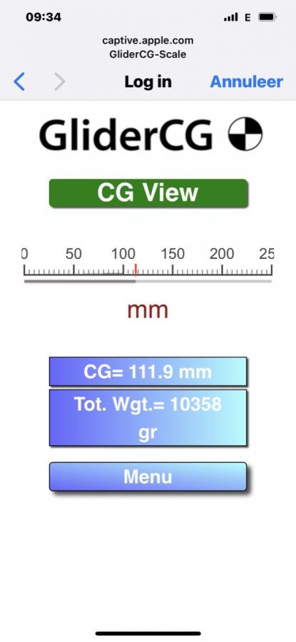

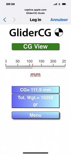

                                        #179
                                        Next problem , make the cg thru extra weight or thru extra batteries .
                                        I measured both .
                                        No landing gear mounted . (not possible to measure , practical issues.)
                                        With extra weight cg 111,9 mm total wit = 10358 gr Click image for larger version
                                        • RC ML
                                          • Dec 2020
                                          • 22

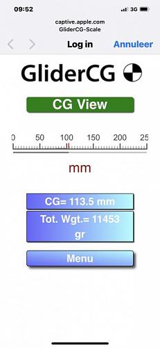

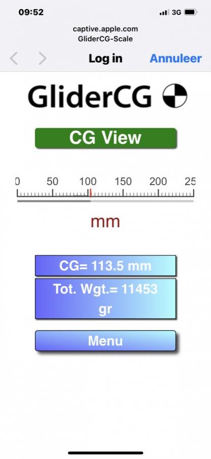

                                          #180
                                          First set of batteries = 2x 6000mah (in series)
                                          Now with extra batteries 2x 5000mah (i don't have others ) that have to go parallel.
                                          The 4 batteries setup :
                                          cg=113,5 but can go to 112 just by adjusting the batteries on batterie holder in the Gilmore.
                                          The weight is 11453 gr , that is +1100gr .
                                          I am going first for the 2 batteries setup . (See how long i can fly)
