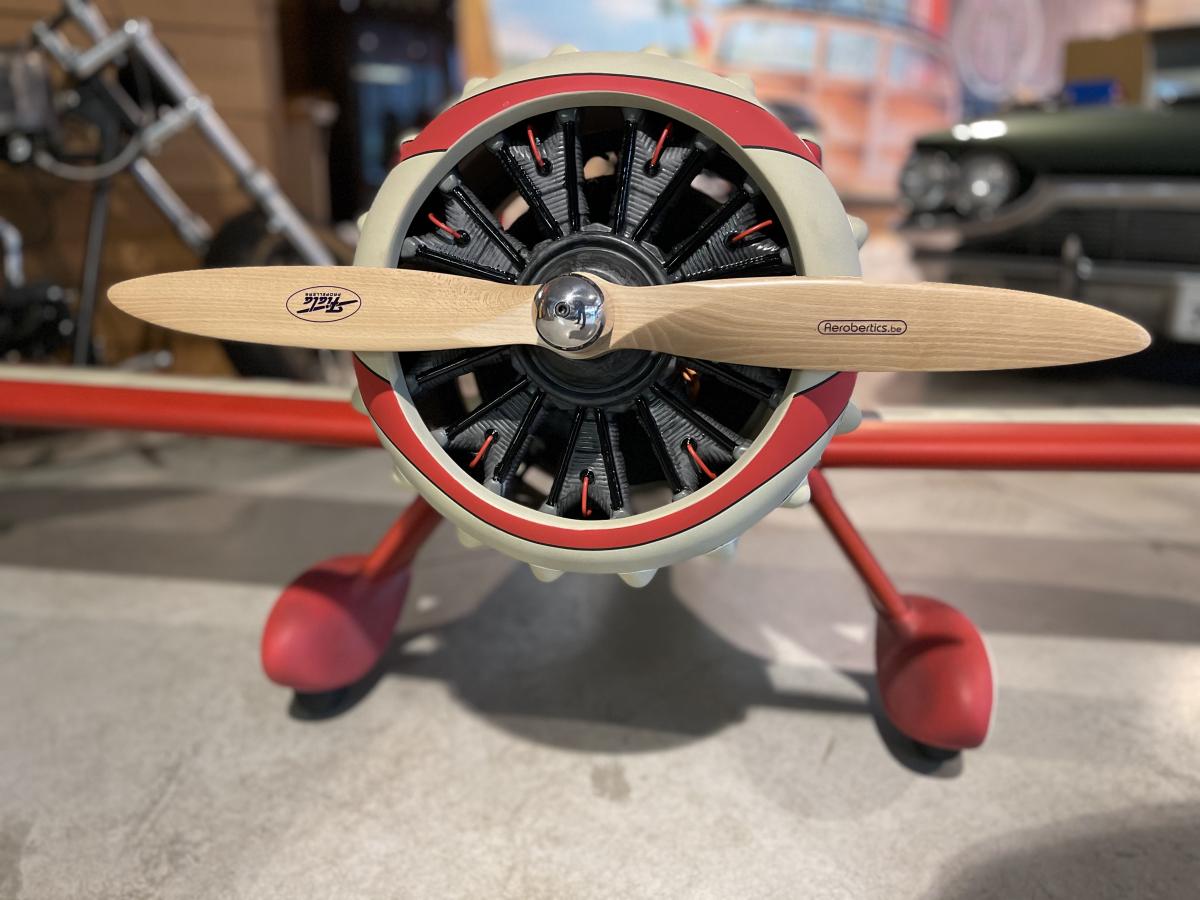

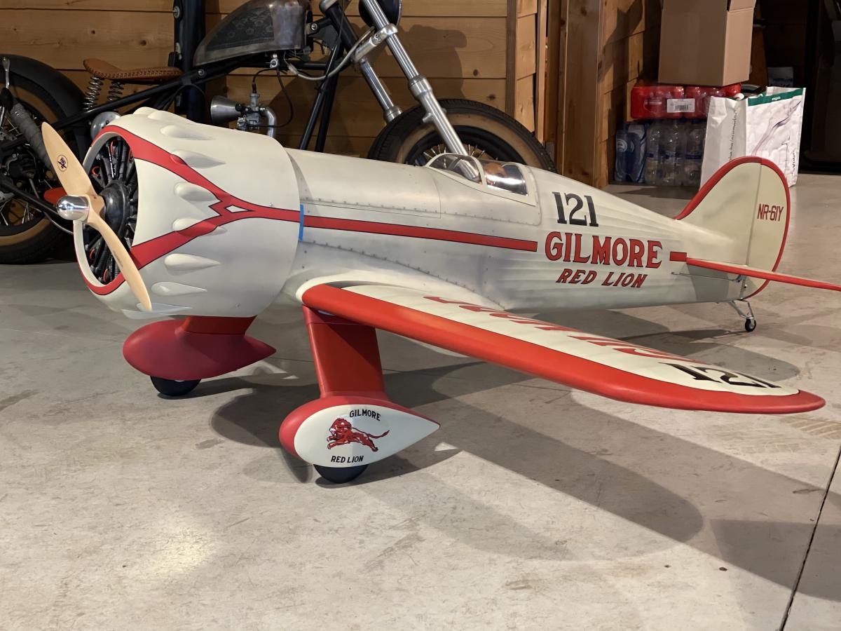

                Finished

                  Originally posted by RC ML
                  Finished
                  GREAT Going!!!!
                  Now get her maidened and let us hear all about the thrill. Looking forward to flight report.
                  DaleD
                  • RCBobP
                    • 89
                    #209
                    Finished
                    That's a real sharp looking bird there. Looks like you glued the blisters on? Looks pretty good!

                      #210
                      RC ML looks dang good!!! Can't wait to hear about or maybe see some video of the maiden!!!
                      Cheers to a job well done!

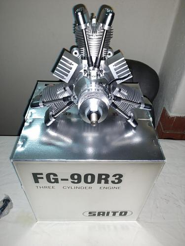

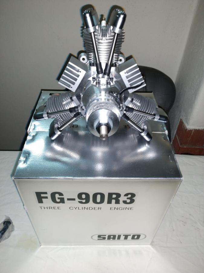

                        Well the engine came in today!!!
                          Another question. Has anyone ever used the power box regulator switches before?
                          Here is a link to the switch I was looking at.
                          https://www.chiefaircraft.com/pbs-6330.html
                          YES!!!! Glad to see an IC powered Gilmore about to be assembled. Can’t wait to hear how she performs.

                              RC ML Looks Great! Nice detail on the dummy engine.
                              406PIlot Nice engine! Looking forward to seeing how it looks wrapped in the big cowl.

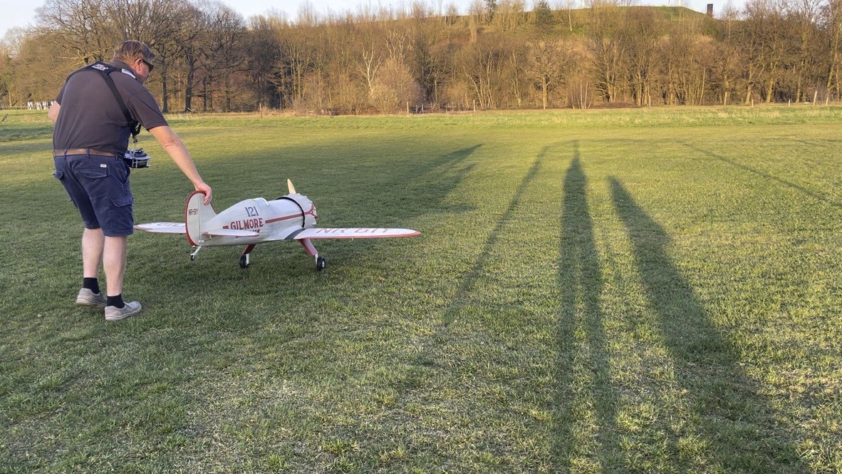

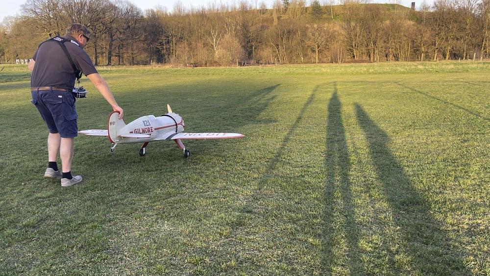

                                      Video of the Maiden

                                          RC ML ML Nice quick flight. Seems to take off and land with no problems. Are you using the book control throws for all surfaces? How did it feel in the air?
                                          Great work!
