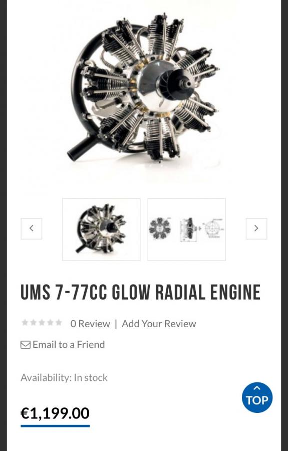

ID:	294028 Would the UMS 7-77cc glow enginemate well to this model? Looking at the specs it seems it would be but wanted to get thoughts. I think a nice radial would sound and look great in this magnificent beast. Thanks!

                              Thimble Based on the engine specs, the UMS 7-77cc should be a good choice power wise. The opening at the front of the cowl is 10.75" (273mm), so the 9" diameter of the engine would look nice and allow cooling air to reach everything. The sound of a well tuned 7 cylinder radial would be perfect.
                              Adding some 1/8" aircraft grade light ply to the front and back of the firewall before mounting the engine is suggested. It would help prevent wood compression of the factory firewall, when supporting the extra weight of an IC engine.
                              If you go with this set-up, please share some pictures so we can see how great it looks.
