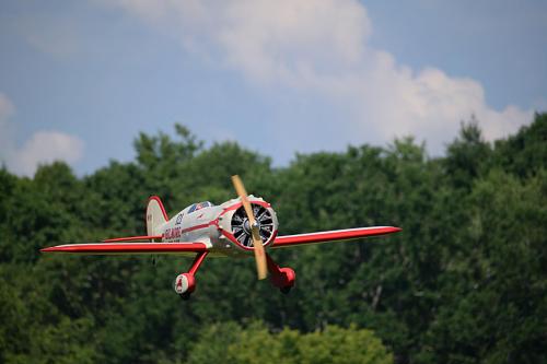

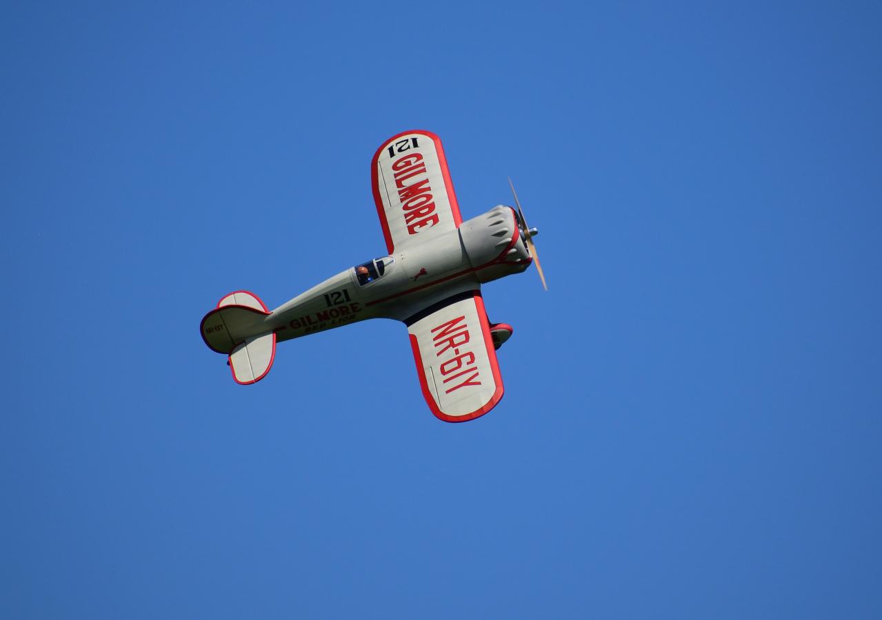

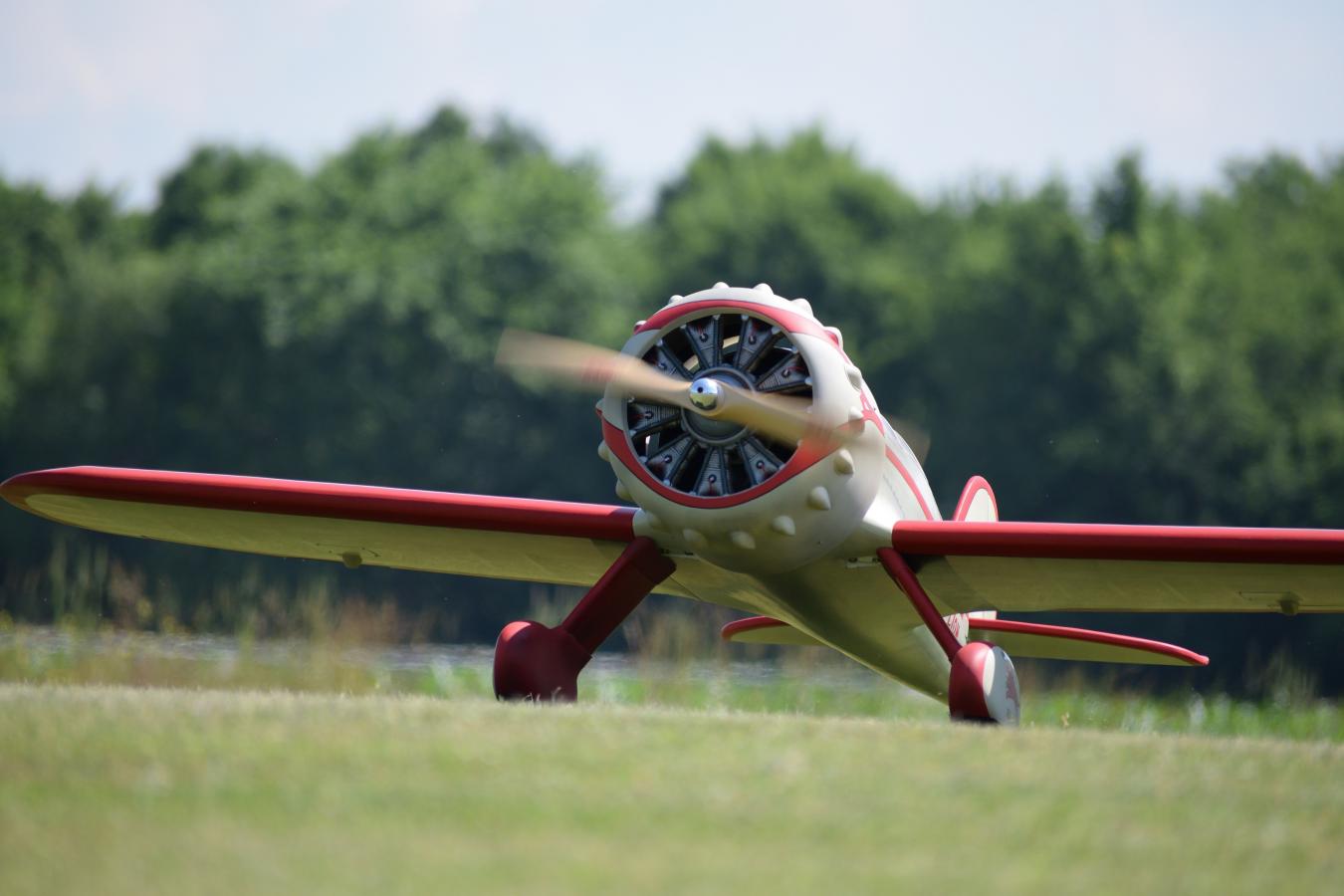

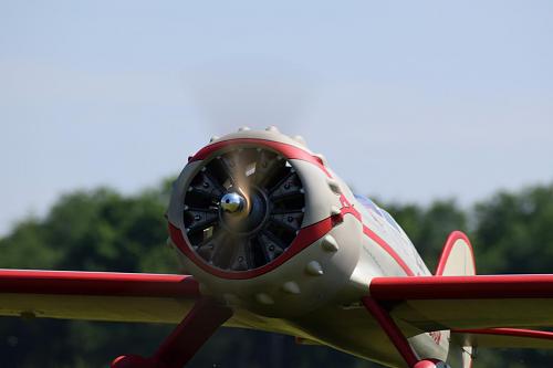

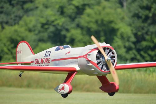

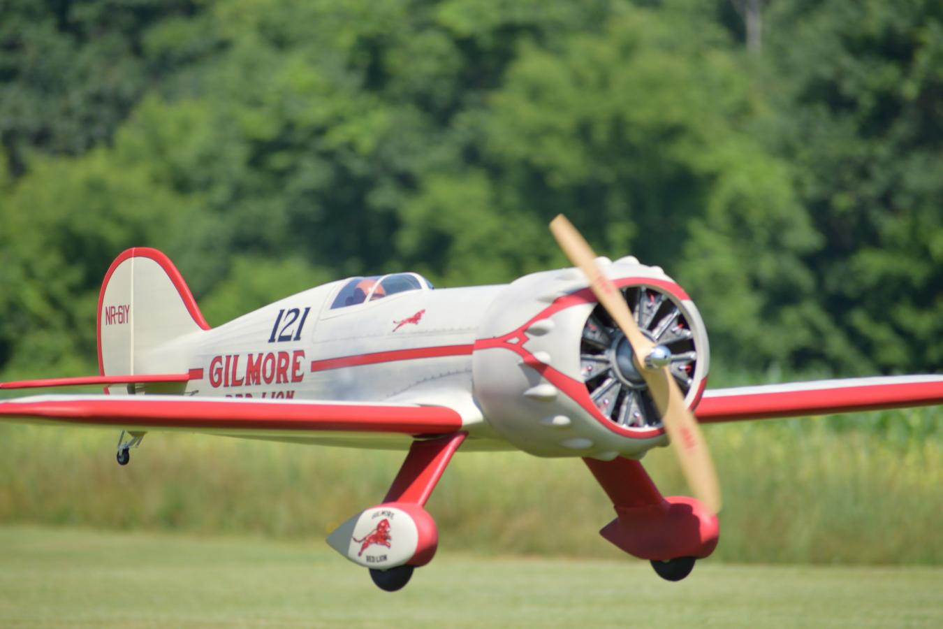

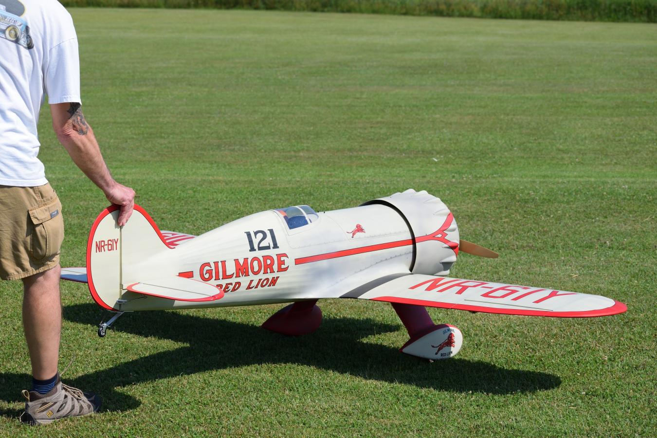

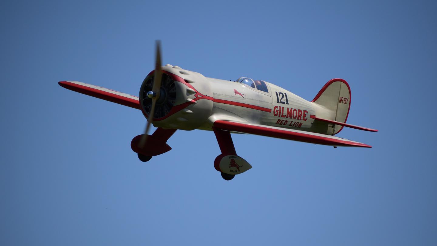

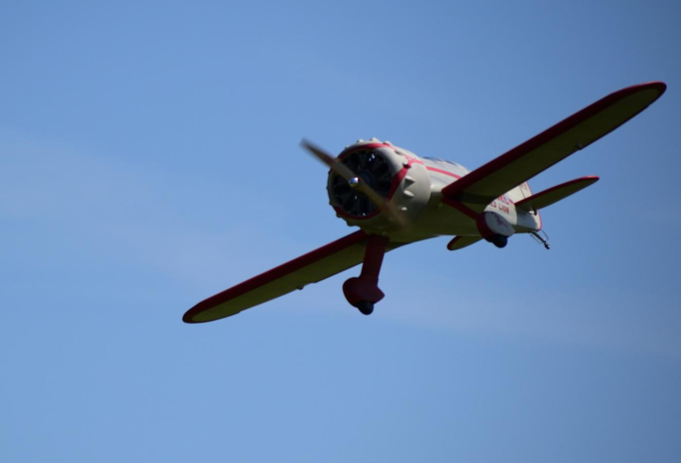

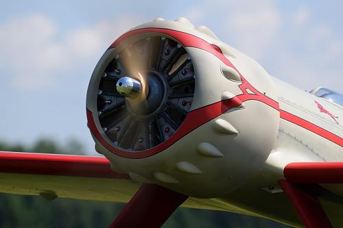

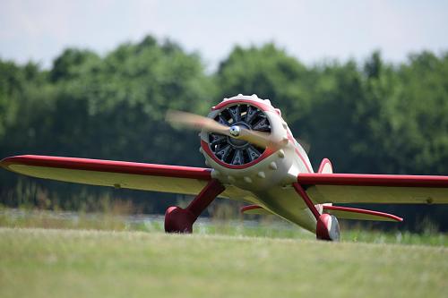

                        Got a chance to get the Gilmore out for a couple of flights today. It flew like it was on rails. The lastest ballast addition did the trick. Total lead added is now at 30oz.
                        As soon as I have the chance, I'll get it on the vanessa rig to see where the CG wound up at. It sure feels good to have it flying the way it should now.

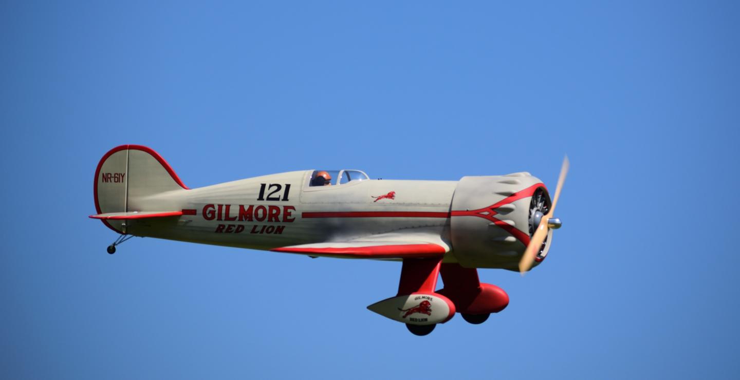

                          #52

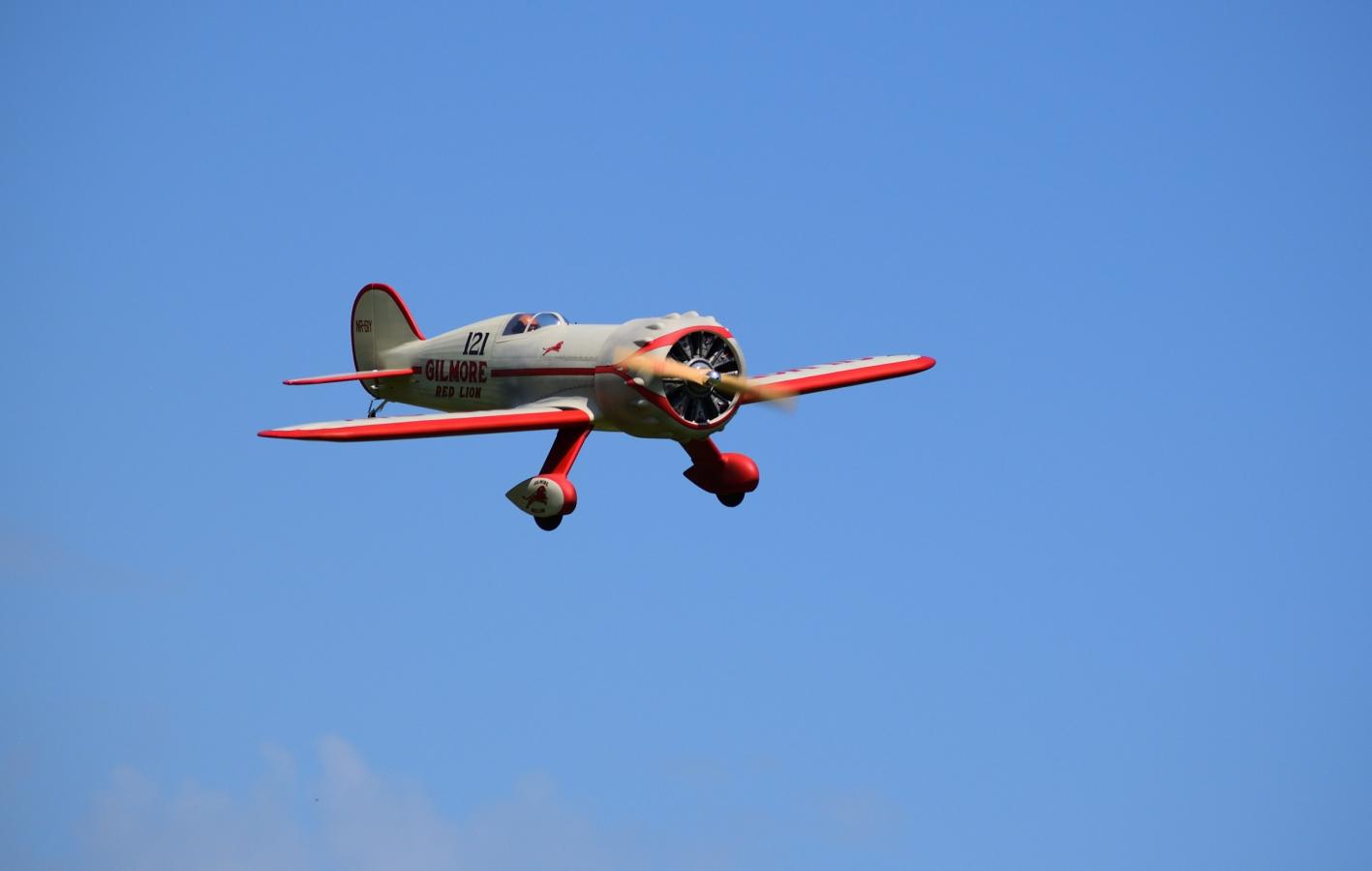

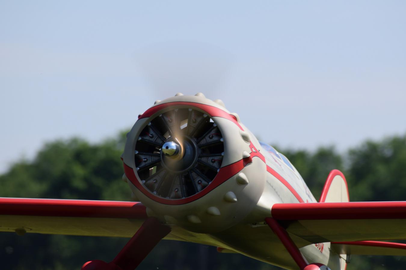

                          The Gilmore Red Lion balanced at between 112-113mm on the vanessa rig. Now I'm looking forward to flying it at events. Unfortunately the Rhinebeck Jamboree has been cancelled for 2020. It will be flown there next year. There are still a few others on the event list.
                          If you are a fan of classic Golden Age avaiation, this is a bird worth adding to the hangar. There's just something special about an airplane with a big round cowl. Good job Black Horse and Motion RC!

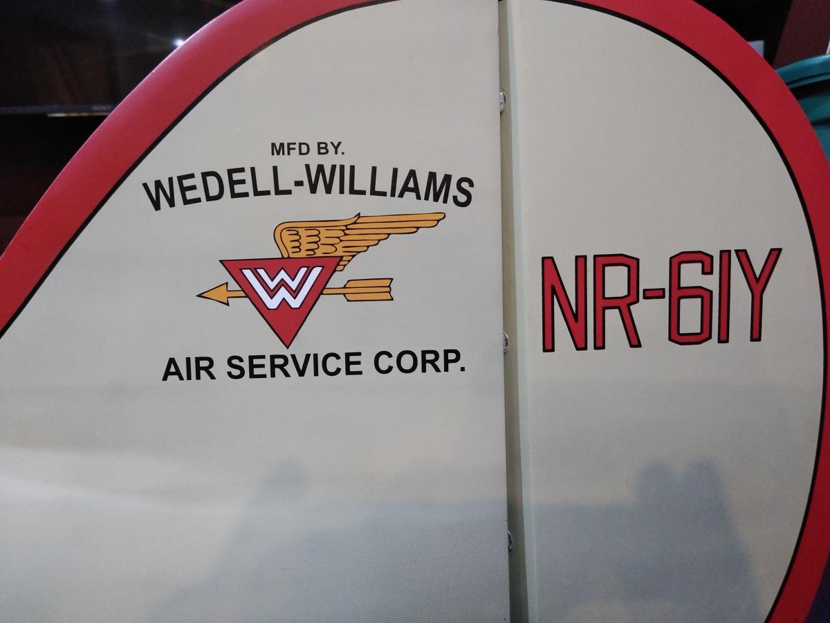

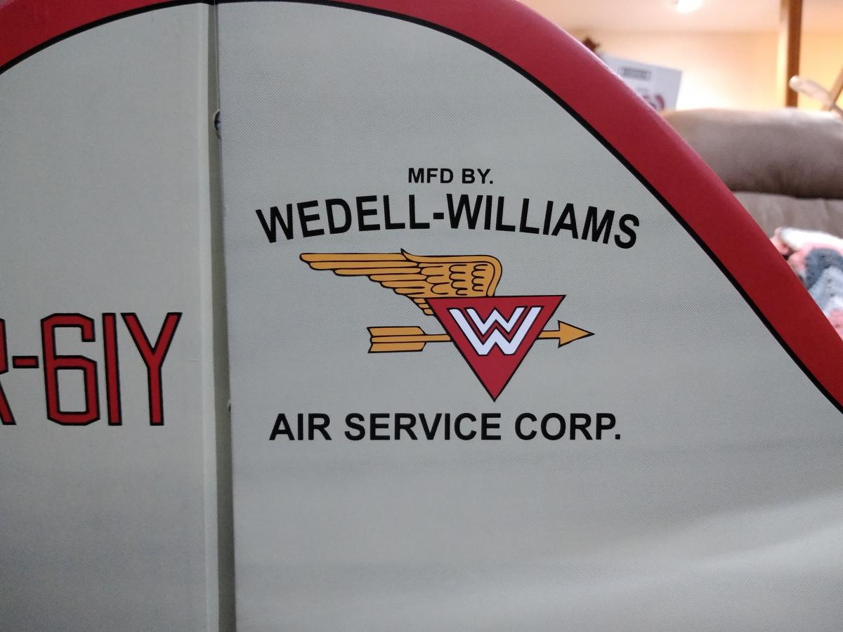

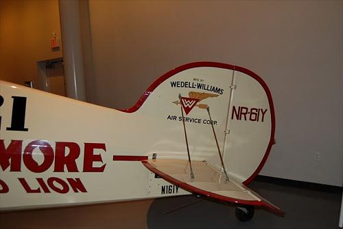

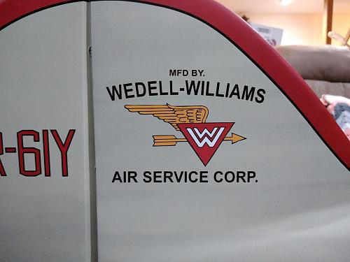

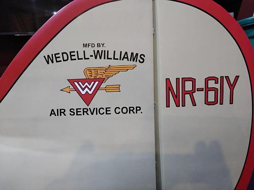

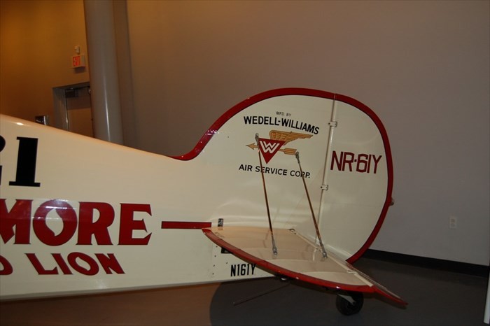

                                      A big shout out to Callie Graphics for producing the Wedell-Williams tail graphics for the Gilmore Red Lion. The vertical stab just looked a bit incomplete without them.
                                      Just tell Callie that you want the same Wedell Williams tail graphics set she made for Tony Jensen, and she can hook you up. They are done in a matt finish so they blend right in.
