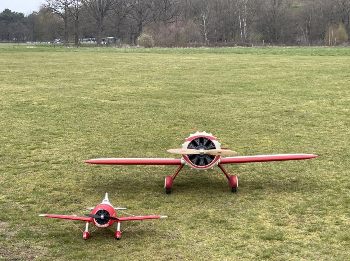

                                      #238

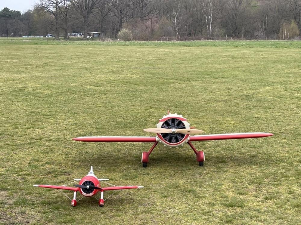

                                      Father and son Click image for larger version

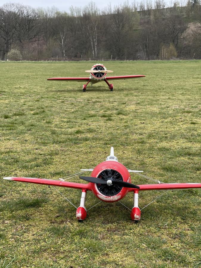

                                        #239

                                          #240

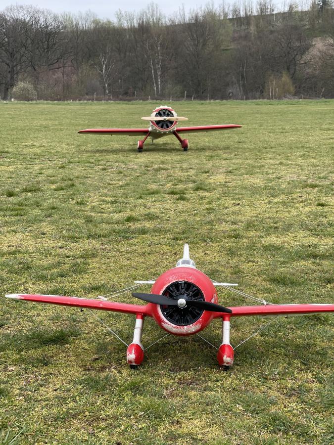

                                          Awesome picture.
                                          Love big one and small one. Can't wait to get mine together and running.
