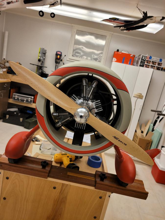

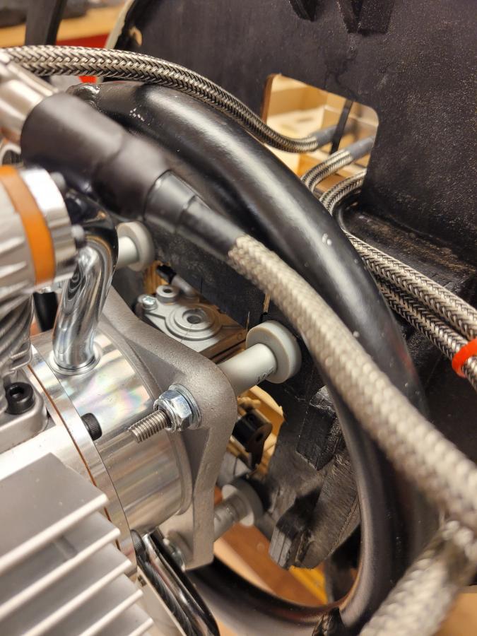

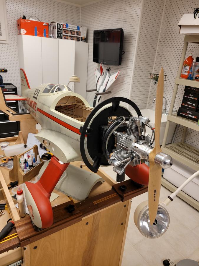

                    Coming down the home stretch on mine. Engine (Saito 90) is finally mounted. Went with 10-32 bolts from inside the firewall, through two spacers into a lock nut. That gave enough clearance between the keleo ring and the firewall. Had to shave down the two plywood tabs on the left side of the firewall (as you look at it from the front).
                    All that's left to do is plumb in a gas tank and add radio gear (receiver, batteries, etc.).
                    FYI- the closeup of the firewall showing the spacers makes it look like sparkplug wires are resting on the muffler. Not to worry, I took care of that before I mounted the cowl!

                        Looking good RCBobP.... That saito FG-90 pulls the gilmore fantastically with a 24x12. OHHH THE SOUND!!!!!!!!!!

                            Yes, that sound. Purrs like a kitten! Did you have any issues balancing the plane? That engine adds some weight to the front, so I'd like to see how you set up "under the hood". Battery placement, etc. Did you have to add any aft weight? Did you balance at the 112 mm mark?

                              No problems at all with balancing the plane. The heavy motor helped quite a bit. I didn't have to add any additional ballast or weight. I am using the 112mm CG and it's perfect. I included a picture from when i was laying things out during assembly. I'll get an updated picture and post later. However things didn't change. Fuel tank / batteries / switches etc all stayed in the same location shown.

                                406PIlot Nice clean install. Pretty easy to do when there's an area the size of most garages to work with lol.

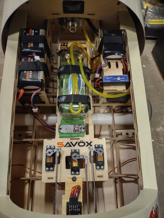

                                    Ok here is a picture i snapped when i got home from work.

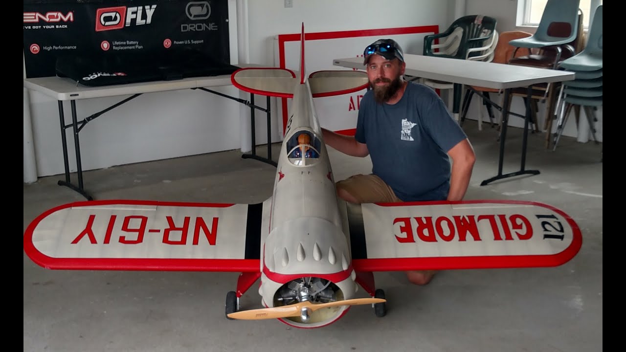

                                      She has flown! One maiden flight, I was the only one at the field, so no video.
                                      AUW: 23.45 lbs (no lion, closed cockpit, 12S 5200mah)
                                      CG: 114.6 mm from LE
                                      Batteries:
                                      2 6S 5200 Zee packs - https://smile.amazon.com/gp/product/B08GLMY3BT
                                      1 2S 2200 pack for Rx
                                      Taxi and takeoff were no problem...needed right ridder to keep her straight, but that's par for the course.
                                      I personally need more aileron. My high rates were per the manual and I'll be adjusting.
                                      This plane loves rudder...if you don't fly rudder, you might not enjoy flying this plane and it's probably not going to look great in turns. The good thing is that this plane responds well with rudder input. Not only in coordinating turns, but for aligning your lines, not to mention corrections for your landing approach.
                                      Rudder rate as stated in the manual is perfect.
                                      I need more time on the elevator...I stayed on high rates the entire flight...as I didn't want to loose any aileron. Yes, as she flew yesterday, some would say pitch is twitchy....but I didn't notice any other tail heavy tendencies...so as of right now, it's just nicely sensitive on pitch. (this has been stated before in the thread...I'm just confirming with my experience)
                                      In fact...at 114.6 CG, everything pointed to it still being nose heavy. I wont know for sure until after a few more flights. I'll keep in mind that even if it's nose heavy...moving the CG back will give the elevator more authority. It truly is a balancing act to get everything the way you like it.
                                      Landing in just mowed grass on a rolled field was butter. Not even a bounce. (another reason I don't think it's tail-heavy) I stayed with the stock wheels and had no problems. However I BET landing on pavement wouldn't be as smooth.
                                      More to come!
