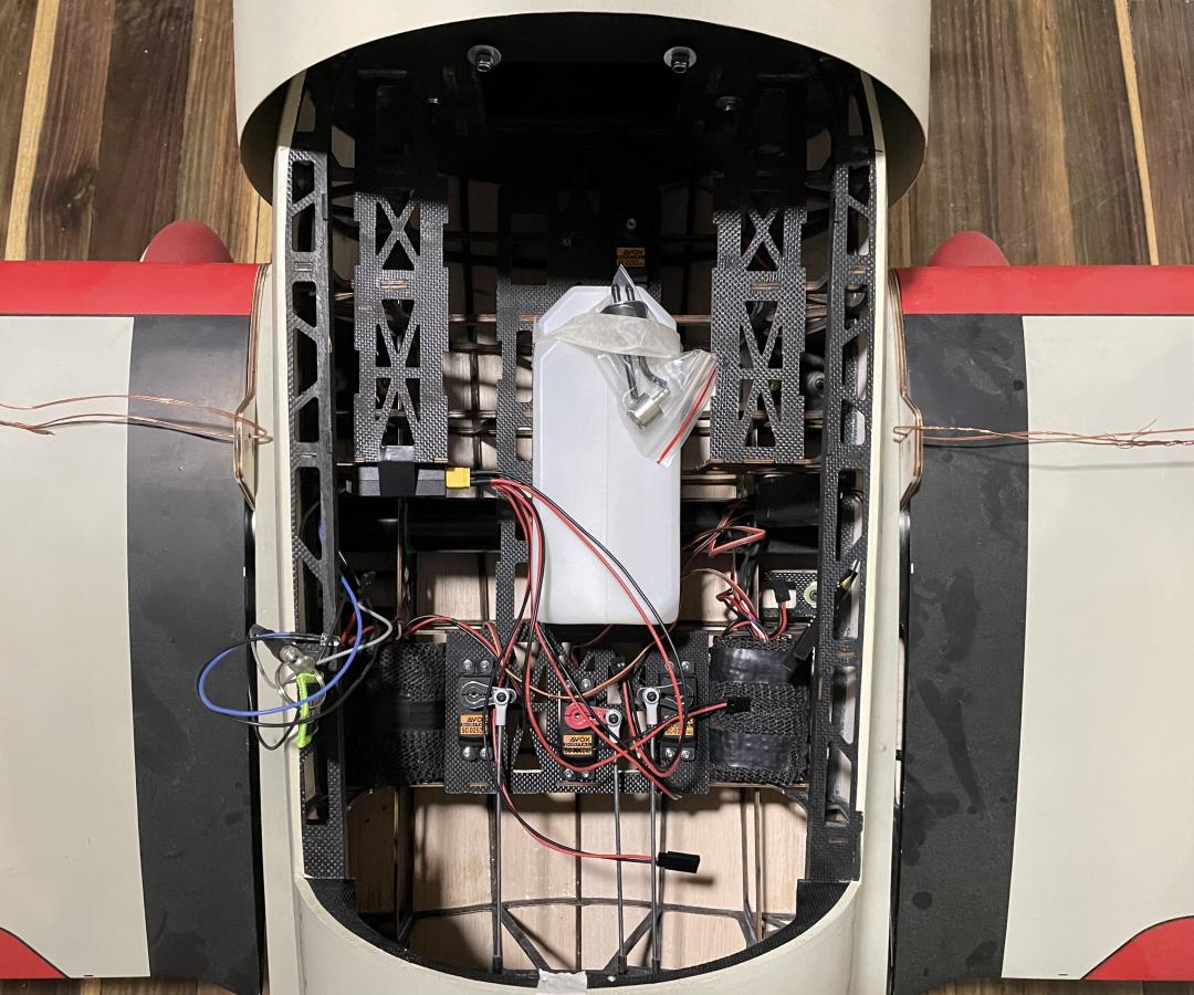

                  My build has slowed compared to when I first started. Apologies for the delayed updates
                  Prior to ordering the Sullivan Skylite wheels I installed a pair of World Models inflatable wheels but they feel a bit on the heavy side which influenced my decision to pull the trigger on the Skylites. I managed to modify the CG rig by filling in the existing 1/4-20 hole at 118mm and making a new 4-40 hole at 112mm as recommended.
                  With the current set up:- UMS 575 for motor, two A123 packs, BoomaRC redundancy switch and the inflatable wheels, I’m able to balance with things as arranged in the picture.
                  I expect with the Slylite wheels installed, I may need to move the batteries forward a bit.
                  Hopefully, this weekend I will be a bit more productive.

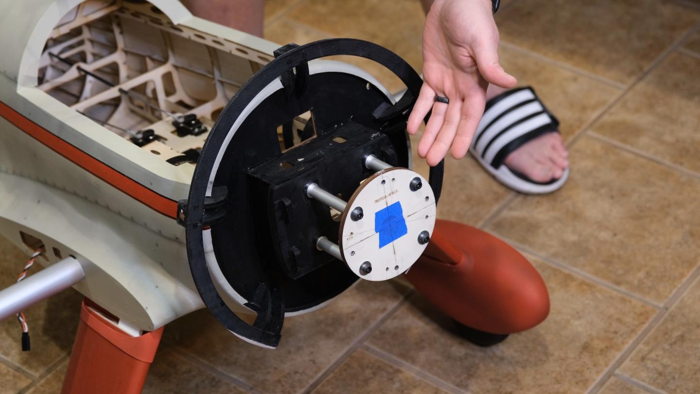

                                  Anyone mount a Saito 90 with the Keleo ring? Looks like I may need to tear out a lot of the motor box to get it to fit, unless I'm missing something here.
                                  Thanks.
                                  • 406PIlot
                                    • Nov 2020
                                    • 381
                                    • Billings, MT
                                    #417
                                    Thanks.
                                    I am not using an exhaust ring but i do have a Saito FG90 R3 mounted up. Yes i did have to take a chunk of the motor box / mount out for the carb to fit into the fuse. Just use the template that is included with the FG90 and you'll have no issues.

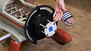

                                      That part I got, no problem, but unless you use a larger standoff, the keleo ring wont fit over the motor box, so I think some of the motor box has to get taken out. With the Saito engine you can't get longer bolts in because of the engine design. The cylinder heads block the bolt holes. Anyone have a work around?

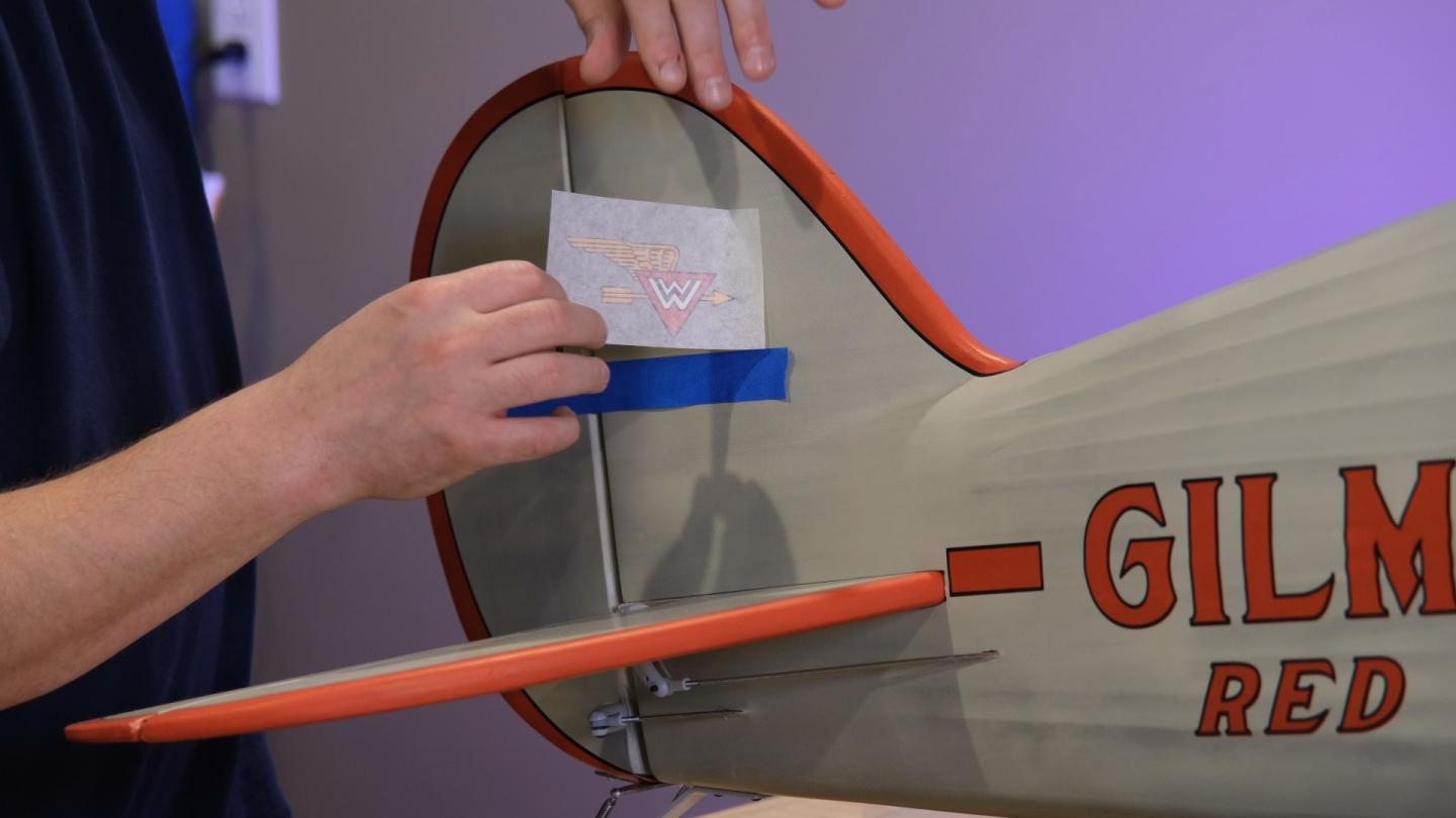

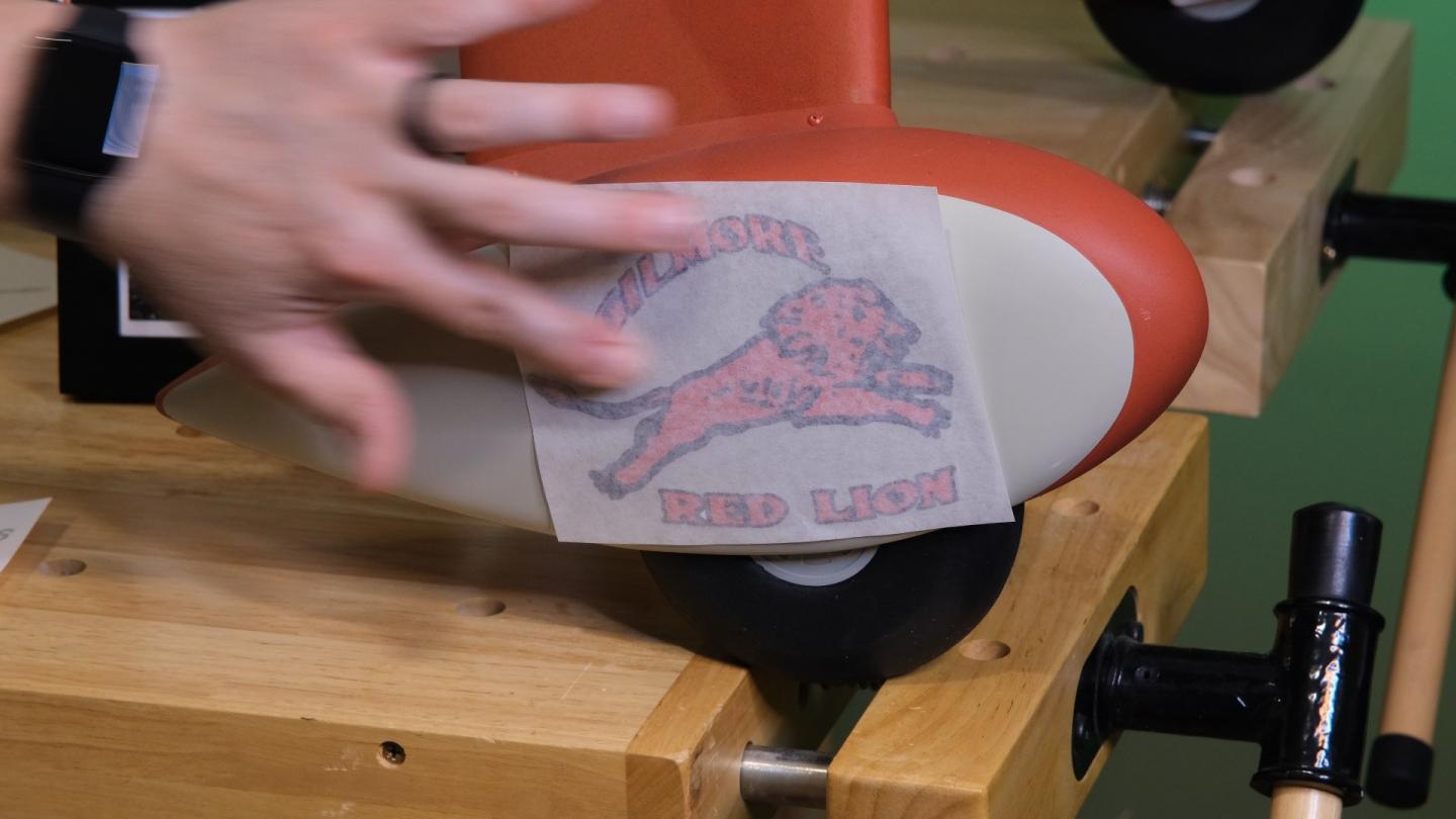

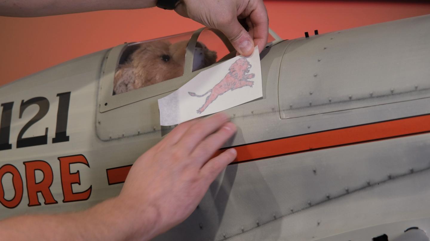

                                        The last build episode is up! Enjoy! This episode shows how I mounted the ESC and applied some graphics. (thanks Twowingtj for the nod to Callie!)
                                          You can use longer bolts, but you have to take the mounting plate of the engine in order to get the longer bolts into place.
