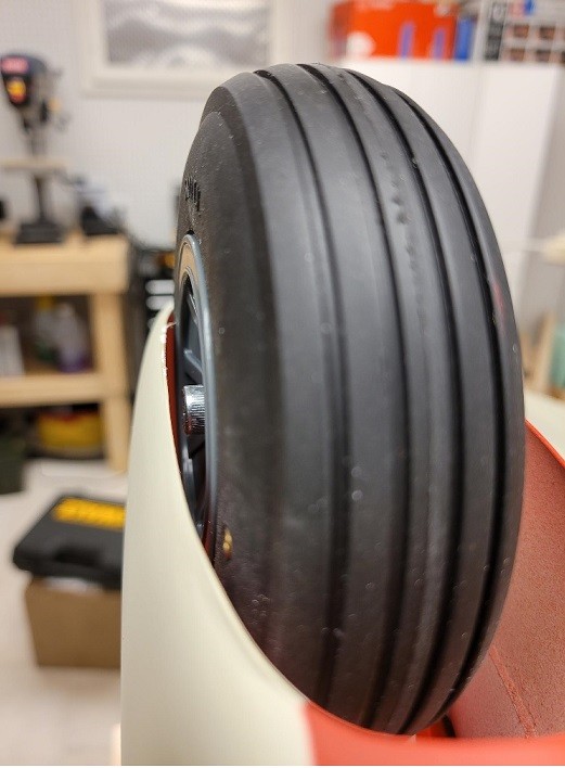

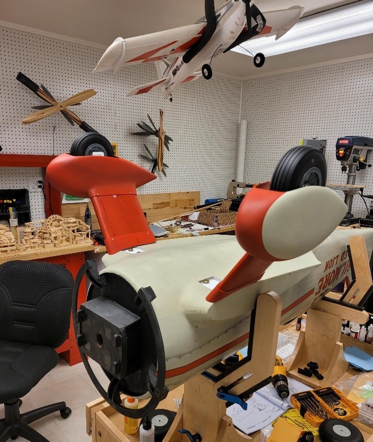

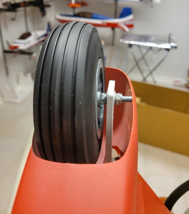

                                    Wheels pants and wheels mounted!
                                    Went with the nylon nuts as recommended by djmoose. I purposely mounted the wheel pants a little higher because I'll be landing on grass. Also went with pneumatic wheels. Looks like I'll need to find that magic spot of tightening the assembly enough so that it won't wobble, but not too much that compression will stop the wheel from spinning freely. Also looks as though I need to trim maybe 1/4" off the end of the axle bolt so it doesn't press against the wheel pant and distort it. Finally, it the pant may need some trimming on the outside so the wheel doesn't rub against it. Will know better once I cut off some of the axle and let the pant take its shape.
                                    Once I'm satisfied with this, I'll turn it upright and attach the elevator and rudder.
                                    Moving slowly, but worth the wait.
