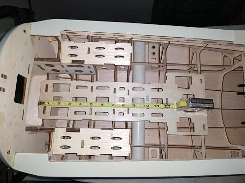

      The gear are pretty heavy. Where are they compared to your desired CG?
      Originally posted by RC ML
      Next problem , make the cg thru extra weight or thru extra batteries .
      I measured both .
      No landing gear mounted . (not possible to measure , practical issues.)
      With extra weight cg 111,9 mm total wit = 10358 gr

        Complete assembled with landing gear i came on 107 cg (included +-600gr weight)
        Tomorrow i have to play some more with that weight and position of the batteries to get it right

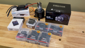

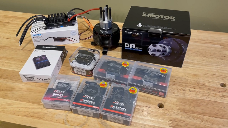

          The Gilmore just got delivered. I'll be unpacking things later this afternoon / this evening. Servo's & Engine have shipped out as well. Hopefully those will be in next week. Things will start going together very soon!

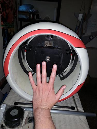

              Regarding the Saito 90, Ray English, recognized Saito guru (I got mine from him after his modifications) suggests 24X12. It's a heavy engine. Would love to see someone's setup "under the hood" to see where/how they mounted batteries to get CG balance correct. Think there's enough room for a smoke tank?

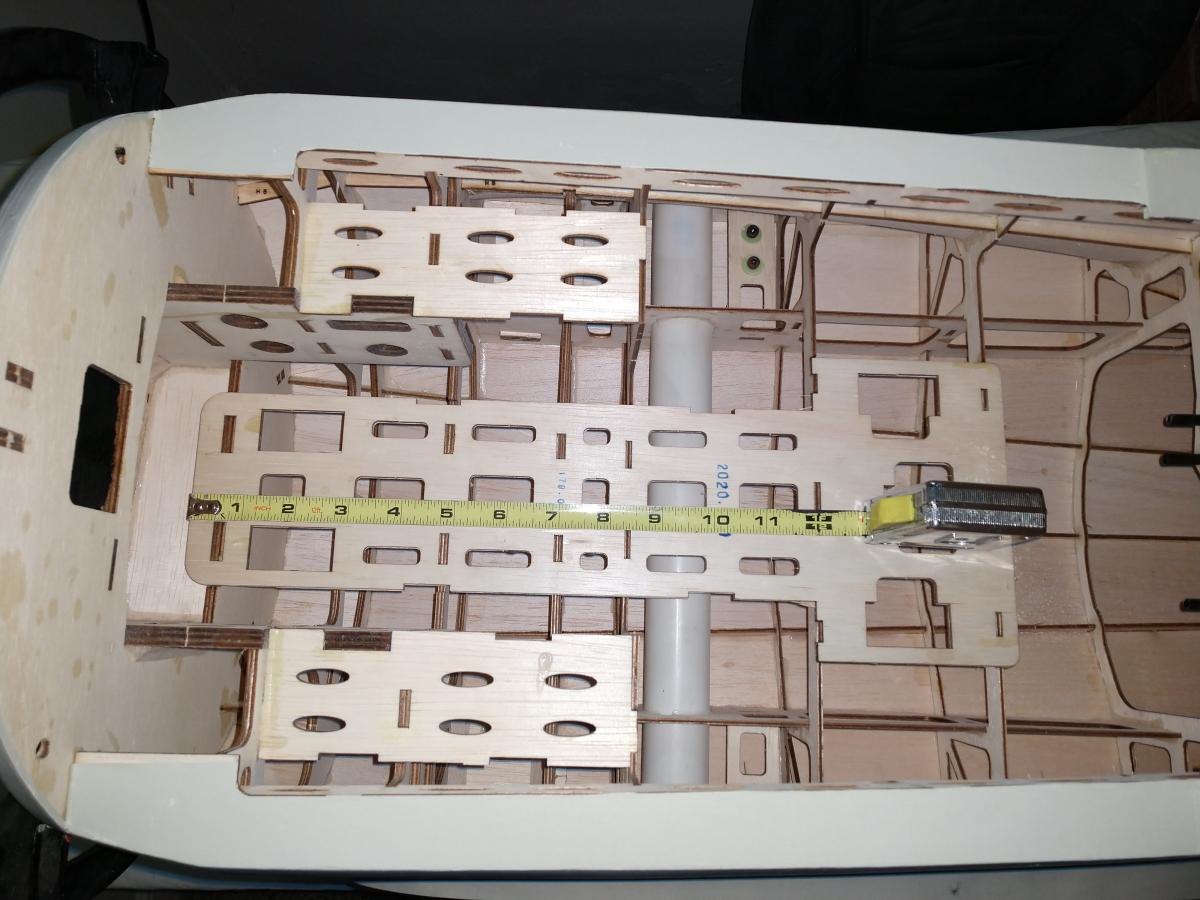

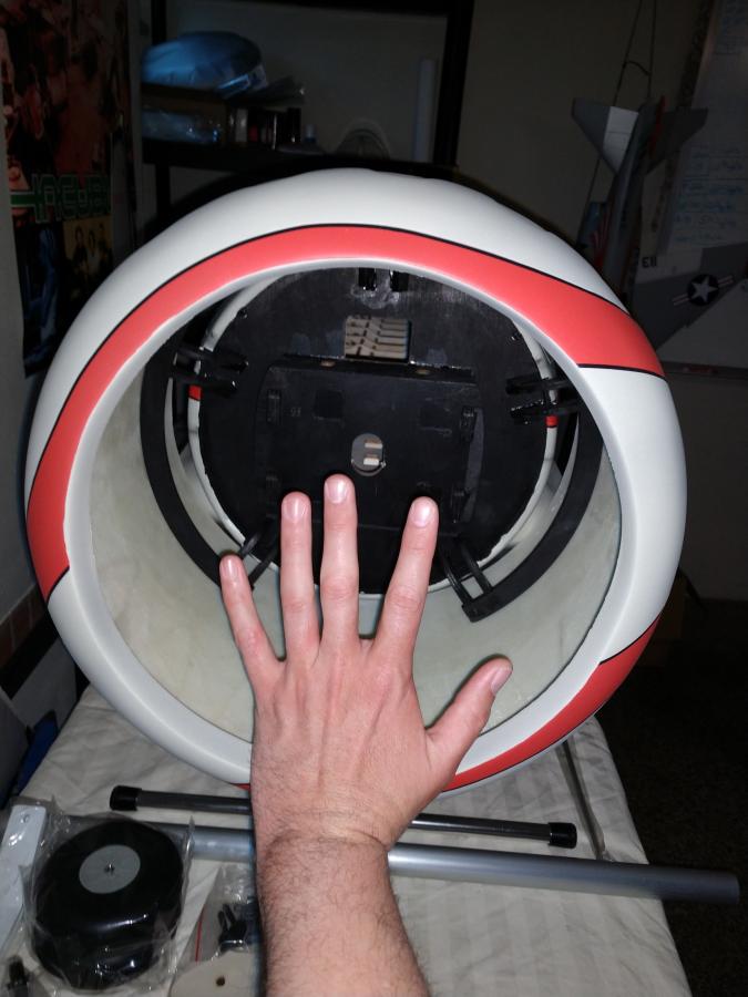

                There is a ton of room in the cowl and fuse. I'm planning on running a 24x10 to start with.
                Here a few quick pics I just took for ya.

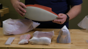

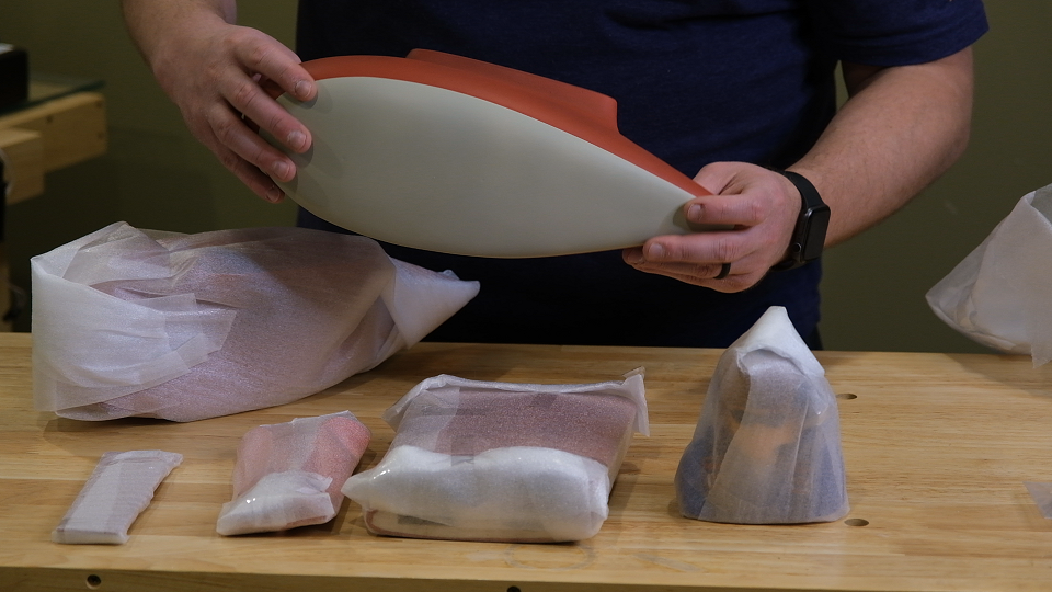

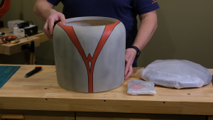

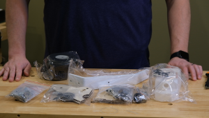

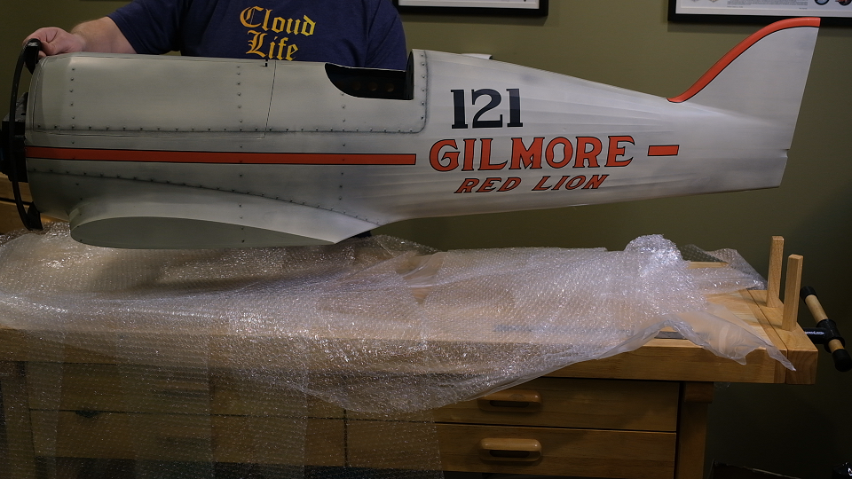

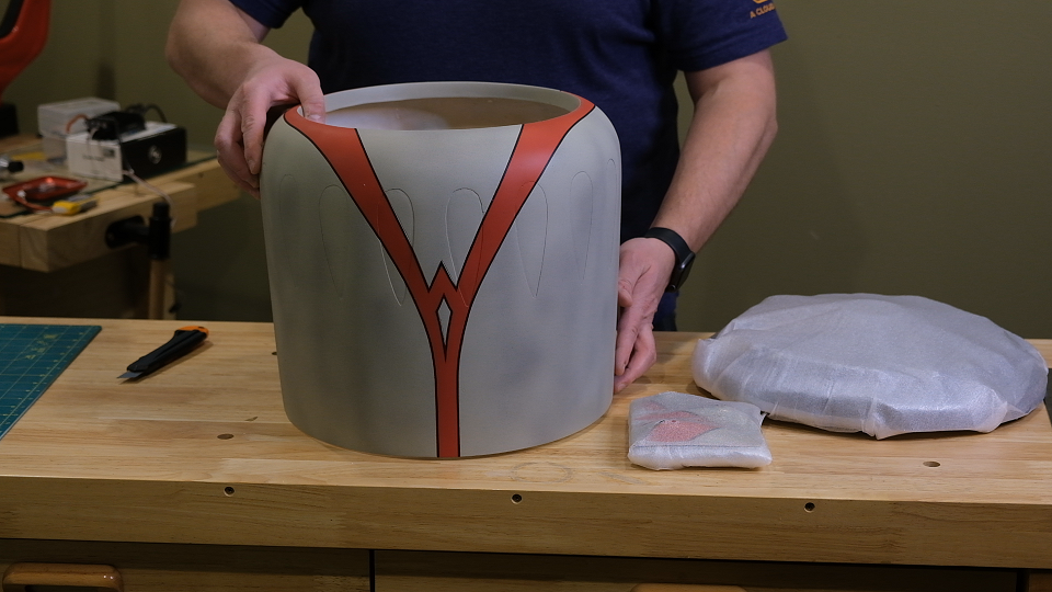

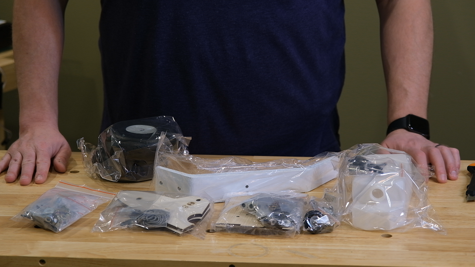

                  Unboxing video with the first of my footage from the Crawford Auto & Aviation Museum! Enjoy!
                  Click image for larger version  Name:	snap1.png Views:	0 Size:	801.3 KB ID:	305987Click image for larger version  Name:	snap2.png Views:	0 Size:	850.5 KB ID:	305990Click image for larger version  Name:	snap3.png Views:	0 Size:	858.4 KB ID:	305988Click image for larger version  Name:	snap4.png Views:	0 Size:	819.1 KB ID:	305992Click image for larger version  Name:	snap5.png Views:	0 Size:	762.4 KB ID:	305993Click image for larger version  Name:	snap6.png Views:	0 Size:	751.5 KB ID:	305991Click image for larger version  Name:	snap7.png Views:	0 Size:	766.6 KB ID:	305989Click image for larger version  Name:	snap8.png Views:	0 Size:	886.2 KB ID:	305994Click image for larger version  Name:	snap9.png Views:	0 Size:	672.5 KB ID:	305986
                    #189
                    djmoose Great job on the video!
                    The covering is self adhesive. It will tighten up with heat and will likely need some after its first time in the sun. Mine did.
                    The best way to tighten, if needed, is to use a heat iron with a sock on it. Set the iron temp accurately between 210 and 230 degrees F. Too much heat will "over shrink" the covering causing it to distort and misalign with the printed pattern. If shrinking over a sheeted area, press the covering to the wood after applying the heat. this will ensure the covering is adhered to the wood.

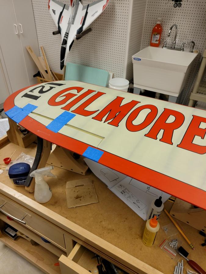

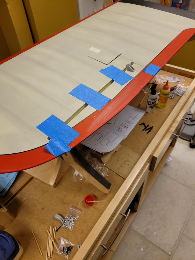

                              Ailerons now installed. The pre-drilled holes were nice, but maybe a scoche too wide. Really needed to coat the pockets with epoxy, and be sure to twist the hinges to get an even coating. Hopefully I did a good job. Thanks again to twowingtj for posting that video.Click image for larger version

                                #195

                                  #196
                                  [QUOTE=RCBobP;n306168]Ailerons now installed. The pre-drilled holes were nice, but maybe a scoche too wide. Really needed to coat the pockets with epoxy, and be sure to twist the hinges to get an even coating. Hopefully I did a good job. Thanks again to twowingtj for posting that video.
                                  I noticed the same thing about the pre-dilled holes on the ailerons! I actually got my ailerons / hinges epoxied in last night. Did you check to make sure you had all the hardware? Mine was missing the screws for the servo covers. Not a huge deal I have some that will work with no issues, but I was a little disappointed they just flat out forgot to add those in.
