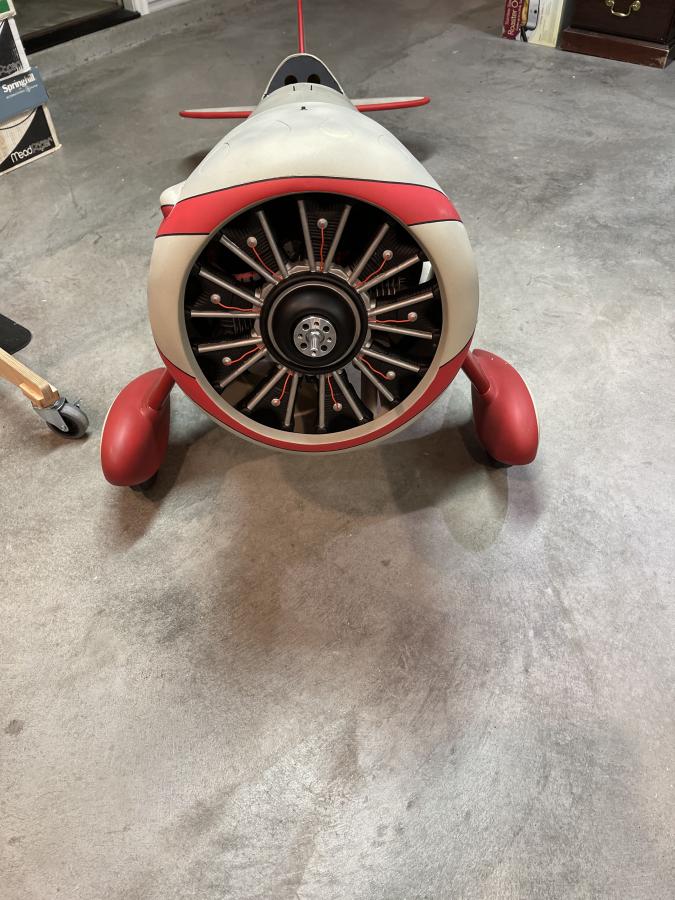

              • Since resolving the issue with installing the cowl, the next focus was getting the engine mounted. After exploring the various options(modify engine box or rebuild new engine box) and talking with Adrian at CH-Ignitions, the decision was made to modify the mounting plate on the UMS 5 75cc engine. The modification was successfully completed and the engine installed.
                Can someone please check and share the distance from the front of the cowl to the cowl ring with the cowl installed? The cowl that came with my kit has what appears to be only one small dimple unlike the three as indicated in the manual. I wish to be certain this is the correct location for the mounting screws. See below picture.
                With the cowl positioned as per the single small dimple, it would appear that I will need to move the engine forward about 1.5 inches for the prop to clear the front of the cowl. Has anyone modified their cowl any by cutting out a bit by the leading edge of the wings?
                Sharing a few pictures below.

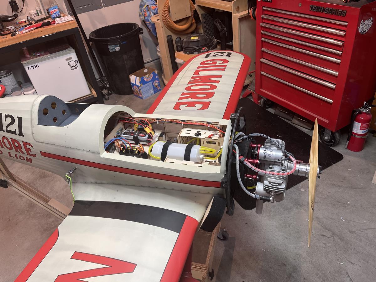

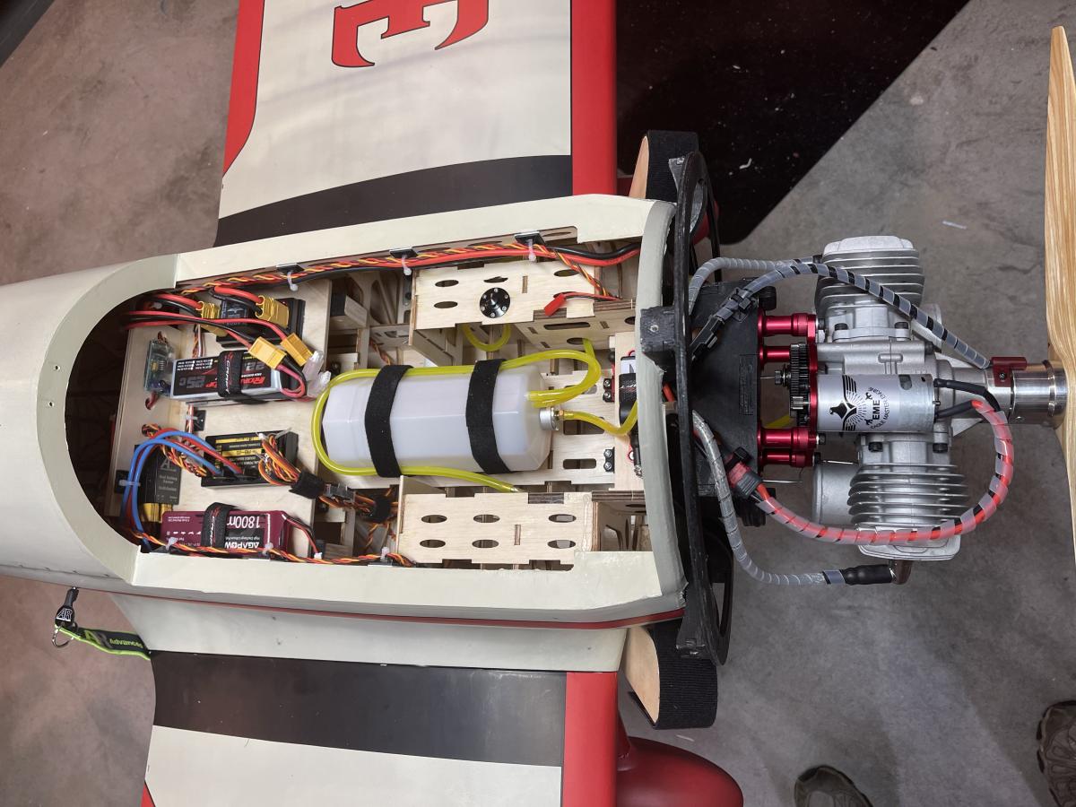

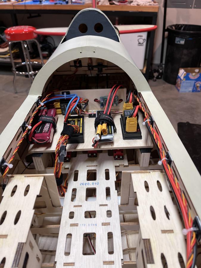

                      • First time for me posting any pictures here...
                        I am about 90% complete with this build. I am running an EME 70cc Twin with the auto-start.
                        I had to move all the radio gear back to assist with the CG but I have not completed the final balance yet.
                        Bonding all of the blisters on the will be, ummm, a good time, so I have left this challenge till last.
                        • mechwizz Thanks for sharing photos of your setup! Nice powerplant, and a clean install, too. Very neat.

                            • Originally posted by mechwizz View Post
                              Thanks for sharing your build.
                              Your engine/auto-start combo appears to be similar in weight to my UMS 5 75cc. I note, with the exception of the fuel tank, you’ve place most items in an aft position. I will most likely follow your install as a guide. Should be able to provide comparative notes in the coming week.
                              All the best with your build, please continue to share progress.
                              DaleD
                                Thanks for these helpful photos. Let us know how the balancing goes. Meanwhile, I'm looking at the suggested throws. Are they pretty much accurate? 10 mm on the elevator (12 mm high rates) doesn't seem like a lot of throw for a plane this size.
