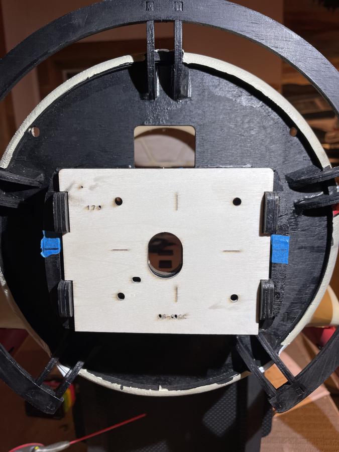

              #146
              i used the engine mount to locate the holes for the electric motor mount.

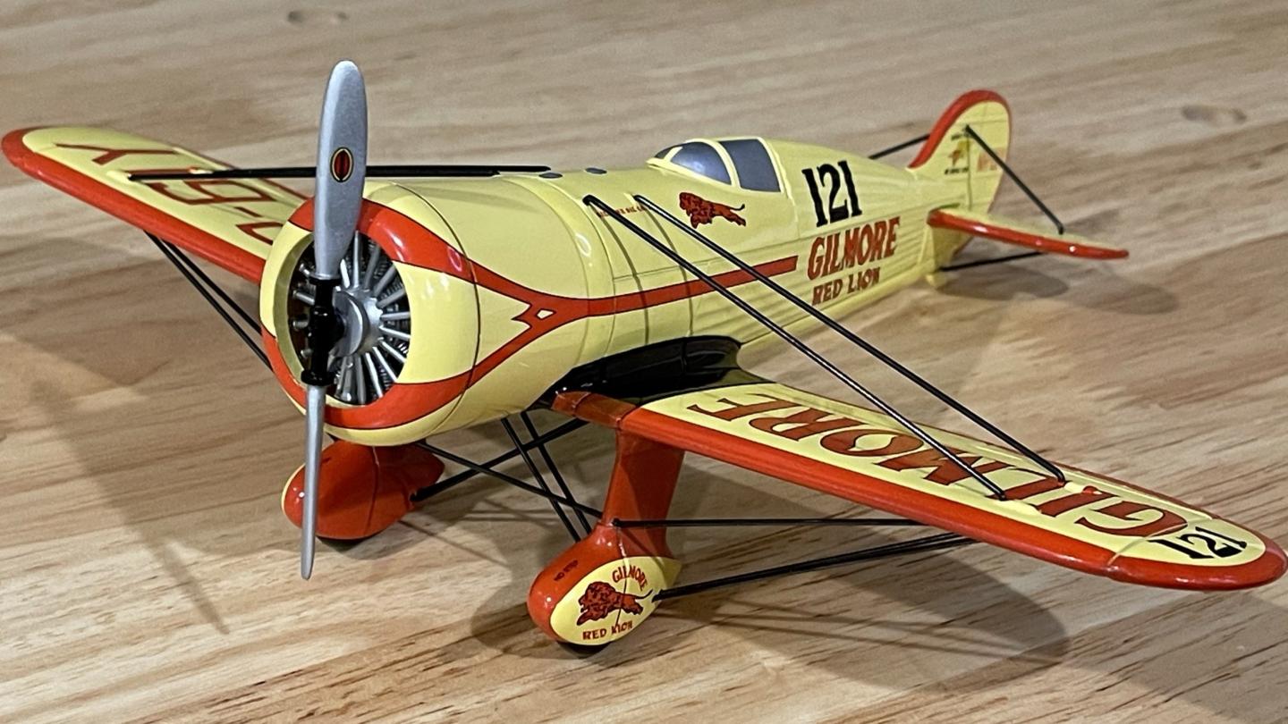

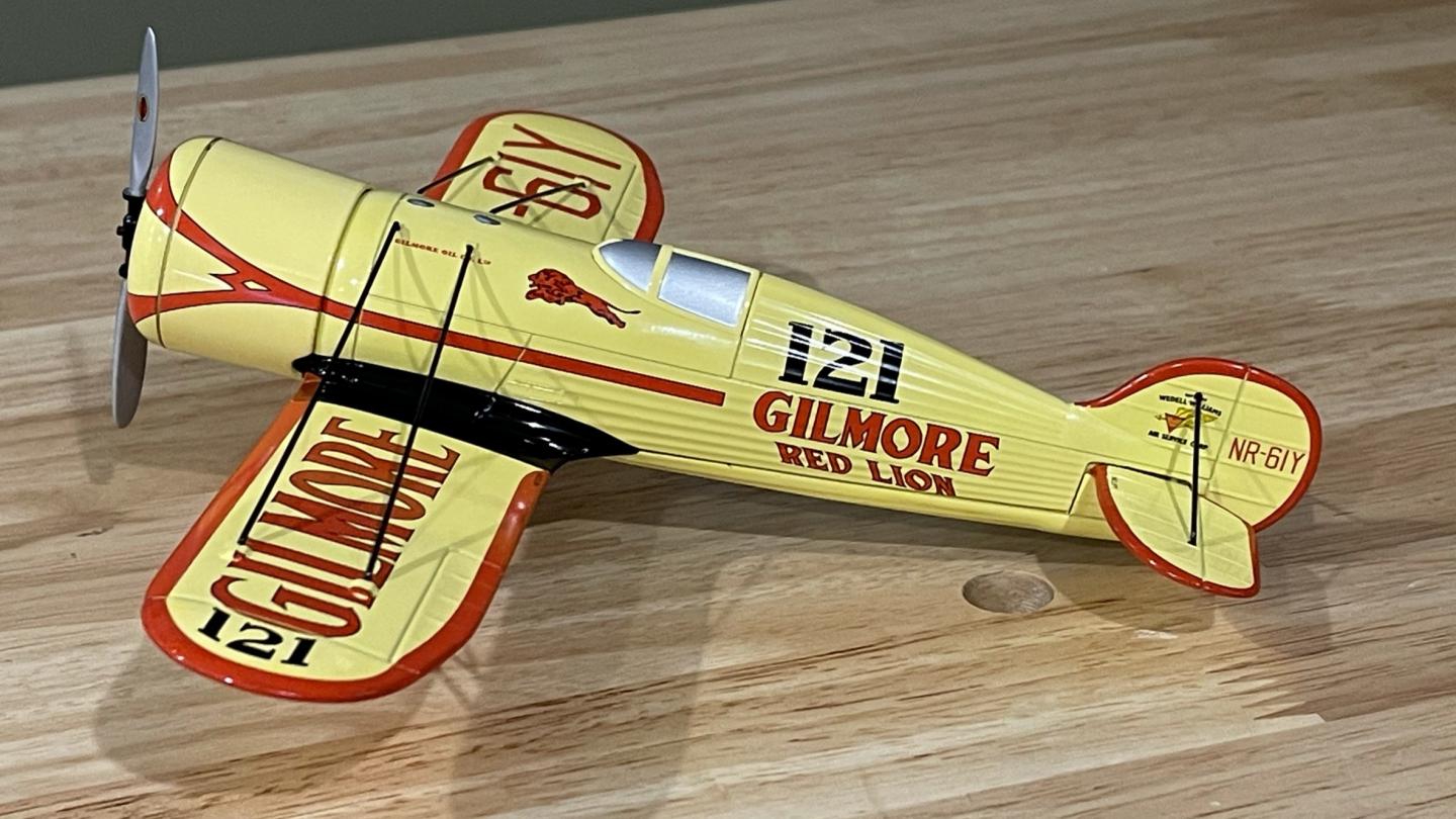

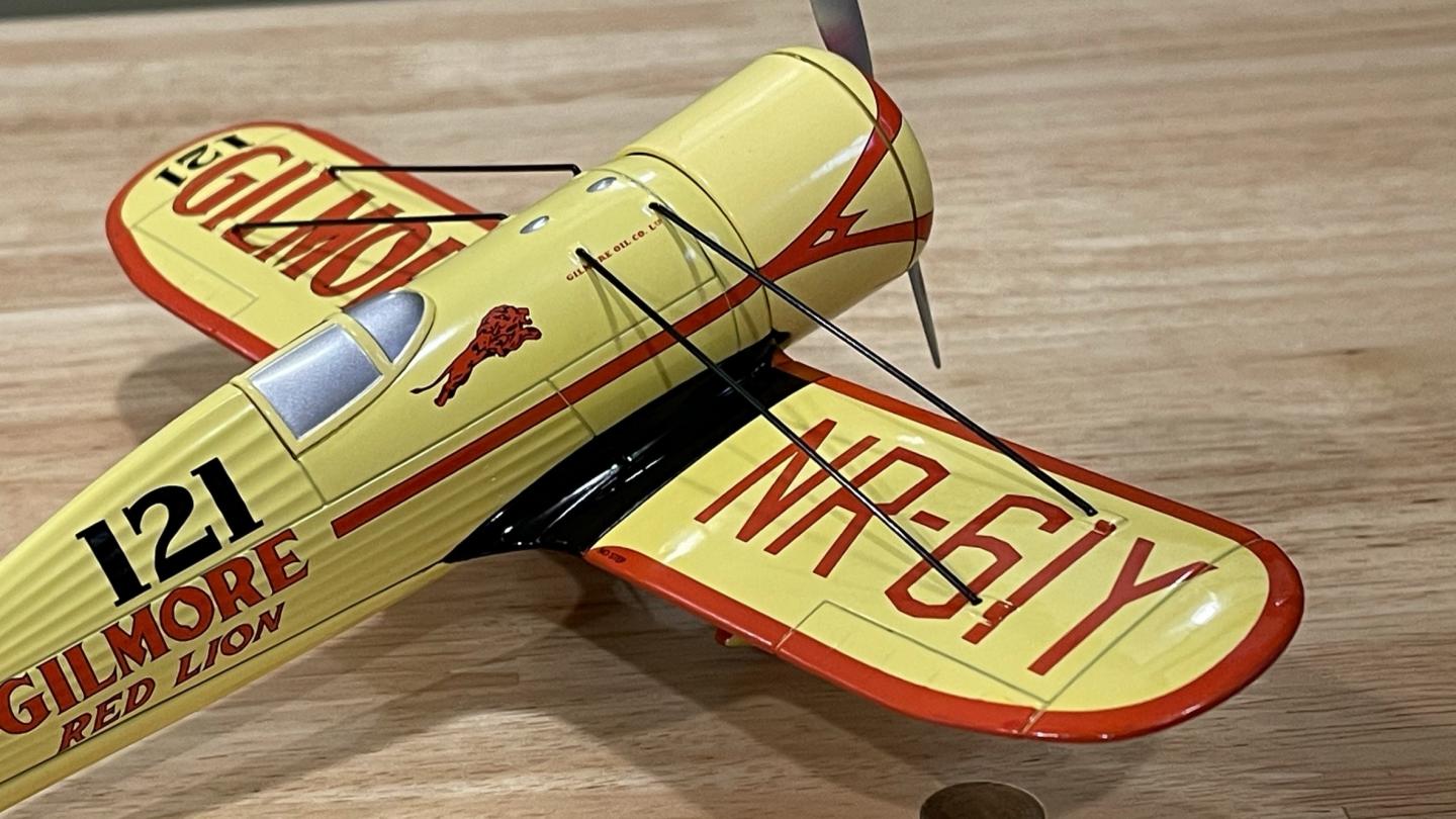

                      It's almost time to get started on mine! I have to finish up a few things, but took some time to assemble THIS 1:32 diecast Red Lion. 😁

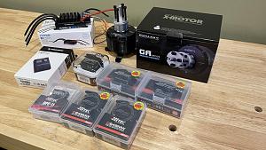

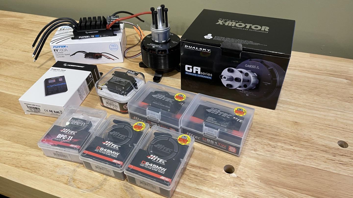

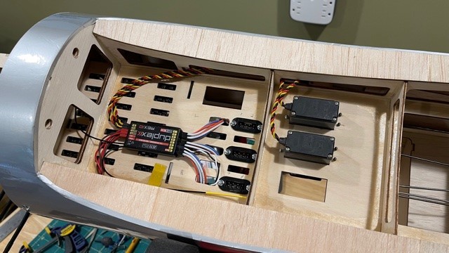

                                    Got all of the electronics ready.

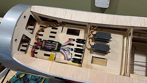

                                        Are you running any sort of UBEC or redundant battery for your receiver?
                                        • djmoose
                                          • 150
                                          • Cleveland, OH

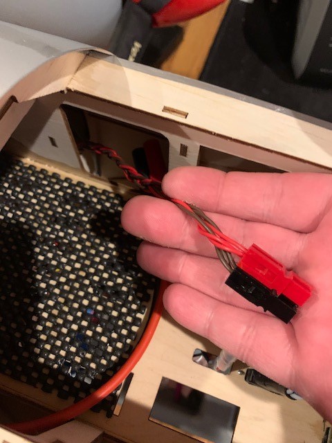

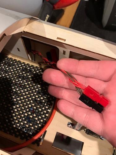

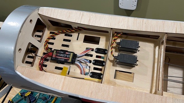

                                          #160
                                          I run a separate smaller 2S LiPo (1000-1500mAH) directly plugged into the Rx.
                                          I make a custom power harness with 3 power connections from a PowerPole (rx battery) to 3 servo connectors directly into the Rx. (red servo connectors into the Rx in the picture below)
                                          No real redundancy, per say, but pure isolation...and 3 separate power connections into the Rx to really assure I can get 15 Amps of pure DC power without voltage drop due to the 5 Amp rating of typical servo connectors.
                                          I set a voltage alarm on my Jeti radio to help detect Rx pack issues. I also see the Rx voltage on my main screen and get a real-time visual of the voltage.
                                          Click image for larger version  Name:	power1.jpg Views:	0 Size:	76.9 KB ID:	305248
