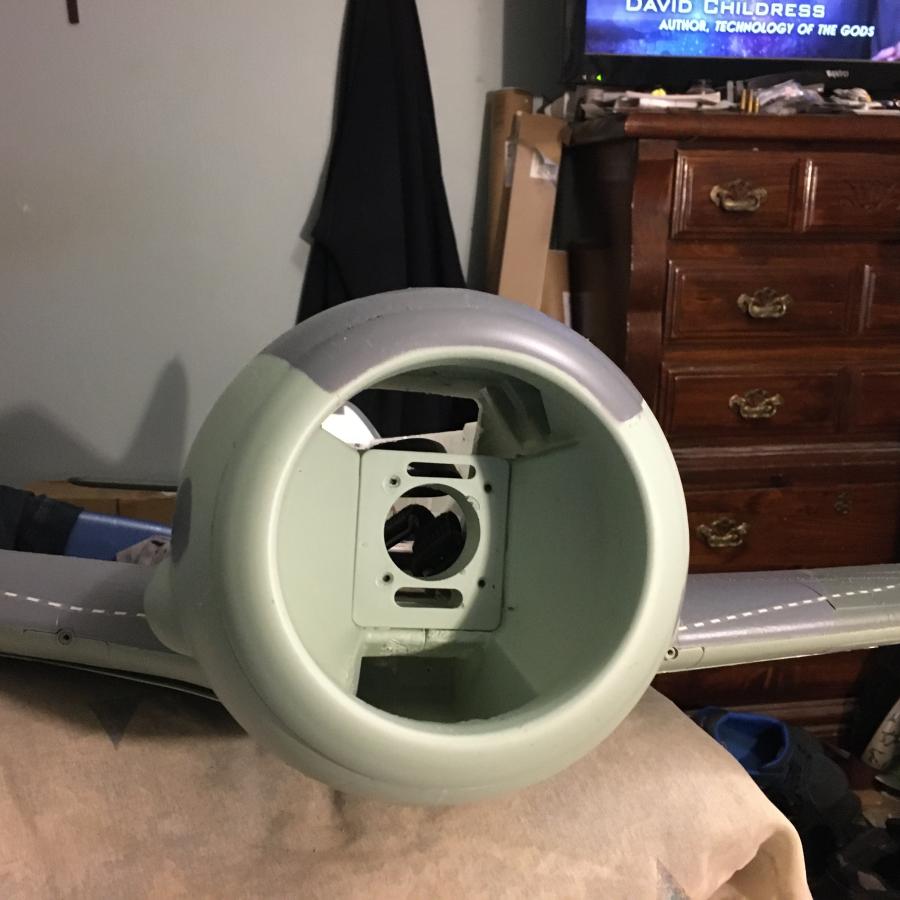

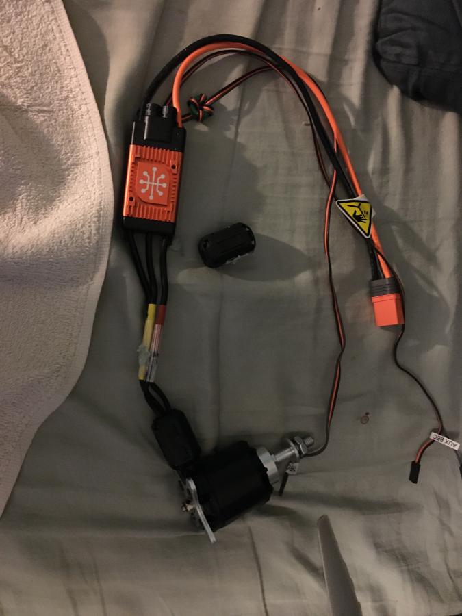

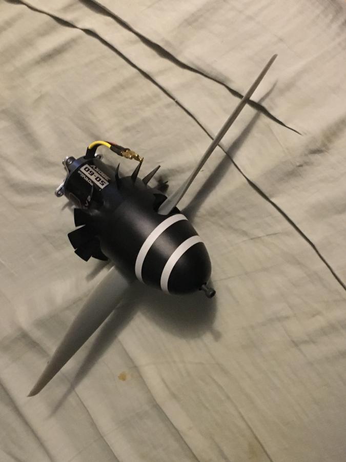

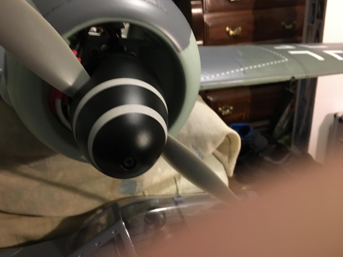

    so, i love the way this plane fly's. i don't like the power plant they picked, i don't think it does the aircraft justice. so i did an engine-ectomy. i replaced the stock power with a turnagy NTM 5060-380 turning a ape 15x10x2 on8s. to follow is my path
    my initial thought was the stock motor was a 4258 and i was replacing with a 5060 so i was only 2mm longer. well, its clear they did not use the same ruler to measure both. the 5060 is 10mm longer.
    https://hobbyking.com/en_us/propdriv...ucts_analytics
    https://www.smallpartscnc.com/index....product_id=130
    https://www.horizonhobby.com/product.../EFL01371.html
    https://www.dolphinco.com.au/spinner...inum-2-blades/

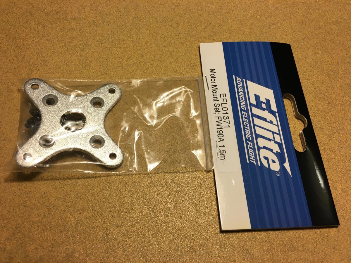

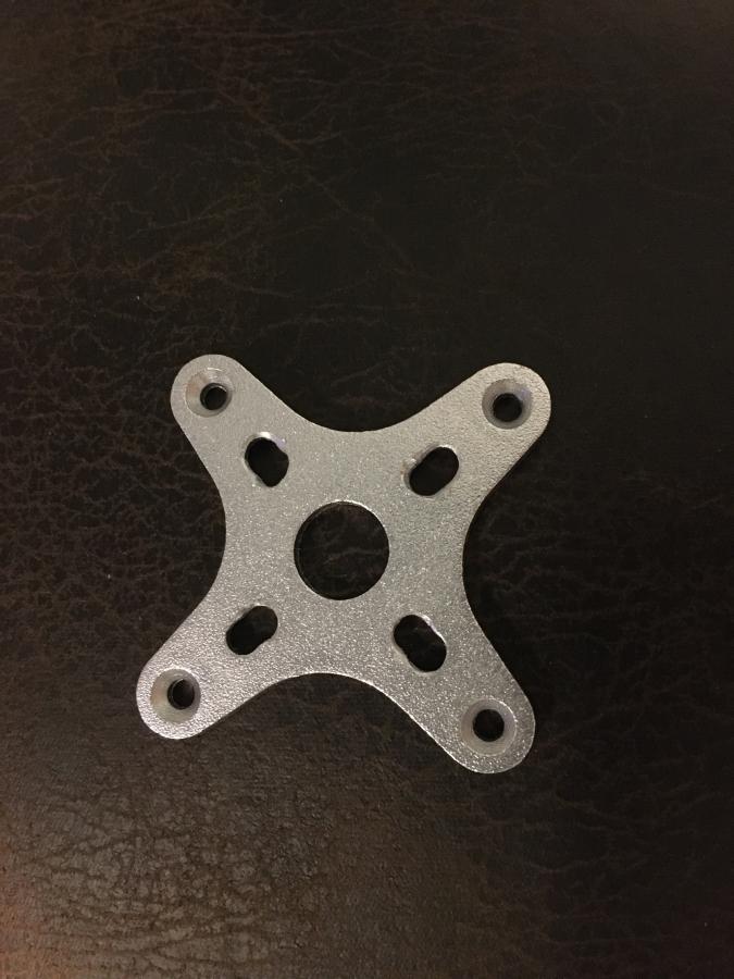

    so i started by buying an extra x mount and elongating the holes to fit the 5060 and drilling out the center hole till it fit over the c ring on the back of the 5060. the 5060 covered part of the screw holes that mount the x mount to the firewall so i installed the screws in it before loc-tite-ing the x mount to the motor,
    removing the stock motor is accomplished by removing the four x mount to firewall screws. the esc is glued in so it pulls out the nose with a little elbow grease.
    the castle 100amp fit in the same spot, though i did have to lengthen the battery lead. the 5060 with the modified x mount screws right in place of the stock motor. when i thought the motors were 2mm delta i figured i could use the back plate of the stock spinner to give me the cooling fan, but 10mm delta put the fan mostly out side the cowl. so i went with just the dolphin spinner. i started with the 15x10x2 prop with a plan to go to the master airscrew 14x9x3.
    i put two flights on it today, the first it was flying in and out of the lifting fog which was ok because i wanted to test how well the firewall would hold up to a motor putting out 3 hp so i wanted to do a lot of fast throttle ups, then MPT's. second flight i did all the maneuvers i usually do. i did notice that when i retracted the wheels at full tilt they would bind as the wheels entered the wing, at half throttle they went up fine. this is because i put a robart wheel on the stock hub, it was one i had here and it was a 1/4 inch larger than everyone has been using so i'm not worried about it at this point. so now it does all the maneuvers like a fighter!
