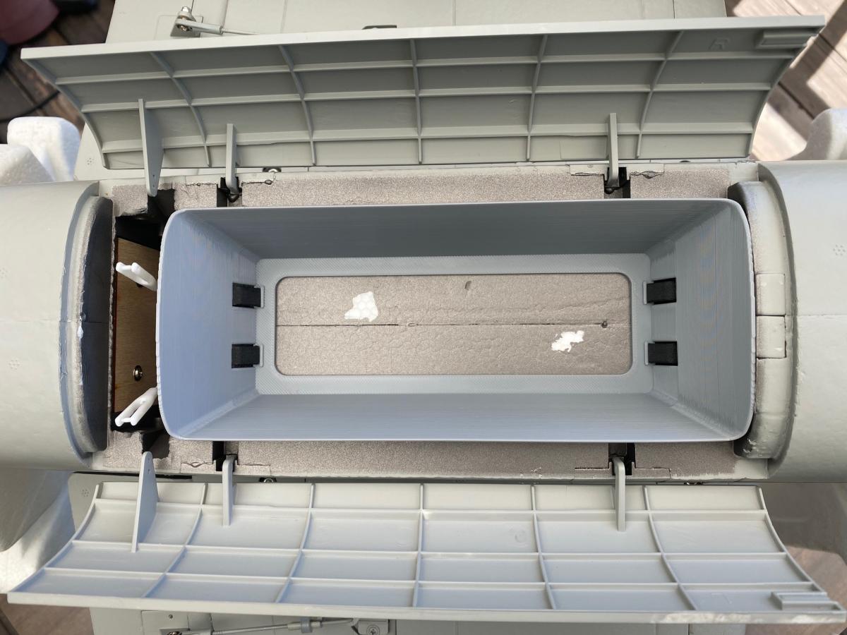

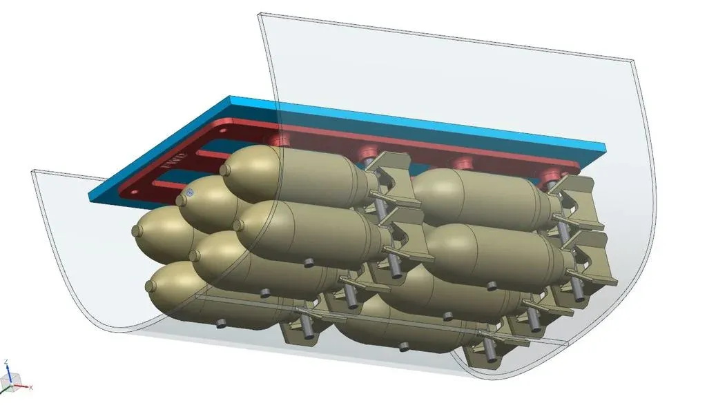

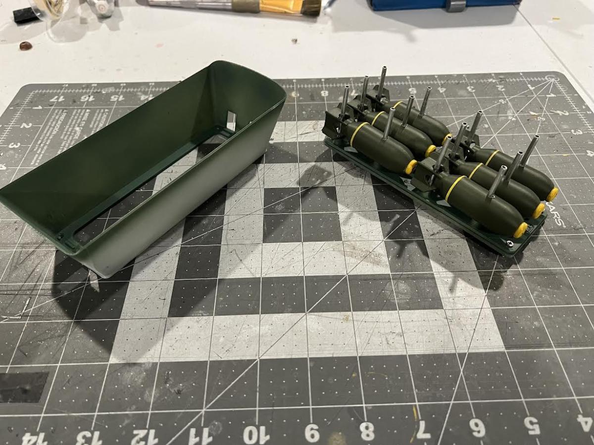

    Yesterday I worked on a prototype somewhat scale version of the M40 para fragmentary bomb commonly used by units like the 345th Bomb Group in the Pacific Theatre in WWII. I took a picture of an orange-painted printed bomb with a weight on the nose a M5 16 bolt. The entire bomb weighs about 12 grams and is dropped out of the bomb bay as I did again yesterday with four of these bombs as a test. The real planes didn't drop a bomb that looked like this; this was just a test to see how well it drops from the airplane. I also drop these bombs from the bomb bay without the parachutes and they look pretty realistic.
    In the photo below, the green and yellow bomb is a prototype for the M40. I'll add more details and probably make some changes on how it is constructed. I'm hoping I can get at least 4 of these units made up this fall before Real winter sets in and I have to wait until spring to do the tests.
    I painted the bombs orange to hopefully see them better when they drop onto the ground in the weeds, dirt, and sage. I have several painted OD and are more scale looking, but I would probably lose every one of those in the weeds if I do drop them. They are too delicate to drop onto the runway, mainly the tail fins. They would break off every time. Still, looking to print them in a stronger material where they might survive landing on the runway without damage.

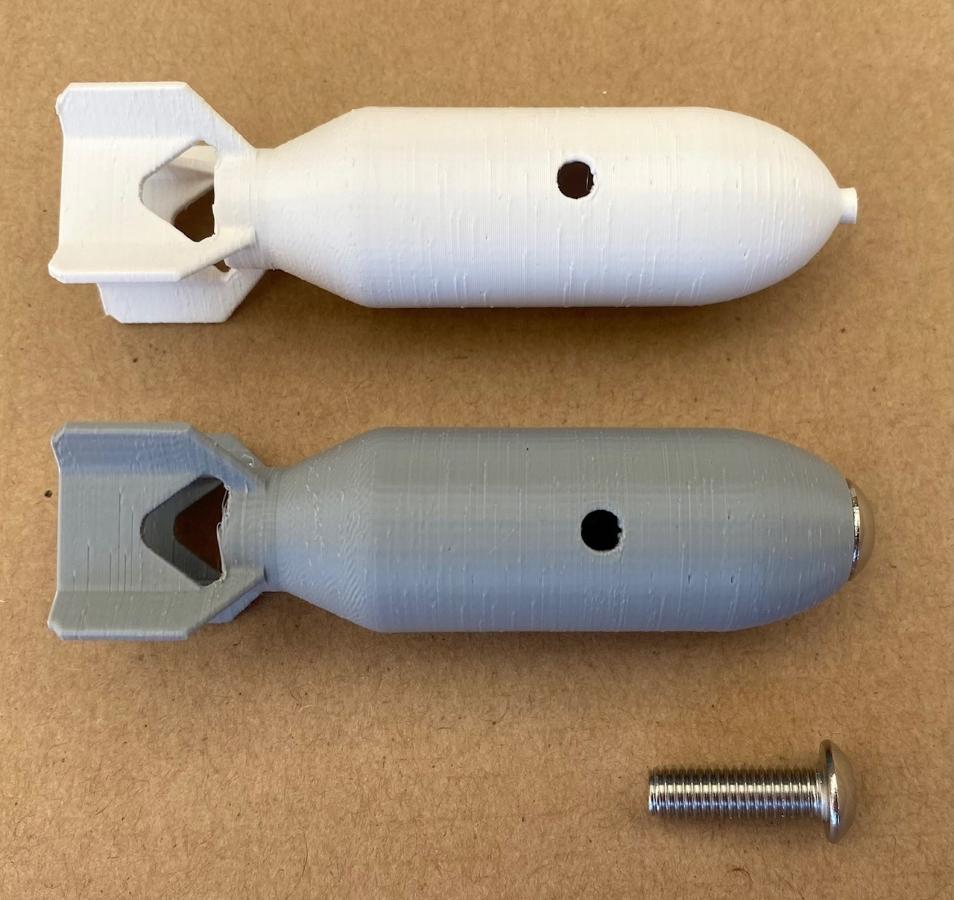

    Today I did a couple more flights on my B-25J. I have 18 flights on it now, and 11 of them involved dropping bombs as a test. Today, I dropped four bombs I call my MK. 1 parfragmentary bombs which are orange-painted printed bombs with a dowel screwed into them with a snap swivel to attach a small 6 inch diameter parachute. I just carefully folded the plastic 'chure, loosely wrapped the strings around them, and carefully set them in the bomb bay. I wanted to see if they would get tangled, or what would happen with them. Turns out, they all dropped out quickly as soon as the bomb bay doors opened, and the parachutes opened immediately for a gentle landing in the field next to the runway. They fell in about a 10 foot circle, which worked well, and no damage, especially with using the parachutes.
    This first test was just to prove the concept of these "parafrag" bombs and the weight of the printed bomb is about what I'll weigh the more scale looking bombs that I'll eventually fly on the plane.

    Hi Dan: I’m sure that’s mine. Flew them one time and couldn’t find any of them. You can keep it or throw it away. I’ve printed up a bunch of scale bombs with weights in the nose that drop realistically. The Flightline foam bombs drop like confetti.
    I’m also experimenting on “parafrag” bombs that drop by parachutes.

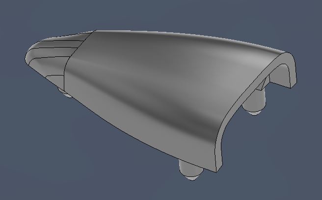

    Thanks, Steve. Just a preliminary first step in sizing how this will go together. Charlee confirmed for me that there was a "break" in the venturi tube at the forward edge of the nose wheel door. So, there are basically two tubes that make a fairly tight fit with the gear up and doors closed. The forward tube is bolted to the forward fuselage, and the rest of the tube is bolted onto the nose gear door itself.
    Charlee explained that the reason for that blister being off to the right side of the nose gear door and not centered on the centerline as the Flightline folks designed and produced it, is because for whatever reason, the nose wheel when retracted is not centered on the fuselage but actually is angled off to the side, thus the reason for the blister being offcentered to accommodate that fact. I found that very interesting why it was designed that way. Nevertheless, that is why I will have to modify that gear door with the blister now off to the side. The venturi tube is curved to follow the shape of the relocated blister with the exhaust for the air just behind that blister.
    One addition to that email. Charlee later explained in a response below my entry is that the reason the nose wheel is offset to the right when retracted is that it allows room for a crawlway for a crewmember to get to the nose of the plane on the left side of the aircraft, below the pilot.

    This is one that has to be mostly "eyeballed" since I have no design drawings, but I think I'm fairly close. That's about all I can do for what it is. I'm glad I put it on, though. Good to get the ol' noggin working to figure out how to do it. Not a big deal, but sorta fun, too.
