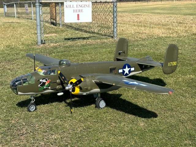

  • Ocalavol
    I installed the spare ESC and removed the red wire since the remaining ESC powers the radio. Maidened the model today and it was a huge success! Stable, controllable, no problems. I even had to tone down the elevator throws that I had set high due to a previous post worrying about enough elevator authority. I'm very pleased.

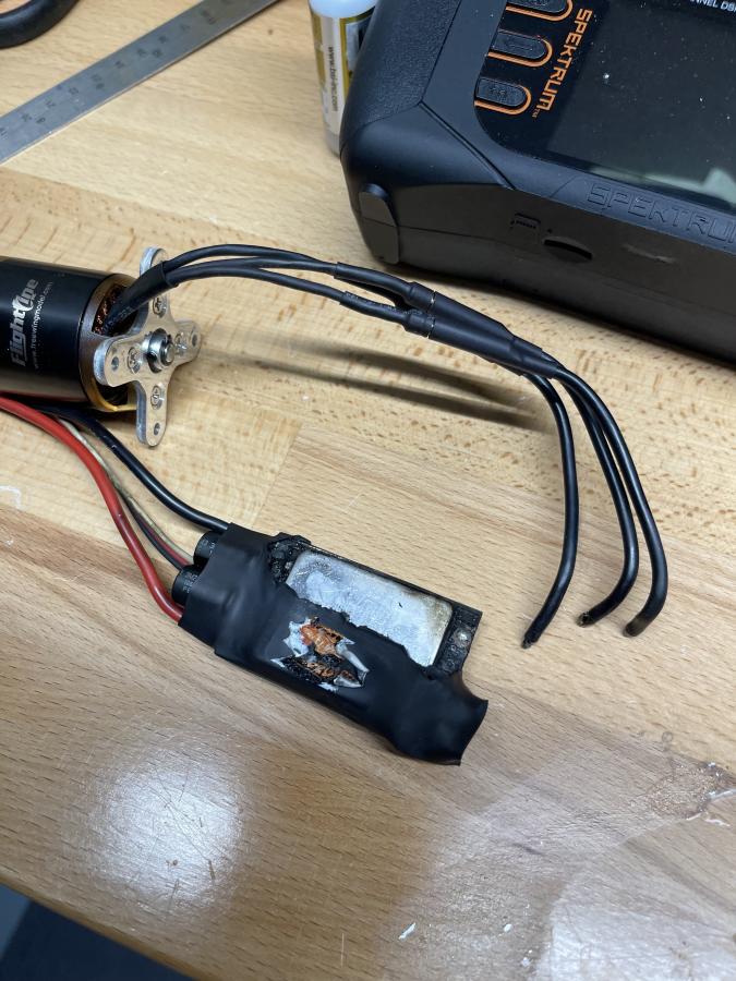

  • Ocalavol
    Just received a reply from MRC on the service ticket after only 1 day. They apologized for the problem and suggested that I check the battery Y-harness, too. Mine seems fine. They will replace the fried ESC, of course.
    I have a spare 60 amp ESC from a fliteline P-38 that is labelled as including the BEC. Would this be safe to use as a substitute?

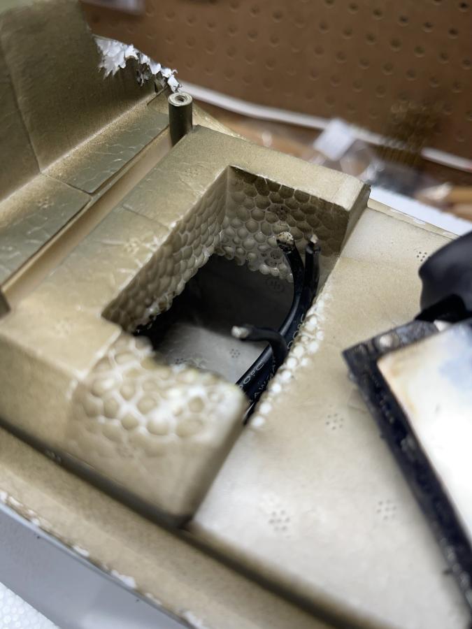

  • Ocalavol
    Hi guys! Just received my model yesterday and got started immediately with assembly. Everything went well all the way thru getting the Lemon 10-channel receiver installed and the gyros working properly. THEN I pushed the throttle up just a little to stop the transmitter lack-of-use tone.....and POP, smoke started coming out of the right nacelle. I managed to get the battery disconnected pretty quick, but the residual smoke was awful. I remember in several earlier posts reports of this happening. I disassembled the nacelle (not fun with the LG struts) and pulled the ESC. It was fried. Looks like the capacitors may have failed or something like that. I'm no electronics guru. I have a customer service ticket in with MRC and am waiting for their response. I wonder if they have a QC problem with these particular ESCs.
