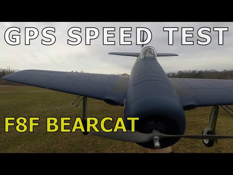

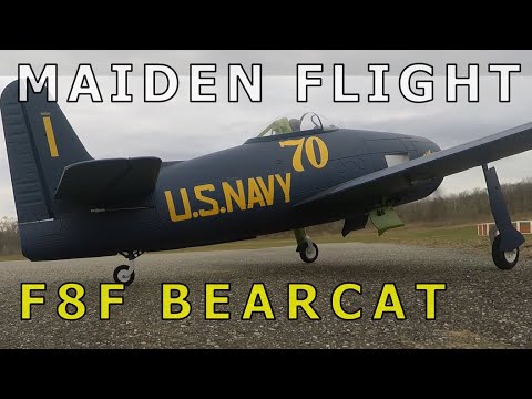

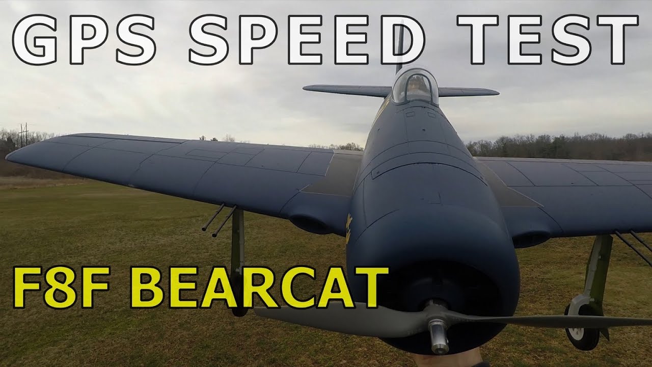

    Finally maidened mine. Stock esc and motor, 6S 3300mah all the way forward with 12x8 apc e prop. No fire! lol. I do have some gear issues to resolve. Video to follow with GPS speed.

            Check those gear doors to make sure the wheel locks aren't interfering with the retract. One good thing, she's clean on the bottom and will land fairly slow, may be the advantage to a two bladed prop?!
            Also, those pins on the doors are kind of funky. make sure they aren't getting hung up in the wheels, thread them in a little more and makes sure they don't hit the rim. Gear doors must be at open takeoff otherwise the gear can't retract.

                Thanks grossman, after inspecting it seems I had the gear door pushrods installed with the "L" hooks facing in towards the fuselage. Seems this caused the gear doors to open in flight and then when the gear down command was given the gear would get caught on those doors and fail to come down. I removed the tailwheel assembly (nice design, tucked up inside the fuse) and drilled and pinned the shaft back together using 30 min epoxy.
                My old 12x8 prop I had has been removed in favor of a 11x8.5 I just installed, check out my youtube channel anmd subscribe if you'd like to see some more videos of this bearcat. I also have a 90mm F18 from motion RC i'll be maidening soon. She's all ready to go just waiting for some real good weather for that one.

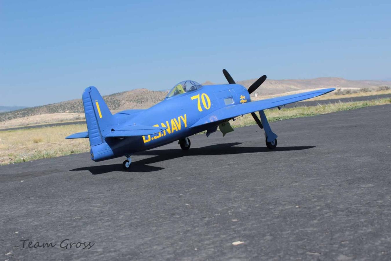

                          Personally, I love this plane, Bearcat One is 6 years old

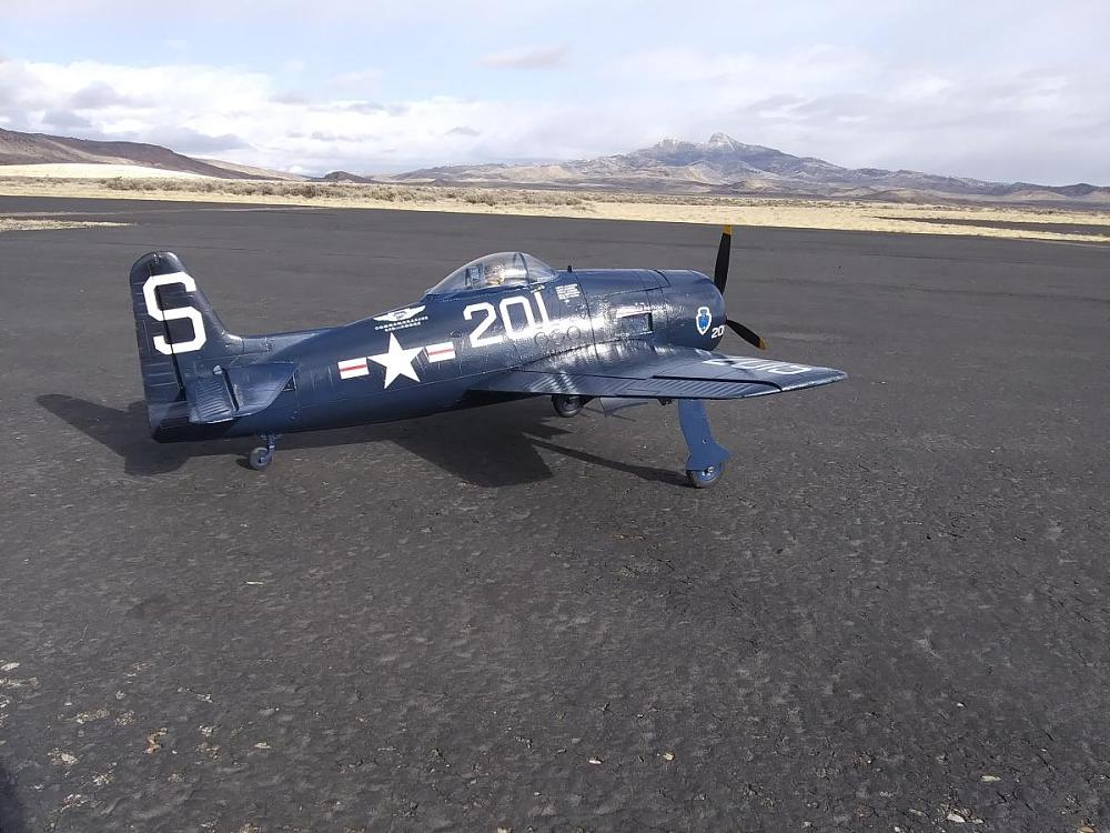

                          And Bearcat Two is two.
