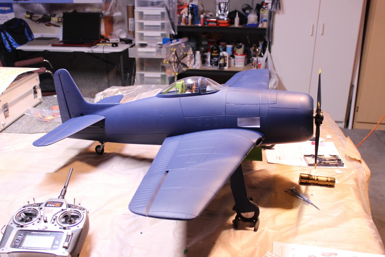

                        Give it several coats of
                        Except get the gloss finish,
                        Before........
                        After....... Click image for larger version
                        'nuff said

                            #813
                            Looks great Grossman, what did you apply the clear with?
                              • 7438
                              #814
                              I use an old 1/4" oil paint brush as I have several laying around. They're very splayed out and fairly soft, not stiff bristles. I have used a foam brush as well, but prefer a soft bristle brush. I apply it pretty liberally and lay it out front to back, in the direction of the airflow, keeping an eye out for runs. Once applied, I'll hit it with a hair dryer to set it up, then let it air dry for several hours. It will get more glossy with more layers, I generally go for at least four layers. BTW, I apply the decals first and then use the clear coat to seal them as well.
                              Dang, I miss that plane!

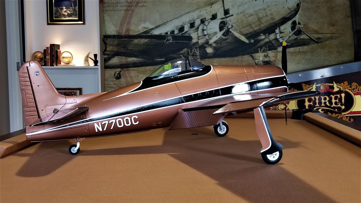

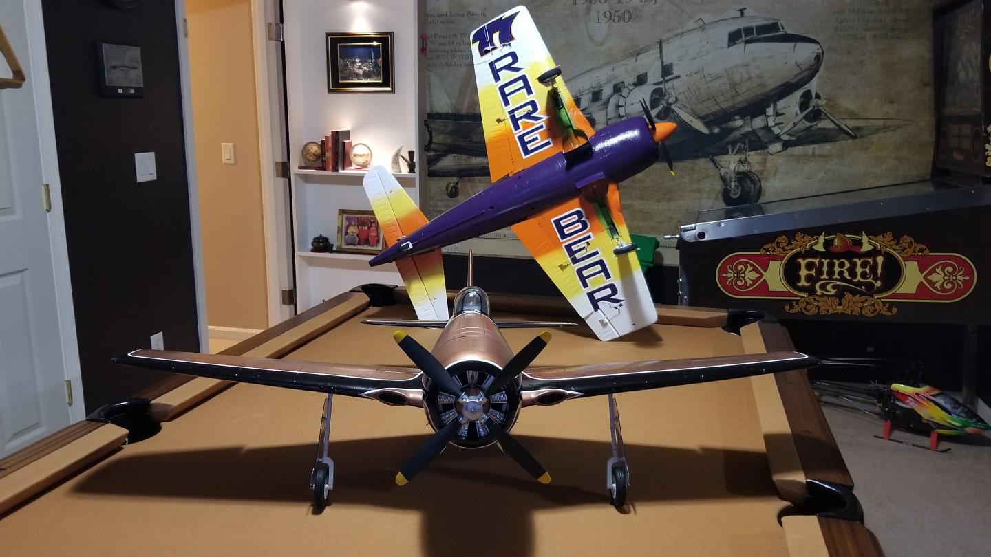

                                    I have two Bear cats, one i Have done as a vintage Reno racer. Callie graphics. Click image for larger version
ID:	301153Click image for larger version

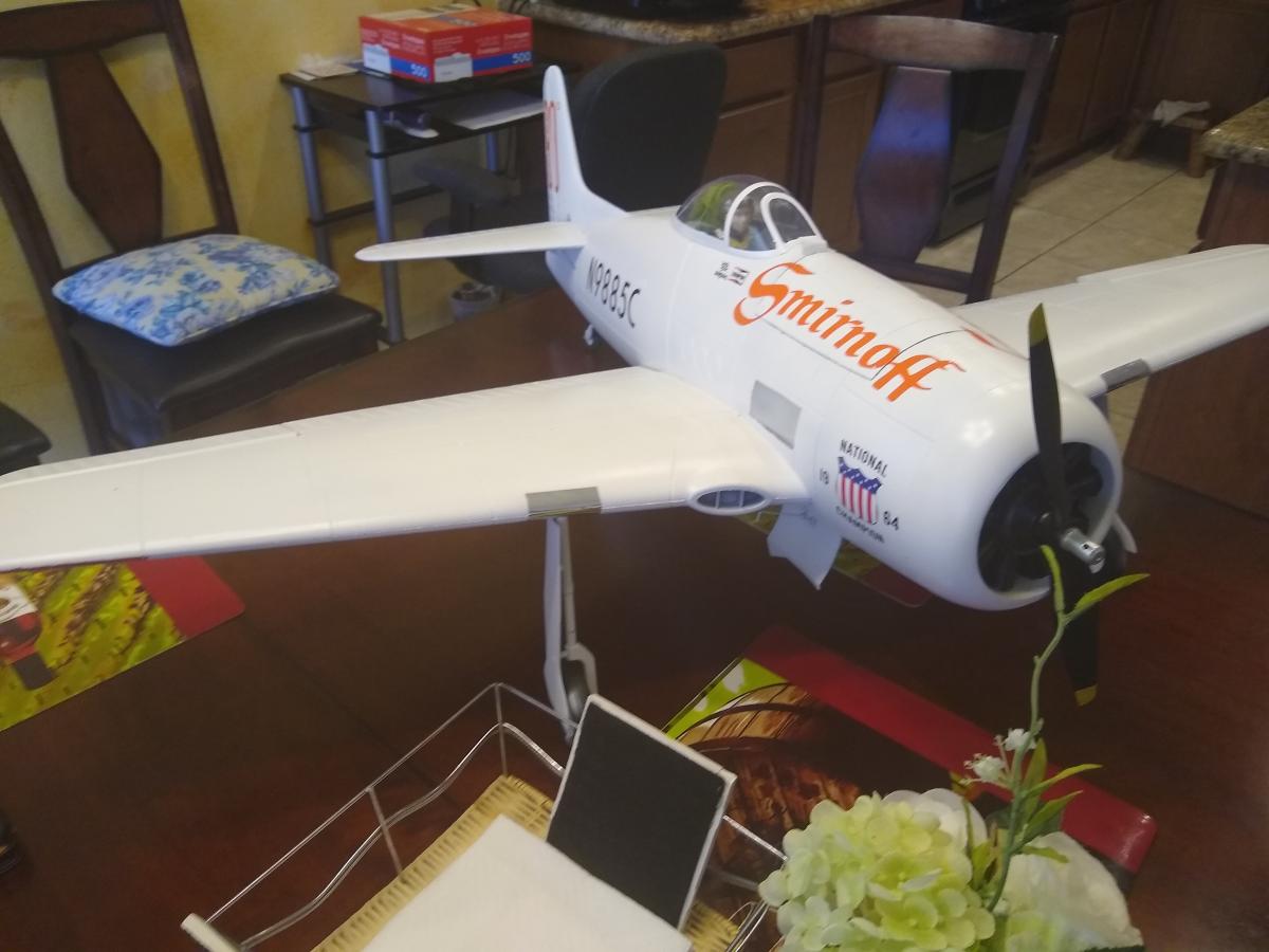

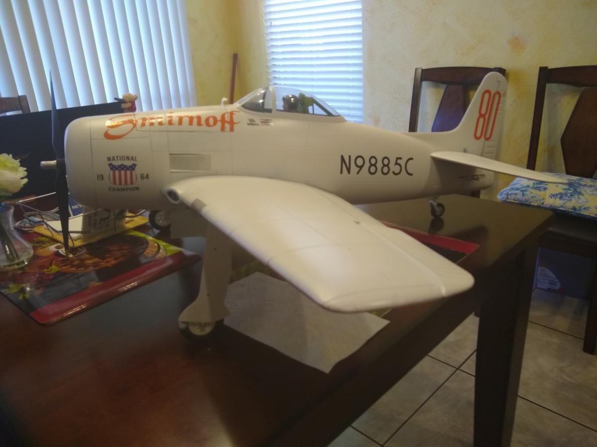

                                        Originally posted by WrightBrosRC
                                        Is anyone still flying these?
                                        Lost my last Bearcat in the sun without a good result and haven't had one in a couple of seasons. Really miss that bird so she's on my list of birds to buy. Interestingly, I see you have a Bearcat painted in Bill and Corky Fornoff colors. I'm seriously thinking of going that route with the next one.
                                        Great job!
