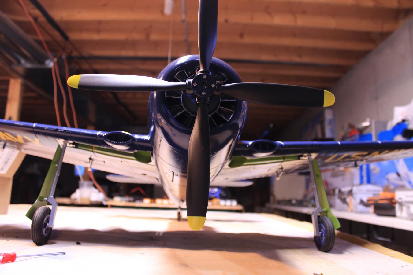

    Might be the perfect airframe to install a 650 kv into.
    That and the 1400 mm Corsair prop work amazingly!
    What bird is the 650 coming off G-Man?? Sounds like fun!!!

          I put this set-up, 4258-650, in 3 of my Bearcats. Two are the FL 1200mm Bearcat and the other is my 11Hobby Bearcat. Paired with the prop from the 1400mm Corsair, they definitely improve the performance!
          If I remember correctly, I am using the 70 amp FMS ESC in all 3.
          Bob

                                    Interesting, we're at 5000 feet here in Cody and the stock system was pretty good. I wanted the four blade prop for scale looks, so that's why I went with the 650kv and the 1400mm Corsair prop on mine. The thing is awesome! Had it out yesterday with a buddy of mine who's just learning to fly. He loves it, I told him, "watch this and ran it down the runway at about 20 feet, then fed full throttle and pulled her back. Climbs like a homesick angel! I hate to think how high she'll go, when she gets to be a speck, I roll her over and cut the throttle way back. Just amazing!
                                    Think it over before going the upgrade, its a minimal amount of work to get the 650kv in her and she looks so scale with that big prop. Also went an 85 A Mantis ESC, beware of the short battery connecting cables in these! I have an A3L in her as well as I like the way she handles with it. The trick with the battery, at least for me, is to plug it in and let the gyro stabilize, then place the battery in the proper position, which is so the rear of the battery is sitting on the cross bar, you know what I mean if you have one. Also, I put a tab of weight on the tail of the fuse to help with the CG, what with extra weight on the nose.
