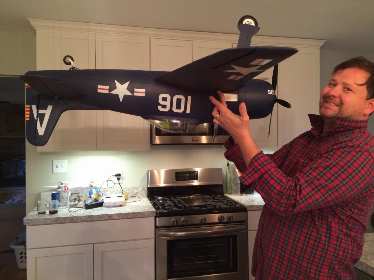

            Interesting, I just put my 4000's all the way forward and flew, it was fine. The CG as Ryan show it, is slightly different.

                                      btw the pic of the f8 upside down for balanceing has the gear out is that standard? I thought it was to balanced with the gear down but either way this plane flys well with almost any battery lol.... I use admiral 4s 4000 all the way forward and a 10 min flight is not unusuall

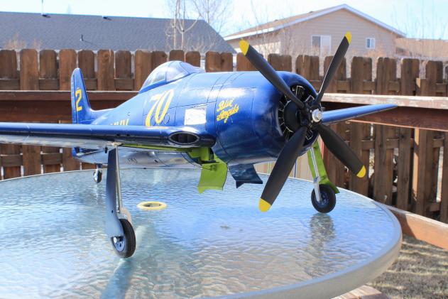

                                        I went by what Ryan said in the flight video until I swapped out the motor and prop, then the battery had to go back to the foam cross support just beyond the battery tray. It took a minor bit of work to get the motor in, new holes to mount it, but once done, this plane acts/looks more like the real thing. I haven't seen one with the 880 kv and two blade prop upgrade yet, but it can't be much faster than this one and I use a more realistic looking prop. Click image for larger version

                                        And yes, I did eventually paint the nut and washer yellow.
                                        Winter project, retractable tail wheel.
