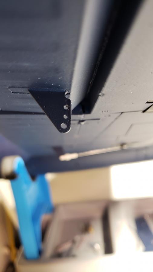

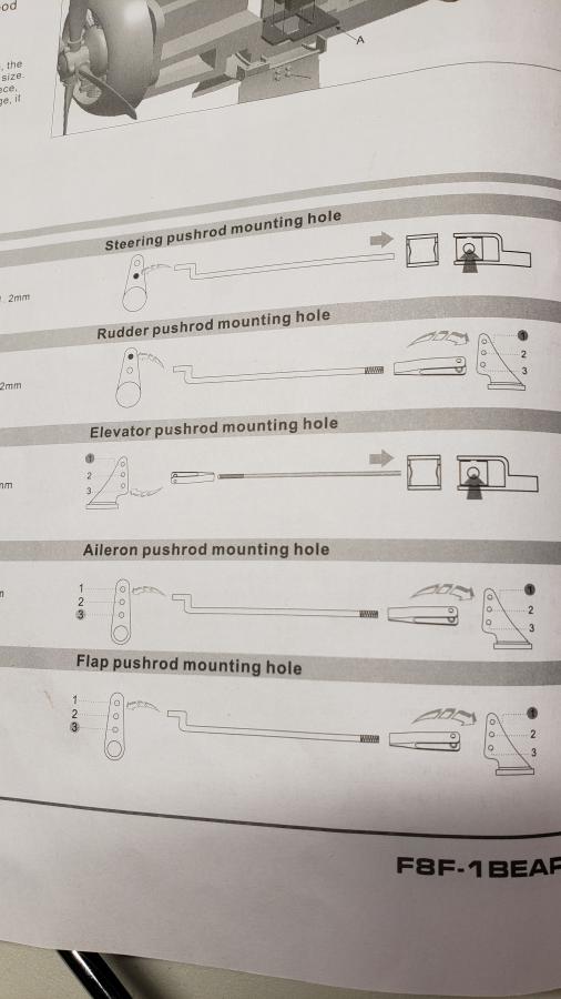

                                The manual calls for the push rods to go in control horn #1 which is the outer most hole. The hole is also larger than holes 2 and 3 as seen in the picture. Using #1 hole, there is a decent amount of play at the clevis attachment to the point that I can move the aileron up and down slightly which I can imagine isn't great for the flying. Anyone else run into this? Should I go hole #2 instead? All the control horns are this way.
                                  #736
                                  I didn't have that on mine, but since there's a little slop using the first hole, just go with the second. You will still have plenty of throw. But make sure you use the second hole on both ailerons so you won't have differential throws.

                                    #737
                                    Thanks. Weird that mine is different. Anyone else
                                    • Fallguy44
                                      • Nov 2018
                                      • 52
                                      #738
                                      In case anyone searches for this in the future, I took a clevis from my Eflite p47 razorback and used them on the ailerons. The thread size is the same but the stud that goes into the control horn is a larger diameter and fits the larger hole perfectly

                                          #740
                                          I run mine from the inner most hole on the servo control arm to the outer most hole of the aileron control arm.
                                          As you can see in the pictureClick image for larger version
