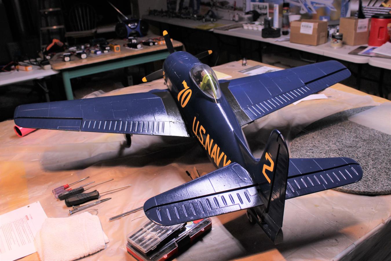

    Has this had any factory mods since first release? My concerns are main gear issues on grass fields.
      • Nov 2013
      • 2765
      • Cody, WY
      #882
      Originally posted by WillCorsair
      Do you have any pics of your mods? Thanks.
      I'm Down for a 1500-1600mm Bearcat if they come out with one someday!!
      davegee
        • 7385
        #883
        I didn't take any while I was applying the flight metal, but it's metalic tape, like chrome duct tape, except in big rolls. The wing is pretty thin where the gear attaches and as Dave can attest, the runway we deal with is not the smoothest to put it kindly. The wing panel on the top is pretty obvious, so do like I did, out with the ruler and measure, then cut a paper/card board template, check it for size and modify accordingly, then cut whatever material you have to strengthen the wing and apply. Even packing tape will give the wing some resistance to failing. I'd hoped that at some time there would be a gear upgrade, but nothing as yet and as the airplane is getting up there in age (4 years?) I'm not holding my breath. I also went with Dave Brown tires and that helps as well.

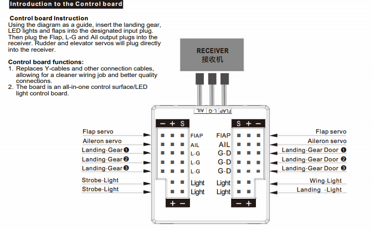

                  Ah the famed blue box, the online manual which I rewrote should describe the hookups, but just in case, I have the diagram here:
                  Click image for larger version  Name:	flight control board.PNG Views:	0 Size:	123.4 KB ID:	355790

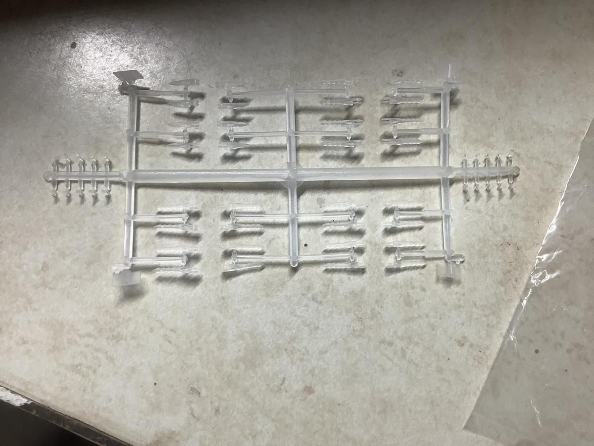

                      #890
                      Here’s pics of the battery tray, parts that came with it, and the decals that were on it as received.

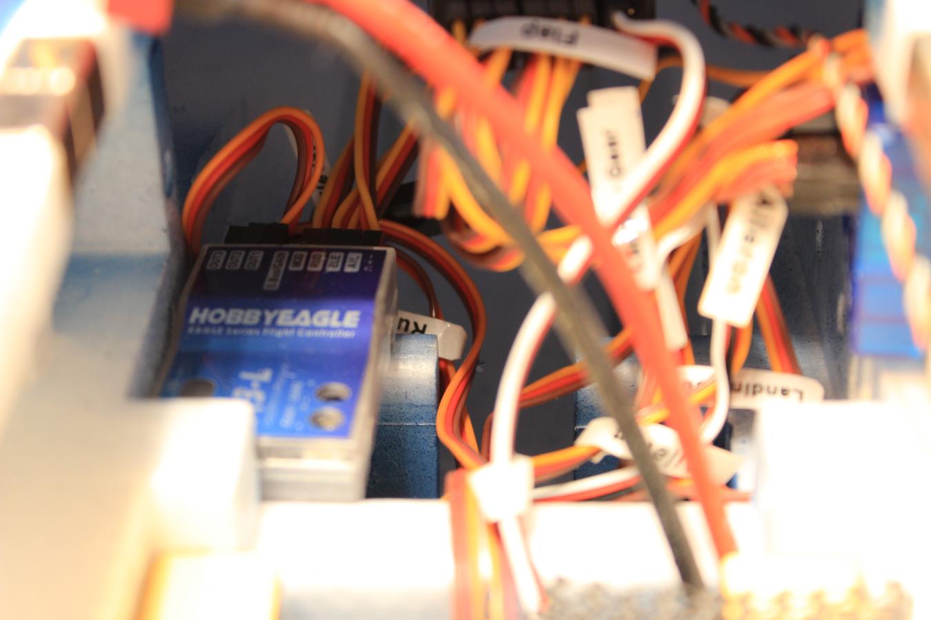

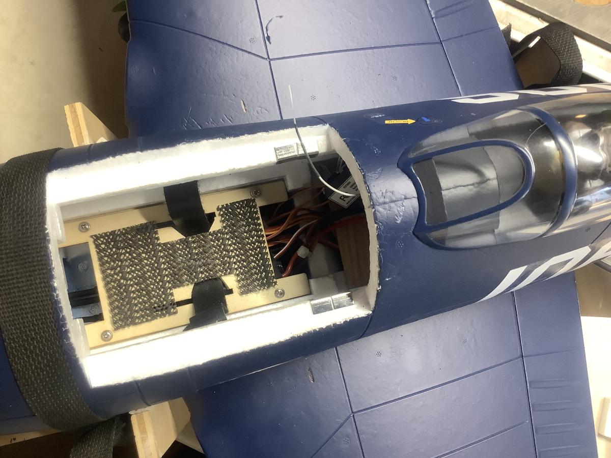

                              #894
                              Well, it’s been a bit of a challenge for me to get this put together but bench tests are all correct so, I’m confident…sort of.
                              I went with HOBBYEAGLE A3Super3 programmable and really like PC system for setting flight modes, gains, and calibration of level. I’ve got three modes; gyro off, normal gyro, and auto level.
                              I’m using a Futaba 8 channel receiver. I added plywood deck to support the gyro and receiver. The blue box is on the left side of fuselage in the photo.
                              Expect to get maiden flight Monday or Tuesday.

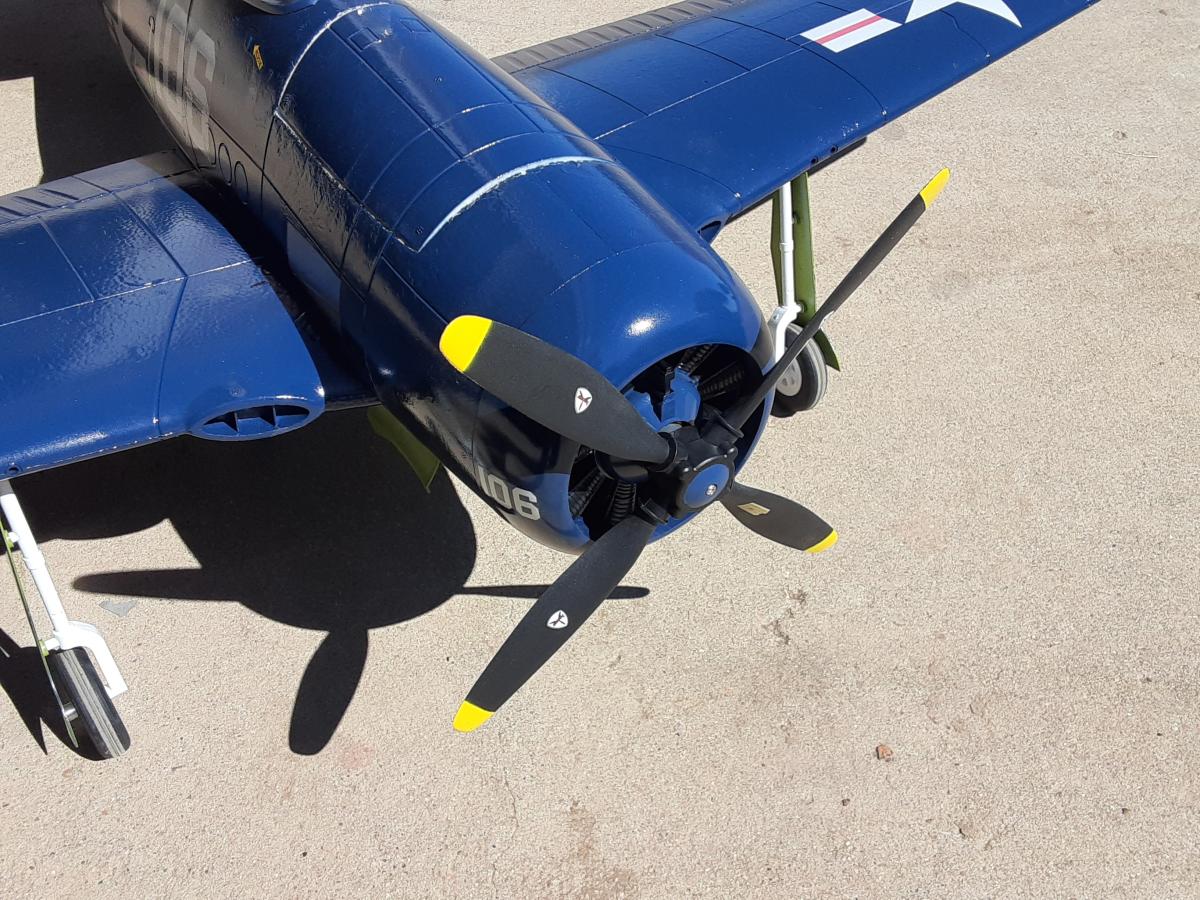

                                    • 7385
                                    #897

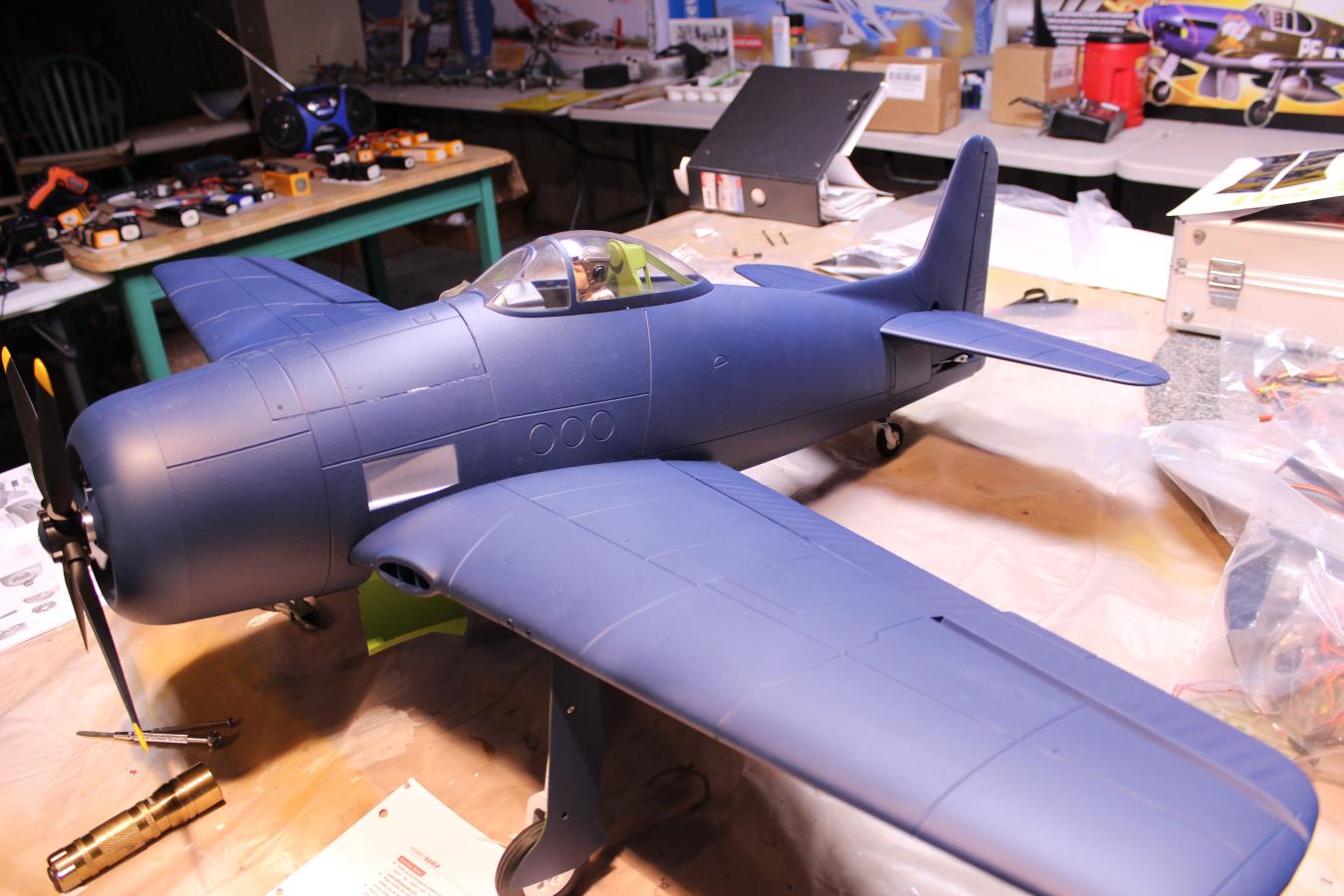

                                    This is what you have now....
                                    Click image for larger version  Name:	IMG_8914.jpg Views:	0 Size:	129.6 KB ID:	356545
                                    And this is the same airplane after several coats of Minwax...
                                    Click image for larger version  Name:	IMG_8941.jpg Views:	0 Size:	154.2 KB ID:	356546
                                    It takes several coats applied with a soft brush of foam brush applying in the same direction. I applied one, then used a hair dryer on it, then applied another, then let it set overnight, repeating this until the streaks were gone.
                                    This is my preferred product but its becoming hard to find for some reason.
                                    Just makes sure its water based and gloss with UV protectant.
                                    Click image for larger version  Name:	027426359055.jpg Views:	0 Size:	97.5 KB ID:	356547
                                    Where it says Clear Satin, look for clear gloss, the only pic I could find.
                                    My rule of thumb is: For glossiest finish, use a brush, for flatest finish, use an air gun.

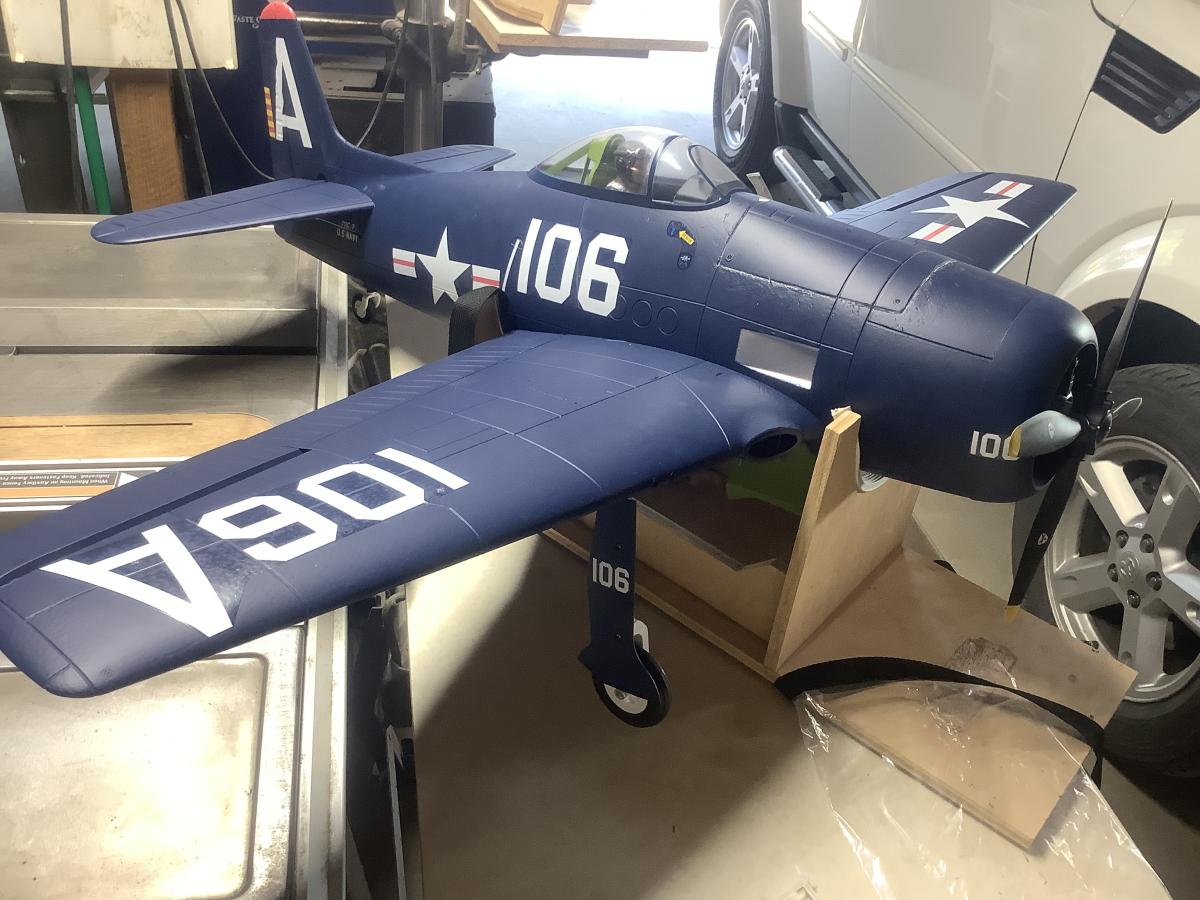

                                          #900
                                          I put 3 coats of urethane on and that really helped the drab mat look. Even the decals look better. I used what I could find here locally - a MinWax spray and pretty happy with the results. Click image for larger version
ID:	356695Click image for larger version
ID:	356696 Checked the cg and looks right on with 3600maH 4S all the way forward..Click image for larger version
