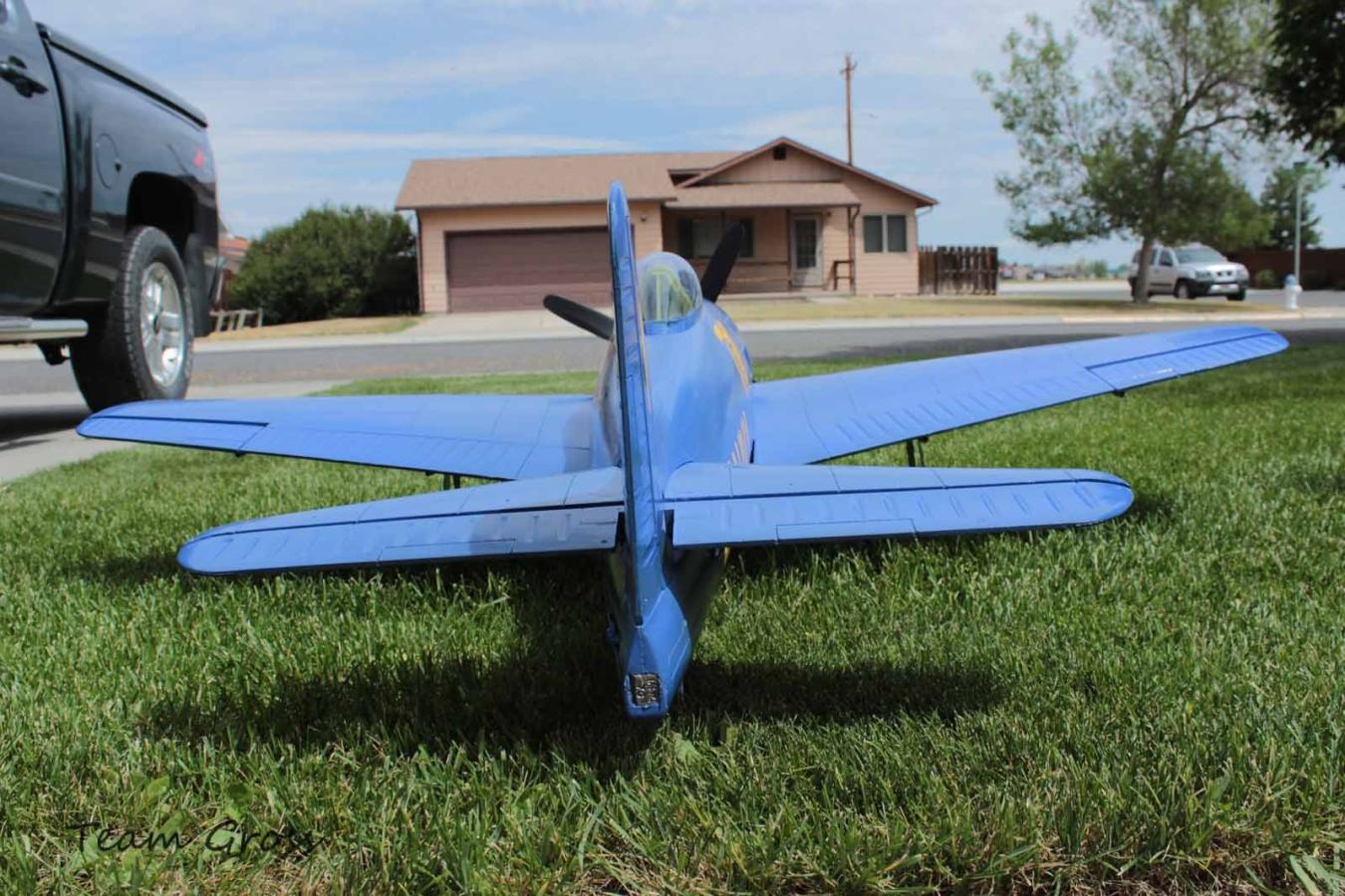

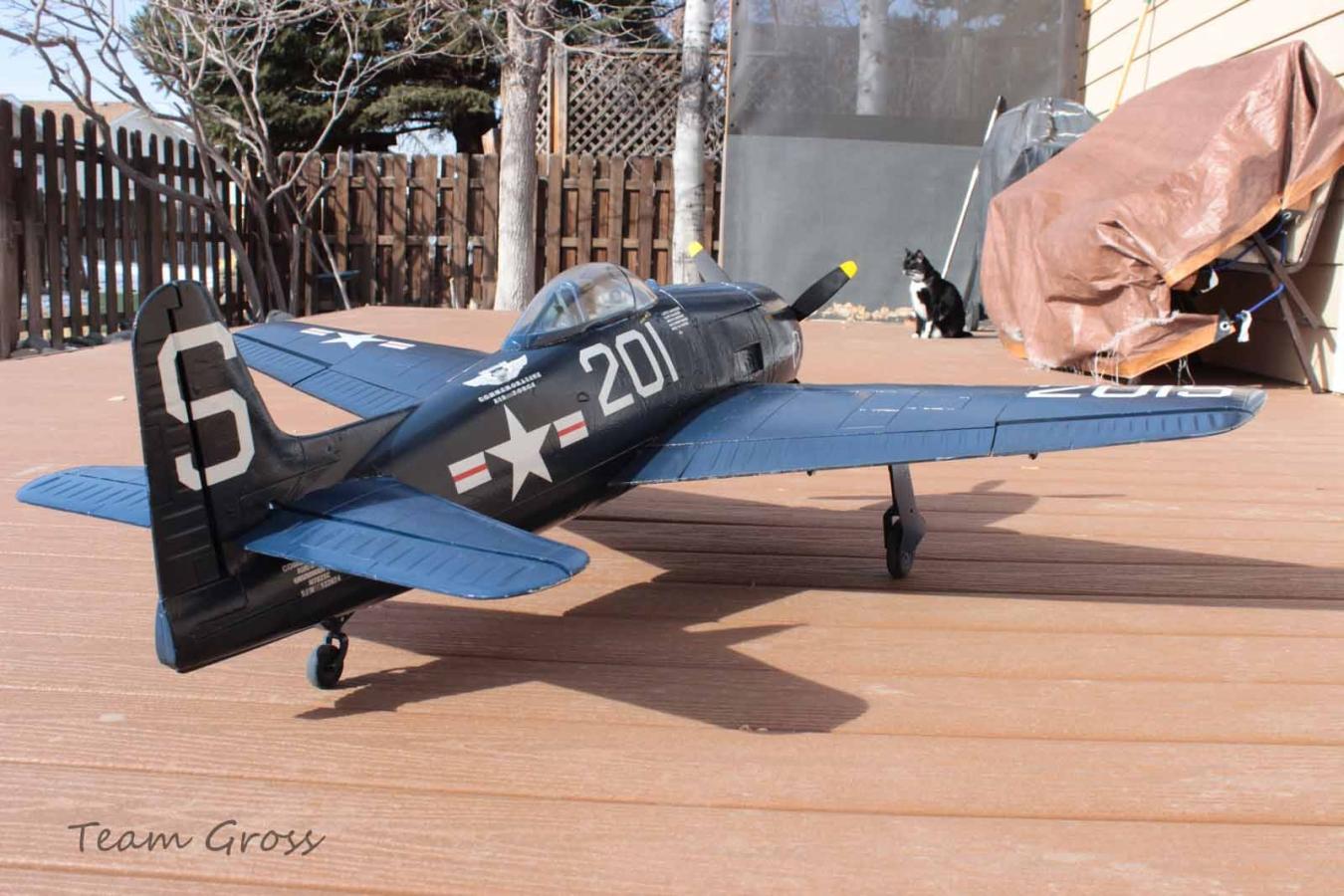

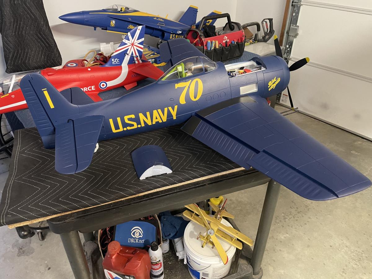

                                        The prop was my first thought as well. When I went 6s on my FMS 1400mm P-40, I had to change the prop and spinner. Found out the hard way but with a good result. I suddenly had no power and thinking I had a bad battery (burnt out cell or something) I popped the gear and landed her only to find out that she'd shed the prop and spinner! Got lucky that time.
                                        I have two Bearcats, one runs a 650 kv with an 85 A ESC using a FMS 1400mm Corsair prop and the other runs a 3948 kv 760. with an 85 A ESC using the stock prop. Either way, the performance is great without the risk of shedding a prop.
                                        The CG with a 6s system would be a concern as well. With the 650 kv I had to add a small amount of weight to the tail Click image for larger version
                                        Whereas with the 760, I didn't need it.
                                        Another thing aesthetically, number 201 got the Grumman treatment and everything was painted blue. Sounds like a small thing, but, at least to me, it make the airplane look so much more scale.
