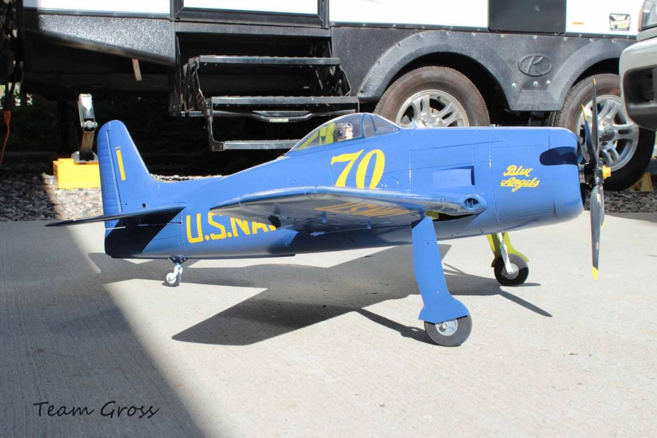

        Looks good! I run a 650 KV with a FMS 1400mm Corsair prop on the Blue Angels Bearcat.
        Click image for larger version  Name:	IMG_5302.jpg Views:	0 Size:	134.4 KB ID:	356794

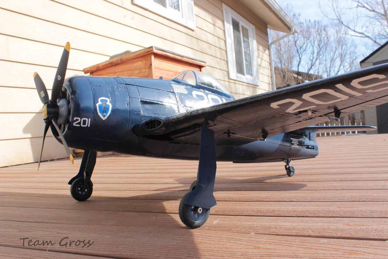

        I had to put a tab of stick on weight for the CG
        Click image for larger version  Name:	IMG_5311.jpg Views:	0 Size:	195.2 KB ID:	356795
        So I hollowed out a square and fit it in, I usually run the battery back a bit but the CG is pretty forgiving.
        On this one, I use Dave Brown tires, I love those I swear you can hear them suck onto the runway.

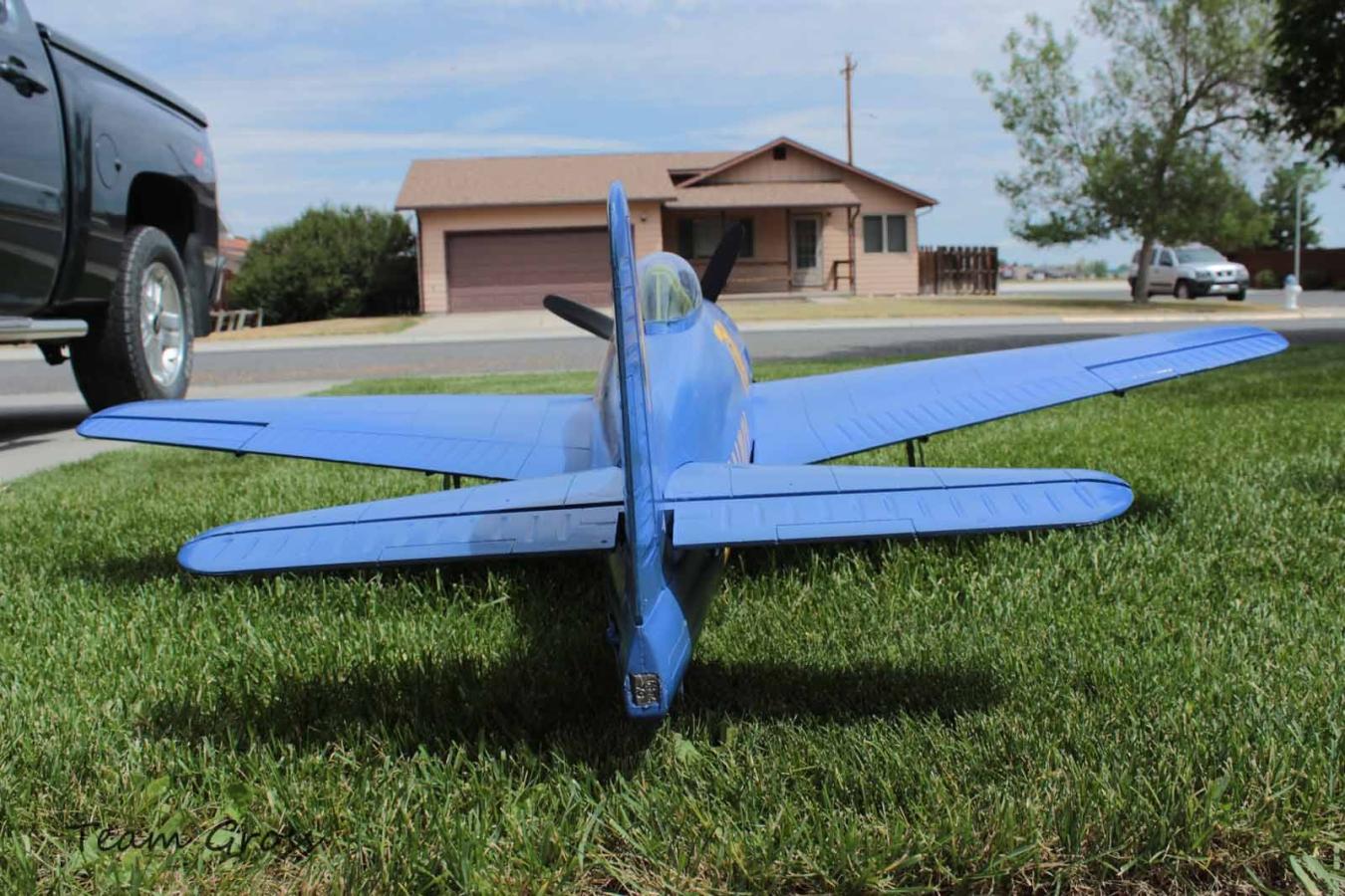

        With the other Bearcat, used a 780kv with the stock prop and didn't have to use any tail weight.
        Click image for larger version  Name:	IMG_5650.jpg Views:	0 Size:	148.0 KB ID:	356796 Performance wise, they are, at least to the eye, identical.
        One thing I've noticed with both is the tailwheel likes to jump and I'm thinking of a Dave Brown tailwheel to save my prop tips. You have to taxi very carefully at our field as the runway surface is not the best to say the least.
