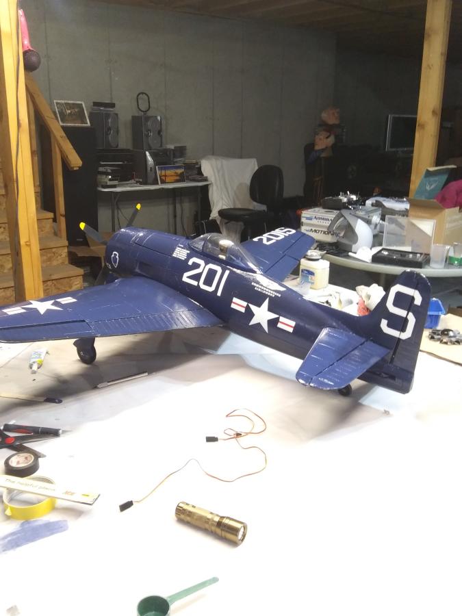

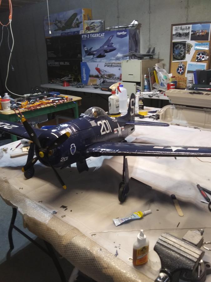

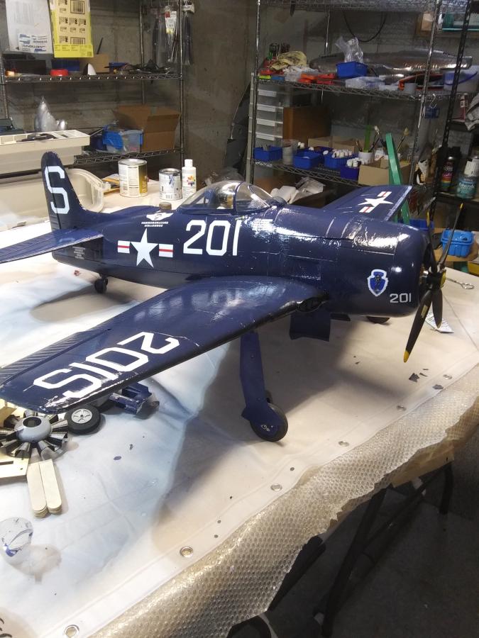

          Bits and Pieces update.
          She's assembled and painted, all systems are working.
          I used the receiver from La Patrona and had the blue box sitting in storage, all worked well.

          Still have some work to do, The battery deck has to be manufactured and installed, I'll use the one out of the other Bearcat for a template. Note to self. Make a pattern of all pieces that can't be bought.
          I found that making everything blue really added to the authentic look, apparently, from what I've seen and heard in videos, Grumman painted them blue and slapped them out.

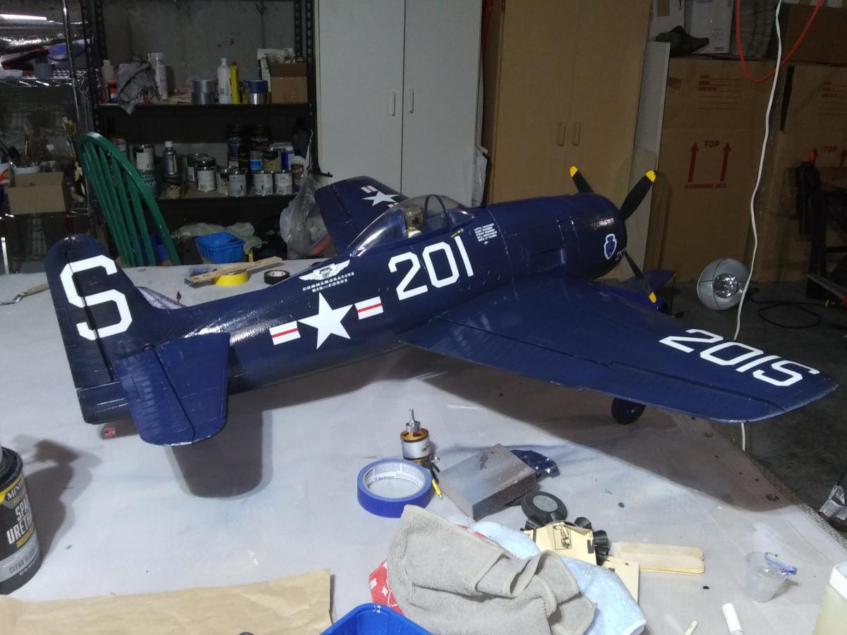

            The 3948 760kv motor seems like an ideal upgrade for this plane. The motor mount fits into the stock holes, the prop shaft was from La Patrona and the stock Bearcat prop fit onto that perfectly, so the stock bearcat prop shaft will mate up to the motor. I'm dealing with a slightly bent nose so I shimmed the motor to align it properly. The stock radial motor fit over the motor even with the damage to the nose, with no mods as well. I had the other 760 kv and weighed it against the 650 that I have in the other Bearcat, the 760 is lighter but heavier than the stock 580kv motor. The nice thing is that with the battery back, she CG'd up without having to add weight to the tail. Anyone looking for this motor, I got it from one of the 3D FMS birds, can't recall which one but it should be easy to find on the Horizon Hobby website, or Motion may have an equivalent motor.
            Just judging from the amount of throttle for taxiing and comparing it with the other Bearcat, she looks to be more powerful. can't wait to see he fly, I'm just waiting for an A3L which is on its way. With the ten channel receiver, I can vary the amount of gyro by using the control knob, it just doesn't get any better.
            BTW, the battery deck is installed, I used the one out of the other bearcat and trimmed the excess off an old battery hatch floor and it worked great!

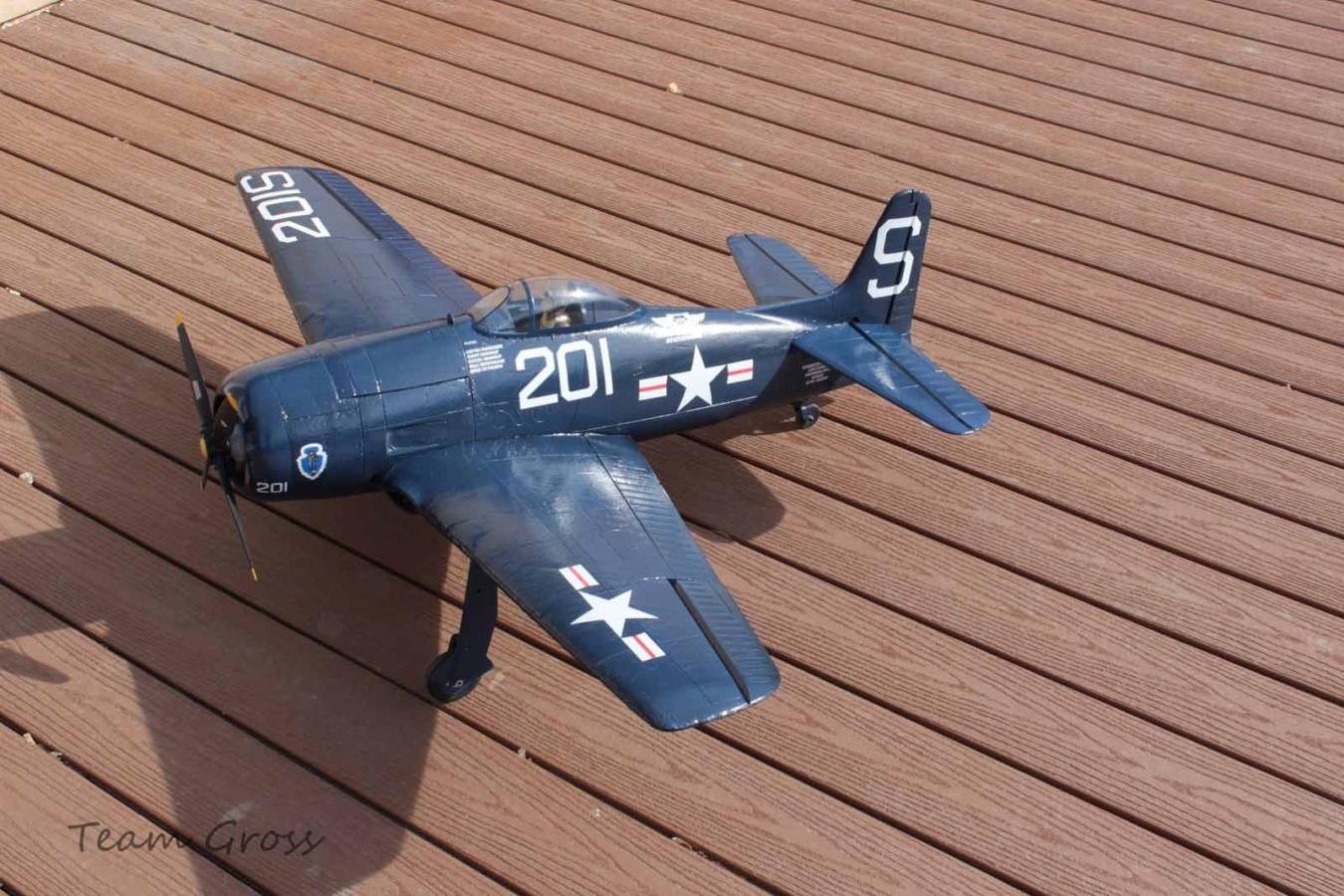

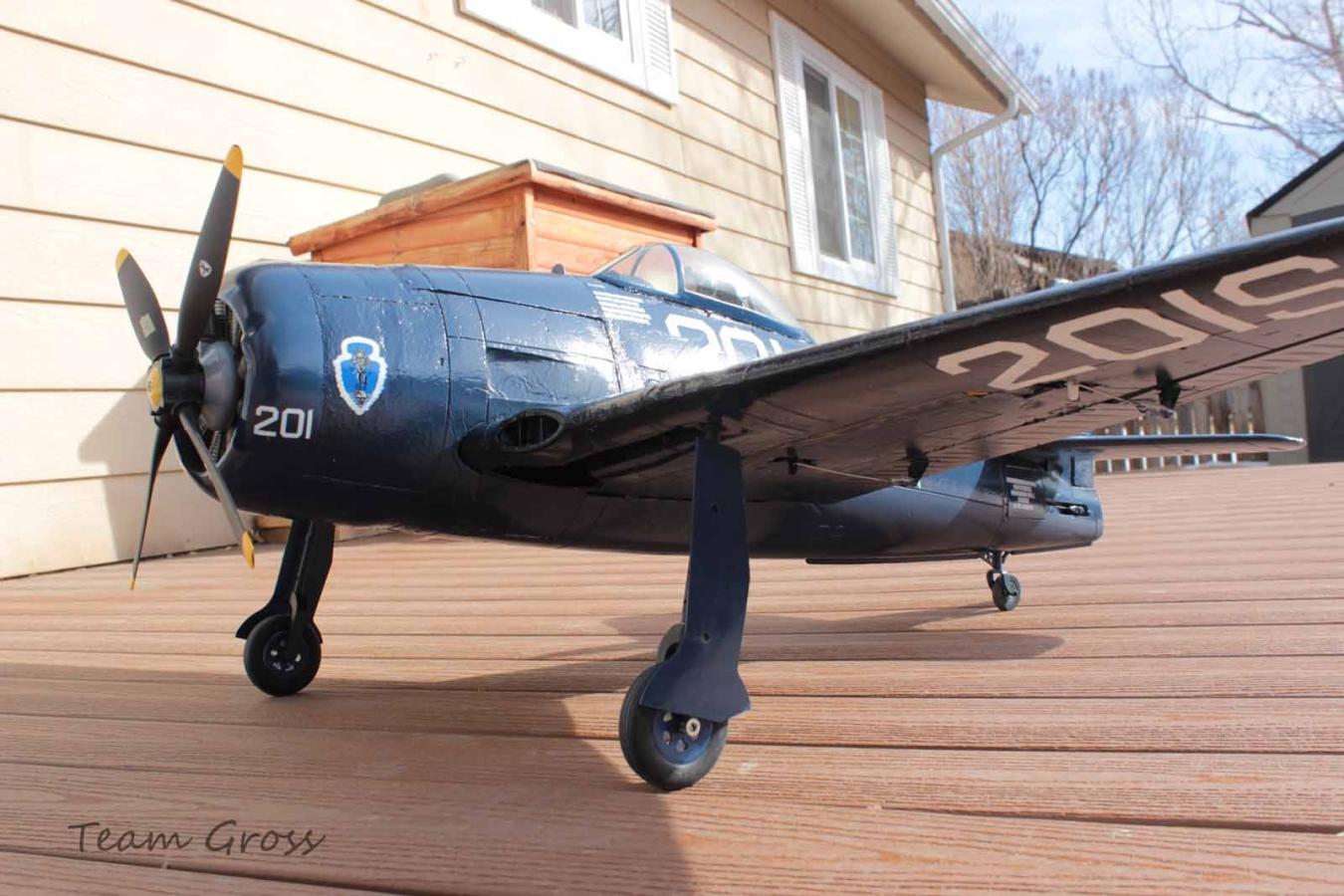

              Well, the sun is out and the Bearcat is complete with the installation of the A3L yesterday. Traditionally, all my planes get their pictures taken out on the deck. Is it perfect, no, but it's damned close and considering the parts, with the exception of the motor, ESC and main landing gear wheels, are all from a plane that went down in 2017, she's an unexpected surprise!
ID:	338577Click image for larger version
ID:	338578Click image for larger version
ID:	338579Click image for larger version
              I'm noticing a pattern in the fleet now. Two Bearcats, two Spitfires, two flyable Mustangs, two P40's and two Pandoras. Hmm, wonder if that's significant?

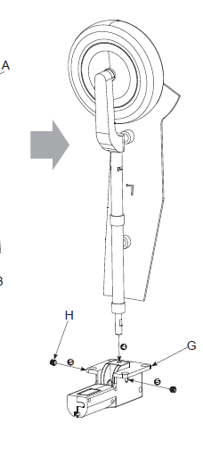

                    Hello, first post in/on this forum.
                    Recently decided to try a war bird. Came across a Flightline F8F 1200mm Bearcat which was affordable so picked it up. The bird was/is basically a derelict as its previous owner flew it hard and put it to bed wet (literally wet). Flew it with only two of the four props. Belly landed the bird most of the time (according to the owner) and generally took no to little care of it. Being a sucker for mistreated aircraft I brought it home.
                    I've had it up once now and it does what I expected. Not hard to fly at all if one keeps its speed up. I am however, wondering it I should replace the main gear as they both seem to be wobbly. The bird will taxi fine and takeoff and land fine BUT the gear just seems somewhat loose. Question is what is too loose for this bird? Hoping someone here can give me some insight.

                      There is a set screw at the base of the strut and the retract. It's a little difficult to see and only accessible when the gear is retracted. See if you can find it and tighten it up, I had the same thing.

                        Greatly appreciate the information Grossman56. Went out and found the two grub screws positioned at the side of the trunnion/s. Tightened all four of them up but the loose strut/s remain.
                        While going through the process of locating the grub screws I did find what I believe to be the real problem, however, as both retract servos mounting flanges are broken across one side. If it were not for the metal cap each landing gear servo would simply rotate out of position on landing. It appears the metal cap/s are acting to hold the broken section of each flange in place. The cap also is splinting the remainder of the two flanges thus fixing both gear in place for now.
                        I could not locate the set screw/s.

                          I'm not sure if you have the manual for the airplane. A few years ago I rewrote some of the manuals and still have them on my PC, here's what I was referring to:
Name:	Bearcat landing gear.PNG
                          As you can see, 'H' is the set (grub) screw I was referring to. It's easier to access if you remove the retract from the wing. Make sure both are tight as they will cause the wheels to slop in a toe in/toe out manner and if they're really loose, the retract will fall out. Hope this helps.

                            Yes, the two grub screws identified in the above diagram are the screws I mentioned. I tightened both for/on each strut.
                            Took the bird out this AM. Handles well during taxi, takeoff and landing. One would not think so though when the gear are tested and there is such a great amount of slop.
