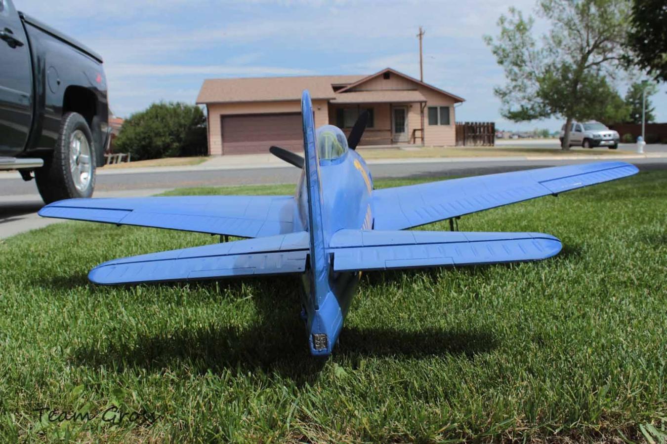

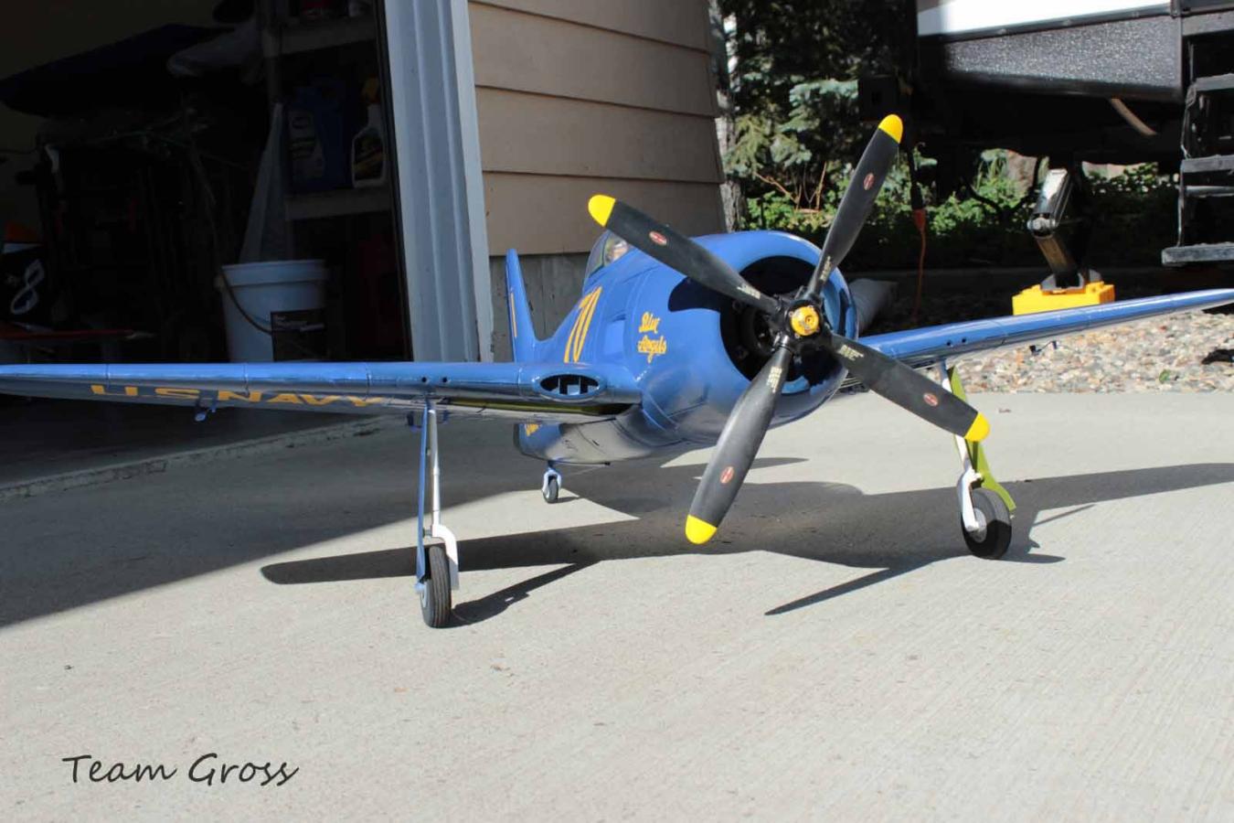

              Yep, my Blue Angels Bearcat has a 650 kv motor with the FMS 1400 mm Corsair prop on it
              Click image for larger version  Name:	IMG_5303.jpg Views:	0 Size:	122.9 KB ID:	377753
              And my CAF Bearcat has a 3948 760 kv (Which was in all the 1300mm FMS 3D Aerobatic planes) spinning the stock prop.
              Click image for larger version  Name:	IMG_5650.jpg Views:	0 Size:	148.0 KB ID:	377754
              Both have 85A mantis ESC's the 650 is from the FMS P40 and the 780kv was from an FMS 3d airplane, I'd have to look it up.

                  You'll need the x mount for the motor as well and whenever I upgrade, I go with an 85A Mantis ESC. The performance is great, much better than stock. A lot of my 1400 mm airplanes are flying the same system and it improved them, so with a lightweight Bearcat at 1200mm, she's probably the fastest prop driven plane in the fleet. I can fly with 3600's and 4000's moved back. I also found that a tab of weight in the tail...
                  Click image for larger version  Name:	IMG_5311.jpg Views:	0 Size:	195.2 KB ID:	377820
                  helped with the CG.
                  Be careful taxiing if you're on a rough surface as the tail likes to bounce, I keep full back elevator on mine. Also, this one has Dave Browns on it which really help, you can almost feel them stick to the runway when she lands. A bit of back elevator when taking off and man she's in the air in 10 -12 feet with no effort, I use half flaps too. When it comes to maneuvers, she'll do anything you ask effortlessly. The surprising thing is that she loses none of her slow flight characteristics which really made me happy.
                  I tired searching out the 760 kv with no luck, somewhere out there...
                  I'm thinking of buying two Tigercat nacelles and redoing them from front to back( 760kv, 85A ESC, LX B25 props, different x mounts and ESC-motor adaptors). Maybe better off to buy the whole airplane, but those 760s were awesome on her.

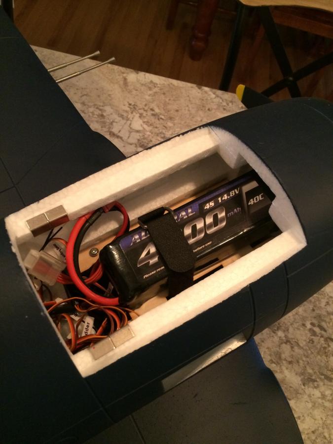

                        I have experienced nothing but complete Joy with my airplane this bearcat is outstanding everything I have to say about it is good minus one thing three seasons of flying this aircraft with the recommended battery no problems until now after doing a corkscrew I'm pulling out of it nicely made a nice banking turn to the left and the battery hatch popped off and the battery came out and disconnected and that was the end of that aircraft I couldn't believe my eyes always thought that strap was too short wasn't getting enough of an area for it to work properly but it did for a long time I had so much faith I was not worried and I am so sorry that this airplane is gone get a longer strap for the battery maybe put in a secondary that is my advice and I'm sure this airplane will give you pleasure forever they could have fortified the landing gear a little better too but that's another story for another day
                          • 7438
                          #992
                          I hear you. After purchasing my last Bearcat I messaged Alpha and told him that the battery strap was too small. I had a spare FMS strap that was long enough so subbed that one in. I told him I shouldn't have to use an FMS strap in a Flightline bird. Guess he didn't get the hint. It would be nice if the boys would take a bearcat fuse out of a box and see for themselves back at Motion RC HQ. Just try strapping down a 3600 4s Admiral let alone a 4000. Don't know what happened because I never had that problem with my first Bearcat.
                          Remember this??
                          Too bad you had to lose a bird over this. I use velcro on all my batteries. Strange that the hatch came off as well. It didn't happen to be a new hatch did it? I've had hatches where I've had to swap out the magnets because they're the wrong polarity. They fight like the devil to get them even close to each other so I doubt if that's the problem but you never know...
