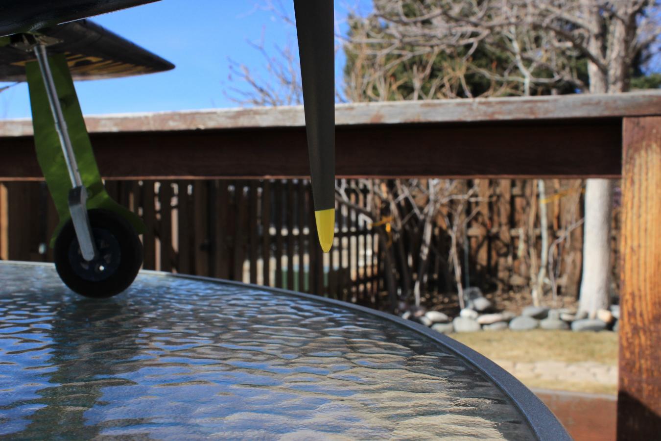

                                The Bearcat once again graces my fleet. Sold off some planes that weren't being flown and and invested in my favorite airplane. The price has definitely gone up, from $199 originally to $279, and I'm not going to get into the politics behind that, suffice it to say that it a bigger percentage of my income than it used to be.
                                On the plus side though, the quality of the kit remains outstanding so the molds are holding their own! I changed out the motor and ESC to a kv 650 and a Mantis 85A spinning a 1400mm FMS Corsair prop, which has proven to be the ultimate combination for 4 cell performance. I also swapped out the tires for Dave Browns, I just love those tires!
                                The one thing I found was that the battery strap was way too short to hold an Admiral 3600 4s pack in place. Don't know what happened there but I had a spare FMS strap that did the job. With the stock strap, I could get maybe 1/4" of velcro to grab but it was so little it would just let go. I even took the decking out to see if the strap was hung up on something, but no, its just a 1/2" too short. Alpha may want to look into that as there would be nothing more frustrating than to build the plane and then try to mount the battery, but you can't!!

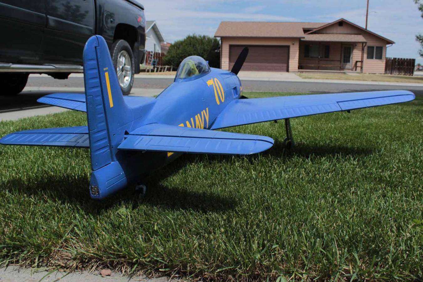

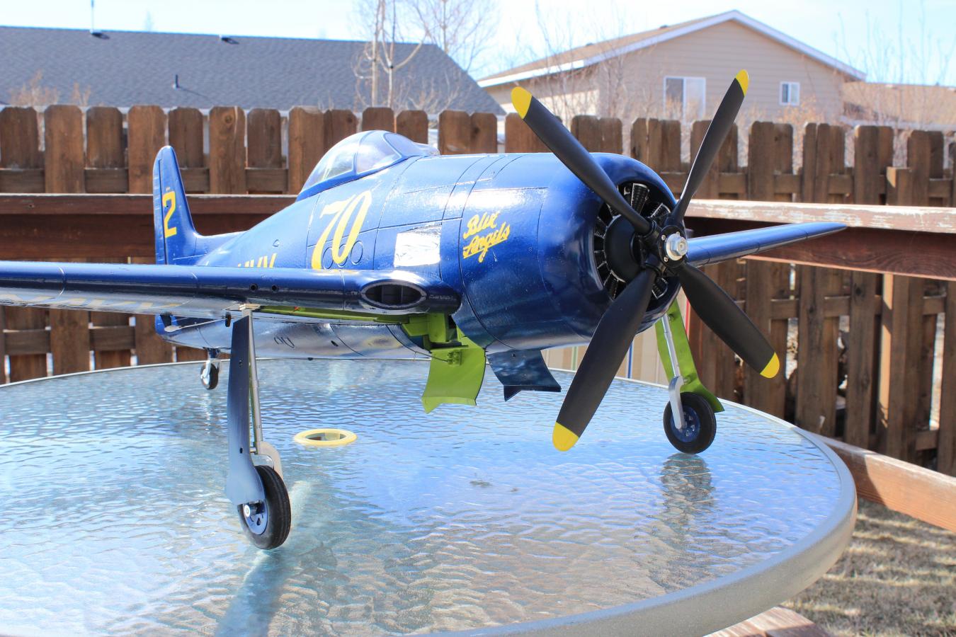

                                If you're wondering what it looks like with that big prop, here's some pics from the first time I installed it.
                                And here's the ground clearance...
                                I've never had a problem touching the prop both landing and taking off and the slow flight characteristics remain the same as with the stock system.

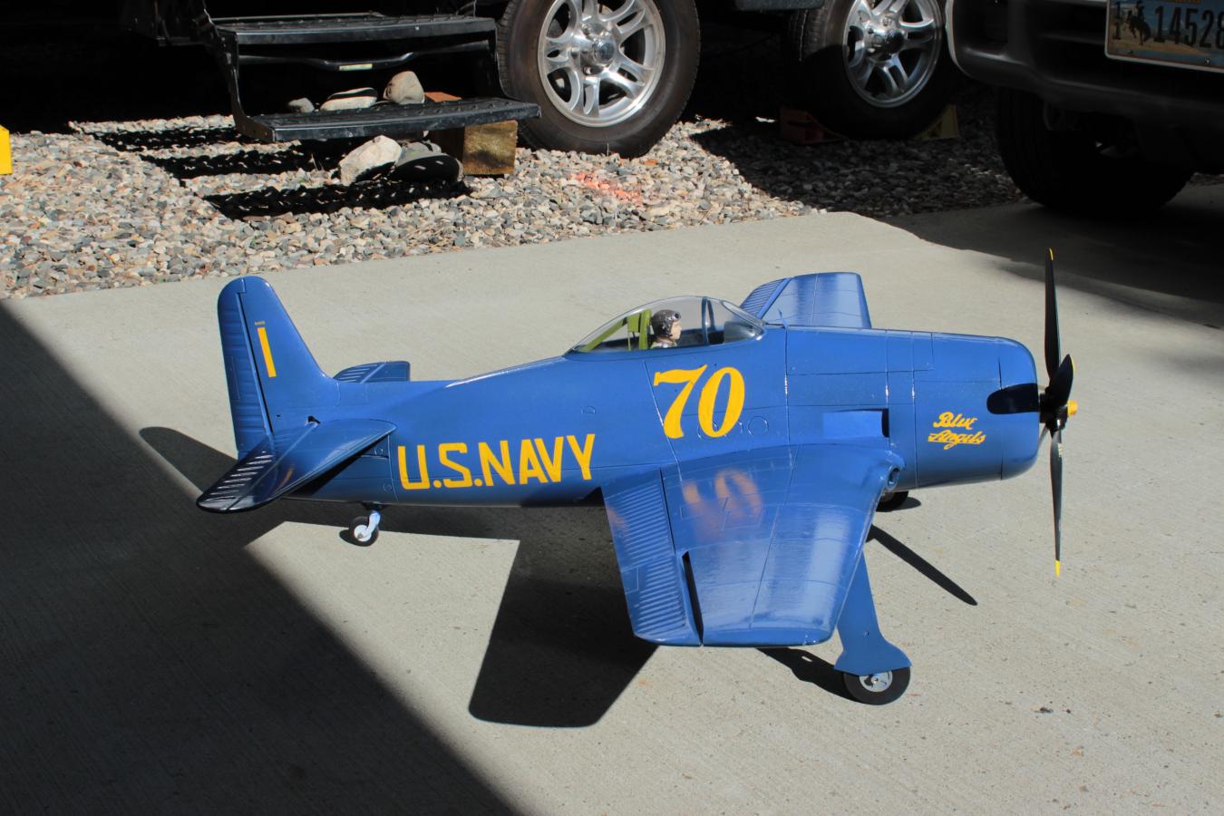

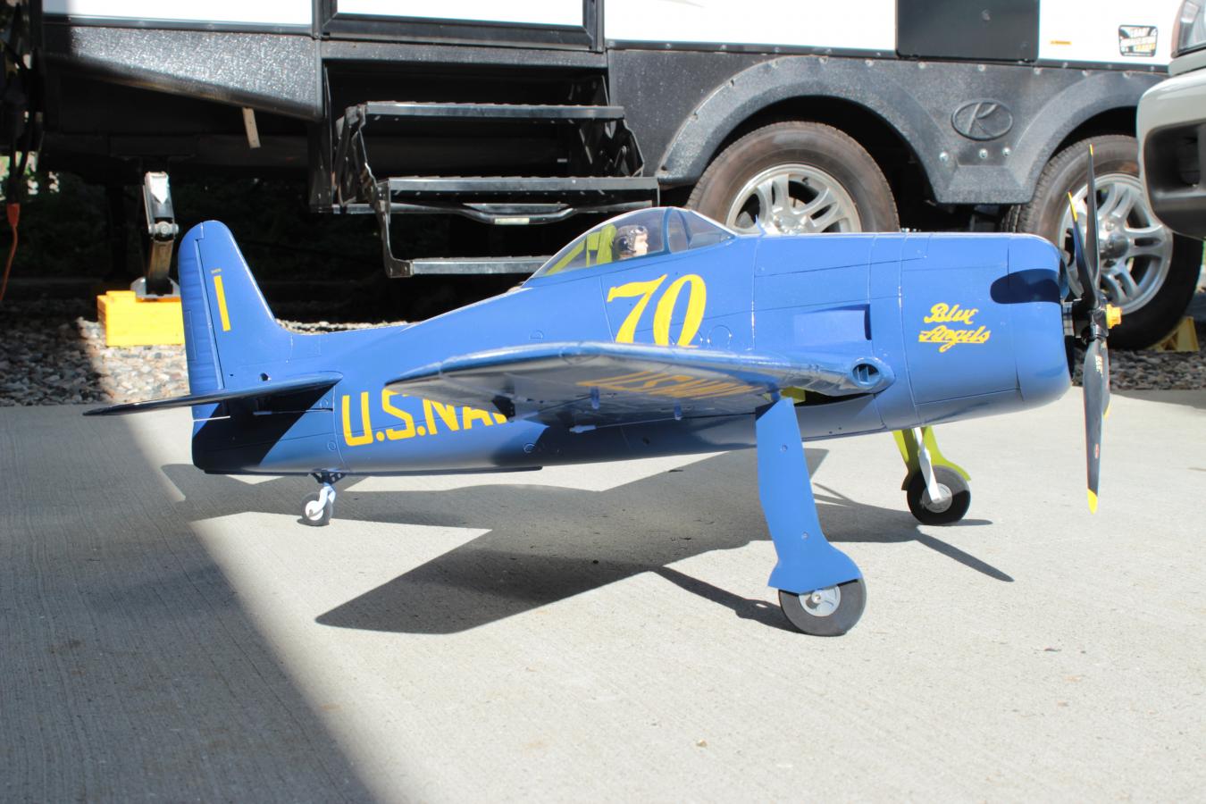

                                    I decided to go with a lighter blue this time, which looks great so far. One issue I've found is that the decals don't stick worth a dang and they were bubbling off the backing board. Personally, I think they have a life expectancy. Hopefully they'll work, but if not I guess Callie is my only option. We'll see.
                                    I was gong for a blue similar to this...
                                    She's a little darker but picture some where in between. First coat of Spar Urethane on her now. It's been hitting 100 degrees out here in Cody, so the drying time is great!

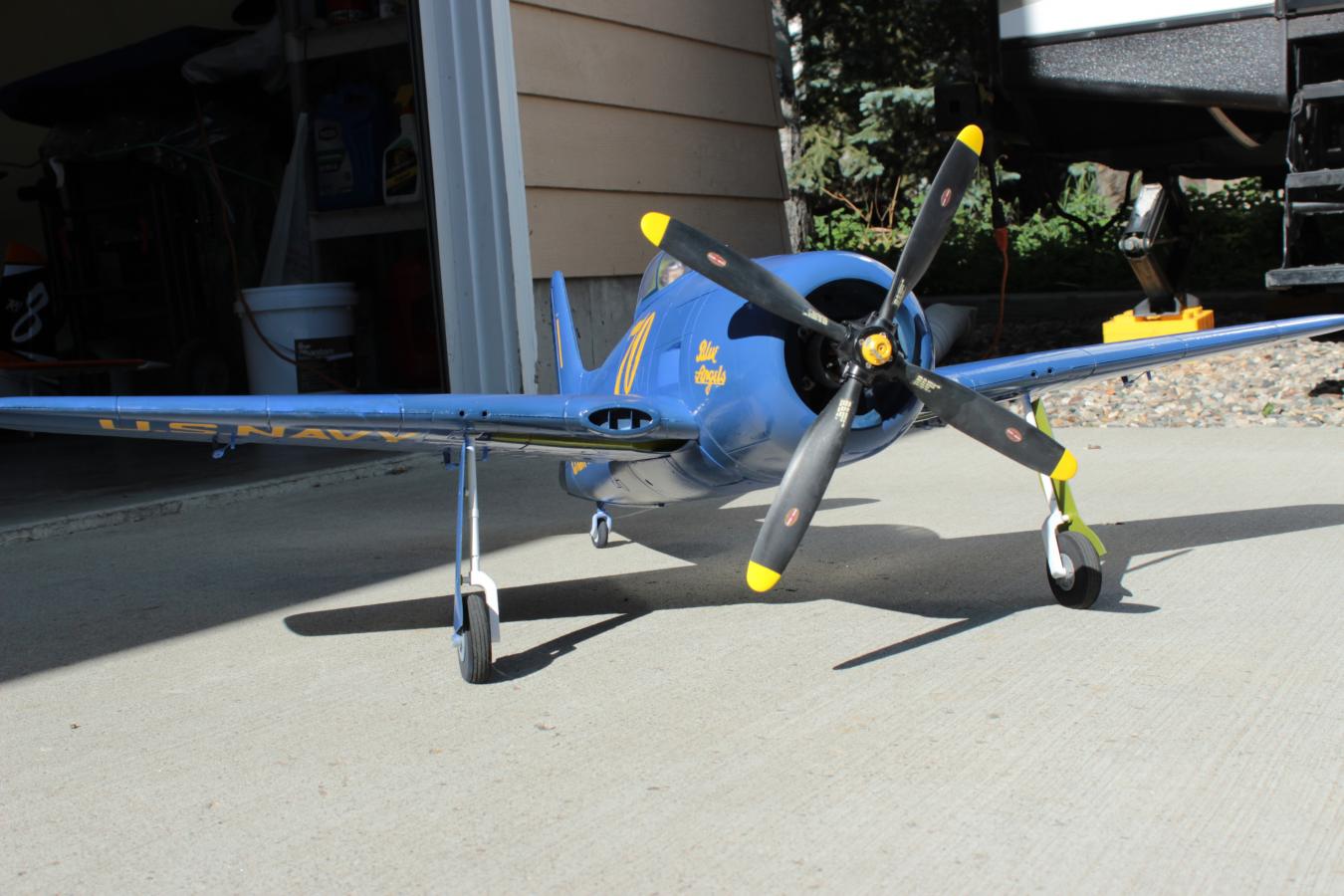

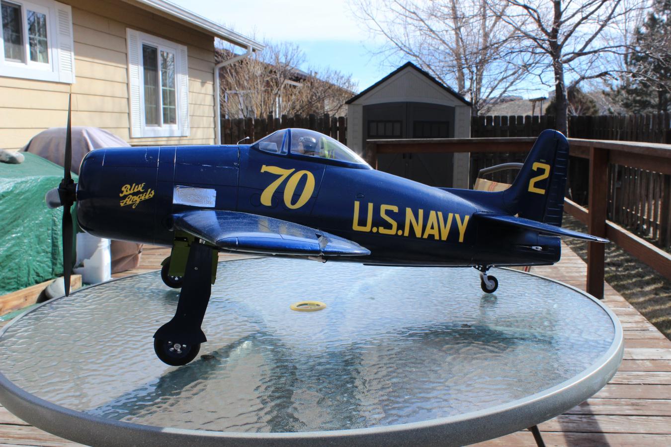

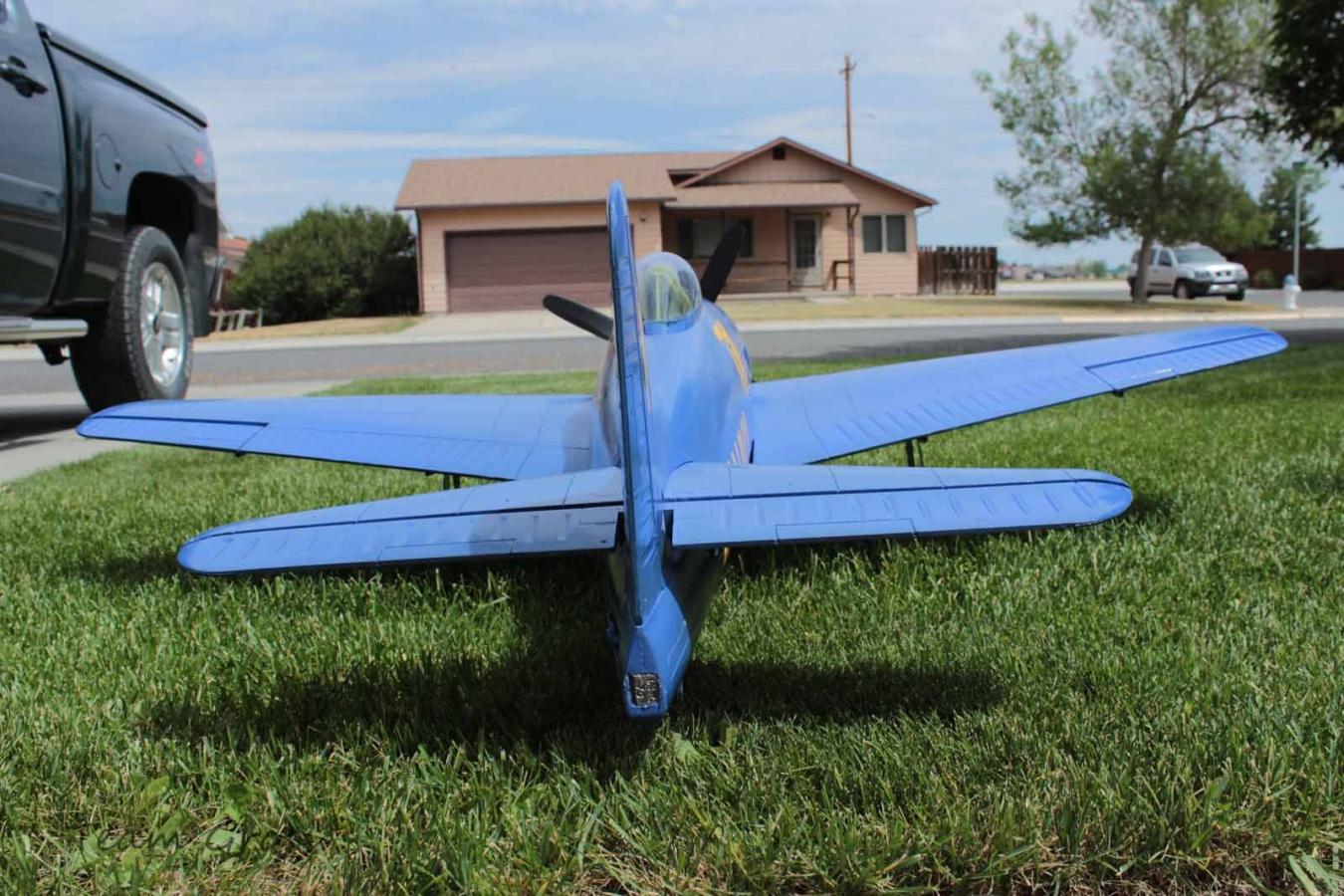

                                        Work on the new 'Cat continues, just got another coat of Spar Urethane on her and the first pictures of the work so far..
ID:	316348Click image for larger version
ID:	316349Click image for larger version
                                        Still working on the motor, shaving it down to fit over the 650, then some detailing on that. Right now I can get her to CG up on the stock points and she's a pretty forgiving bird. I used a 4000 4s battery sitting back to line up with the back of the floorboard. Worse comes to worse I can use a 3600 instead, but I always used a 4000 in the past, the only difference being that I had a 1/4 oz of weight where the tail hook would extend. Still some detailing to do but so far so good!
