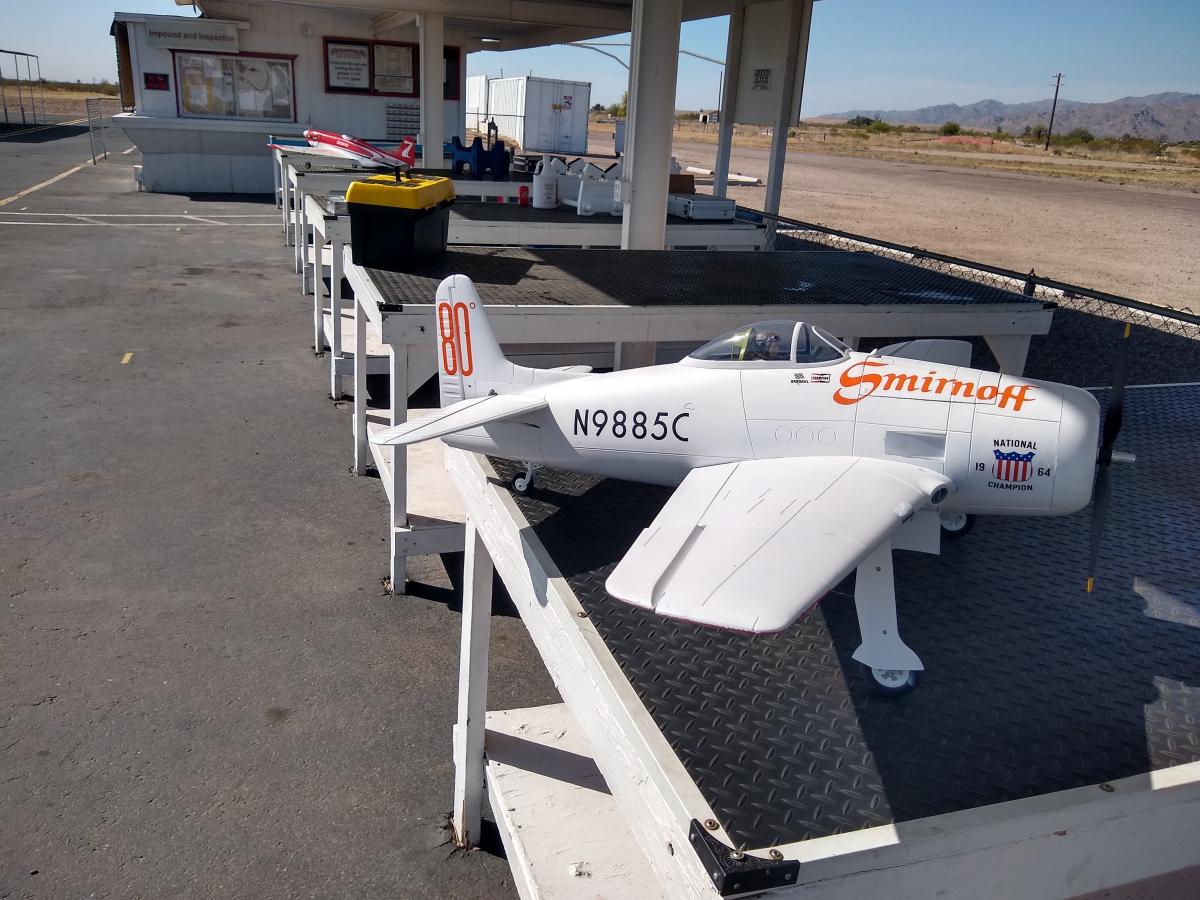

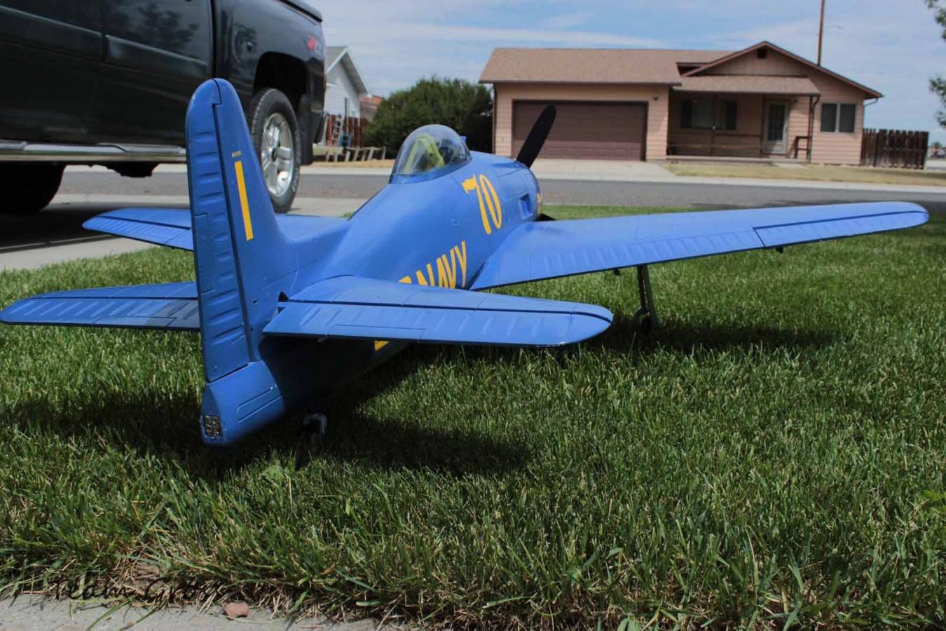

  • Posted in the wrong thread but I took my Bearcat out for a flight and getting ready for the warbird races coming up in our club. Click image for larger version
Name:	Smirnoff Bearcat.jpg
    • That looks good, Randy.
      • Thx I am going to race in the bronze class and I have the stronger motor and a two bladed prop. It is actually competitive in the bronze class. I got the decals from Callie graphics and this is the plane that won the the national air races in 1964.

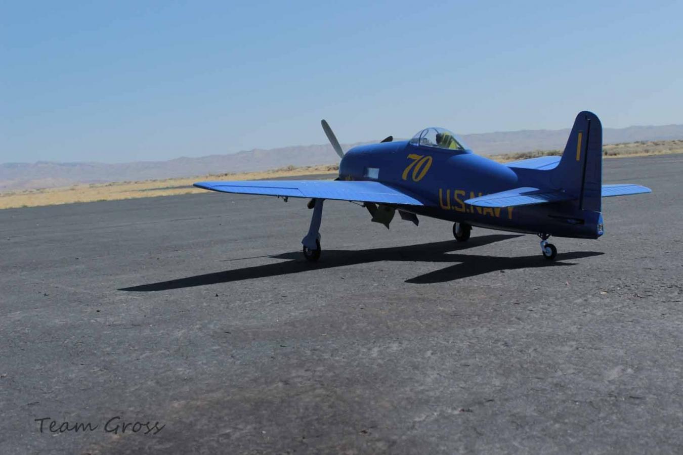

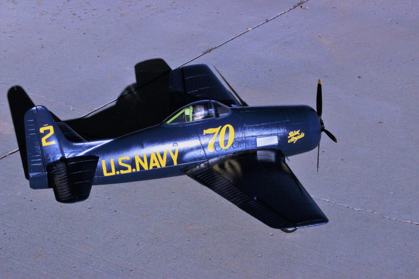

        • Looks great Randy, did you do the stock upgrade from MRC?

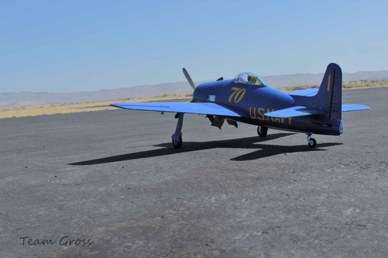

          I'd be interested to see how my Bearcat with a 650kv and a FMS 1400 mm corsair prop compares. The airplane is incredibly fast, there is a big difference between 3/4 and full throttle and its not hard on flight time, lands like a stock bird as well. It's a bit of drilling to mate the motor mount to the firewall and a fair amount of trimming to get the faux radial to fit over it. I use an 85A Mantis ESC as well. Also, one pad of stick on weight in the tail.

          Note, I did a repaint using Testors Royal Blue, looks good and then of course Spar Urethane for that waxy shine!

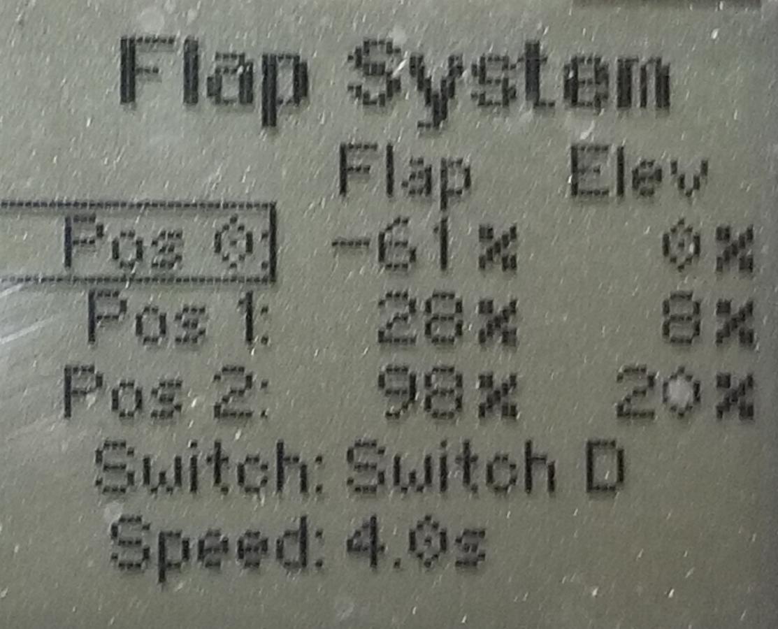

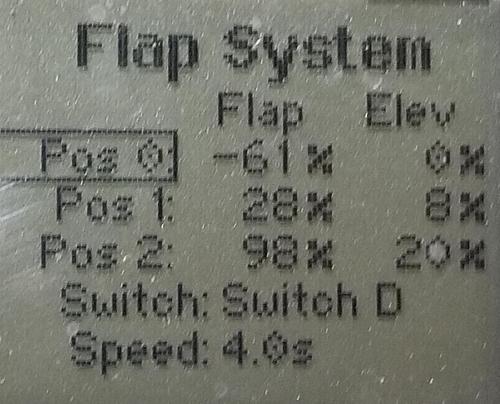

                                  • Mine doesn't balloon with flaps. It actually did a loop. Can you tell me what percentage of down elevator did you use?
                                    • This is my config. Results may vary... Click image for larger version

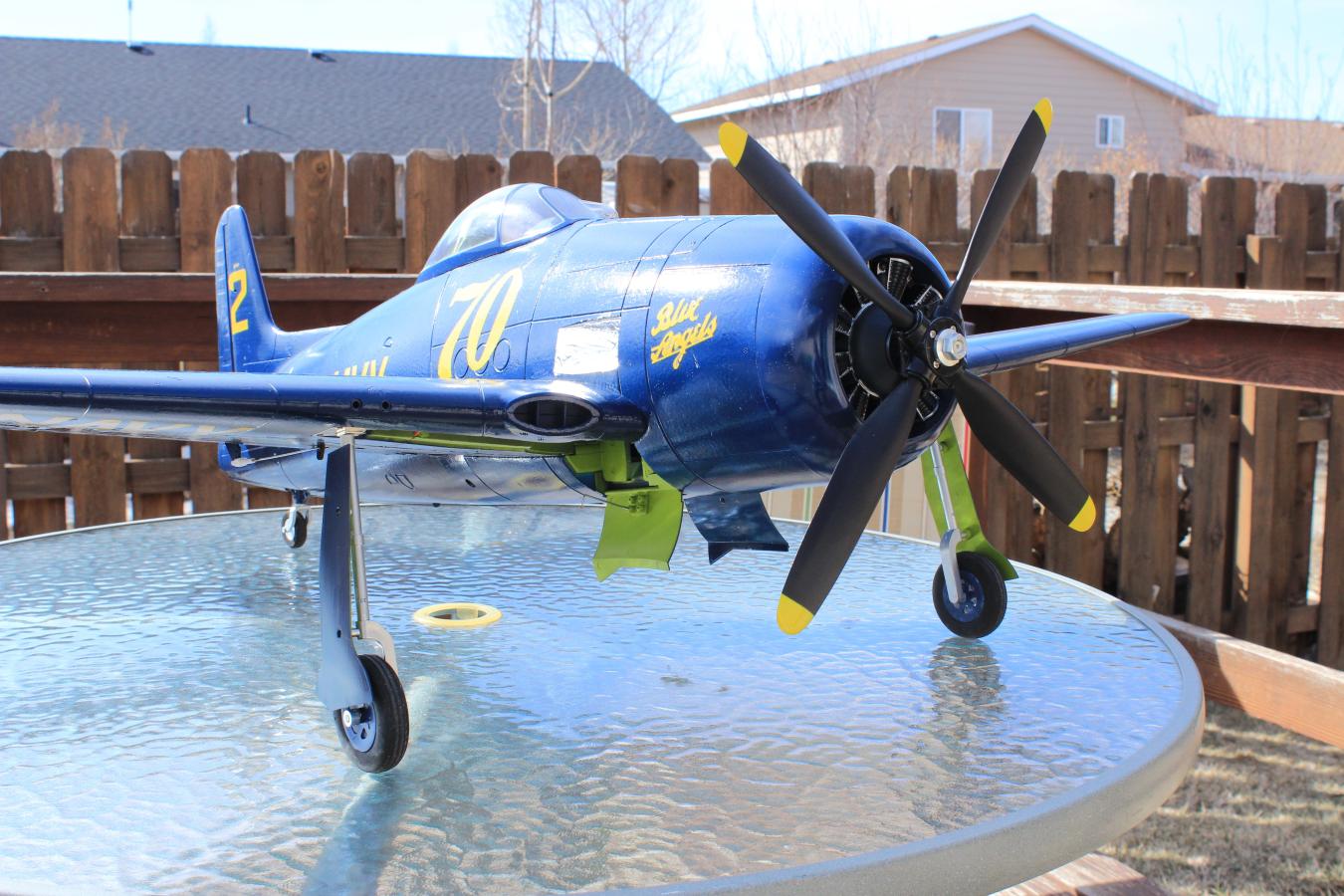

                                      • Well, it's winter in Wyoming, so since all my planned repairs are done, I started looking at some wrecks. I have two F8F wrecks and one F7F. Funny how time changes your perspective. I totaled my first F8F at Muncie years ago and bought a new set of wings and fuse then transferred all the guts from the wreck to the new. No biggie, we've all done it. Then last year I lost Bearcat 2 in the sun and let's just say it isn't very pretty. Sold an airplane last Spring so purchased Bearcat 3, installed the 650Kv and 85A Mantis ESC from Bearcat 2 into it and all is well.
                                        Started checking over Bearcat 1 fuse and wings because, frankly, I was bored. The wings are in surprisingly good shape, I'd popped the retracts out and the repair was a little rough but not bad. The nose of the fuse is slightly wrinkled but intact with a slight chip on the nose ring. "A project!" cried I!
                                        Bearcat 1 (she will fly again!)

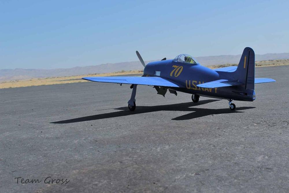

                                        Bearcat 3
                                        Now the question is what to do for power? I'll go digging to see what I have lying around. I do have a complete prop, motor and ESC from Bearcat 3 that has never been used so that's a possibility.
                                        Hard to believe this plane (picture #1) went down at Nefi in 2017 and five years later, she just may take to the skies again.

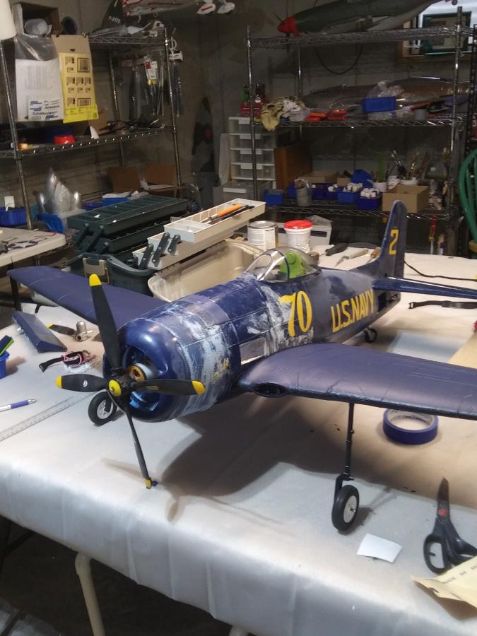

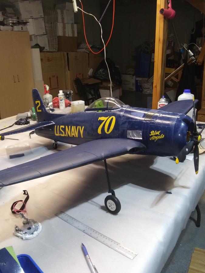

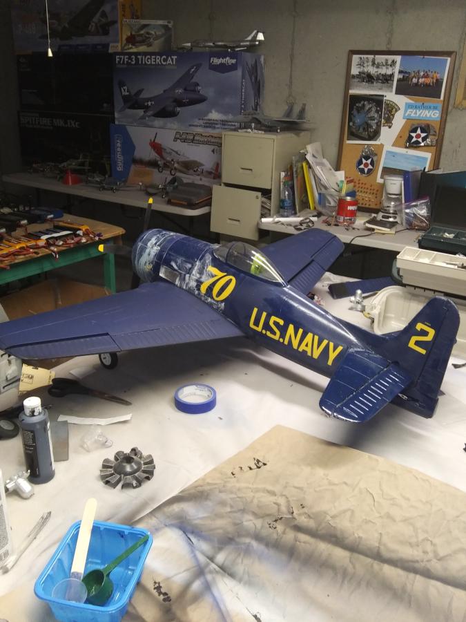

                                        • Bearcat One, now rechristened as Bit's and Pieces is being rebuilt as we speak.
                                          Here she sits after a trial fitting of all the major parts:
                                          Click image for larger version  Name:	20220215_102111.jpg Views:	0 Size:	81.2 KB ID:	337518
                                          Now, the wings are rebuilt from the original, I cut and applied Flite Metal in the shape of the wing panel where the landing gear attaches to add aluminum strength, then primed the wings with Krylon Foam Primer. Painted the wings black then used the same blue I had mixed for the Pitts. A pretty accurate match. The tail section was original to both Bearcat one and two, one of the elevators was knocked off, now reglued to the stab using Foam Tac.
                                          Click image for larger version  Name:	20220215_102141.jpg Views:	0 Size:	81.6 KB ID:	337519
                                          As you can see, the fuse is in the process of being filled, I tried the steamer to loosen the foam and it did help a bit but there is still some work to be done. There is a slight amount of damage to the nose ring as you can see at about 2 o'clock, but the picture makes it stand out more than in real life. The wheels are from Bearcat three as I have Dave Browns on her. The motor is from La Patrona. A 3948 kv 750. I haven't run the numbers on it yet, but I'm thinking a Mantis 85a ESC should work. The prop is the original Bearcat one prop before I converted it to the 1400 mm FMS Corsair prop. This will do for now, with the possibility of converting it to the Corsair prop in the future. The nice thing about this motor is that the dummy radial should fit easier than with the 650 kv, haven't tried it yet, so we'll see.
                                          Click image for larger version  Name:	20220215_102156.jpg Views:	0 Size:	74.8 KB ID:	337520

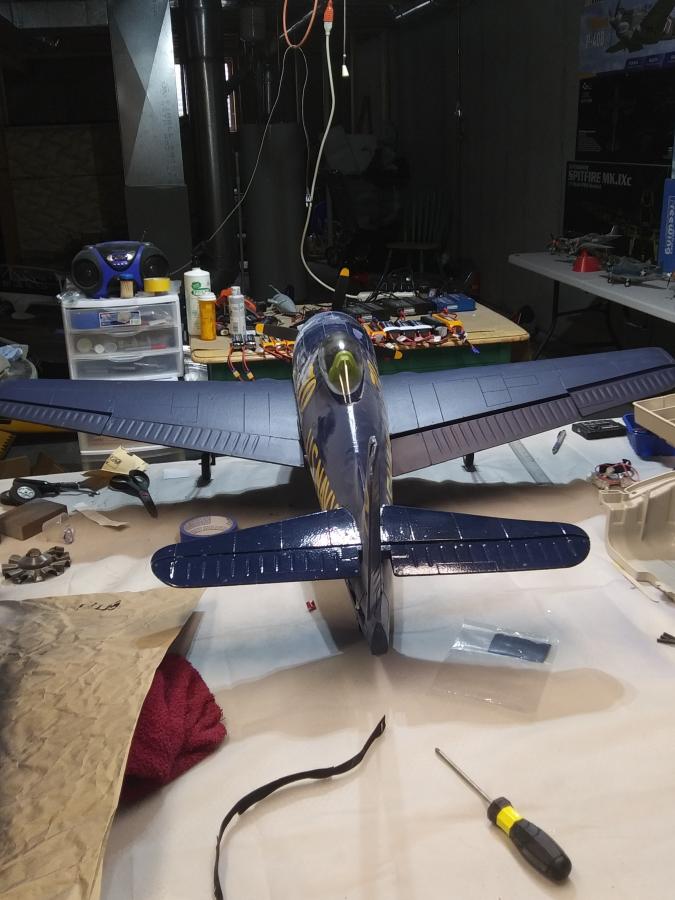

                                          The glossy tail section was on the wreck of Bearcat two, here it is all together again with the tail wheel and linkage hooked up to the rudder. there is a plate that goes over the linkage and damned if I didn't find a brand new plate buried inside the fuse of Bearcat two, still in its bag.
                                          Click image for larger version  Name:	20220215_102230.jpg Views:	0 Size:	71.7 KB ID:	337521
                                          The fuse will get the Primer, black and blue repaint as well and for once, I won't use the Blue Angels decals but the basic Naval markings, just to be different and 'cause I want to
                                          Stay tuned!
