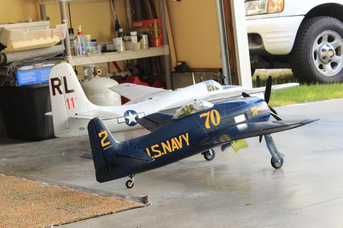

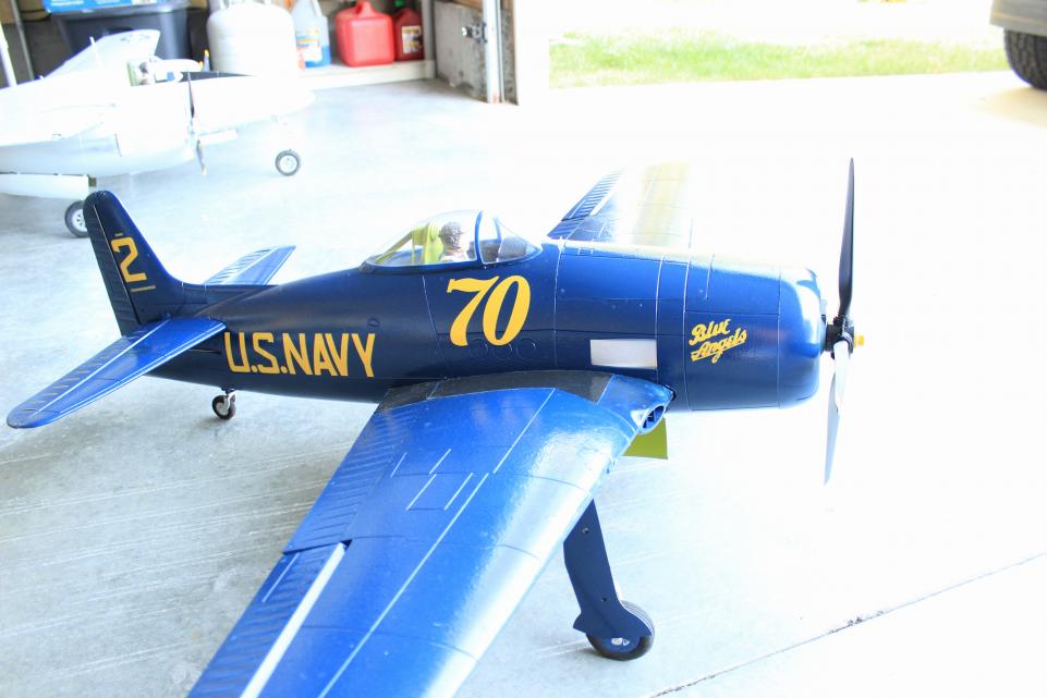

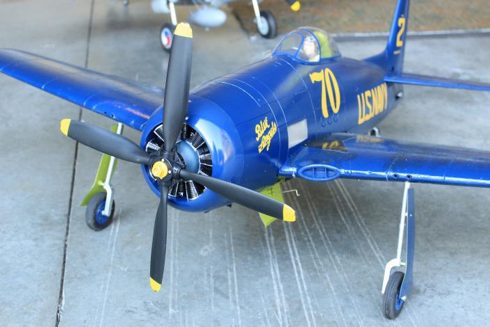

          I love this bird !! I started out stock and then went with the a 650 kv with a 85A ESC and the 1400 mm Corsair prop. Great upgrade when your ready for it. Had an incident at Nefi as I'm sure you've read and had some repair work when I got home. She's back in the air and flying like her old self!!

            #565
            Looks good Tony, welcome to the Squawk.

            Very nice Bearcat. I like the Blue Angels scheme as well.
            Tony
