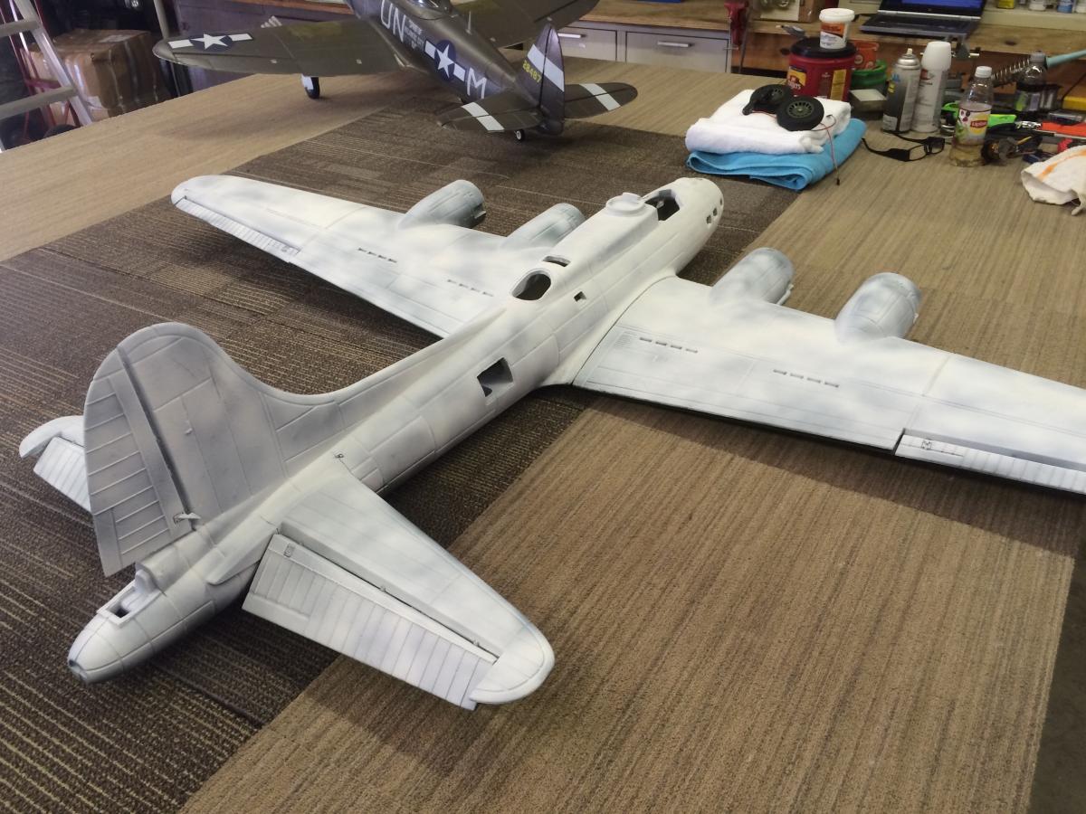

                                      #418
                                      Yes on both, it makes the smaller stuff lay down and hardens the larger fuzz so you can lightly sand it.
