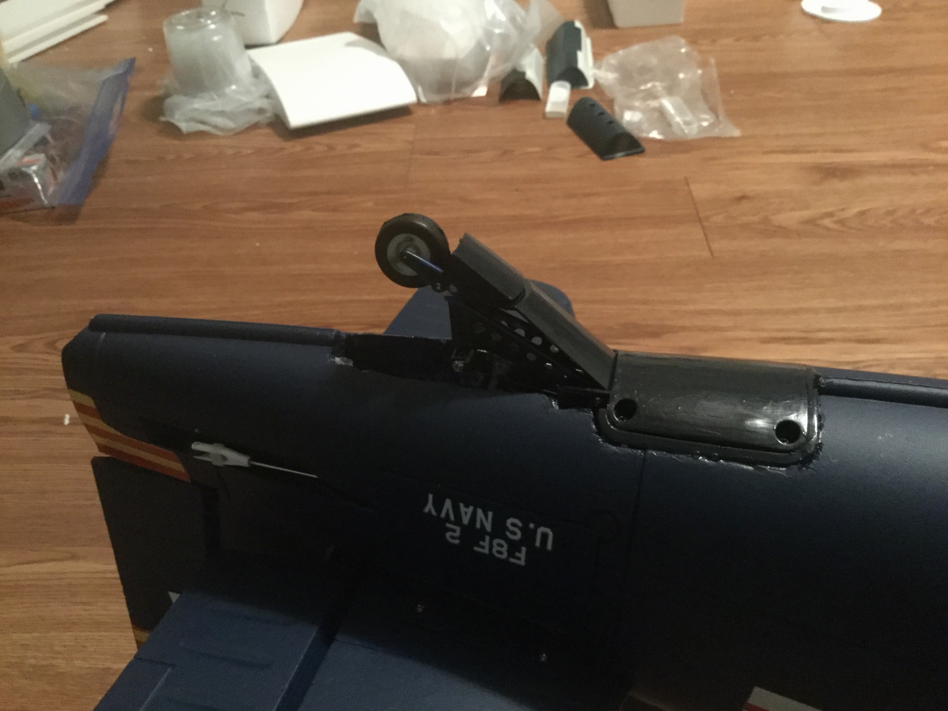

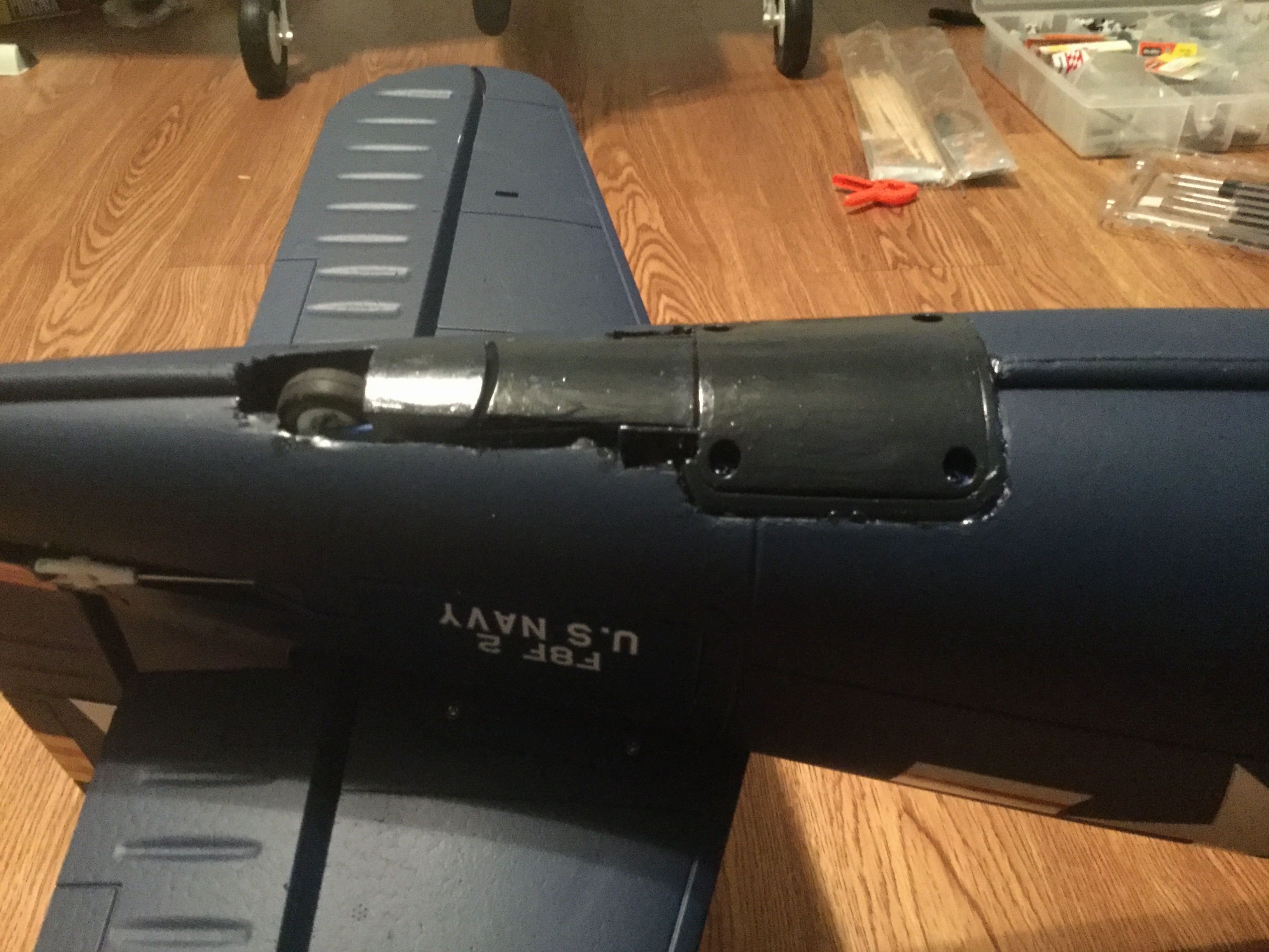

        Last night I finally decided that it was time to get rid of the tailwheel on my Bearcat. I found that the tail retract from the FMS 1400mm Hellcat was almost a perfect fit for this model, and actually looks more scale than the stock tailwheel. Only issue with the mod was redoing the rudder pushrod, since the stock one is a small pushrod coming off of the tailwheel steering horn. Got a few shots in flight this morning, and I am glad I put in the work! I'll post a few more photos of the retract itself if anyone wants them.

          #304
          Looks great Delta! That totally makes it. Retract wizard. :cool: Man, haven't taken it out of the box yet. Need to get on it...let us know what you did Ace.

            #305

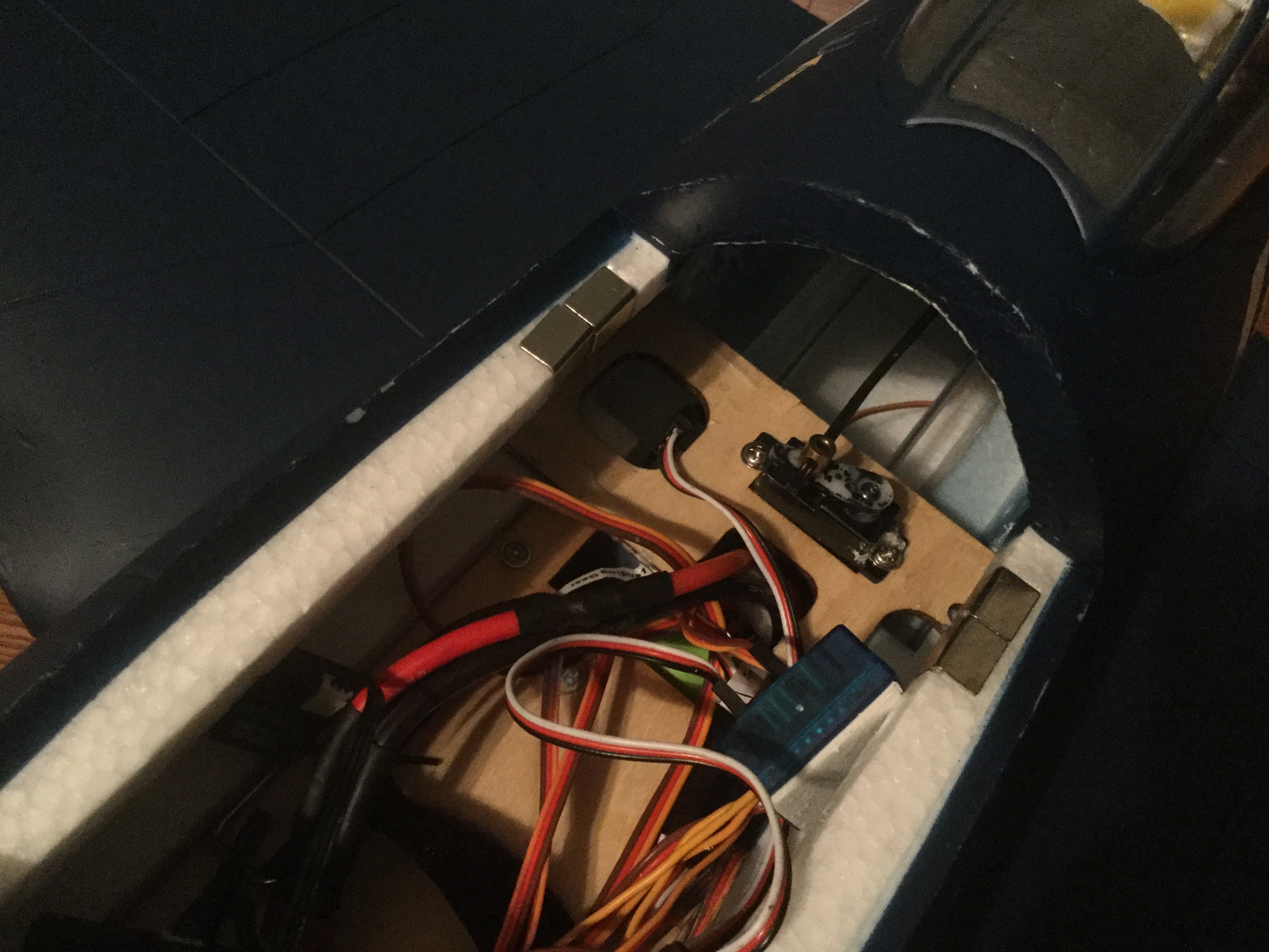

            Thanks Westsider! Here are a few more shots of the assembly. Installation is pretty simple, just cut the proper sized hole, remove the stock assembly, and epoxy in the FMS unit. I mounted a tray inside to hold the servo for the retract as well. The unit has a steering servo built in, so no need to worry about running more pushrods. Unfortunately, that servo is reversed from the rudder channel, so you will either have to run a reversed Y harness, or use a separate channel. I have both steering and tail retract on separate channels for the moment.
            The biggest headache is the rudder pushrod. As I said earlier, the stock setup runs a pushrod to the tail steering horn, and another, shorter pushrod links that to the rudder. You can either replace this with a longer single pushrod, or bind a smaller pushrod to the original one. I did this by overlapping a spare shorter pushrod with the one that went to the steering arm and tightly would thread around that joint. Thin CA was applied to harden and secure the joint, and it is quite solid so far.
            FYI, the retract is available here: http://www.bananahobby.com/rear-land...4483-prd1.html. I scoured the internet for some time looking for other sources, but they seem to be the only source. They are a discontinued part so I would get them quickly while they are still available.
              #306
              Bravo Zulu, F106DD! The grass crowd would have a tough time with that scale tailwheel but as an asphalt flyer your mod has got my wheels spinning and my finger is on the Buy button at Banana right now! This looks really nice. Paired with your big prop, I really love your setup. It's always gratifying seeing modelers take a mass produced item and really make it their own.
