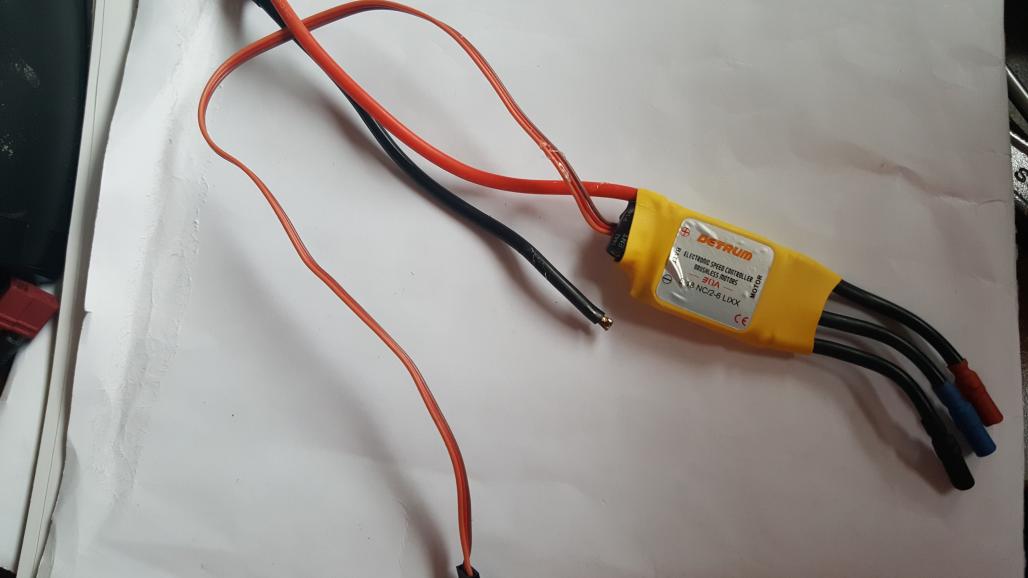

                              ESC over heat problems with Dynam Spitfire. Anyone else? Click image for larger version

                                I cut open a chin scoop and vent holes on the bottom rear of the fuse and have had no more problems even on 4s.
